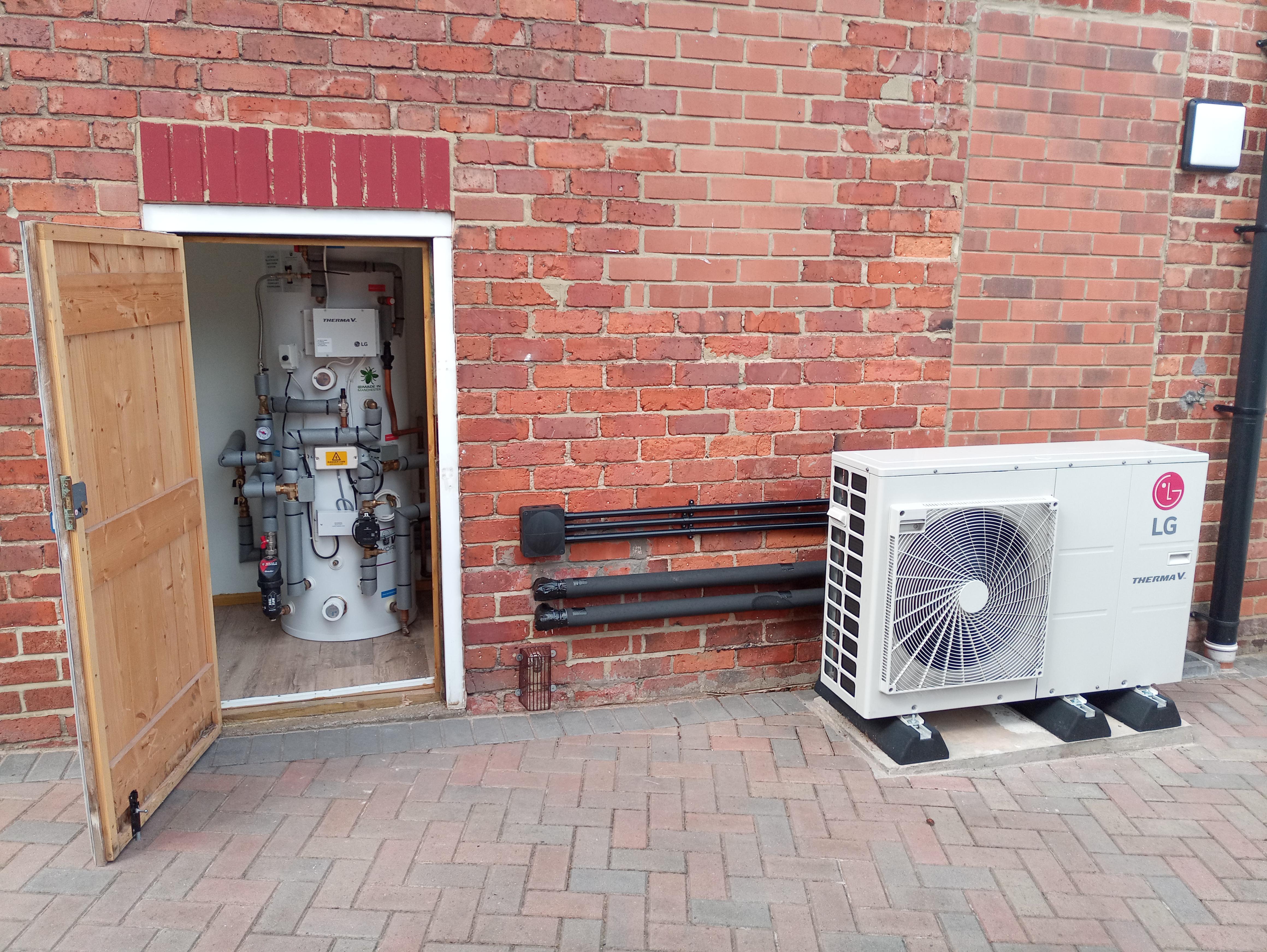

Ronny Posted May 28, 2021 Share Posted May 28, 2021 I have been trying to upload a pic of the heat pump and tank with no luck. I will try this time using my phone Link to comment Share on other sites More sharing options...

Ronny Posted May 28, 2021 Share Posted May 28, 2021 3 hours ago, dpmiller said: Inverse, ST. Bog-standard weather compensation, in other words? I think you are correct with your statement. I am the first to say I am at times bamboozled with what a lot of the settings do, or are meant to do. I am old so at least I have an excuse. I am hoping when winter comes around, I will be able to run AI mode and perhaps be able to run the system constantly, at reasonable cost and comfort level. Link to comment Share on other sites More sharing options...

Ronny Posted May 30, 2021 Share Posted May 30, 2021 7 minutes ago, ReedRichards said: This is how it works, as @dpmillerstated. @Ronnyis that a Telford cylinder (like mine)? The cylinder is a world heat 150 L superflow The biggest I could get into the available space. Link to comment Share on other sites More sharing options...
ReedRichards Posted May 30, 2021 Share Posted May 30, 2021 Ah, different company but also made in Manchester. It was the bee logo I recognised as my cylinder also has one - but I now think that to be a Manchester branding. Link to comment Share on other sites More sharing options...
Ronny Posted June 3, 2021 Share Posted June 3, 2021 On 30/05/2021 at 22:17, ReedRichards said: Ah, different company but also made in Manchester. It was the bee logo I recognised as my cylinder also has one - but I now think that to be a Manchester branding. From what i can see of your cylinder it looks identical to mine. Perhaps they sell the same thing under different brand names. I can only see a small portion of yours in the picture you uploaded. Link to comment Share on other sites More sharing options...
dpmiller Posted June 3, 2021 Share Posted June 3, 2021 A lot of the componentry will be the same, and (no doubt) there are only so many suppliers of the wee rubber trims for around the pipes, and the plastic top/bottom covers... Link to comment Share on other sites More sharing options...
