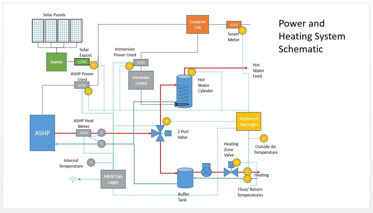

Chris Bottomley Posted February 8, 2022 Share Posted February 8, 2022 @Shark sorry for the delayed response I don't look at this forum too often. I have a PassivLiving MMSP unit installed. This was when the system was put in. As far as I know it has no direct connection to the LG Therma V unit, it only uses its own sensors. It uses the following metering: Sontex SuperCal 531 metering unit for ASHP output, flow rate? and temperatures Eastron SDM230-Modbus meter for ASHP power usage Eastron SDM130-M meter for immersion power usage Remote wireless internal air temperature sensor On top of this I have a home brew Raspberry Pi system that grabs data from the PassivLiving unit. It also has the following sensors: Heating and hot water demand Home power usage (Smart meter) Solar power generated ASHP flow and return temperatures Heating flow and return temperatures I have a Honeywell T3R wireless thermostat that was included in the installation and as noted in the discussion above it is debatable whether it is particularly suited to ASHP as it operates in a pulsing control mode rather than a pure on/ off as for old fashioned themostats. This has the impact of the ASHP only being on for short bursts (a minute or so) unless there is a big differential between the demanded and actual temperatures. Link to comment Share on other sites More sharing options...

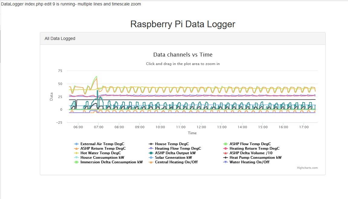

SteamyTea Posted February 10, 2022 Share Posted February 10, 2022 On 08/02/2022 at 22:57, Chris Bottomley said: On top of this I have a home brew Raspberry Pi system that grabs data from the PassivLiving unit. It also has the following sensors: Heating and hot water demand Home power usage (Smart meter) Solar power generated ASHP flow and return temperatures Heating flow and return temperatures How do you grad the electrical data from the Smart Meter and PV. Link to comment Share on other sites More sharing options...
Chris Bottomley Posted February 14, 2022 Share Posted February 14, 2022 Steamy Tea- the smart meter and solar panel meter have LEDs that flash 1000 times per KwH usage or generation. I use a phototransistor over the LED to sense the pulses and count them over a two minute period and then convert to kWh. Link to comment Share on other sites More sharing options...

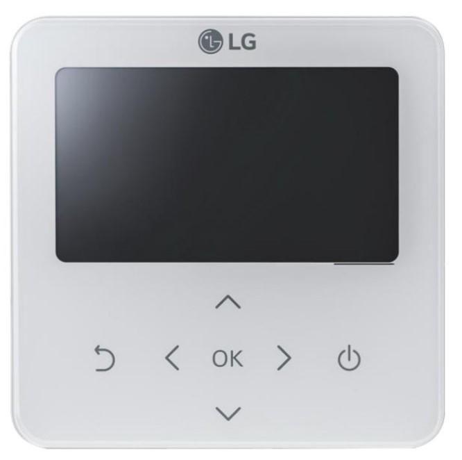

ReedRichards Posted February 25, 2022 Share Posted February 25, 2022 (edited) I thought I had commented but my comment has vanished (or I never completed it). You can see what the flow temperature IS in either mode by pressing the semi-circular arrow on the display. In AI mode you cannot see the target flow temperature and you can never see the outside temperature (from which you could calculate the target flow temperature). I would be surprised if you have a significantly different version of the software (go to Settings - Service - RMC Version Information to find out). But if so, ask your installer for an update next time you have the heat pump serviced. Edited February 25, 2022 by ReedRichards Extra comment Link to comment Share on other sites More sharing options...
Chris Bottomley Posted March 1, 2022 Share Posted March 1, 2022 On 18/02/2022 at 13:42, SteamyTea said: Is that on a Raspberry Pi. Saw a project online about it. Keep meaning to look into it more. I use an old CurrentCost with the optical pulse counter. Steamy Tea, sorry for the delay in replying- I only look at this board occasionally and the notifications I have set up don't seem to work. Yes it is a Raspberry Pi based monitor- I looked at the OpenEnergyMonitor system but decided that I couldn't get the combination of sensors and logging inputs that I wanted (mainly due to having an MMSP monitor already installed that I wanted to grab data from) without a lot of code hacking so I decided to build one myself. If I remember correctly it is a Pi 3B+, it runs a python program that executes a data logging cycle at two minute intervals storing the logged data in a MySQL database. The 2 minute cycle time was mainly driven by the MMSP monitor that also works on a 2 minute cycle, it seemed a reasonable compromise between resolution and data storage requirements as most of the parameters are slow changing. The data logged can be accessed as a plot via a web page using the HighChart plotting software and can be downloaded to a PC for analysis using SQL commands. All the sensors are home made as I didn't want to spend too much on it in case I couldn't get it to work. The data logged is: ASHP Energy Output, ASHP Energy Consumed, ASHP Flow Termperature, Internal Air Temperature and Immersion Energy Consumed: grabbed from the MMSP monitor. House Smart Meter and Solar Energy Generation Meter: optical pulse counters. Water Heating and Central Heating Demand: mains optical sensor on pump and zone valves. Heating Flow, Heating Return, Hot Water and External Temperature: DS18B20 one wire temperature sensors An example of the output is attached as well as a simple system outline drawing. My main reason for installing the monitor was to understand how the LG AI system worked as I now have the internal and external temperatures as well as the ASHP flow temperature available and can see how they vary. It was also useful in understanding the operation of the Honeywell Thermostat. Link to comment Share on other sites More sharing options...

Chris Bottomley Posted March 2, 2022 Share Posted March 2, 2022 Not sure what you mean by demand data, I log the time that the 2 way valve on the ASHP circuit is switched from the default heating position to hot water that gives me hot water demand. The time that the zone control valve on the radiator circuit is energised which gives the heating demand. I haven't found a way to monitor the demand signal for the ASHP directly but you can see it's on/off periods from its electrical usage data. MMSP is the Metering and Monitoring Service package that is an option when you sign up for the RHI scheme, it is an additional package that adds a degree of monitoring on the ASHP. I had the momitoring unit put in but the installers failed to follow up with the support package. From what I understand the take up of the MMSP option is very low. It, together with my additional monitoring, has proven useful as I have managed to reduce the ASHP consumption by around 20% by tweaking temperatures and schedules over my second year of ownership with little impact on comfort. Having said that it has been a releatively gentle winter so far in Somerset compared to last year. Link to comment Share on other sites More sharing options...
