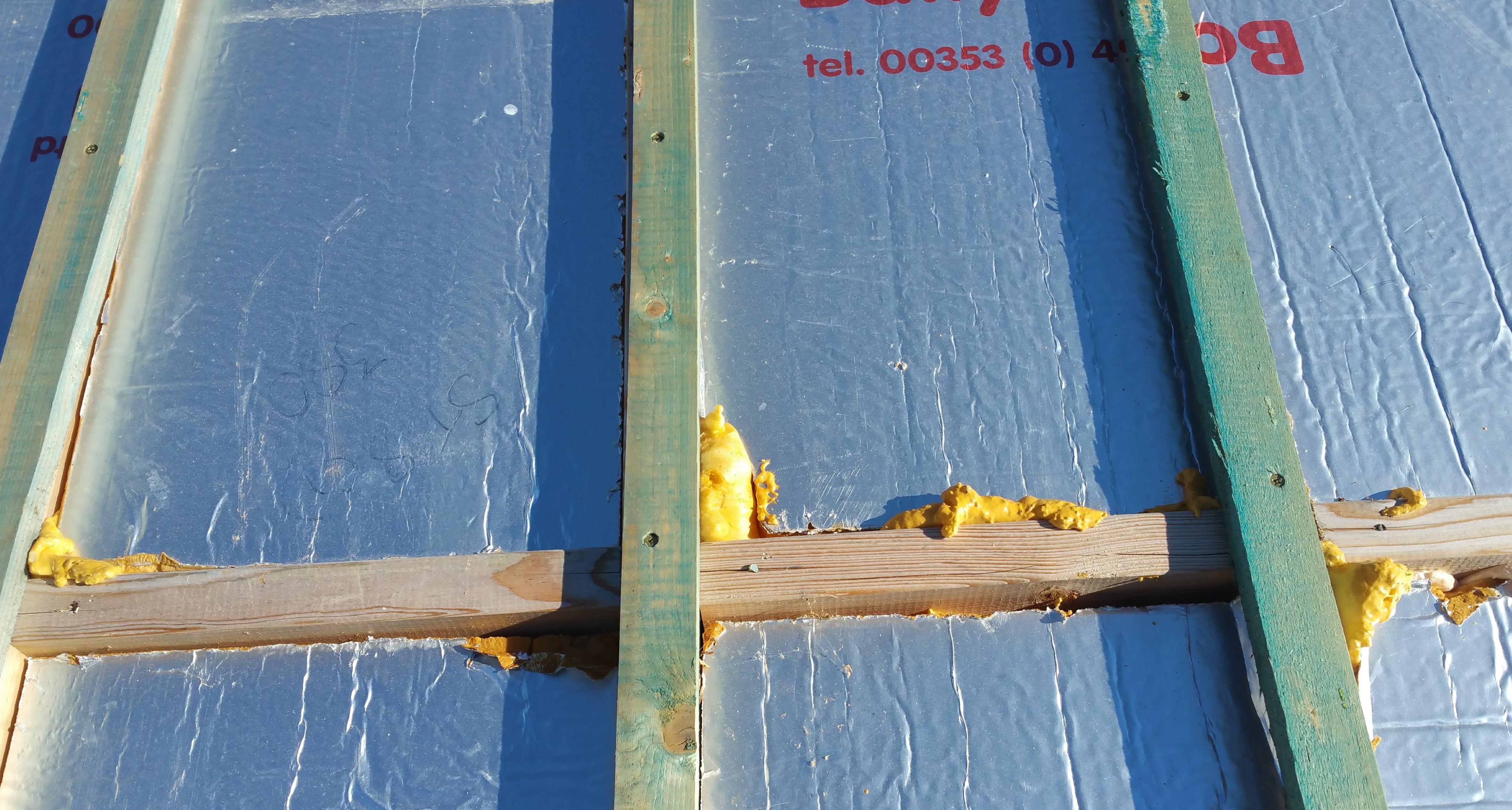

ToughButterCup Posted July 4, 2018 Posted July 4, 2018 Have a look at this. Just about finished insulating between the rafters, and putting on the counter-battens. There are bits and bats of foam in the 50mm ventilation gap. Do I need to trim the foam flush with the top of the PIR? Thanks in advance. Ian
Ian Posted July 4, 2018 Posted July 4, 2018 No you don't as it's all below the level of your breather membrane.
