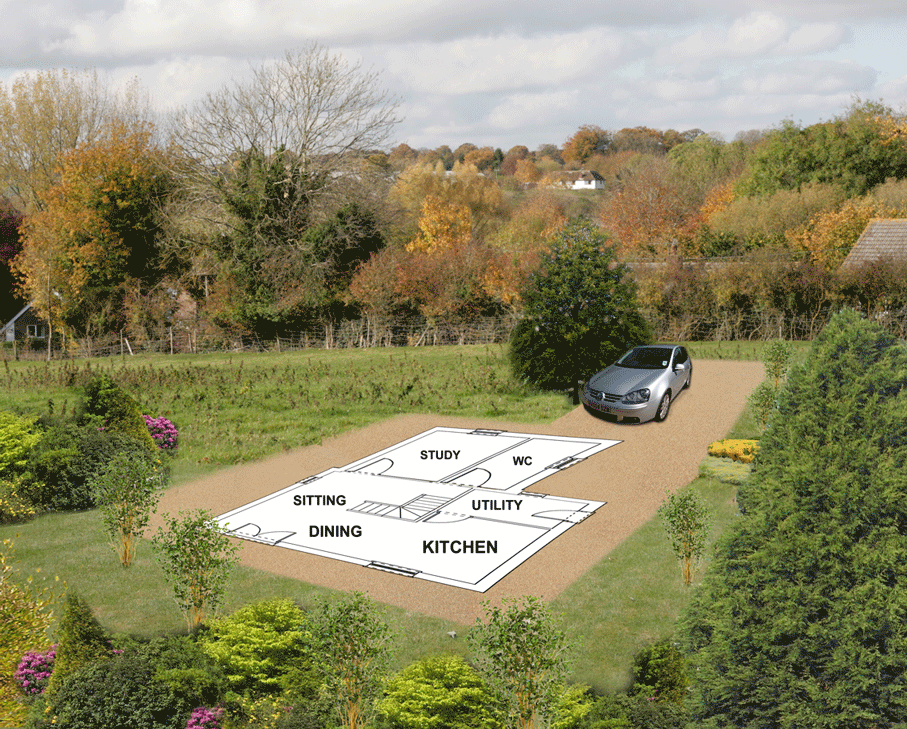

Adrian Walker Posted June 28, 2018 Share Posted June 28, 2018 (edited) Joined BuildHub last September and thought it was about time that I introduced myself. Had a small farm in Hampshire (near Stockbridge) that I sold a 5+ years ago, but kept 2 acres to build a house on. Pre-planning showed that some affordable houses would have to be part of the planning permission deal. Since then I have discovered the Passive House concept and the plan now is to build a number of Smart, ECO and affordable houses. By affordable I mean less than 80% of market rate, so about £300K. I have some very innovate building and funding ideas that I will share as the development progresses, including having identical Passive Houses built using 3 different building methods - ICF, SIP & Timber Frame. At a visit to a Passive House in Andover last November I met member Dreadnaught and I'm helping him with his project. This is a very early design (animated gif), but it gives a flavour of what I'm trying to be achieved on the site. Edited June 28, 2018 by Adrian Walker 2 Link to comment Share on other sites More sharing options...

Adrian Walker Posted June 28, 2018 Author Share Posted June 28, 2018 25 minutes ago, Declan52 said: Welcome. Are you not shooting yourself in the foot going for 3 different build methods. Surely if you pick a preferred method and get a price from a company to do shell/complete build of the 3 houses your bargaining power is much better. Nice gif never seen that before Thank you - both. The rationale for using 3 building systems is to find out which is the best system to design with, build with and most importantly how comfortable the houses are to live in. It's an experiment, the houses and occupants are monitored 24/7 to gather data and provide answers. To get a good price from suppliers you ask them if their system is the best! Link to comment Share on other sites More sharing options...
