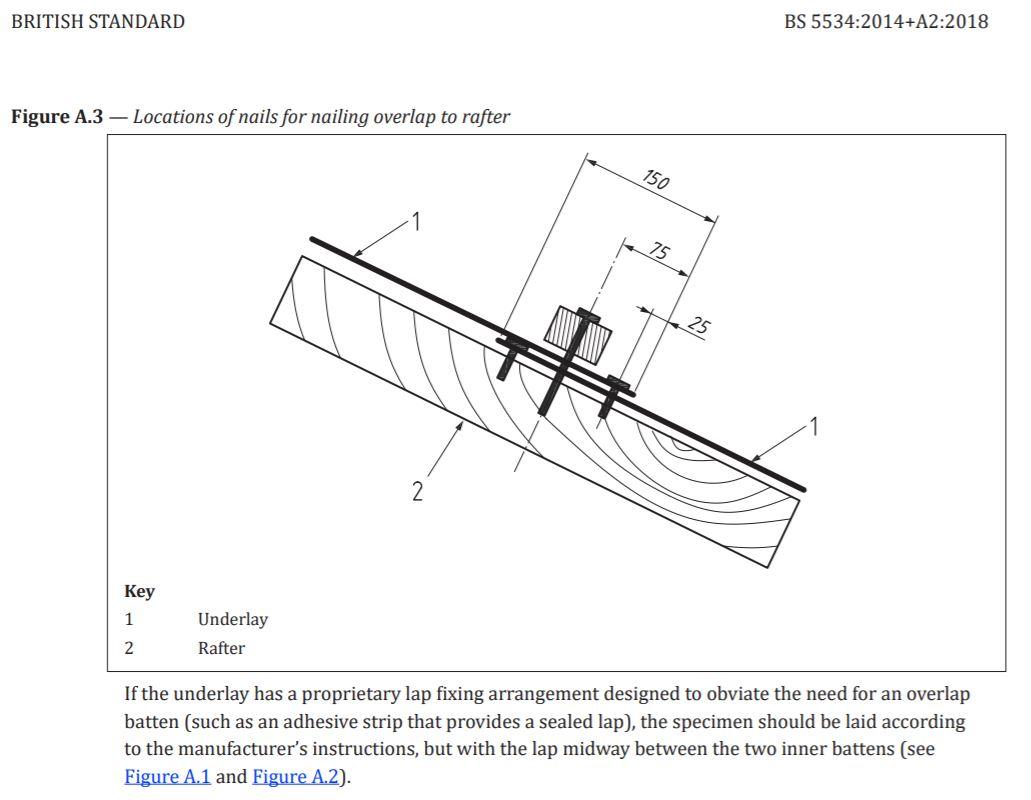

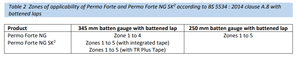

Ian Posted June 28, 2018 Share Posted June 28, 2018 7 hours ago, recoveringacademic said: Do I need to seal the overlap (150mm - proud of the fact that I worked that out for myself) between the layers of Permo Forte? Or can I let the wind blow under my skirts as it were? I would say that you definitely don't need to tape the overlaps unless your Permo Forte is also acting as your air-tightness layer. Roofing underlay performs 2 main tasks: 1) It acts as a secondary barrier to rain & snow 2) To reduce the effect of wind uplift on the roof For neither of those tasks would you need to tape the overlap joints. Normally the overlaps are dealt with by battening the lap joint. The guidance with regard to overlaps for the product is in the BBA certificate. http://klober.co.uk/media/uploads/573ef4e58dbd2.pdf Relevant extract below: Note your product is the Permo Forte NG (not the NG SK2). The SK2 version has an integrated tape and is the type of underlay you would use if you are using it as an airtightness layer. Link to comment Share on other sites More sharing options...
Ian Posted June 28, 2018 Share Posted June 28, 2018 (edited) Edit to above comments: I'm guessing that the tape can be used instead of using a batten at the overlap position. Extract from BS 5534:2014 'Slating and tiling for pitched roofs and vertical cladding — Code of practice' Edited June 28, 2018 by Ian Link to comment Share on other sites More sharing options...

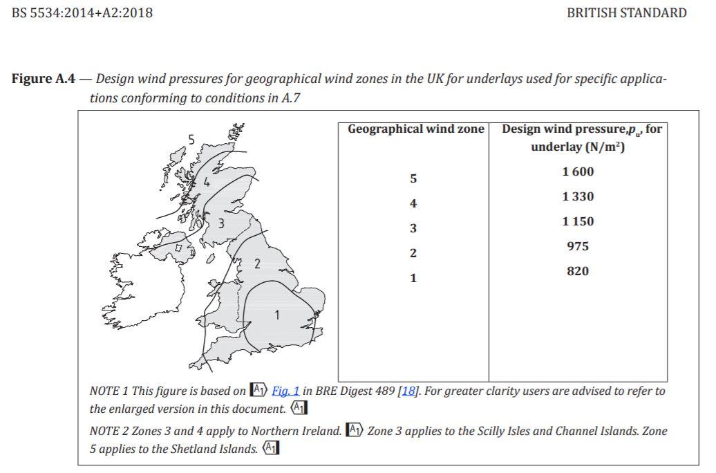

Ian Posted June 28, 2018 Share Posted June 28, 2018 (edited) and your site is zone 2 so even with local topographical anomalies you're nowhere close to the wind pressures of zone 5 Edited June 28, 2018 by Ian Link to comment Share on other sites More sharing options...
