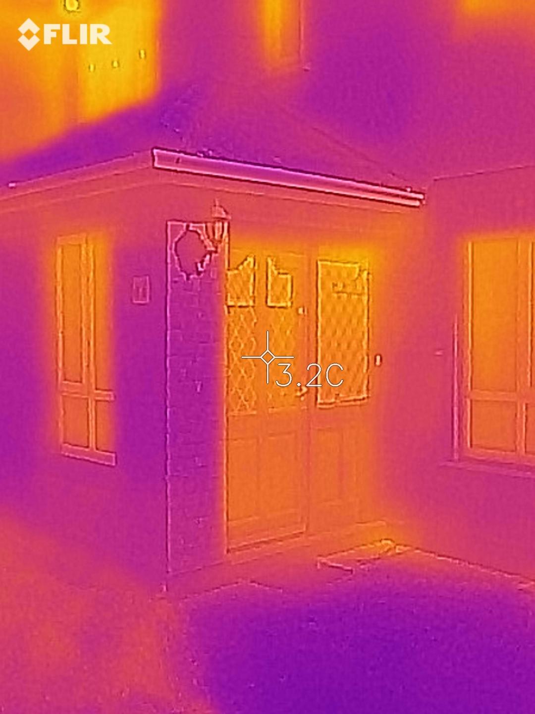

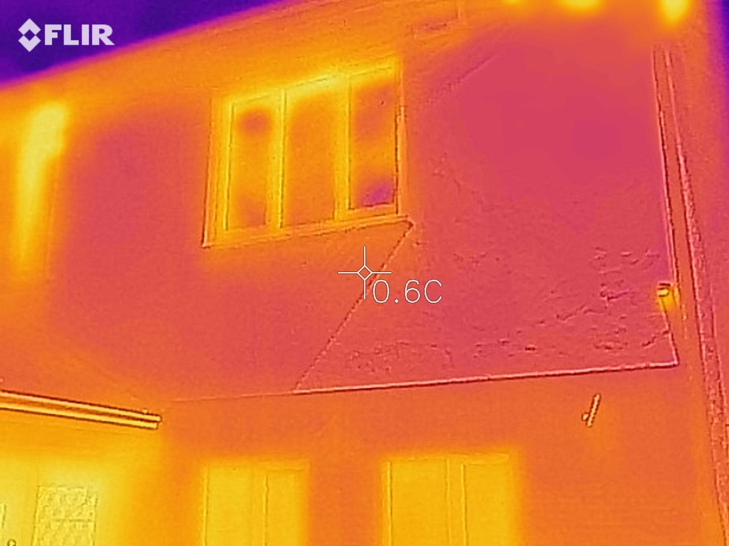

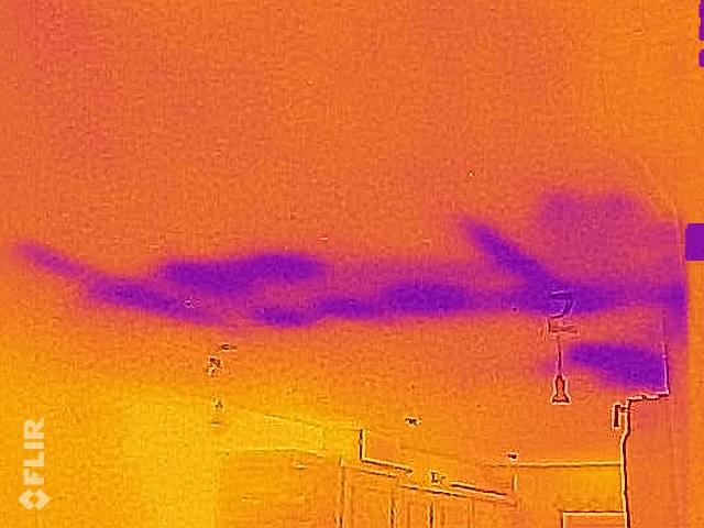

mike2016 Posted June 21, 2018 Posted June 21, 2018 I bought a Flir One for my android phone. Very nice, just had to get the right dongle (On The Go) adapter when I changed phone to USB-C. The newer one can swivel 180 degrees as some phones reverse the USB connection. Resolution is poor but good enough for the task, great for getting temperature measurements and for comparisons / gradients / cold bridges.

gravelld Posted June 27, 2018 Posted June 27, 2018 (edited) I find it's not so much the resolution as the viewing angle of the lens (I forget the proper term) that can be an issue. I used one of the dedicated units a few years ago and had to stand a good way back from the area of interest which makes it more difficult for use inside. I don't know how the modern phone-connected devices compare. @mike2016 how far away were you standing for your shots? Edited June 27, 2018 by gravelld
mike2016 Posted June 27, 2018 Posted June 27, 2018 Reasonably close, 8-10 feet in some cases, 15 feet in others to get the whole house. It should be possible to get a good shot from within most driveways I'd imagine.
