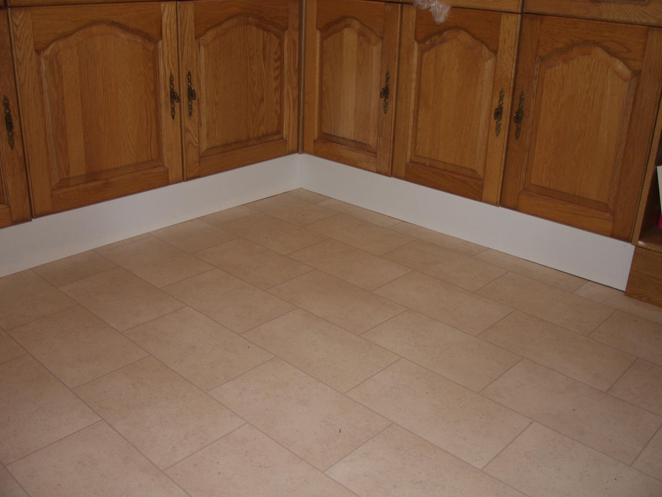

zoothorn Posted January 22, 2019 Author Share Posted January 22, 2019 (edited) Aha ok I understand the clips now.. & the magnetic catches sound useful Onoff thanks indeed for the kind offer/ will PM. I think that grade floorboard idea might let the side down a little.. altho cheap for sure. I think something a step up: any other ideas bar MDF then? pine will cup, & plastic-wood covered chipboard (stuff on before) placcy top will chip when cutting/ look bad. Progress (lino/ skirting).. but cannot get the skirting to meet bar gaps, so glueing is n/a (need help how to remedy!).. Edited January 22, 2019 by zoothorn Link to comment Share on other sites More sharing options...
Onoff Posted January 22, 2019 Share Posted January 22, 2019 Tbh that really doesn't look that bad. At this stage I would I think back off the screws and get those mitred faces pushed together and glued and pinned. Wipe off the excess glue. That will of course leave a gap to the wall. Fill with decorators caulk and smooth level with the skirting. Link to comment Share on other sites More sharing options...
zoothorn Posted January 22, 2019 Author Share Posted January 22, 2019 [Edited pic 3 above, more smart n tarty this shot] Looks better in photos tbh Onoff. Point is I can't get the mitred faces to close better than this.. at the top they only just meet on 1 of the 3 mitre joins, otherwise its clear 1-2mm gaps, which can't be closed by glue can it? Link to comment Share on other sites More sharing options...

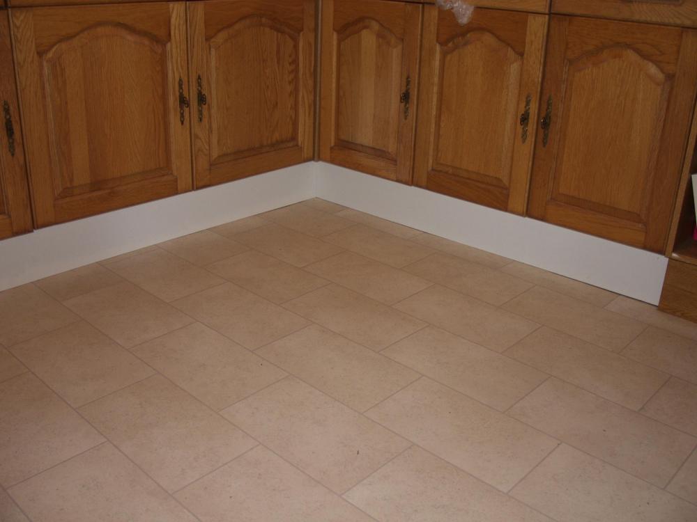

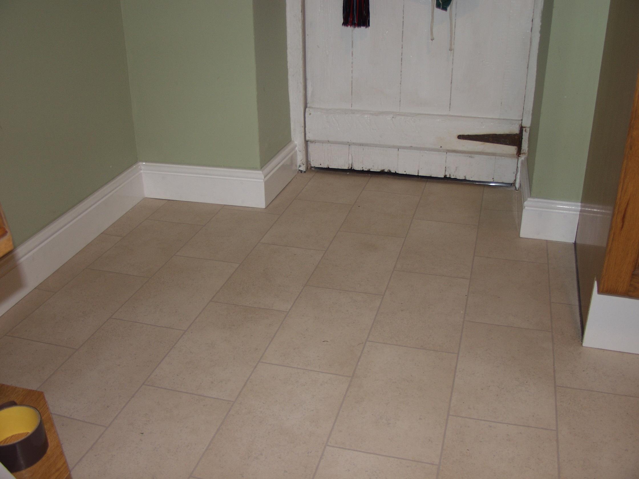

zoothorn Posted February 20, 2019 Author Share Posted February 20, 2019 Hiatus/ I ran out of motivation (skirting.. low down, back grumbles etc).. but pulled my finger out & skirting caulked/ done! & plinths sort of done too (MFC recommended by jewson's & to be honest, seems firm enough just wedged in for now). Link to comment Share on other sites More sharing options...

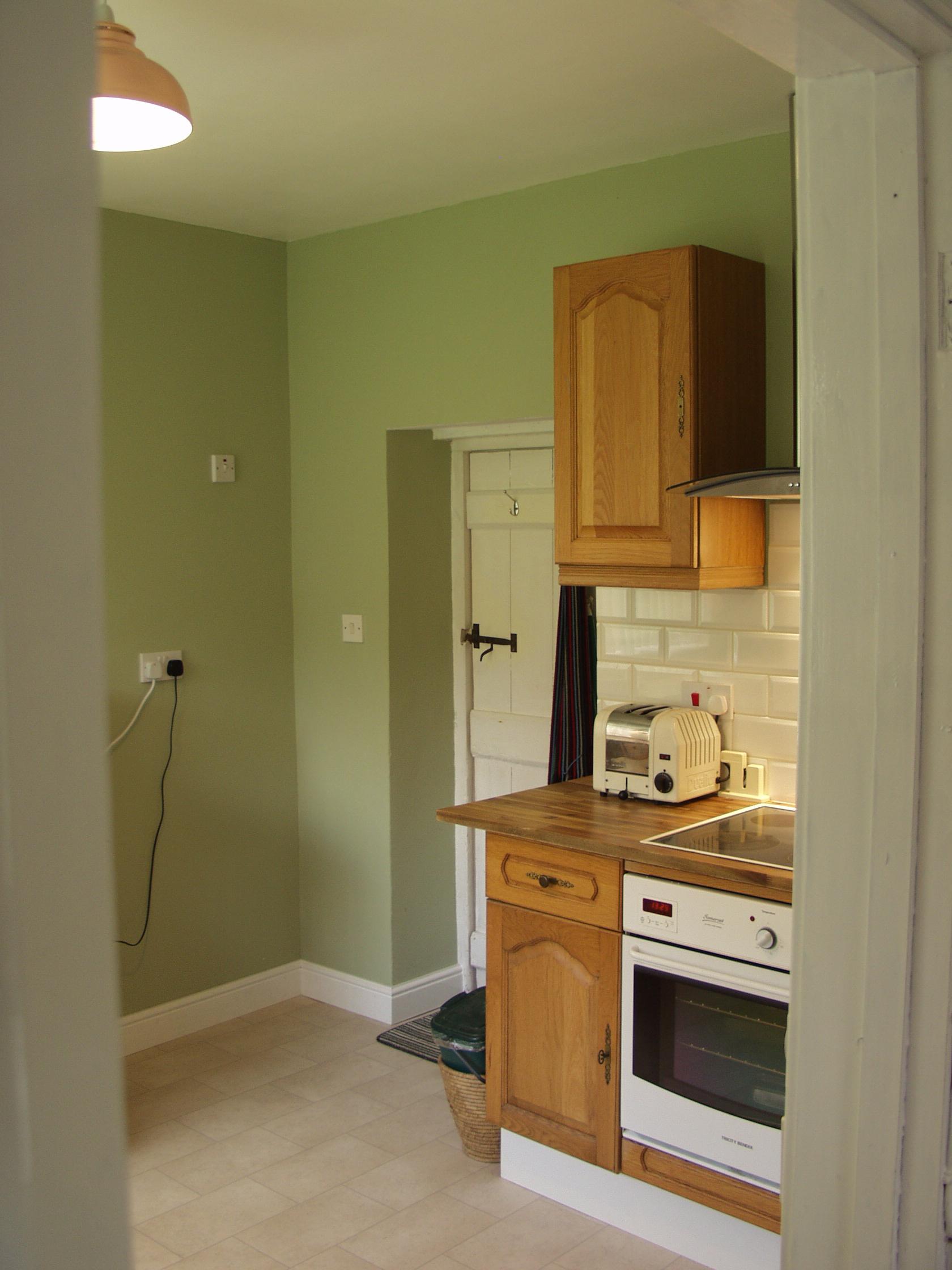

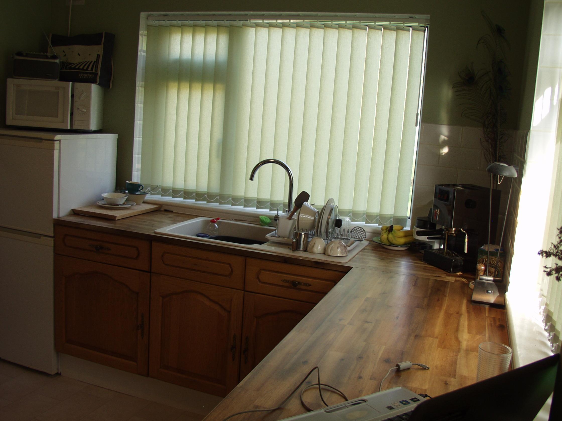

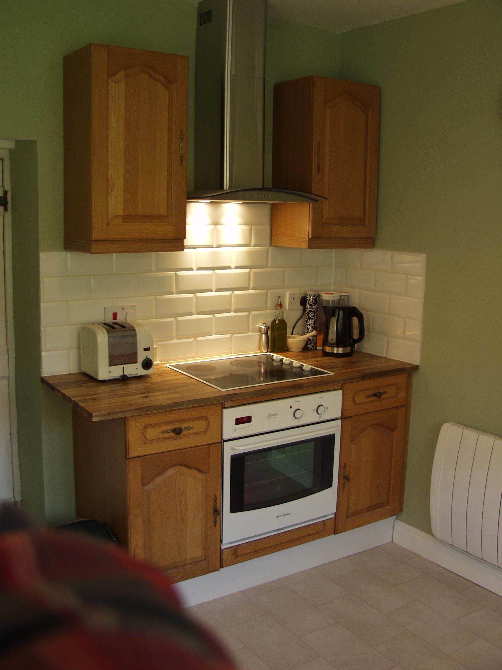

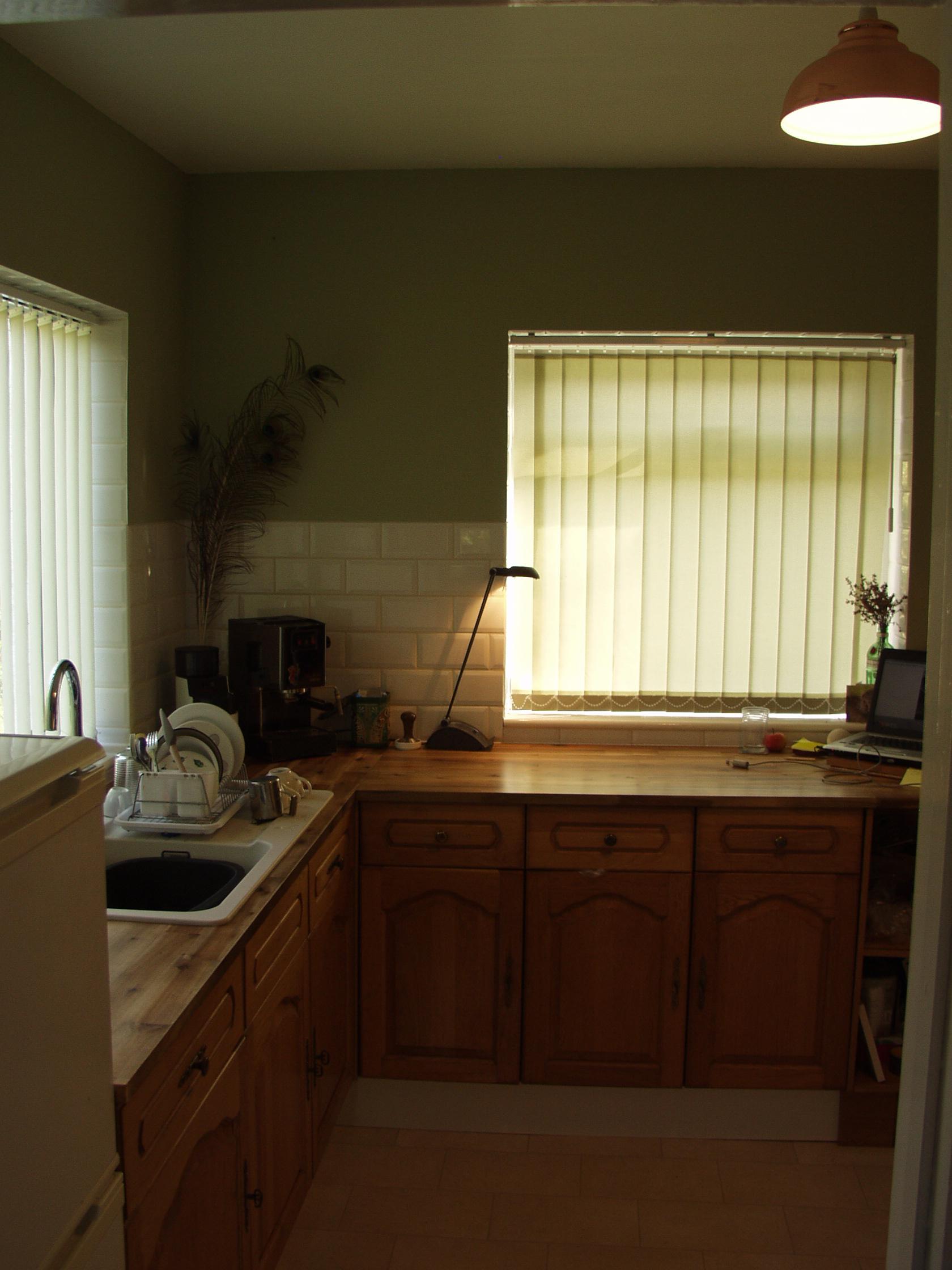

zoothorn Posted February 21, 2019 Author Share Posted February 21, 2019 I'm calling the kitchen- FINISHED godammit! (cos I'm already onto a new small job I need help on!).. & a few final pics of the results. So a -MASSIVE- thanks to Onoff (especially so).. & to PeterW, newhome, JSHarris.. & Ferdinand et al all who encouraged me with kind & helpful comments. 2 Link to comment Share on other sites More sharing options...
lizzie Posted February 21, 2019 Share Posted February 21, 2019 Congratulations @zoothorn Looks great! Link to comment Share on other sites More sharing options...
Ferdinand Posted February 21, 2019 Share Posted February 21, 2019 (edited) Looks good. Well done. The effort is always worth it, as the next one will take half the time. And you now know where some elephant traps are located. Edited February 21, 2019 by Ferdinand Link to comment Share on other sites More sharing options...
Jeremy Harris Posted February 21, 2019 Share Posted February 21, 2019 That's a pretty amazing transformation, looks great. Link to comment Share on other sites More sharing options...

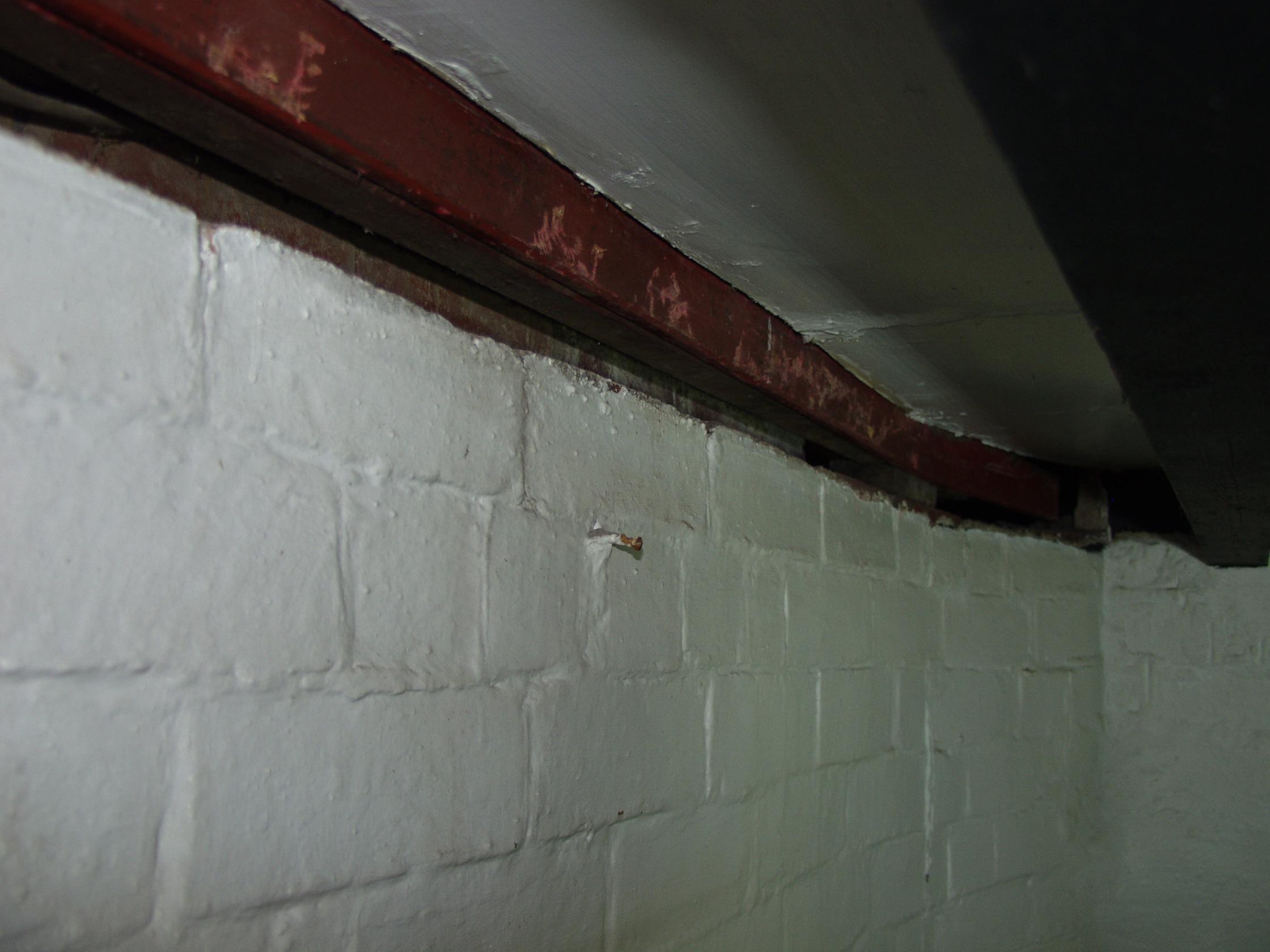

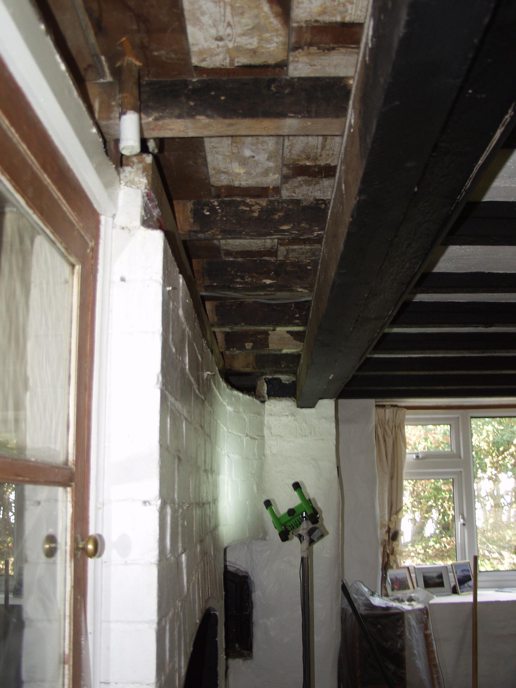

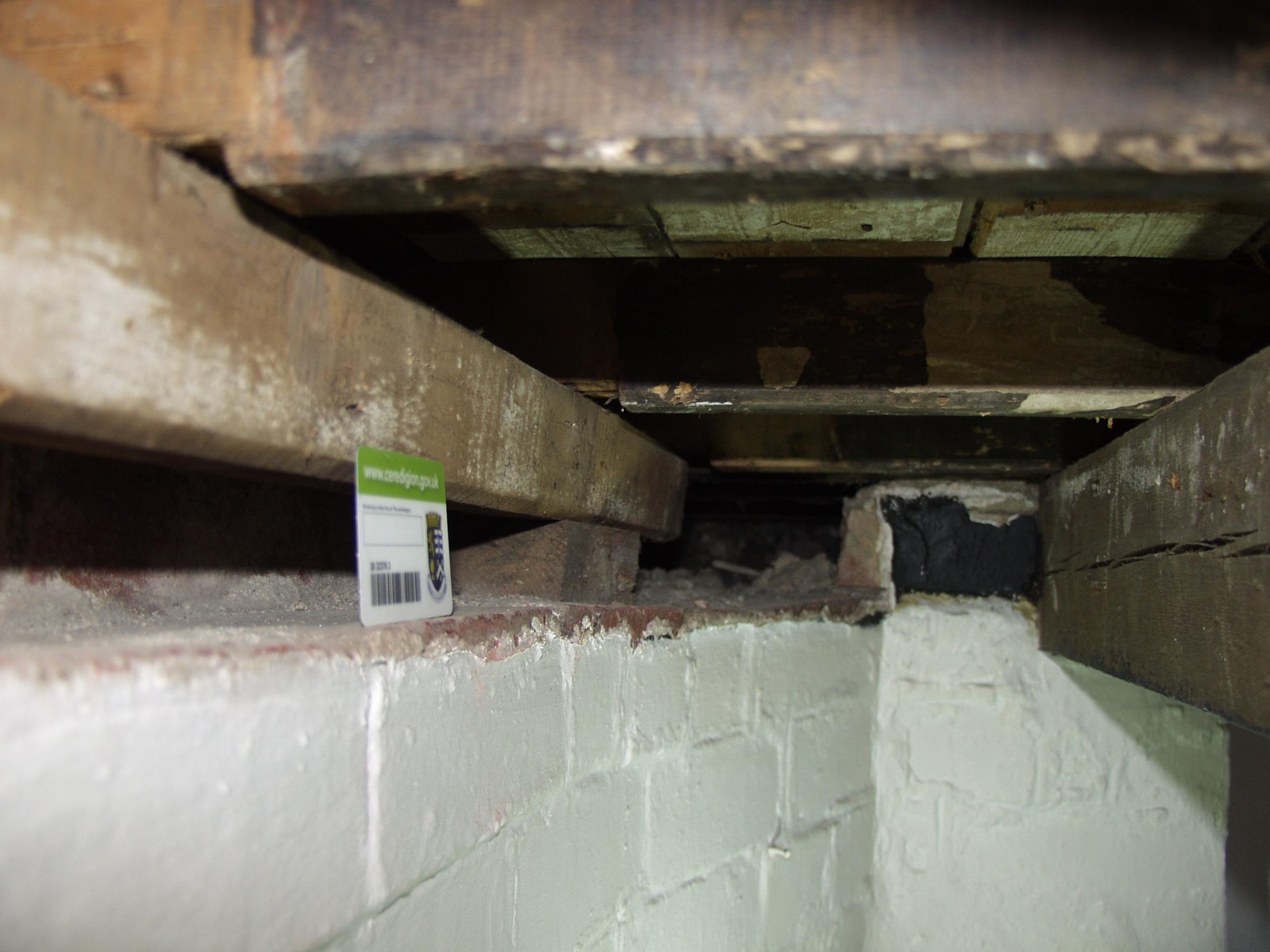

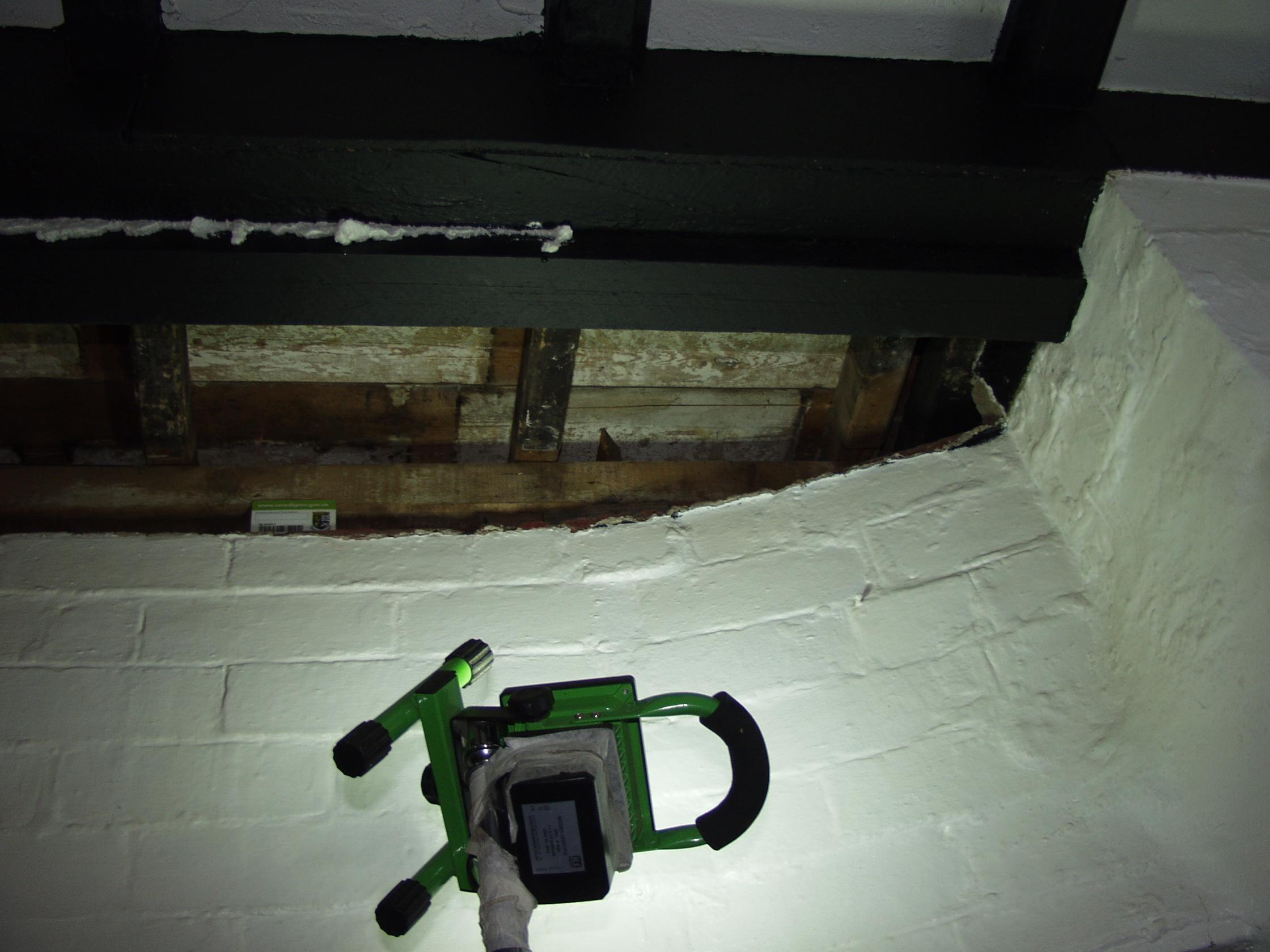

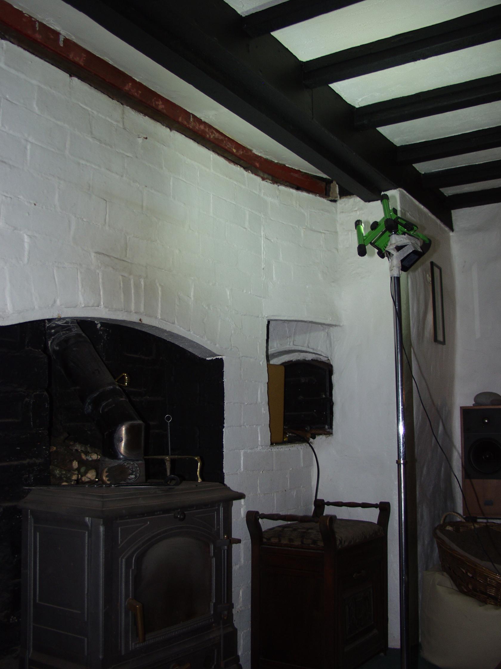

zoothorn Posted February 21, 2019 Author Share Posted February 21, 2019 So my new job. At my stove end of main room, I discovered a major cold-entry-area; I saw some gaps along top of wall & find a whole brick-high gap running right along, into a cavity above my bread-oven area [Pics 1,2]. The gap along was just covered over by painted hardboard & a wood strip (I thought I could feel a cold draught from around my head s'where!). I can get my arm right into the cavity.. but very tricky to fill it/ I can't think how: its too big for foam, & too innaccessible for PIR I'd have thought. Ive removed all the old bodged-on wood strip, crap plasterboard above [Pics 3,4] & cleaned up all ready.. for.. well, the right plan of attack is what I need help on. The gap along/ into cavity: cold funnels right down from the loft > down the upstairs wall voids > into room, a huge draught right in your face here. I've patched up smaller draughty edge gaps, but this is BIG in comparison. If I could successfully stem the cold into -here, really well plugged- it might make a significant difference. At the moment I can get the room warm, but there's a layer of cold at foot-level that lingers making one's oorse & legs nippy. Thanks, zoot Link to comment Share on other sites More sharing options...
PeterW Posted February 21, 2019 Share Posted February 21, 2019 Firstly @zoothorn that kitchen looks brilliant - you should be really chuffed ! That hole... I would look at blocks rather than brick, and you could do a quick fix using cheap thermalite blocks. They are easily cut with a handsaw and you can cut them with a slight taper to fit into the gap. Then foam any gaps or edges, smear of repair plaster over the top... Link to comment Share on other sites More sharing options...
zoothorn Posted February 21, 2019 Author Share Posted February 21, 2019 Nice one guys- I'm definitely a muppet there's no doubt Ferdinand hehe. Very appropriate end 'note' too. PeterW its gonna be a helluva fiddly pickle blocking even cut up to 1/3rds, such as the tricky gap is about 3/4 of a bricks' side high (the buisiness card is there for size reference in pics).. but extends back/ in a good arms length+ above my bread oven. I was wondering if it might be a job for rockwool? IE its malleable & I could stuff a section in, push it back, then another etc.. but I'm not familiar with it & don't know if it would facilitate plugging the draught. And between the joists, is it neccesary to insulate these ~ 1ft square areas? the edge of bedroom1 is directly above here. Thanks, zoot Link to comment Share on other sites More sharing options...
