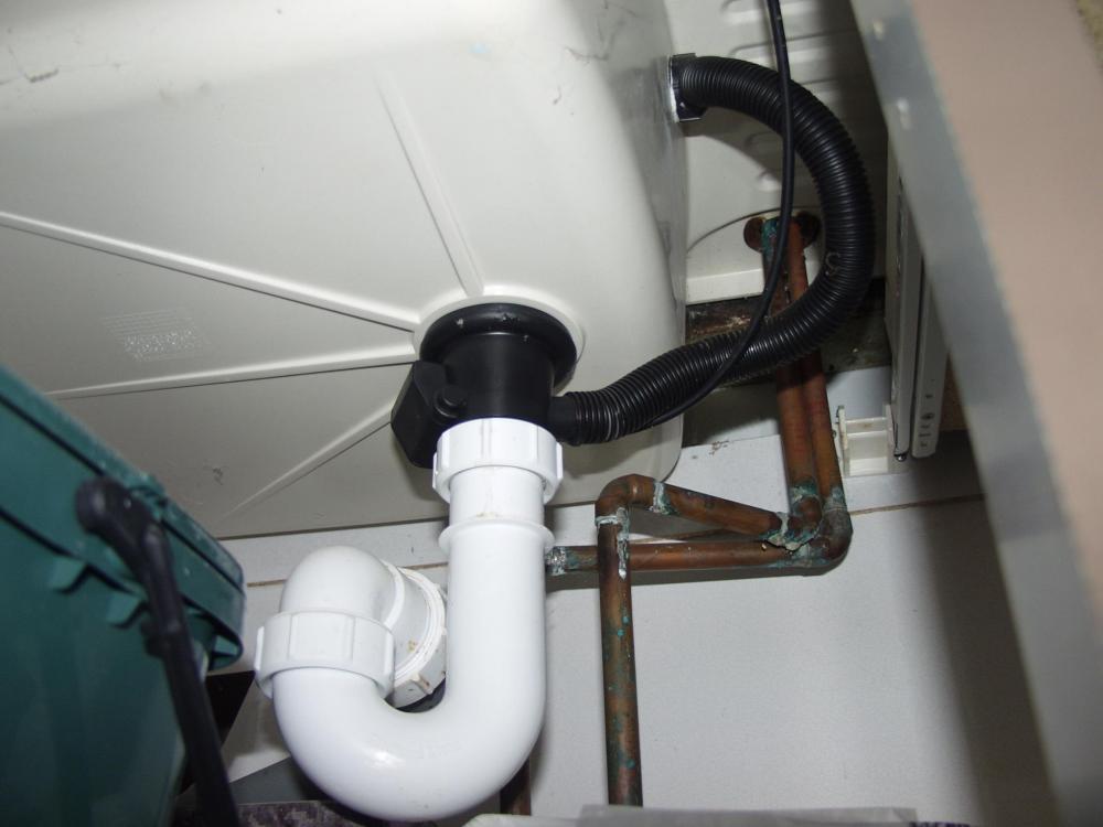

Onoff Posted September 4, 2018 Share Posted September 4, 2018 (edited) 4 hours ago, zoothorn said: I worked out o'flow thing with all my brainpower at 2am. Thankfully red bit's squashy, & just squeezes thru gap only presssing runner in a few mm's/ fine, once Id cut off a good bit of joining grey 'L' pipe/ done. This is how tight things are due to huage bowl. All in and looks nice 'n neat! Have you got a waste trap to go on? Edited September 4, 2018 by Onoff Link to comment Share on other sites More sharing options...
zoothorn Posted September 4, 2018 Author Share Posted September 4, 2018 (edited) Damn lucky I was there onoff. Its so tight fixing the sink to top will be a major headache, bowl end, but I'll cross that bridge in a while. I've scrubbed the old placcy bits, if by a trap that's the white U etc bits, & grey bits so with luck they'll get me from A to B. When its come to the few plumbing bits I've done, I dip into this chap's clips/ find he's got a stupid SOH, + professional.. a good combo/ less boring. So I've got the gist of the (waste bits) job.. the water pipes I'm still a bit unsure of tho. Taking.... my..... time..... I do apologise chaps, I know I know etc!! I got friends coming this wknd/ suddenly sprung on me.. sheesh its a pickle in here! so 2 tops to seal raw bits twice / sink to fit in / biscuit prep / fit top1 / join tops / then do the plumbing stuff MUST be done in next few days. Edited September 4, 2018 by zoothorn Link to comment Share on other sites More sharing options...

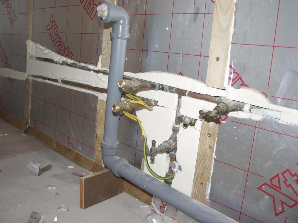

zoothorn Posted September 4, 2018 Author Share Posted September 4, 2018 1st on the job plumb Q. Trying to get grey pipe to reach white trap U section.. & not surprising can't. I can see what needs doing, which is swivel the whole grey pipe from Mickey hole around a 1/4 turn so the entrance point to the cabinet is higher. But I need to hack away at the back cab hole in a great long section to feed it in via a higher point. And also to swivel it on the Mickey hole point. Is these 2 jigs the right idea.. ? this would be simplest in terms of 1 less elbow. But Im not familiar with how these grey bits are meant to fit together. Can you just whip the straight sections out of the elbows.. & reuse the elbow, or are they fixed in to each other with a layer of glue-? Link to comment Share on other sites More sharing options...
Onoff Posted September 4, 2018 Share Posted September 4, 2018 10 minutes ago, zoothorn said: 1st on the job plumb Q. Trying to get grey pipe to reach white trap U section.. & not surprising can't. I can see what needs doing, which is swivel the whole grey pipe from Mickey hole around a 1/4 turn so the entrance point to the cabinet is higher. But I need to hack away at the back cab hole in a great long section to feed it in via a higher point. And also to swivel it on the Mickey hole point. Is these 2 jigs the right idea.. ? this would be simplest in terms of 1 less elbow. But Im not familiar with how these grey bits are meant to fit together. Can you just whip the straight sections out of the elbows.. & reuse the elbow, or are they fixed in to each other with a layer of glue-? Can you repost the photo in question to save everyone having to look back two or three pages? Link to comment Share on other sites More sharing options...

PeterW Posted September 4, 2018 Share Posted September 4, 2018 All grey push fit Pull apart, cut to length and chamfer outside edges. Bit of liquid soap on the seal and push back together. As long as it always goes downhill it doesn’t matter what it looks like. Link to comment Share on other sites More sharing options...

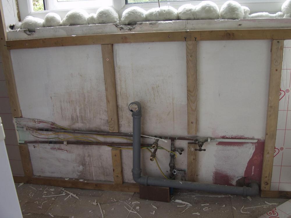

zoothorn Posted September 4, 2018 Author Share Posted September 4, 2018 Aha thanks newhome! ok looking at the 3rd pic. What I'm thinking (the simplest way to get me from pipe end here, to my new white trap section) is to swivel the whole shebang 1/8th of a turn, @ the Mickey hole point elbow. It does move a bit here. What I'm trying top establish, is whether such a swivel is normal.. or a no-no due to there having been glue or something in with the friction fit of 2 normal grey sections into each other. Here is all I need it to get to, the orange O. But do I force it up, or swivel it on Micky point.. or no-no to both ideas? Link to comment Share on other sites More sharing options...
PeterW Posted September 4, 2018 Share Posted September 4, 2018 Slack the nuts off, swing it to the left and then use one elbow to come vertical and the next horizontal and it should all push together. Link to comment Share on other sites More sharing options...
zoothorn Posted September 4, 2018 Author Share Posted September 4, 2018 Ive tried all that Peter, but Ive come to this ^ conclusion as to the only way I can join these 2. When you say slack the nuts off, you mean the whites..? there don't appear to be any on the grey bits, orare there-? Link to comment Share on other sites More sharing options...
newhome Posted September 4, 2018 Share Posted September 4, 2018 White nuts need to slack off. I've done this job in my house. Took me fecking hours to get it all together so I feel your pain . Someone else would have done it in seconds I'm sure! Link to comment Share on other sites More sharing options...
zoothorn Posted September 4, 2018 Author Share Posted September 4, 2018 But I have slacked the nuts off. If I swing the whole white shebang round a bit.. the no ammount of 90* elbows will be able to span the angle. Plus its only about 3" higher that the pipe its gotta meet.. an elbow + a section of pipe, is far more than 3".. so won't meet. If I swing the whole thing round 90* the grey is facing twds me/ then when I tip the tub out in the sink, & then go 'downstairs'.. it all hits me in the face. Link to comment Share on other sites More sharing options...
PeterW Posted September 4, 2018 Share Posted September 4, 2018 How many grey elbows have you got ..? Link to comment Share on other sites More sharing options...
PeterW Posted September 4, 2018 Share Posted September 4, 2018 You can do that with 2 elbows btw first is out of wall, facing 30 degrees or so up. Then swing the trap so it’s parallel to cupboard and then turn the outlet to face the wall. Second elbow into the trap socket facing 30 degrees down, join with a pipe. Link to comment Share on other sites More sharing options...
