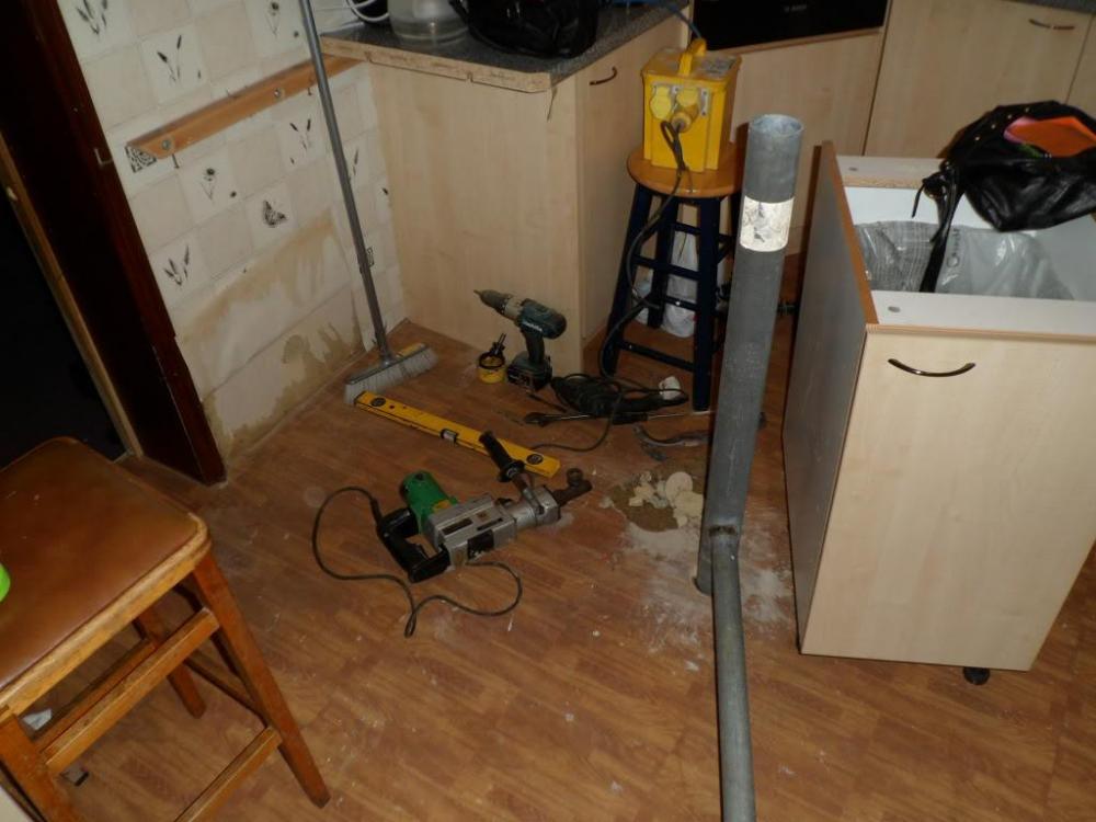

Onoff Posted June 22, 2018 Posted June 22, 2018 Just realised our old breakfast bar was 500mm wide, cut from a random bit of someone's cast off 600mm one. 250mm radiused one end so straight sides. The top was I think covered in Fablon and I edged it in white pvc trunking lid! Found an old pic when making the current bar leg and foot rest. You can see the jig cut, pocketed and biscuit jointed end:
