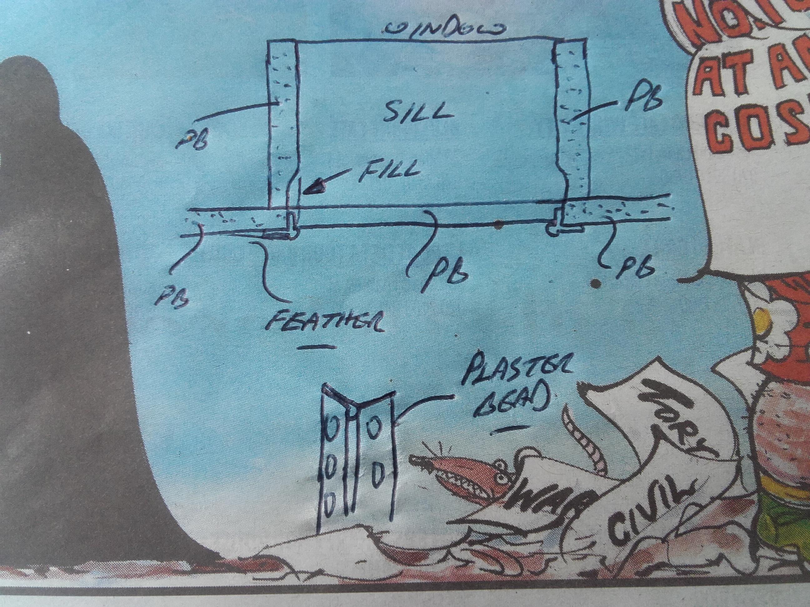

Onoff Posted August 10, 2018 Share Posted August 10, 2018 Ref finishing the reveal. You'll have presumably the sides and top to do if you're refitting a wood sill. (Only paper I have to hand is the Metro and a Boris Johnson cartoon). Anyway, this thread can't get any more mental: As above you could use plaster beads. Depending on whether you've a tapered edge meeting a square edge, a tapered meeting a taper or two square edges meeting you either fill level or fill and feather it in. Link to comment Share on other sites More sharing options...
