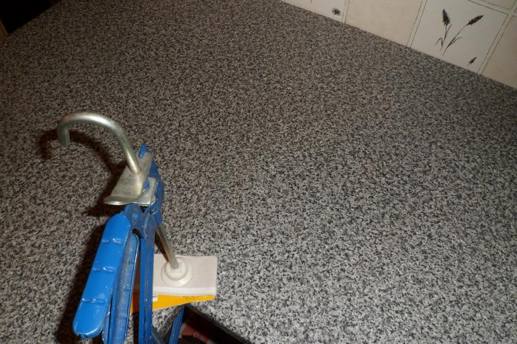

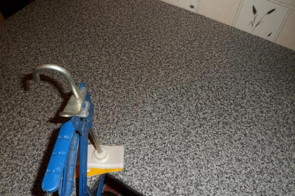

zoothorn Posted June 20, 2018 Author Posted June 20, 2018 4 minutes ago, PeterW said: If you look at the pics it shows you the cuts - you need to do an inset 45 degree cut on bullnose worktop otherwise you end up with an open join on a 90 degree corner. Ive looked it over but cant see what abc is or for on it. I can see, I think with the grey shapes I assume worktop shapes to ultimately achieve by using it, but cannot correspond these results to the jig. I mean what's the hole with '35mm' next to it for? why are there funny shapes to it at btm, one side of straight bit is funny angled. Its just kinda funny lookin.

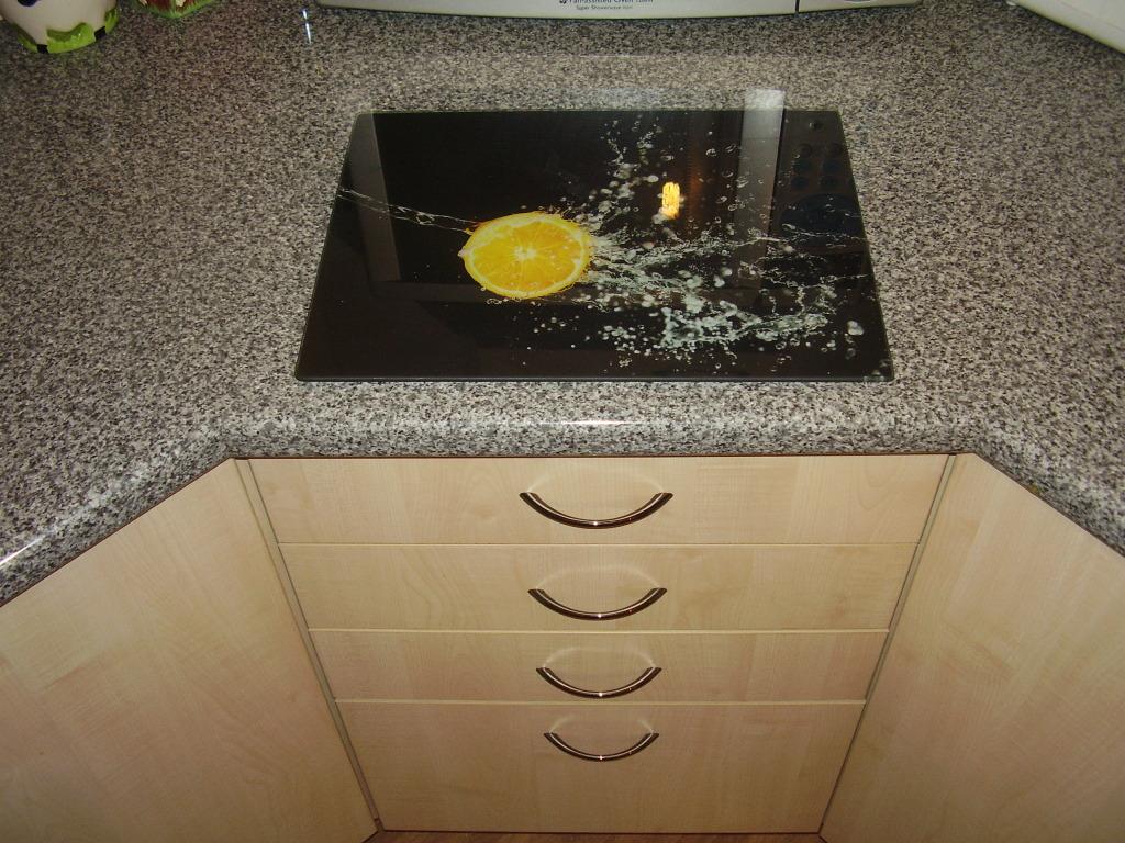

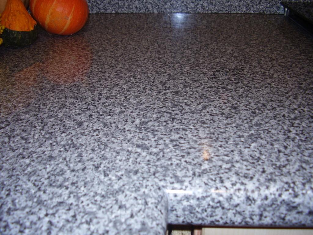

Onoff Posted June 20, 2018 Posted June 20, 2018 There's a fair chance your walls won't be at 90o so doing a 45o isn't quite as simple. Ideally you lay one board on the units against the wall, lay the other one atop it against it's wall - both overlength and split the difference. A bit of a pig to mark out first time. Can be done though. Mine / acceptable:
zoothorn Posted June 20, 2018 Author Posted June 20, 2018 (edited) Onoff looks terrific, but I cant see an L shape there.. but a more complicated 3-way/ section affair. How is a 45* join made, using the jig whatnot's 45* whatsit? Edited June 20, 2018 by zoothorn
Onoff Posted June 20, 2018 Posted June 20, 2018 (edited) 47 minutes ago, zoothorn said: Onoff looks terrific, but I cant see an L shape there.. but a more complicated 3-way/ section affair. How is a 45* join made, using the jig whatnot's 45* whatsit? Just showing you can make a join without a jig. For your right angle buy a jig. I'm the King of being told how to do something and going my own way btw so if I say buy a jig...buy a jig. 1) It's neater 2) Doing it at 45 and you'll need an extra 600mm+ of worktop anyway. That'll cost you more than a £16 jig. A couple more of mine done with a jig: If you're really cheap...worktop corner trim. Wickes, B&Q etc: Edited June 20, 2018 by Onoff
zoothorn Posted June 20, 2018 Author Posted June 20, 2018 Ah I see what you mean re. the 3-way one.. ggod job. But why if this is so good, would I need a jig though? the jig one you did is the one I -can- see the join of. the very cheek I know. Tbh Im not sure I actually like these mitre joins myself. I can't see the design point of them. They're certainly not 'lookers' are they? or is the idea they're meant to be more or if not all invisible done this way? Im weighing up between 'better job' of a square edged worktop, router a round edg &/ add trim (not too disimilar to some of my work, so prob do ok 1st time.. tho the pivot point hole Im trying to figure out how w'out making a hole in worktop surface) & joining either mitred or 45*. Or keep the wood edge & base of tops as they are, remove tiles/ fill in with some of JSHarris' suggested bathroom board stuff.. or something VG quality. Thing with buying jig is literally the one join I'll ever do with it is this L join. Then its redundant. can the 45* join be done without a jig? can the rebated underside bits for the clampy whatnots be done without a jig?

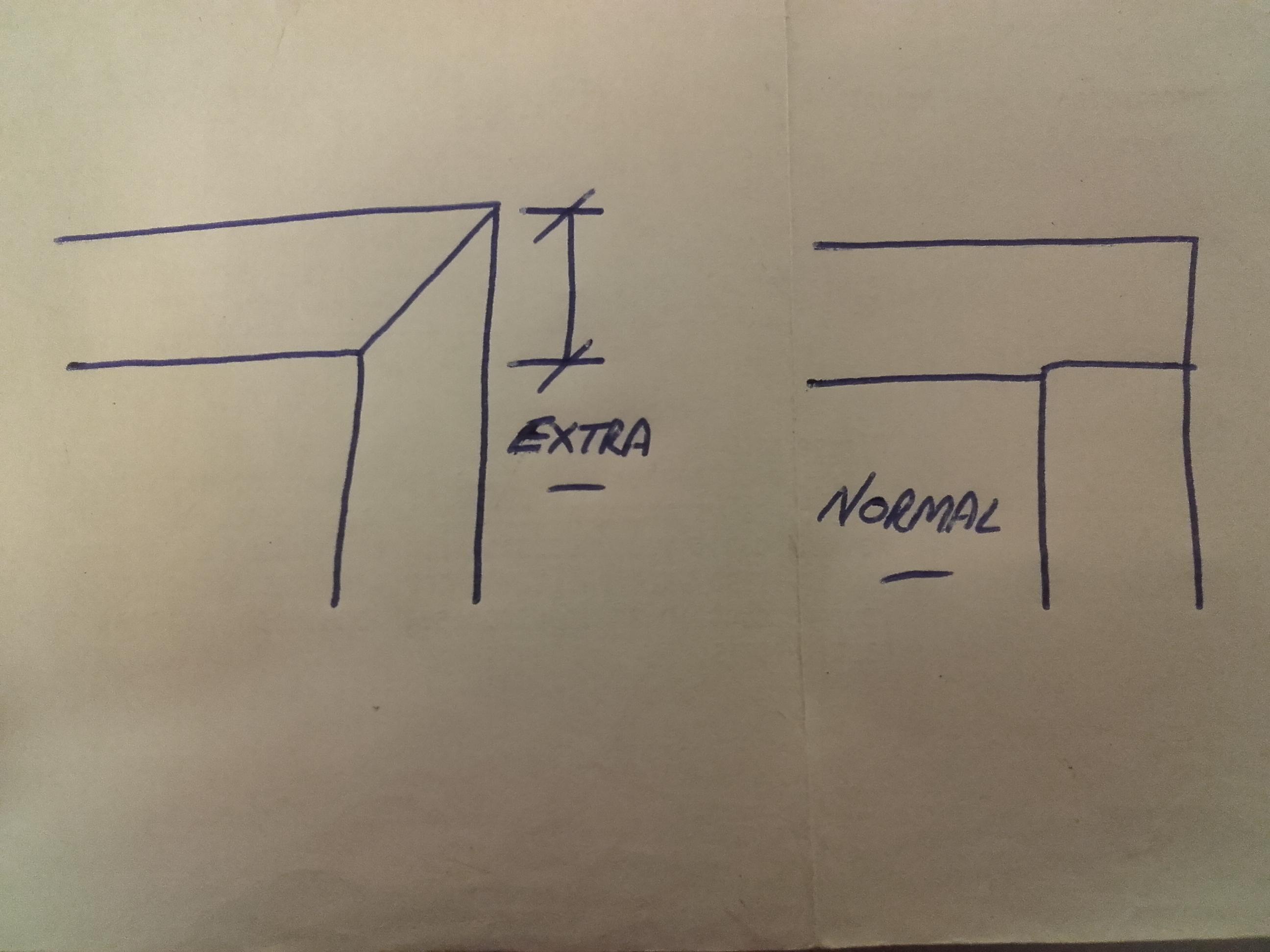

Onoff Posted June 22, 2018 Posted June 22, 2018 (edited) You can do a 90deg corner as 2 45deg cuts. You will need an extra +600mm extra worktop on one leg to do this. I was lucky as two 3m worktops came with slight damage and got replaced. I got to keep the damaged bits so had extra to play with. With a plain finish you will see this more than one like mine. You should still biscuit and pocket such a join imo. A 45 join will be a longer join for water to potentially get under. You will likely notice where the two woktops meet in the internal corner more than with a jig. You can make a simple jig from scrap to do the pockets underneath. 99.9% of people use a jig for a 90. If you don't you're going against the grain. If you want to route a radius on that corner you just turn the worktop upside down and centre it on the "cardboard" side. You risk "breakout" one end of the cut. At the price for that jig Peter posted you could likely use it then sell on eBay and get your money back. You're not by any chance after my Procrastination Crown are you? Edited June 22, 2018 by Onoff
