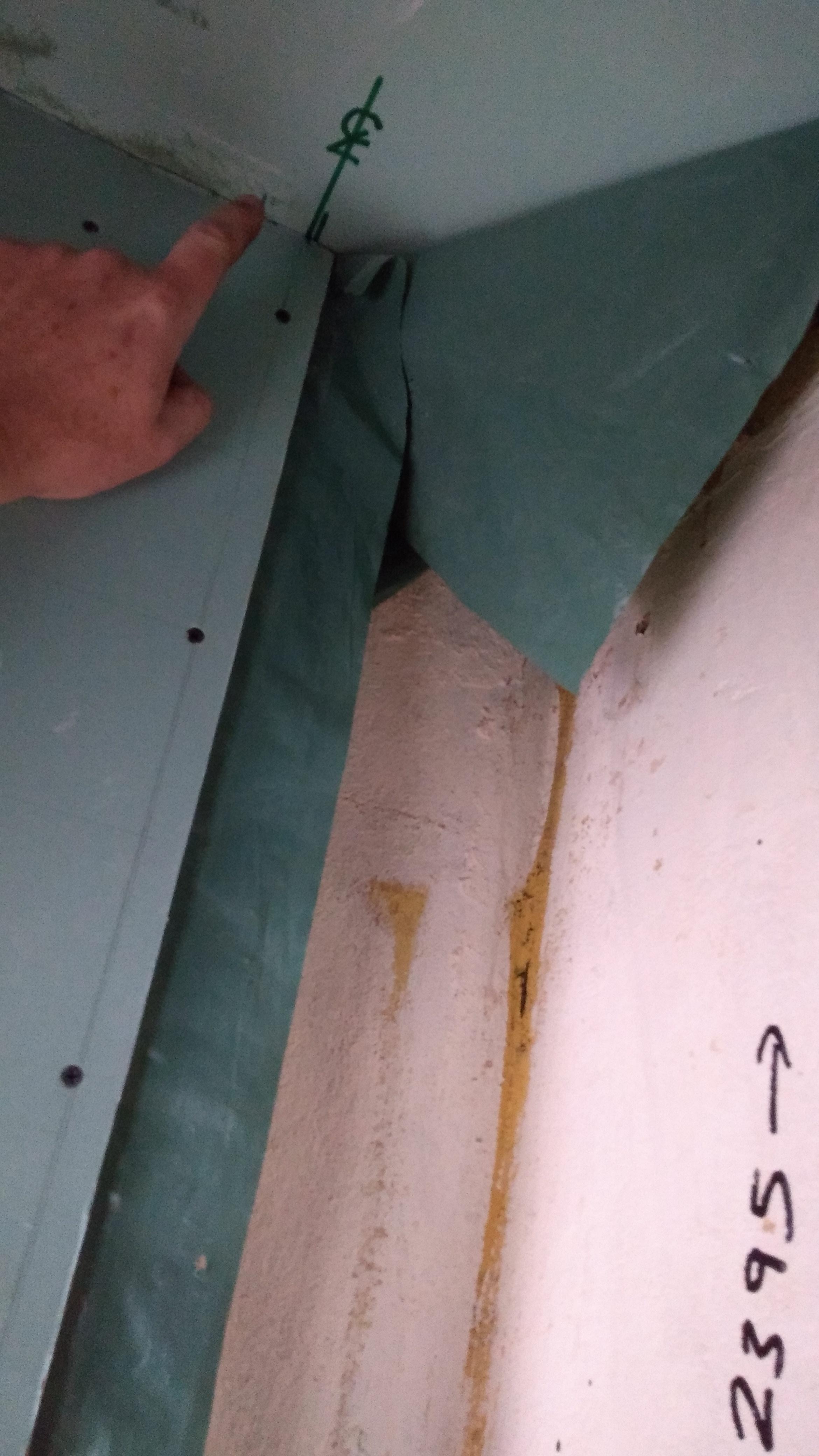

Onoff Posted July 28, 2018 Share Posted July 28, 2018 @zoothorn, the floor in this room you're doing... I assume this is the badly done, "modern" extension that you're battening out, so it has a damp course in the walls and damp proof membrane under the floor? Get the gaps round that window sorted and it should help a great deal. It amazed me how I could feel the draught through the tiniest of holes when I was blocking things up. In fact as the gaps to fill got smaller it seemed to concentrate the cold air blowing through! Link to comment Share on other sites More sharing options...

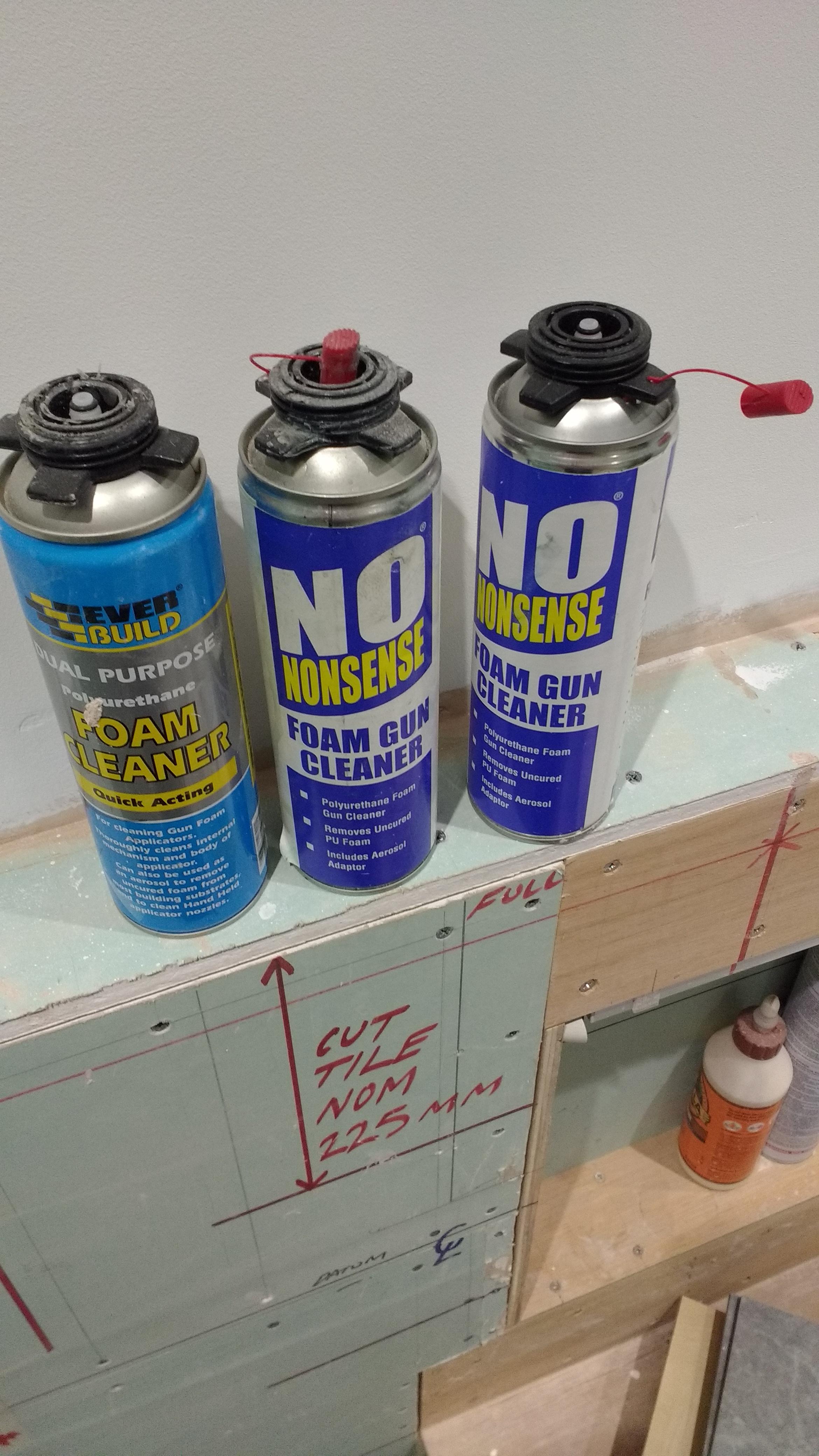

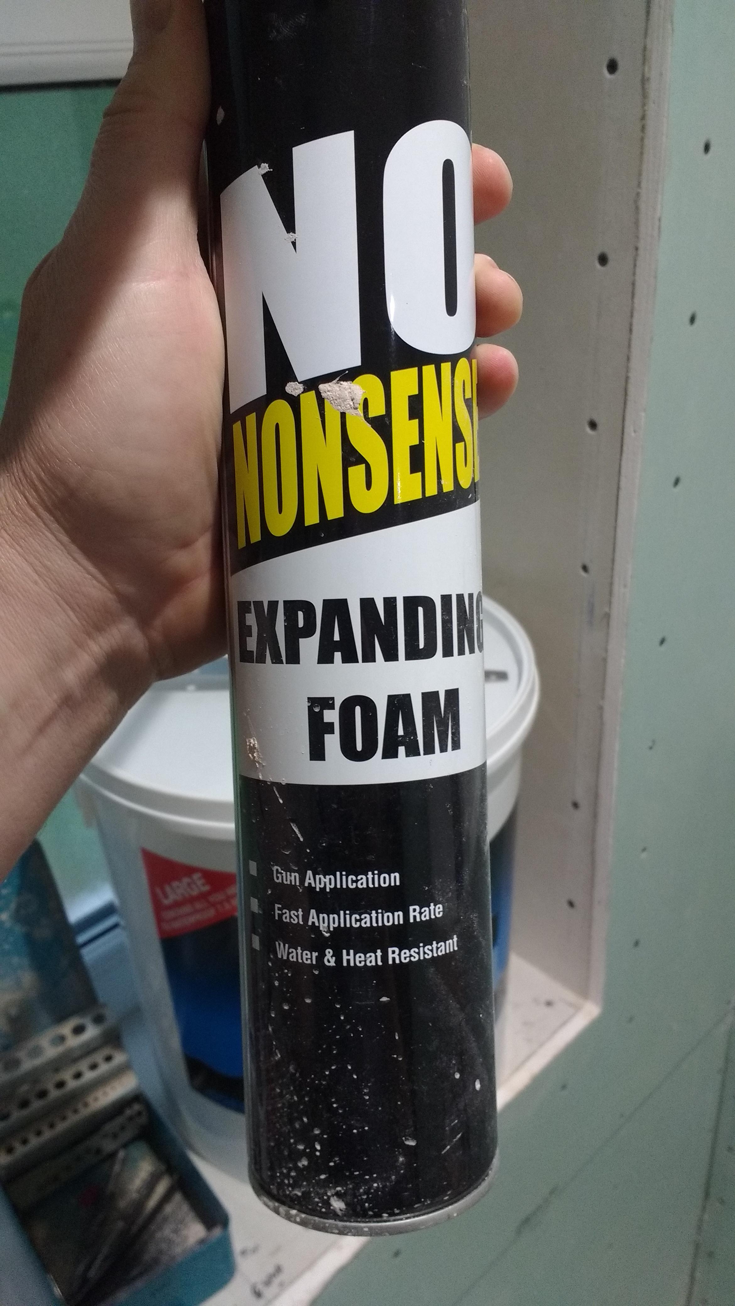

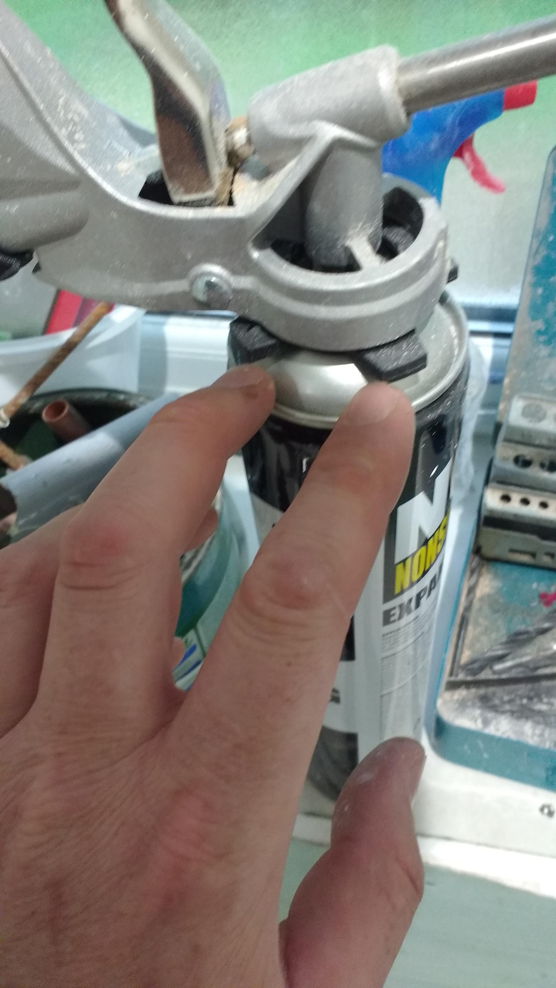

zoothorn Posted July 29, 2018 Author Share Posted July 29, 2018 All good info onoff taking on board- I just got back from town to get a screwfix gun, but just read these ^ replies: so, have I got the right no-nonsense can for it? I don't know now. I had this before/ a std foam with the std straw attatchment. The gun specs said it goes with normal cans.. so what's what I'm not sure now. Had planned to do this job today you see. I notice on your reveal pics a blue dpc involved: as you can see from mine, looking in my draughty sill gap I don't see this. What should I do? Link to comment Share on other sites More sharing options...
newhome Posted July 29, 2018 Share Posted July 29, 2018 39 minutes ago, zoothorn said: I notice on your reveal pics a blue dpc involved: as you can see from mine, looking in my draughty sill gap I don't see this. What should I do? @Onoff added the blue dpc after addressing the gaps around the window and before plasterboarding so you should be good to go in getting your gaps / draught sorted today. I think he said somewhere that you could even use rubble sacks for the dpm. Link to comment Share on other sites More sharing options...
Onoff Posted July 29, 2018 Share Posted July 29, 2018 1 hour ago, zoothorn said: All good info onoff taking on board- I just got back from town to get a screwfix gun, but just read these ^ replies: so, have I got the right no-nonsense can for it? I don't know now. I had this before/ a std foam with the std straw attatchment. The gun specs said it goes with normal cans.. so what's what I'm not sure now. Had planned to do this job today you see. I notice on your reveal pics a blue dpc involved: as you can see from mine, looking in my draughty sill gap I don't see this. What should I do? If you have a foam gun you need "gun grade" foam. Look thru the Screwfix book and there'll often be a price for handheld or gun grade. Cans to screw on the guns have a 4 prong plastic bit on top. My fingers on two of the plastic bits: The top of the gun grade cans looks the same as on these cans of gun cleaner: One on the left is from T'station others are Screwfix No Nonsense brand. They come with the little red nozzle. You can either use as a conventional aerosol or screw onto the foam gun to clean it out. This is Screwfix own brand gun grade foam. It's cheap. It expands...a lot...as I guess it's meant to! This is Soudal Low Expansion foam, better than the Screwfix one for sticking things on etc as well as not expanding so much: https://www.screwfix.com/p/soudal-soudafoam-expanding-foam-gun-grade-750ml/5026d Ref the blue dpm, over my battening I did the walls and ceiling with a continuous membrane or vapour control layer as a nod to draught proofing. Link to comment Share on other sites More sharing options...
zoothorn Posted July 29, 2018 Author Share Posted July 29, 2018 Damn got wrong foam then. Ok to planB: I'll have to try do the job with my foam & its sh*tty attatchment even if it can only be used for the sill job. So here's the wall done so far.. alas there'll be some in/ out PB variation over the battens.. but impossible for me to shim to level unless a days more spent on it (the wall badly fluctuated b4/ Ive done pretty well to level out some of it I think).. at least the units will hide alot. I'm going back over your 27mm insulated PB info/ pics.. maybe this is the way to go if £feasable for a small area. Onoff is it definite neccessary I use a dpc on the sill job?? I understand what they're for etc.. its just that this is a renovation rather than a build, ie, it had no dpc issue before, or any evidence of damp after recent rain. And yours is a continuation of the walls' dpc which looks like the latter stages of a complete build, unlike mine. thx zoothornrollo Link to comment Share on other sites More sharing options...
