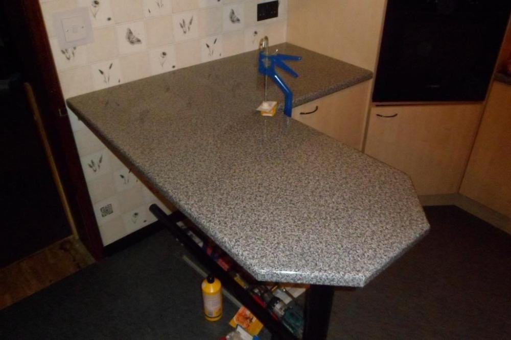

zoothorn Posted June 19, 2018 Posted June 19, 2018 Hi chaps- If you can help: I have generally a bad 80's-diy-disater kitchen, some of I'll be keeping (due to ultra-tight budget).. to revamp myself. To replace 1st: 2 worktops, tricky one is L-shaped, with this (foreground) 45*-off end section being the headache- how. And the join to make 'L'. Is a rounded edge possible instead here? I'm talking 44mm basic worktop, not granite or any fancier stuff. Thanks, zoot
cherryfountain Posted June 19, 2018 Posted June 19, 2018 This job would be straightforward for a kitchen installer. The corner mitre is no problem if you have the right worktop jig and router. If you are fitting it yourself, without this equipment, the only other option would be a metal corner jointing strip, which would give an inferior finish. All bare chipboard needs to be sealed before joining, as ingress of water would soon cause blown joints. If you, or a fitter, intend to use 40mm rounded edge worktops, both ends would need to be routed square and finished with a glued-on laminate strip. The ends therefore would be square edged. Also, I assume a new sink would be fitted, which would involve a sink cutout by jigsaw and, most likely would involve replumbing with alterations to the hot, cold and waste. The other thing to check is the worktop depth. They come in 600 and 616, and 665 and 900 double post-formed. Length 3.6m and 4.1m. Plus you will need the laminate strip for the ends.
zoothorn Posted June 19, 2018 Author Posted June 19, 2018 Hi cherryF.. I have a router/ use frequently, but not a 'worktop jig'.. what is this exactly? anything I can make? I can fit/ jigsaw a new sink into a top/ placcy plumbing bits & a few compression joints I can do ok. Im pretty sure of this bit. Due to the L shape/ I assume a tricky 45* joining of 2 sections at the top (I could do underside if just router work) & this odd cut off edge bit in foreground.. would you suggest its a kitchen fitter job do the lot?

newhome Posted June 19, 2018 Posted June 19, 2018 About 25 years ago we refitted the kitchen and ordered standard worktops from one of the sheds. We then took it to a local joiner who cut the joint for us. It was much easier than trying to buy the right kit and doing it ourselves. Alternatively you could buy the worktop from a company that offers such a service like the one below: http://www.worktop-express.co.uk/information_guides/masons-mitre-joints-kitchen-worktops-worktop-express-nutshell-guide/ As far as how far to go with your kitchen refit you need to ask yourself whether you are happy to live with the doors and drawers that you have and the configuration of units that you have. If the answer to that question is yes, then you can work on a makeover with new plinths, worktop, tiles, and sink (for example). You can rub down and paint the doors if you fancy a colour change. There are lots of videos and links on how to do that if you google. You should easily be able to buy replacement kitchen drawer boxes as needed, and shelving, plinths etc too. If you can’t live with your doors etc then consider ripping it out and starting from scratch. In this case it’s worth keeping your eye on Gumtree, eBay and the local Facebook selling sites as you can often pick up kitchen units for next to nothing when people decide to refit their kitchen that could be pretty decent still. So no definite answer. You have some choices to make

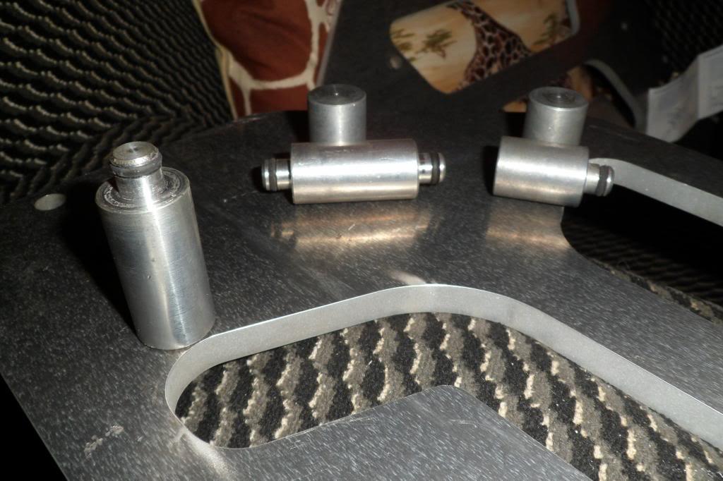

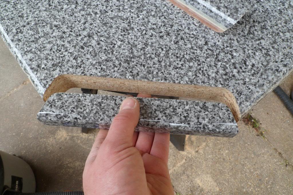

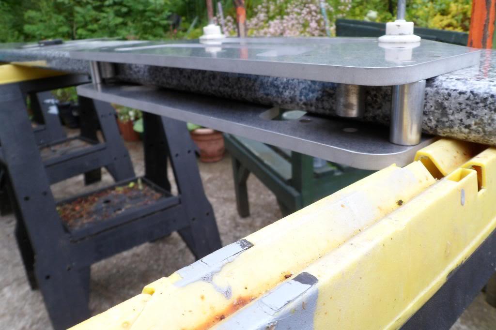

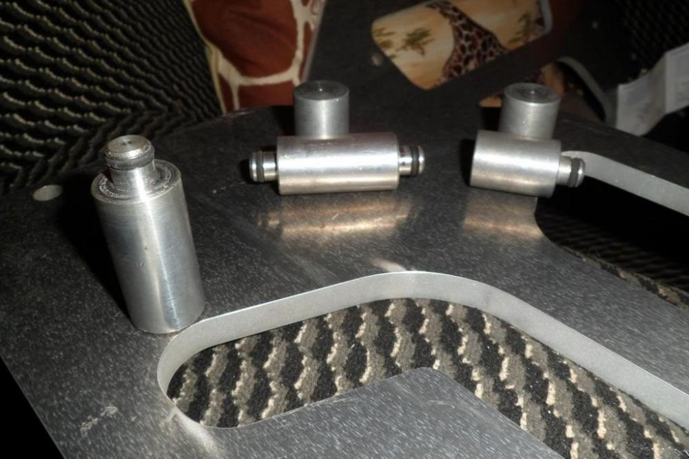

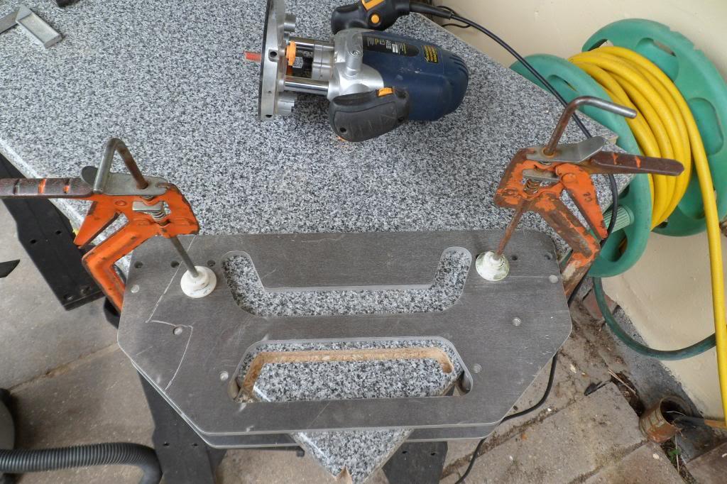

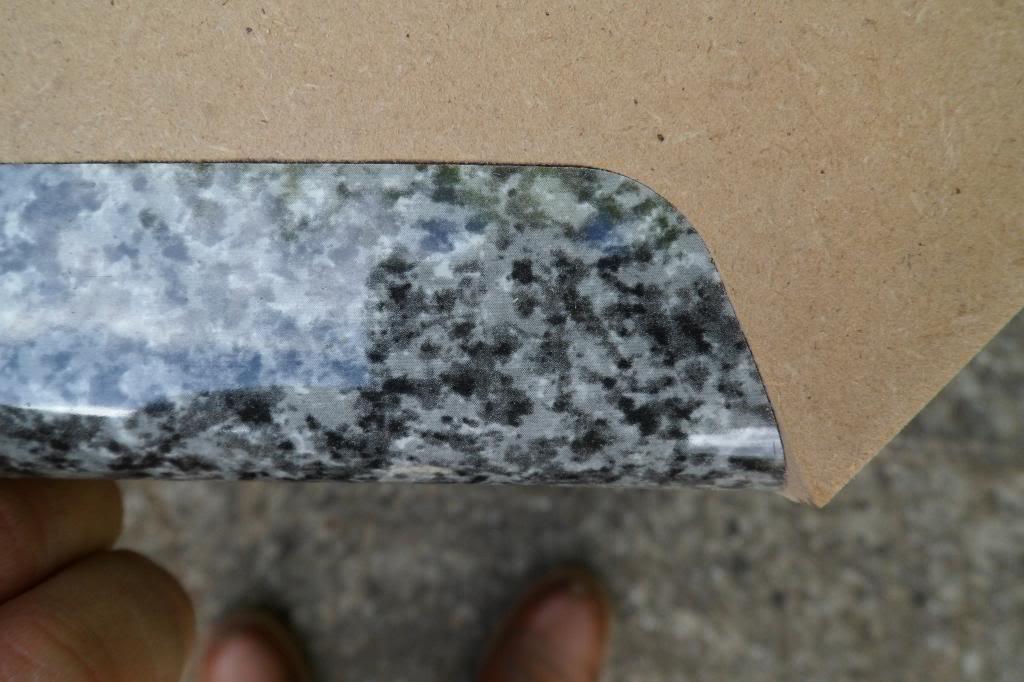

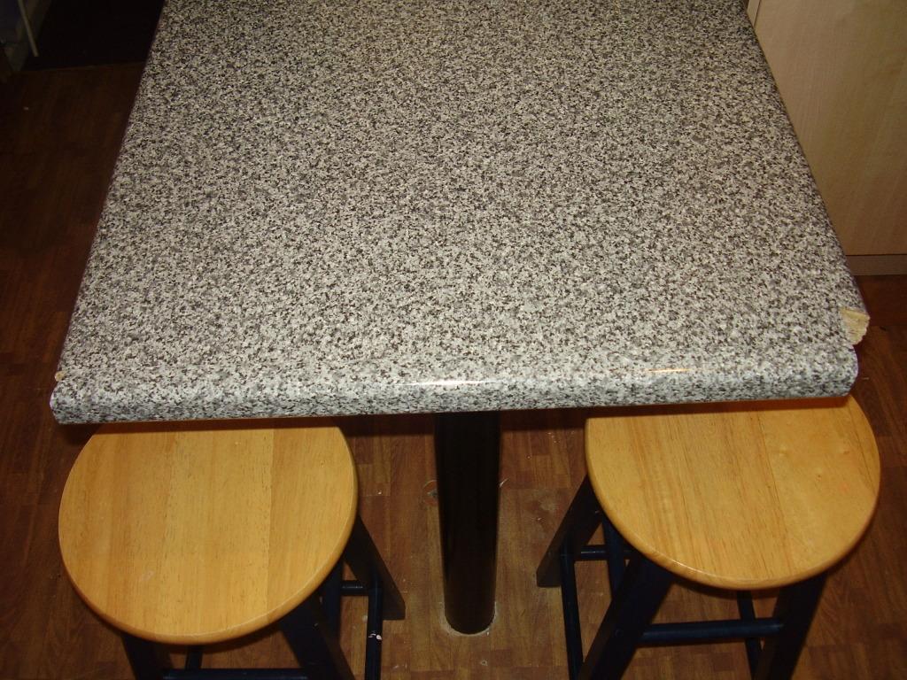

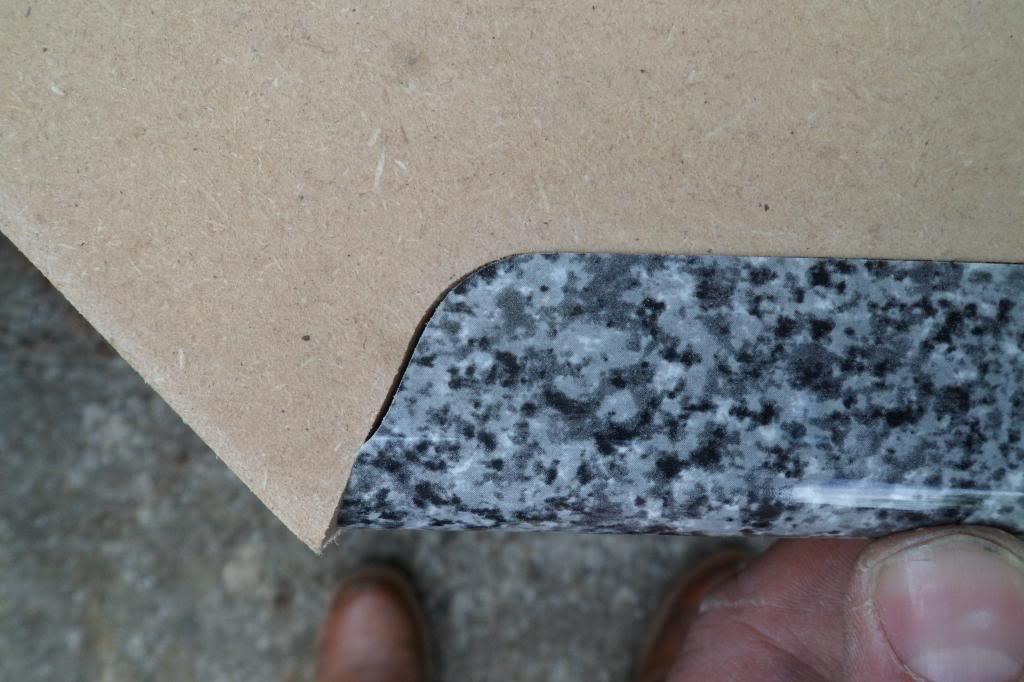

Onoff Posted June 20, 2018 Posted June 20, 2018 (edited) I made a jig to make a breakfast bar. Luckily the pattern is very forgiving. First I grafted rounded edges onto the short end and right hand side of this standard 600mm worktop. The router is your friend to get precise edges to butt together: The jig is o/of 2 pieces of 10mm ali. It does the male and female. It's made specifically for use with the cheap router in the picture: I had to turn down some double ended spacers from ali and fit O rings like on the standard worktop jig: The fit is OK. The inserts were biscuit jointed and glued: I never quite worked out why there was a little "kick" one side. Everything on the CAD model was mirrored and the jig laser cut. One side was perfect: The other had this kick. As a say, lucky I have a forgiving pattern! Meant to revisit and figure why but never did! Tbh it's where we tend to congregate in the kitchen. Edited June 20, 2018 by Onoff

PeterW Posted June 20, 2018 Posted June 20, 2018 Homebase do a solid acacia wood worktops at 28mm for £30 a 2.2m length. Good quality for the price. If you need a jig and are handy with a router then Rutlands do a Worktop Jig for £16.95
zoothorn Posted June 20, 2018 Author Posted June 20, 2018 2 minutes ago, PeterW said: Homebase do a solid acacia wood worktops at 28mm for £30 a 2.2m length. Good quality for the price. If you need a jig and are handy with a router then Rutlands do a Worktop Jig for £16.95 Run me through the idea of the shape of these jigs would you. I do have in fact a jig I made from mdf I use for routers.. shaped in the form of a guitar tweed amp cutout top specifically. I can make a straight cut just using a straight edge guide clamped: what is the benefit of a wortop jig in comparison? This one seem to have angled edges either end off the straight recess..?
PeterW Posted June 20, 2018 Posted June 20, 2018 If you look at the pics it shows you the cuts - you need to do an inset 45 degree cut on bullnose worktop otherwise you end up with an open join on a 90 degree corner.
Onoff Posted June 20, 2018 Posted June 20, 2018 1 minute ago, zoothorn said: Run me through the idea of the shape of these jigs would you. I do have in fact a jig I made from mdf I use for routers.. shaped in the form of a guitar tweed amp cutout top specifically. I can make a straight cut just using a straight edge guide clamped: what is the benefit of a wortop jig in comparison? This one seem to have angled edges either end off the straight recess..? Buy the £17 one if you go that route. Even I wouldn't try and make a standard one.
