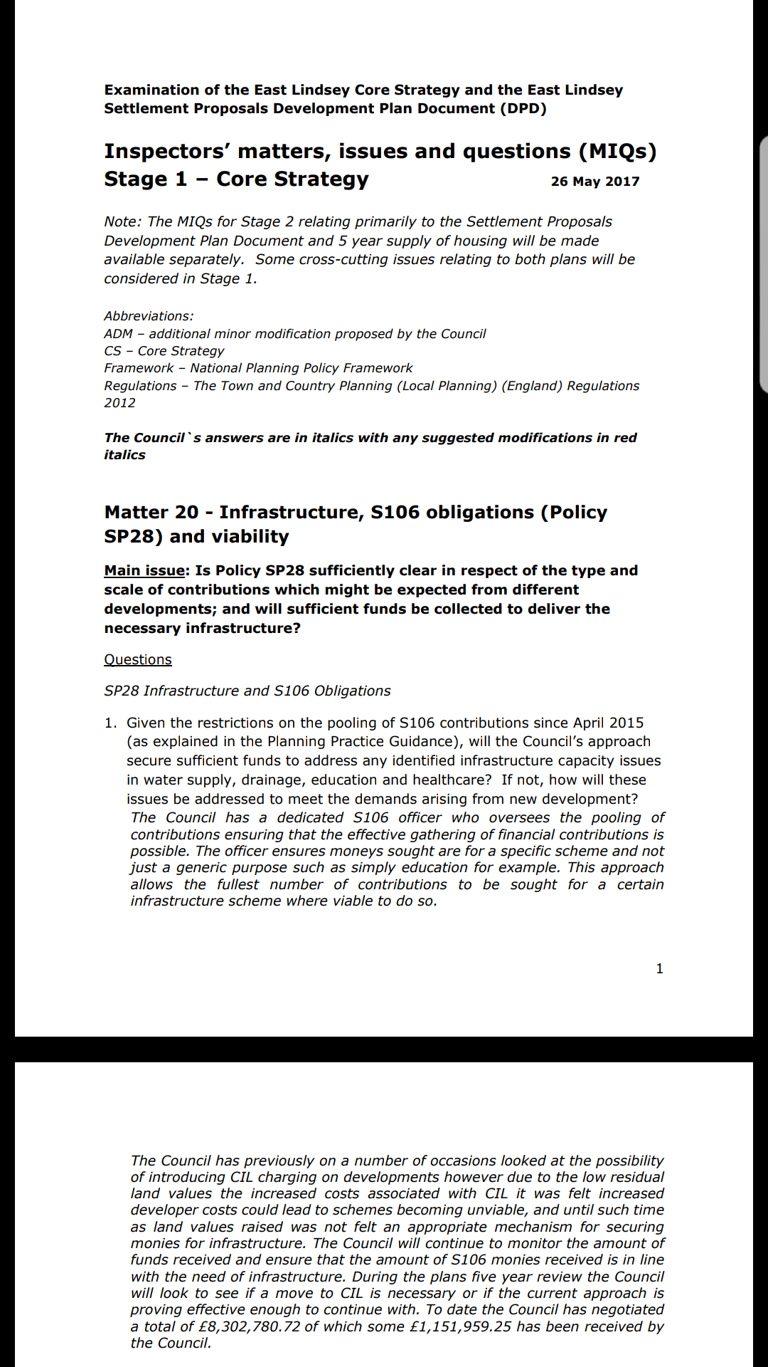

LA3222 Posted June 19, 2018 Posted June 19, 2018 5 hours ago, newhome said: Most of them will be for irrelevant things like neighbour responses etc surely? You should just have to look at the decision and conditions. Seriously, an email to the planning dept should sort it. What LA are you in? Pretty sure @epsilonGreedy is in the same LA as me - East Lindsey District Council. I saw a Pdf dated 2017 where they on about CIL not being feasible at the moment due to low residual land values - they just using S106 at the minute. If you have an S106 liability it will say in your PP if I recall correctly. 2
