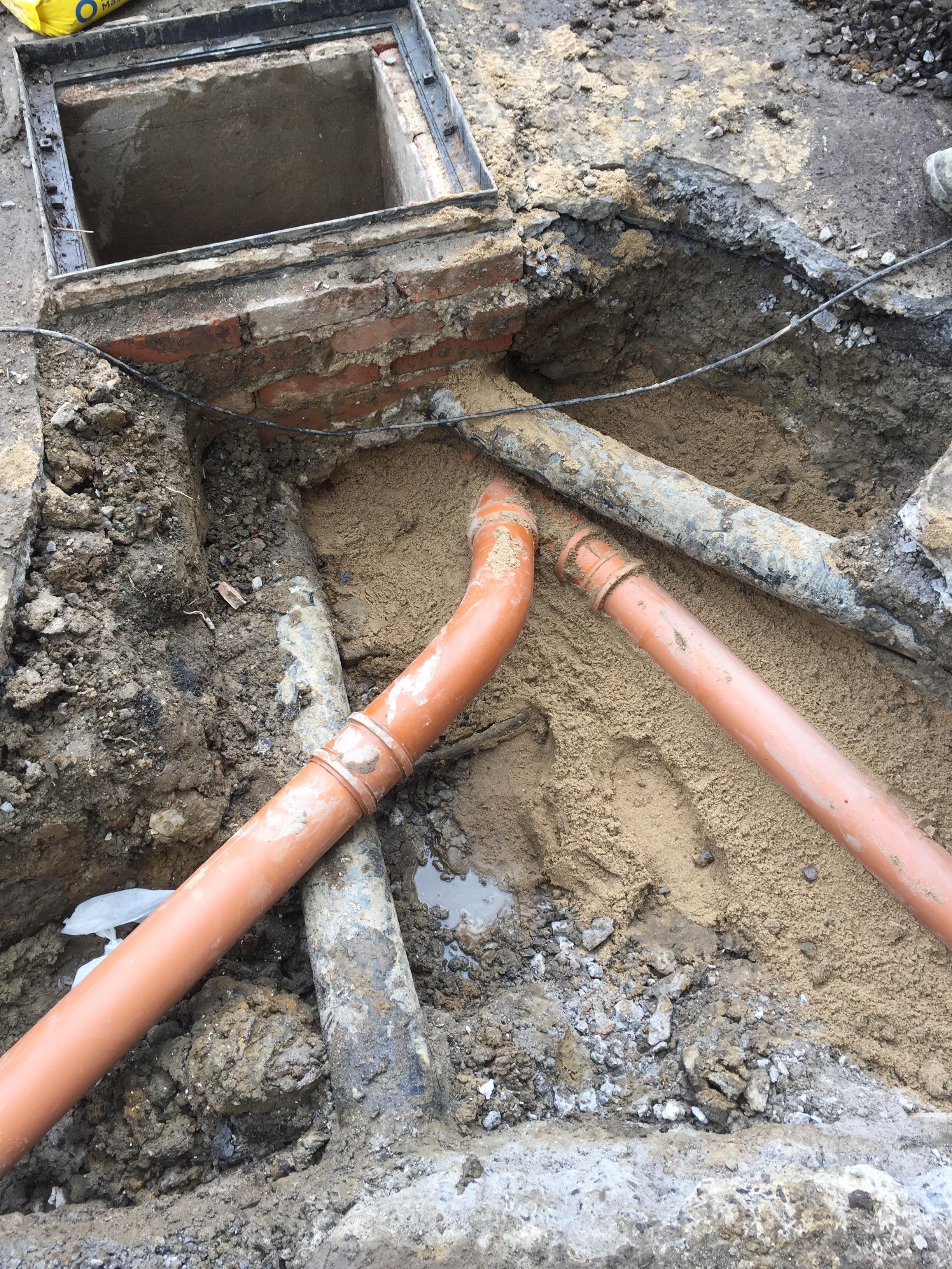

CC45 Posted June 16, 2018 Share Posted June 16, 2018 Neat bend on that pipe @Nickfromwales - how did you do that? Bit of heat? Link to comment Share on other sites More sharing options...
Nickfromwales Posted June 16, 2018 Share Posted June 16, 2018 2 hours ago, CC45 said: Neat bend on that pipe @Nickfromwales - how did you do that? Bit of heat? Bingo bango Link to comment Share on other sites More sharing options...
CC45 Posted June 17, 2018 Share Posted June 17, 2018 Neat. Thanks @Nickfromwales Link to comment Share on other sites More sharing options...
