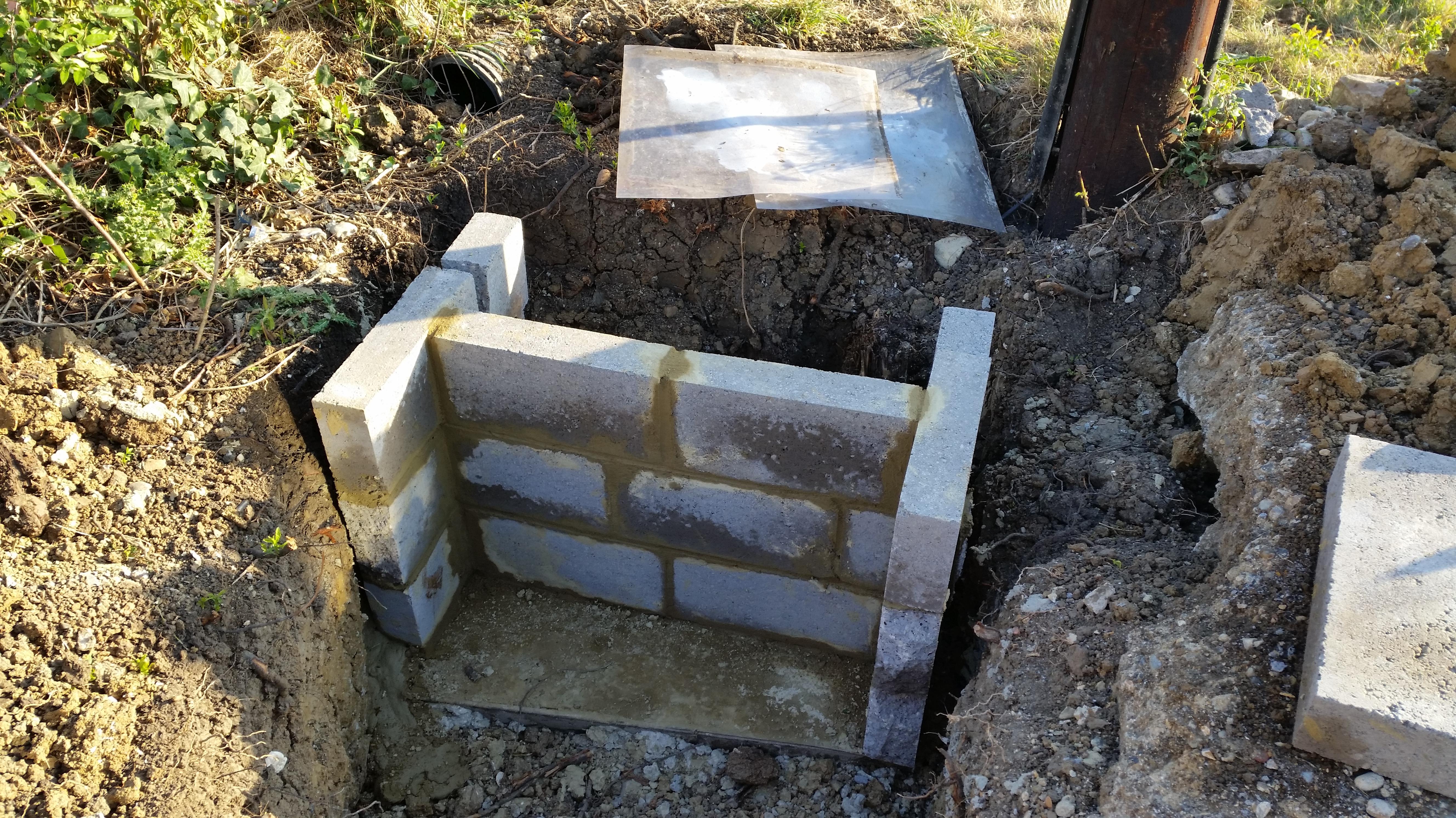

Russdl Posted July 7, 2018 Author Posted July 7, 2018 @Simplysimon (right, lets see if I can do this, quote from another thread that is) In another thread where I asked about Service alterations prior to demolition @MikeSharp01 posted pictures of a 'block house' he'd built on his boundary for all his service, and IIRC from @JSHarris's blog he did something not too dissimilar, but closer to the new property. I 'm leaning towards @MikeSharp01's solution for my own plot and was searching eBay the other day seeing if I could find a second hand roadside electricity enclosure, those big old green metal things, and make that work, but I couldn't find any perhaps because I don't really know what there called. Any way, here goes with Mikes picture. (Crikey it worked!) On 31/05/2018 at 21:52, MikeSharp01 said: Here are a couple of snaps of our block house before we demolished the old house. The front has gas an electric meters and the back has electric distribution (to the house / garden room / garden / lighting and car charger point) and the comm cabinet with the phone line in with wired router and alarm system.

Russdl Posted July 7, 2018 Author Posted July 7, 2018 Thanks @Simplysimon & @PeterW, I’d found those sorts of things but I was looking for something much older, I don’t really know but maybe a circa 1960’s - 70’s one (or much older) with a few more curves and maybe a bit more character, they’re probably out there with the old post boxes and telephone kiosks but I’m buggered if I can find any. Failing that I think I’ll probably plagerise @MikeSharp01‘s design.

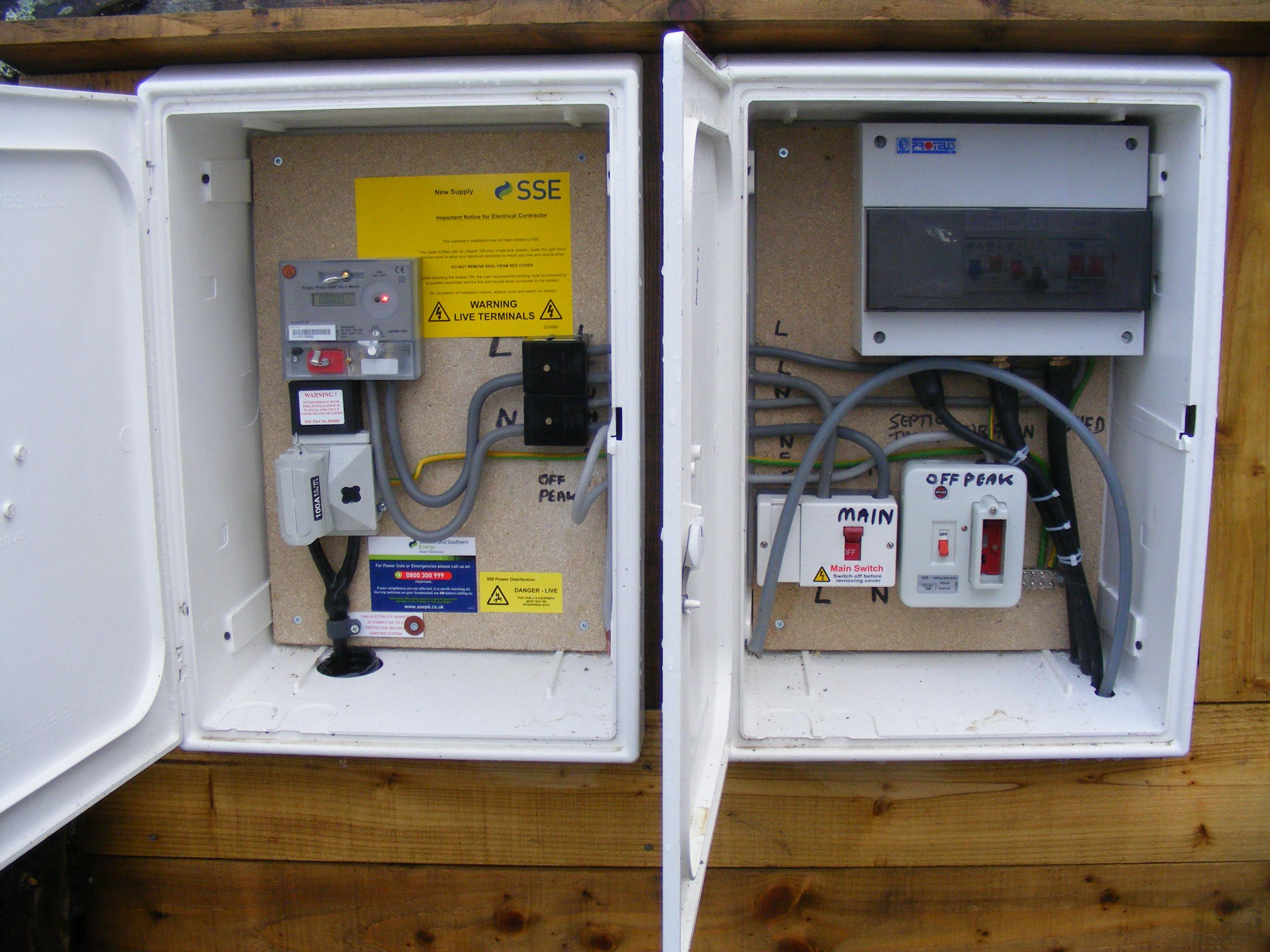

ProDave Posted July 12, 2018 Posted July 12, 2018 4 minutes ago, Simplysimon said: for those who know, would one of these https://www.ebay.co.uk/itm/GRP-Electric-Kiosk-Housing-Meter-Box-Cabinets-Enclosure-SDE1-W750xD450xH1250/253718485438?ssPageName=STRK%3AMEBIDX%3AIT&_trksid=p2060353.m1438.l2649 be suitable to mount at the boundary? cheers Yes, that's a Rolls Royce job. Far cheaper to buy a flush mount standard meter box and build a wall or fence to put it in.
PeterW Posted July 12, 2018 Posted July 12, 2018 Yep as long as it sits on a concrete base. Put a couple of 4” swept elbows in opposite corners to get ducts in and out and then you can always backfill the rest of the duct
Simplysimon Posted July 12, 2018 Posted July 12, 2018 thanks guys, @ProDave one of these https://www.ebay.co.uk/itm/Electricity-meter-box-surface-mark-2/302783808700?ssPageName=STRK%3AMEBIDX%3AIT&_trksid=p2060353.m1438.l2649 do? and will it still need to mounted on the concrete base? cheers
ProDave Posted July 12, 2018 Posted July 12, 2018 That is the surface mount version of a meter box. This is the flush one. https://www.ebay.co.uk/itm/Electric-Meter-Box-Recessed-UK-standard-domestic-meter-box-EBP0011/272284487833?hash=item3f656b9099:g:JisAAOxygo9Q7DF5 I used two side by side in a little bit of fence. Sometimes the DNO get a bit uppity if you put too much stuff in "their" meter box 1

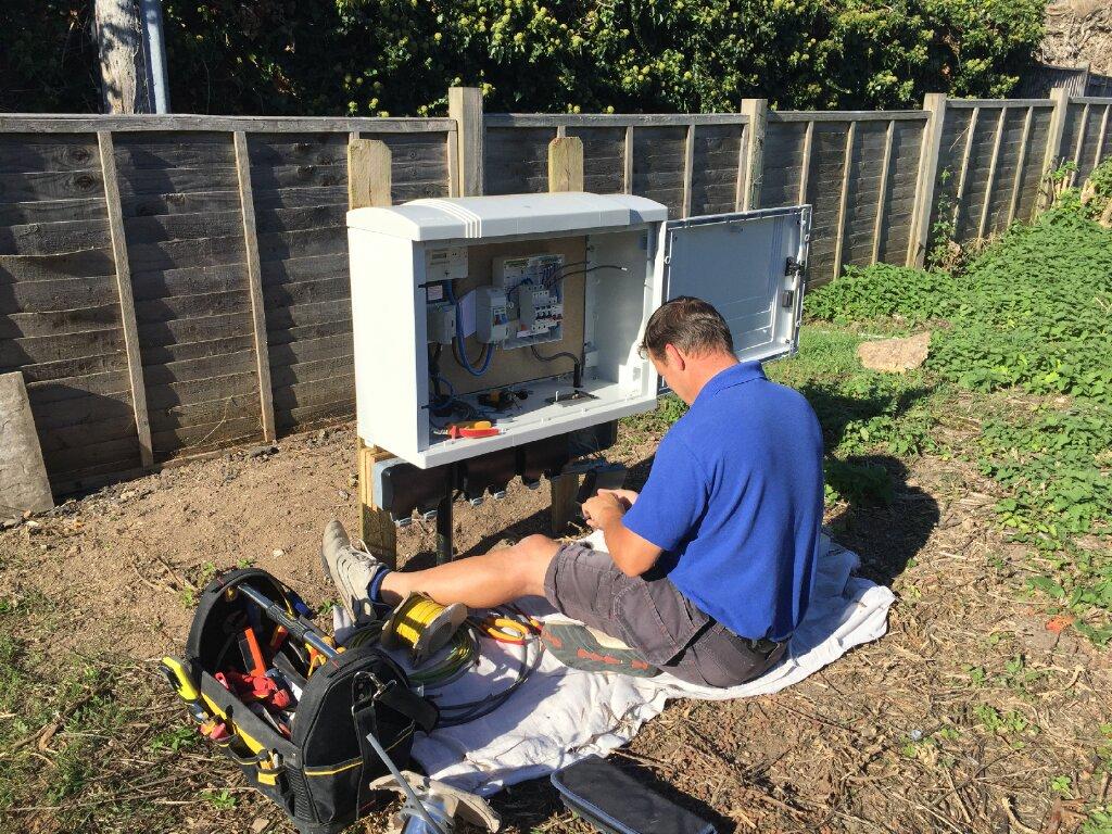

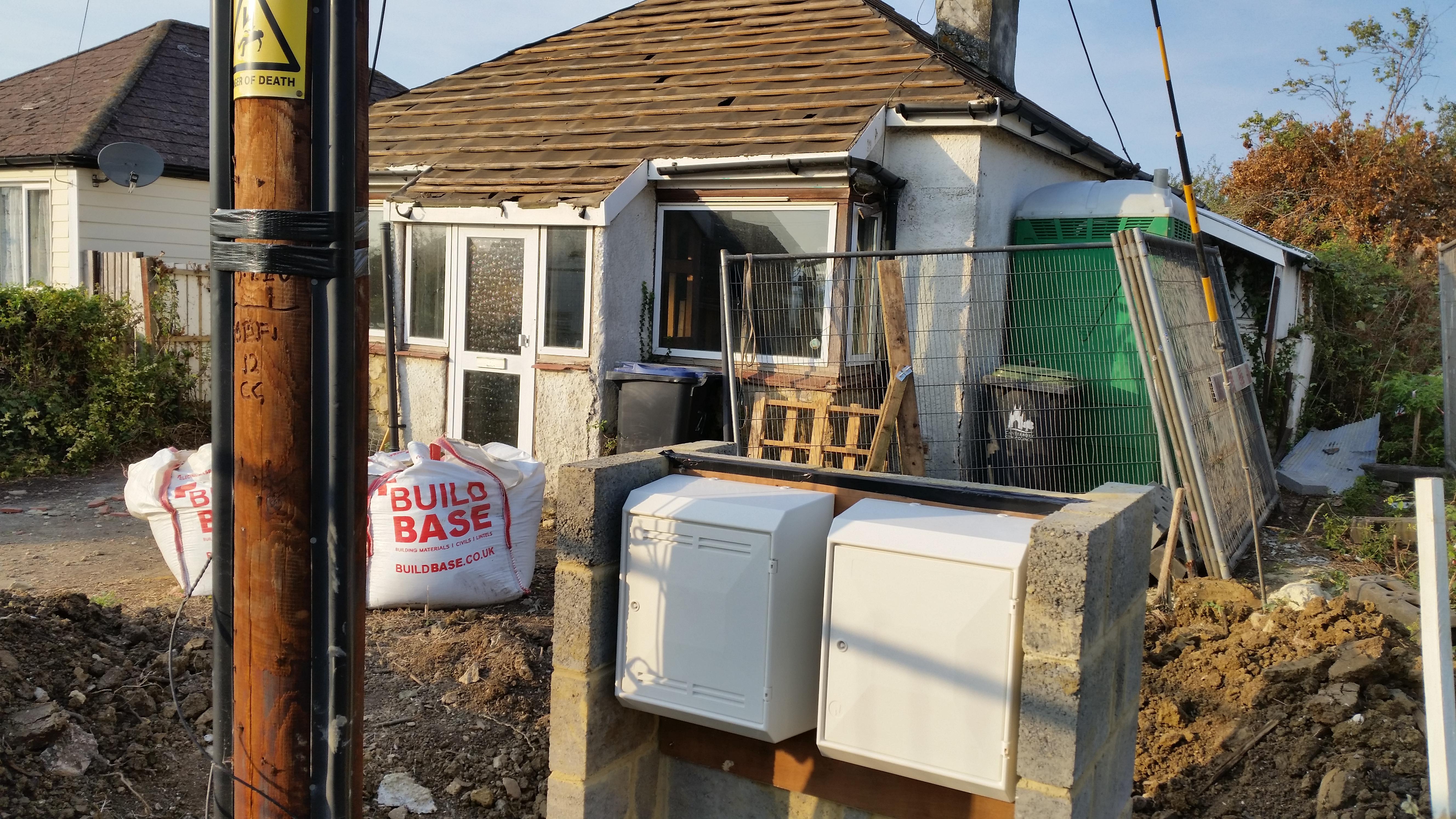

Russdl Posted September 2, 2018 Author Posted September 2, 2018 I've changed my plans slightly and the TBS will be 'temporary'. But I'm getting confused about what/where/who/how etc. I can't call anyone until the morning and I won't sleep with these (hopefully minor things) playing on my mind, so I'm hoping you'll be able to check my plans thus far... I'll be trenching (IAW with the DNO guidelines) from their pole, and under a footpath, so that the hockey stick comes up in to our garden about 1m from our low fence which separates our garden from the footpath. I have a wide (700mm) lockable meter box that will be mounted on 2 wooden post. Inside this large meter box I plan to have the meter and Temporary Building Supply. Whats bugging me is: 1. Is there a minimum distance from the fence to the meter box/TBS (it will open in towards the plot) 2. Can I have the Cut Out, Meter and TBS all in one big box? (a bit late to ask that question, but maybe not too late!!) As I understand it, the DNO pull their cable through my duct and put the Cut Out in my large meter box and dissappear. Then the service provider attach a meter to the Cut Out and disappear. 3. Do the service provider leave a meter with nothing hanging out of it and then my electrician connects tails to the meter and on to the TBS or do they leave the meter tails in Henley Blocks. This is probably nigh-naff and trivia but it's vexing me, any light shining would be much appreciated.
ProDave Posted September 2, 2018 Posted September 2, 2018 1) No, ours is right on the boundary with next door. 2) some DNO's get uppity if you take up space in "their" meter box. Use a small mini CU right in the top right corner of the meter box and you will probably get away with it with little more than a grunt of discontent. What happens next is highly regional dependant. I would suggest the TBS CU is present with meter tails already connected so the meter monkey can connect them to the meter. Having an EIC might smooth the waters if there is any uncertainty. In our case SSE supply a meter with a built in isolator and the electrician makes the final connection. 1
Russdl Posted September 2, 2018 Author Posted September 2, 2018 At the risk of looking stupid (Google was no help) @ProDave EIC? What’s that? Thanks for the rest of the reassurance.
Jeremy Harris Posted September 2, 2018 Posted September 2, 2018 EIC = Electrical Installation Certificate Our supplier wanted one for the consumer side installation before they would fit the meter. 1
Russdl Posted September 2, 2018 Author Posted September 2, 2018 1 minute ago, JSHarris said: EIC = Electrical Installation Certificate Ah! That changes the price of fish a little. I’ll have to check with the supplier tomorrow as my electrician is not available this week and the DNO/Supplier are due on Friday...

Russdl Posted October 6, 2018 Author Posted October 6, 2018 Belatedly, I should update how things went for me. I trenched under the footpath iaw the DNO guidelines apart from where they specify that the marker tape must state 'SSE' on it, I just used a generic maker tape, rebel that I am. I took photos of the trench and the various stages of refilling it to the guidelines. The duct terminated in a hockey stick and then into my (overly large) lockable meter box. Whilst I was away the DNO turned up at the appointed time and moved the cutout under the careful supervision of SWMBO. they weren't interested in the photos and seemed a little surprised that I'd actually gone to so much effort. British Gas arrived later the same day to move the meter, they actually took the old meter away and fitted a new, much smaller one (about the size of a domestic hot water/central heating controller) and were equally surprised by my posh new meter box for my TBS. My electrician turned up a week later to wire up an old CU that was in the old bungalow to the meter and then 4 outdoor double sockets. It all went smoothly, apart from the DNO and BG taking liberties with the amount of space inside the meter box and consequently spreading their stuff all over it, limiting the available space inside and consequently the 4 double sockets are all mounted directly below the box, which in hindsight would have been a good 'plan A' as that means the lockable meter box door is less likely to get broken with constant opening and closing. Photo attached, but go easy on my poor planning that has resulted in a huge, largely empty meter box!
