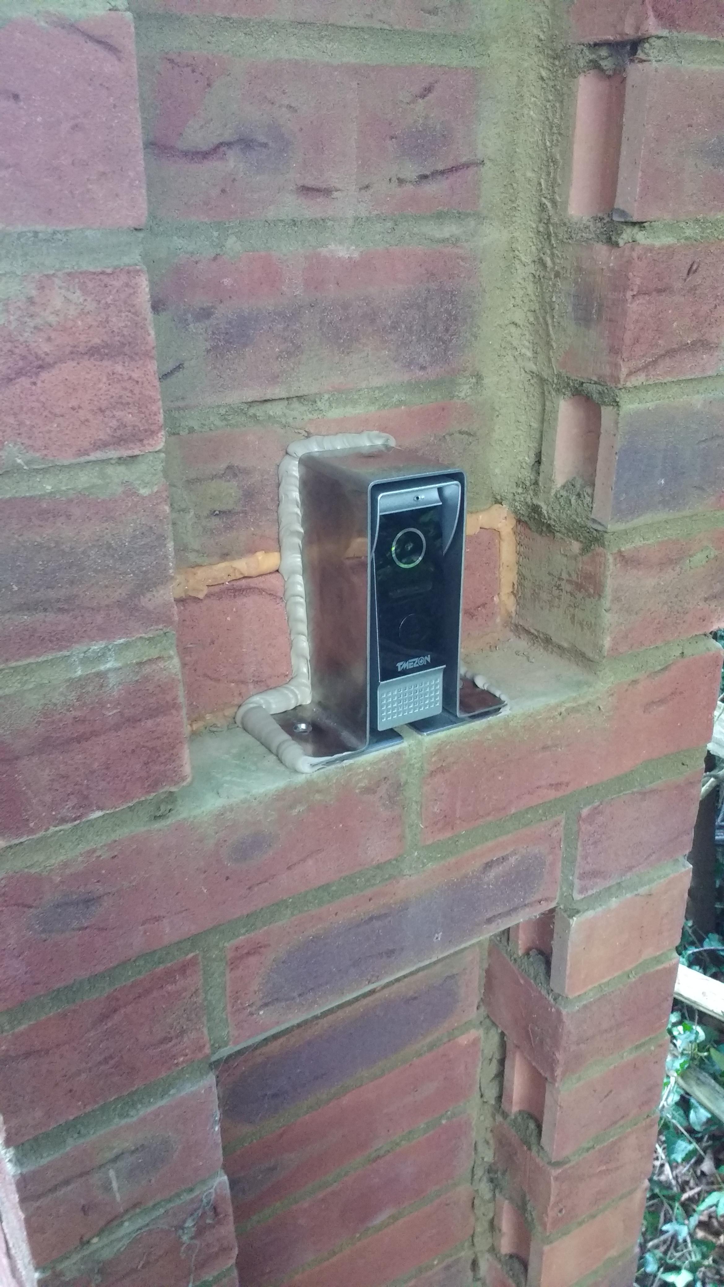

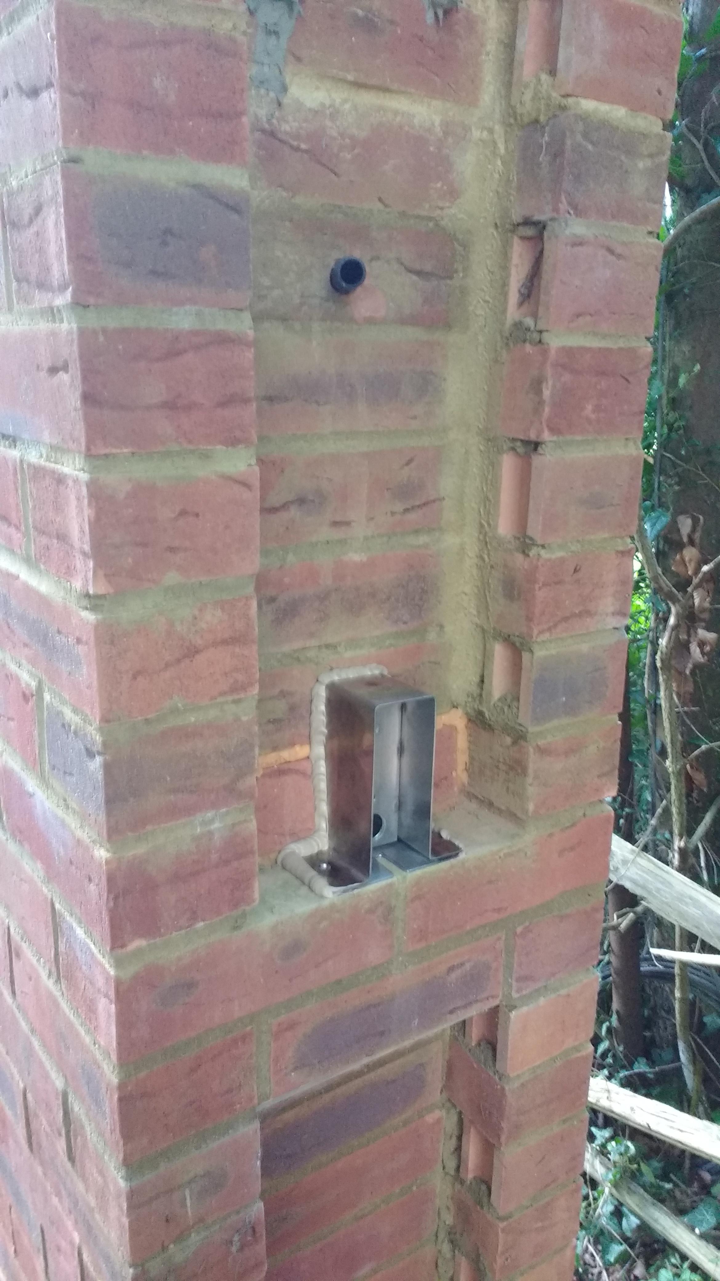

Onoff Posted August 13, 2021 Author Share Posted August 13, 2021 This is the first bending project that folder I made was for, my second attempt at the gate video intercom shroud. I binned the first as I'd hand formed it, aka beaten it around wood and metal formers with a bfo hammer & wasn't happy. All stainless including the M4 rivnuts this time. It's still not perfect, one leg is a bit taller, I stick welded it again as I really struggled with my MIG yesterday but it'll be covered either side with the flints, lime mortared in, so most of it won't be seen: 1 1 Link to comment Share on other sites More sharing options...

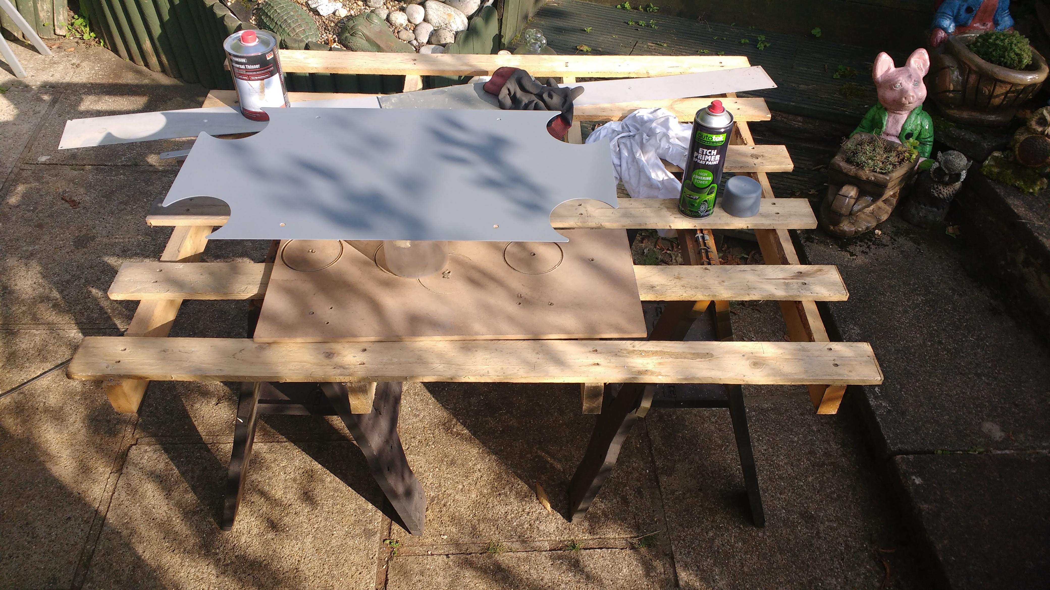

Onoff Posted August 16, 2021 Author Share Posted August 16, 2021 Bit of scrap ali sheet with the corners hole sawn out to cover the gate electrical box. Etch primed, to be rollered satin black to match the rest of the metalwork: The new work bench is proving it's worth... Link to comment Share on other sites More sharing options...

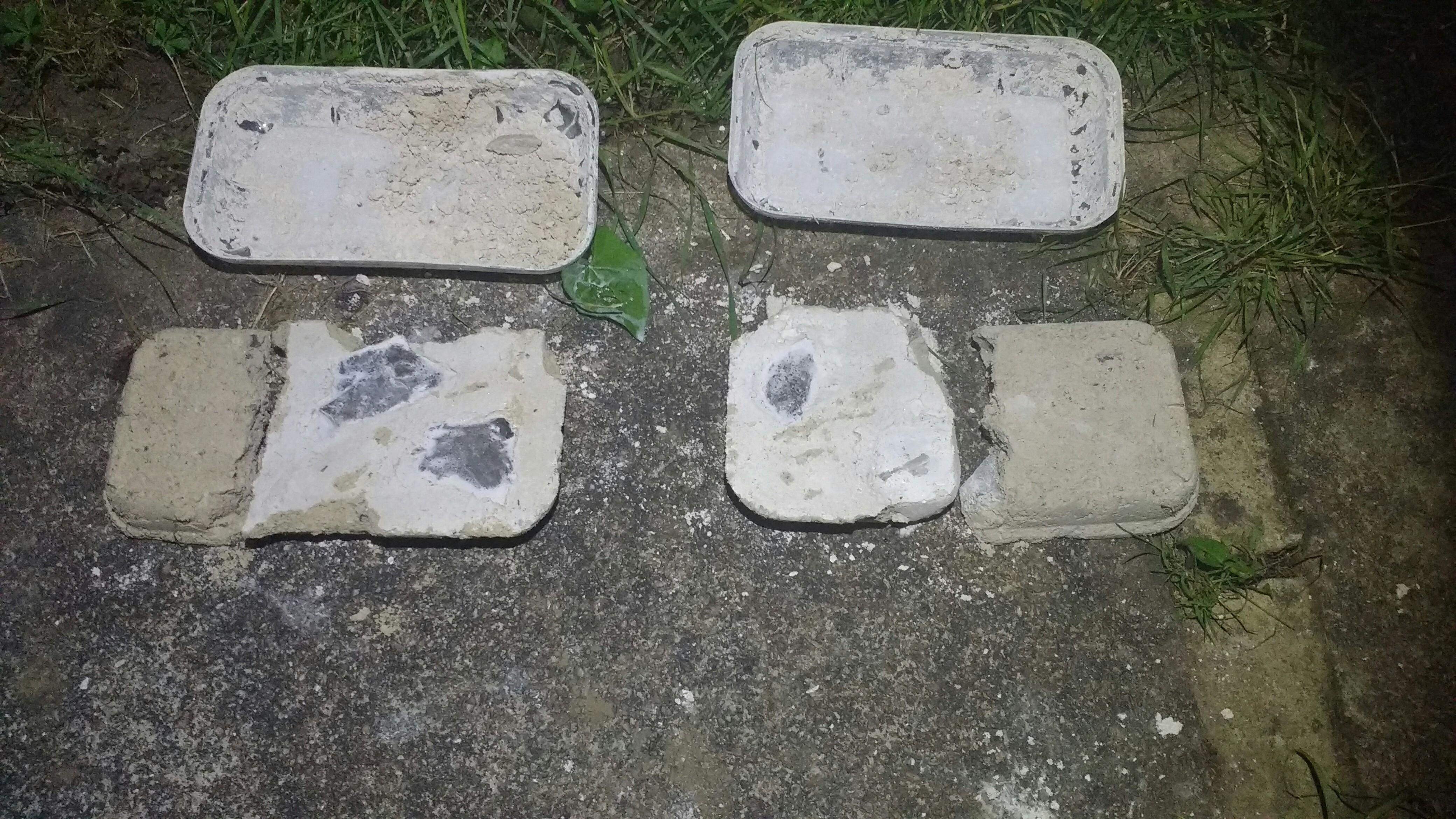

Onoff Posted August 26, 2021 Author Share Posted August 26, 2021 Experimenting here with lime mortar mixes to do my flint infills. In the black bucket: 2 sharp sand 1 hydrated lime In the white bucket: 1.5 sharp sand 0.5 "orange" builders sand 1 hydrated lime At this stage it all looked a bit "white" to me still. Not sure if I want to match my brick mortar or contrast against it? The mix with the half of builders sand was to make it less white. I mixed both mixes up, left to stand for a few minutes then mixed again. Mixing....I mixed for about 5 minutes with the paddle in the cordless. Left for about 5 minutes then mixed again. Is that right? Little video: The mix above left, with the bit of builders sand in, is definitely more mortar coloured. This morning the tray mixes are setting but in no way firm/hard. In the plastic tray though moisture can't get out. Thoughts are maybe the mixes are too wet to set with? Planning this afternoon to drill a load of holes in the back of the pillar recesses, then put in rawlplugs. As I build the wall I'll put in a stainless wood screw to help the mortar key in. Link to comment Share on other sites More sharing options...

Onoff Posted August 27, 2021 Author Share Posted August 27, 2021 I tipped out the two test trays yesterday afternoon. Both still very damp of course and the mixture in both, "crumbly" between the fingers. The mixes are such that I could break the samples in half by hand easy enough. So tipped out they've been able to dry out a bit more overnight. For each sample there's half with the topside facing up and half with the damp bottom facing up. Doing the "fingernail" test and the one on the right, that was just 1 lime :2 sharp sand seems harder to dig into. More like what you'd expect on a church, old flint building etc. The one on the left, the 1 lime : 1.5 sharp : 0.5 soft (for colour), although more of a mortar colour, well it seems softer and you can gouge it with your nail easier. I'm wondering if there's an option to up the lime content (if that's what increases strength) but still make it less white? Hope that makes sense! Or should I just give the samples a few more days to dry out as in will everything just get harder with time? Cheers Link to comment Share on other sites More sharing options...
PeterW Posted August 27, 2021 Share Posted August 27, 2021 Add a half of white cement to the mix ..? 4:1 sand and white cement gives a nice sandstone type finish 1 Link to comment Share on other sites More sharing options...
Onoff Posted August 27, 2021 Author Share Posted August 27, 2021 13 minutes ago, PeterW said: Add a half of white cement to the mix ..? 4:1 sand and white cement gives a nice sandstone type finish The: 1 lime 1.5 sharp 0.5 soft builders ...mix isn't bad colour wise but weaker seemingly than just 2 sharp. If I add 0.5 white cement to this won't it just look "whiter" (albeit it'll be stronger I guess)? I might just stick with the 1 lime:2 sharp sand and accept the contrast. Oddly it seems to have promise. You can see/feel how it will flex and self heal. All new to me this no cement lark! I think as long as I have neatly defined edges between brickwork and flint panels it might look ok. That brings me back to considering having stainless angle trim around the flint panels... ? Link to comment Share on other sites More sharing options...
