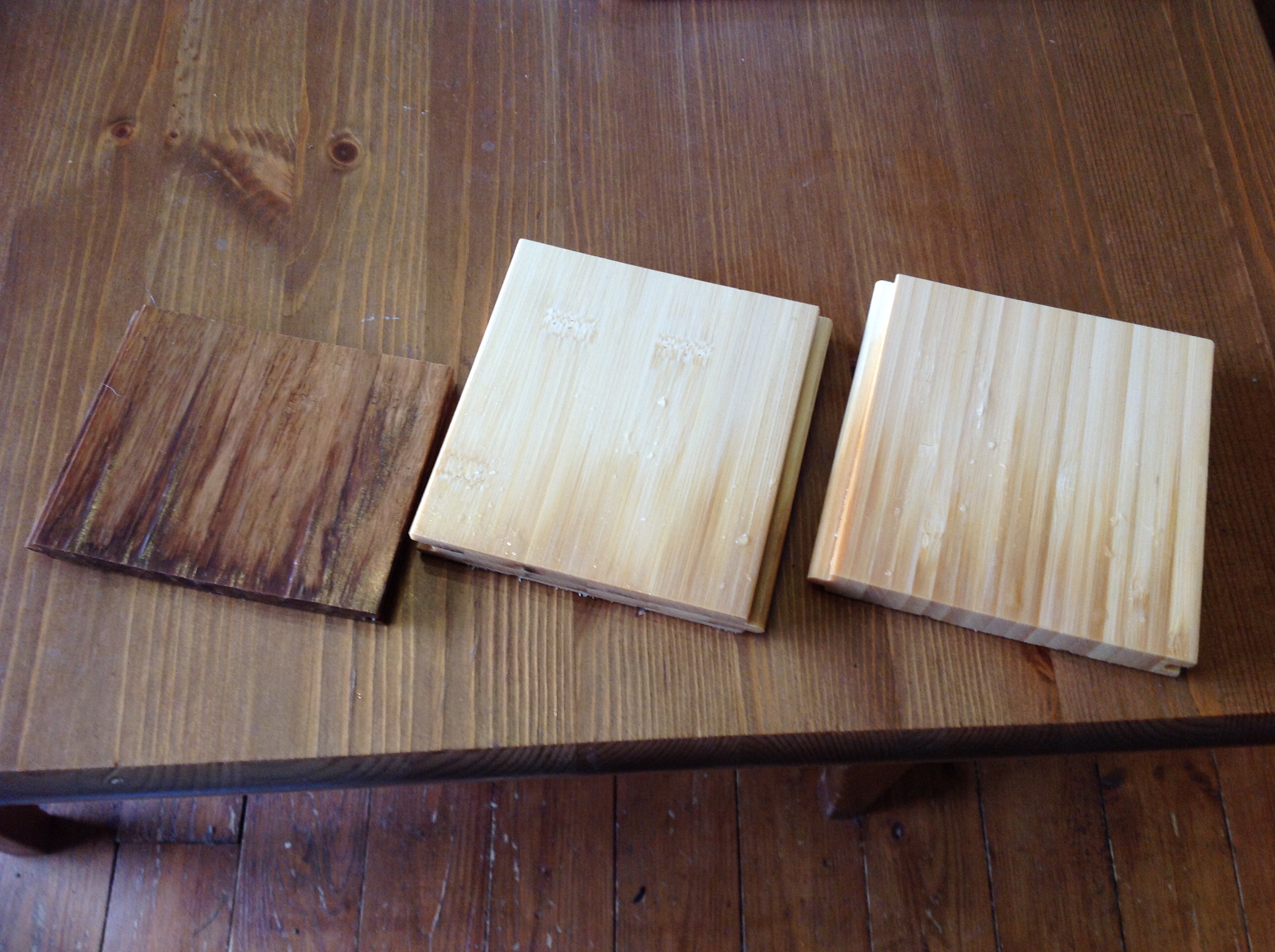

Crofter Posted June 19, 2017 Author Share Posted June 19, 2017 I decided to do a 24hr immersion test of three different types of bamboo: strand woven, vertical, and horizontal. I was a little surprised that the the horizontal fared the best, by a long way. No cupping, bowing, and critically no raising of grain at the surface. Next was the vertical, where again the board remained in good shape but there was a slight raising of grain at the surface, enough to feel when you drag a thumbnail across it. Some way behind these was the strand woven. This sample was a lot thinner, so perhaps it's not an entirely fair test. The board bowed slightly, but much worse is that the surface finish has failed, buckling and bursting. I expect that this is permanent damage and would need to be sanded out. The strand woven sample was 10mm, from 'simply bamboo', and is the cheapest of the three. However strand woven is supposed to be the most durable. It was the most resistant to scratches when I scraped it with my thumbnail (pre immersion). The other two samples were from the Bamboo Flooring Company, and whilst thry fared better at the immersion test, it was possible to scratch these samples with a thumb nail, in particular the vertical one. I also got a sample of cheap engineered oak, with a 2.5mm wear layer- this is cheaper than any of the bamboo options, and looks quite acceptable. It failed the nail scratch test very easily indeed, so easily that I didn't bother doing the immersion test as I had already discounted it. So, at the moment the horizontal bamboo seems to be winning. Which is a shame, because I think I prefer the look of the stand woven! Has anybody else ( @JSHarris ?) done similar tests? Picture shows, from L to R, strand woven 10mm, horizontal 15mm, vertical 15mm Link to comment Share on other sites More sharing options...
Jeremy Harris Posted June 19, 2017 Share Posted June 19, 2017 I haven't done a test like this, but I have some offcuts of strand woven bamboo in some rubble bags, that are waiting to go to the tip, so I'll take a bit out and dunk it in a bucket. Ours is similar looking to the middle sample above, I think, "14mm thick, Solid Natural Strand Woven 142mm Bamboo Flooring", supplied by the Bamboo Flooring Company. Link to comment Share on other sites More sharing options...

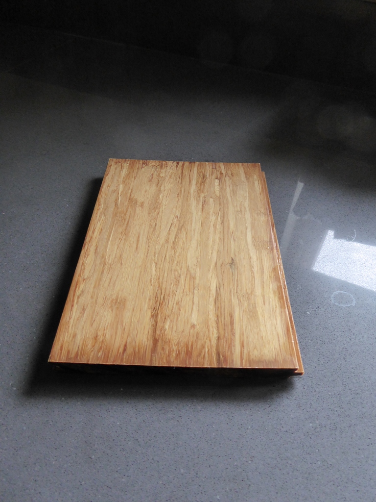

Jeremy Harris Posted June 23, 2017 Share Posted June 23, 2017 As promised, I put an offcut of strand woven bamboo in a bucket of water on Monday and have just taken it out to see how it's fared. The first thing I noticed is that the it sinks, so the density has to be a fair bit higher than uncompressed and treated bamboo. After nearly 5 days of immersion, water has soaked in at the cut edges, and discoloured it a bit, but there seems to be very little distortion. It's very slightly cupped, perhaps around 1mm in the centre. The lacquer doesn't seem to have been affected at all. I'm going to let it dry out for a few days, then I'll take another photo for comparison, to see if it regains its original colour. Link to comment Share on other sites More sharing options...
Crofter Posted June 23, 2017 Author Share Posted June 23, 2017 Thanks for that Jeremy, interesting. My sample of strand-woven was the cheapest one from 'simply bamboo', and is only 10mm thick. I think I'll have to continue the hunt as I'd be reluctant to use it given how poorly it fared when it got wet. I might have to employ some of Ferdinand's tricks to get discounts from the likes of Wickes/TP. I can spend another £2/m2 there because of the money I'm saving on delivery! Link to comment Share on other sites More sharing options...
Jeremy Harris Posted June 23, 2017 Share Posted June 23, 2017 Based on the (very extreme) test of several days of total immersion, I'd say that there's a good chance that the 14mm stuff would be OK if it just got soaked for a short period of time. The Sikabond that I used to stick ours down should seal the underside pretty well, and stop water getting underneath it, so the main issue would be water getting in via the joints. Before we fitted the bamboo, we were warned of a potential problem in wet areas from a friend. He'd laid it in their bathroom and found that the combination of splashes and bare feet polished the surface and made it quite slippery. Not enough to be a problem for adults, but he was concerned that his young children might slip on it. With luck that bit of bamboo will have dried out by early next week, so I'll try and take another photo to see how well it recovers. Link to comment Share on other sites More sharing options...
