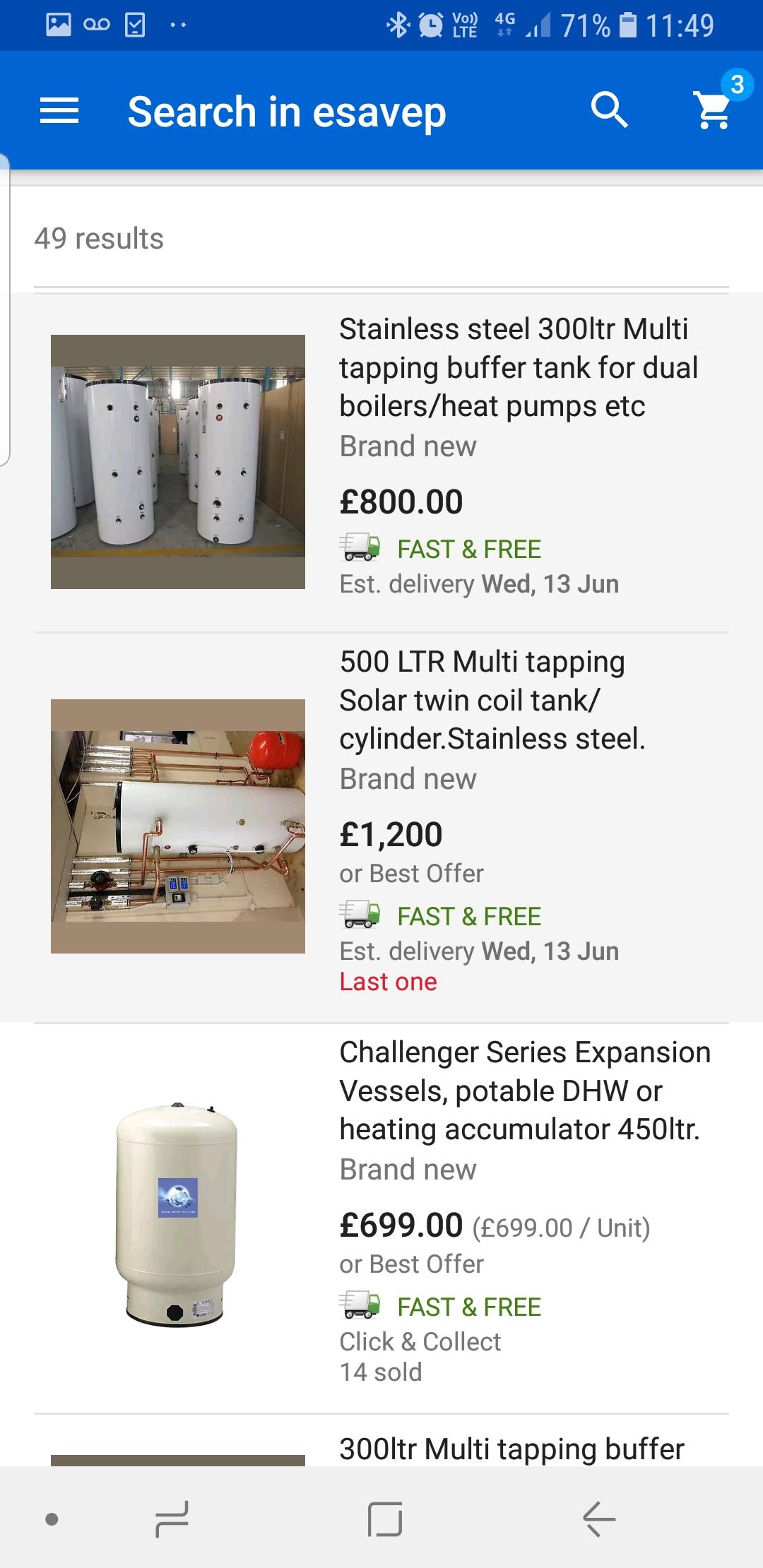

Alexphd1 Posted June 8, 2018 Share Posted June 8, 2018 Maybe of a interest. I have one from Trevor and this one going into this build. I got the eBay one on a cheeky offer Inc vat and del. Can't comment on quality both are still wrapped up. Link to comment Share on other sites More sharing options...

divorcingjack Posted June 8, 2018 Author Share Posted June 8, 2018 OK, got it Thanks! @Alexphd1, thanks, I'll have a look - the price is not that far off what Trevor quoted me, but always good to have options. Cheers all - no doubt back with questions later on! Link to comment Share on other sites More sharing options...
