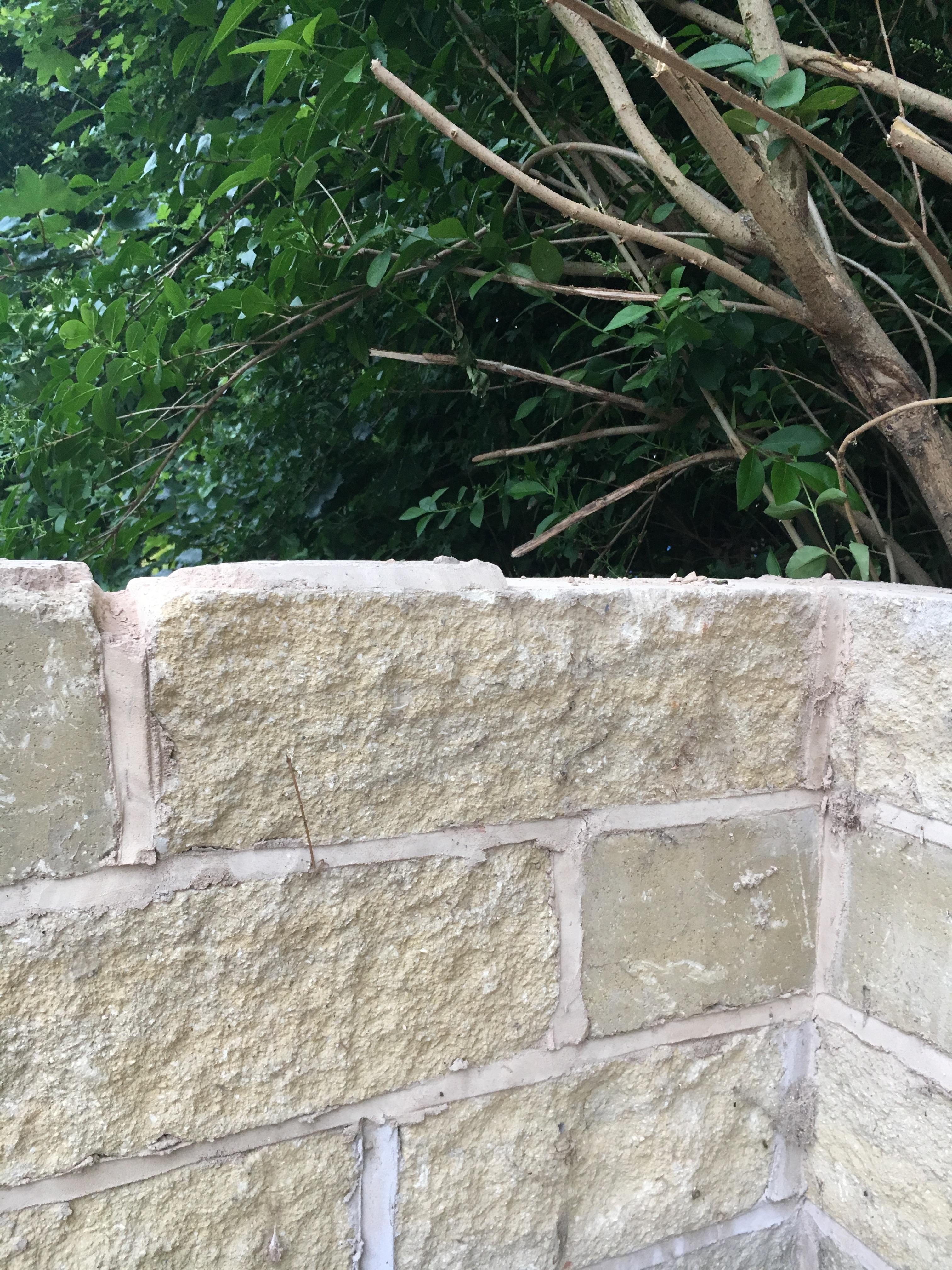

Pjbrandon Posted June 7, 2018 Share Posted June 7, 2018 Hi all, hope this is the correct place for this post. I am repairing and roofing an old brick out building and notice some of the brick work is loose due to failed mortar. I am unsure what type of brick it is and also what type of mortar mix (novice) hopefully someone one can tell me from looking at the pic what type of brick it is and how to get the best mortar mix to match the current mortar colour ? please...... Link to comment Share on other sites More sharing options...

Declan52 Posted June 8, 2018 Share Posted June 8, 2018 They look like a concrete block made with coloured concrete. https://www.aggregate.com/products-and-services/building-products/walling/rough-dressed As far as matching the motar, is it the pink bit or grey bit you are going to go for. Link to comment Share on other sites More sharing options...
Construction Channel Posted June 8, 2018 Share Posted June 8, 2018 the smooth ones look like concrete blocks, but the rough ones look more like stone to me, i dont know what kind of stone but it would take a lot for a concrete block to blow its face and end up looking like that, as for the mortar, it looks very smooth to me so probably just building sand and cement, as for the pink mortar IDK, possibly they added a dye but from the look of the wall, i think its more likely they put some multi finish in it for some unknown reason Link to comment Share on other sites More sharing options...

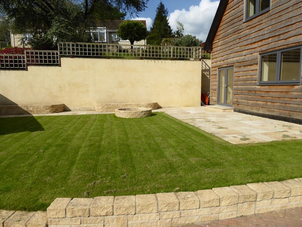

Jeremy Harris Posted June 8, 2018 Share Posted June 8, 2018 I agree with @Declan52, but suspect these may well be Bradstone Cotswold buffs, as they look near-identical to those we used for a lot our landscaping work, like this well: The mortar colour depends on the colour of the local sand to some extent; around here we can get a very bright yellow/orange sand that when used with white cement, rather than the standard grey cement, gives a cream colour to the mortar. When used with normal cement the mortar ends up grey, as in the photo above. I have no idea how you've got pink "mortar" but have to say that I agree with @Construction Channel that it looks suspiciously like plaster to me, especially as it's not well pointed and is failing. Link to comment Share on other sites More sharing options...
Declan52 Posted June 8, 2018 Share Posted June 8, 2018 14 minutes ago, Construction Channel said: the smooth ones look like concrete blocks, but the rough ones look more like stone to me, i dont know what kind of stone but it would take a lot for a concrete block to blow its face and end up looking like that, as for the mortar, it looks very smooth to me so probably just building sand and cement, as for the pink mortar IDK, possibly they added a dye but from the look of the wall, i think its more likely they put some multi finish in it for some unknown reason They make a concrete block using whatever stone and dye they need and make it 225*200*450 and split it in 2. They where used here everywhere around 2000-2005. 1 Link to comment Share on other sites More sharing options...
Jeremy Harris Posted June 8, 2018 Share Posted June 8, 2018 2 minutes ago, Declan52 said: They make a concrete block using whatever stone and dye they need and make it 225*200*450 and split it in 2. They where used here everywhere around 2000-2005. That's exactly how ours came. They were packed on pallets (I bought 5 pallet loads for £15 per pallet, "left over from a job"....) and when the wrap was peeled off you could see that adjacent "bricks" were just split, as the uneven faces were a perfect match to each other. I bought four different sizes, so we could make some of the larger walls in the garden look semi-random, with square jumpers in the courses and as capping "stones" (there's a block wall behind that front wall, just to add a bit of extra strength): Link to comment Share on other sites More sharing options...
Brickie Posted June 9, 2018 Share Posted June 9, 2018 The pink gear may be B&Q/Homebase ‘just add water mortar.’ I had to do a patch job with it the other year when the client (a builder) hadn’t ordered any sand & cement for a Sunday job. Christ,it was awful. What part of the country are you in? Link to comment Share on other sites More sharing options...
PeterW Posted June 9, 2018 Share Posted June 9, 2018 40 minutes ago, Brickie said: The pink gear may be B&Q/Homebase ‘just add water mortar.’ [...] What part of the country are you in? So Hanson who make that stuff for a lot of the sheds have a couple of different blending locations - one is near Lincolnshire and uses the yellow/grey sand from round there and another uses a red sand that’s more orange / pink Bunter sandstone coloured. The downside is it can depend on which factory supplied which warehouse as you can get different blends in the same store. Across the East Midlands if you go east of the A1 it tends to be yellow sand, West is red sand - have to be careful with some of the merchants too as they send what they feel like unless you specify ..! Link to comment Share on other sites More sharing options...
