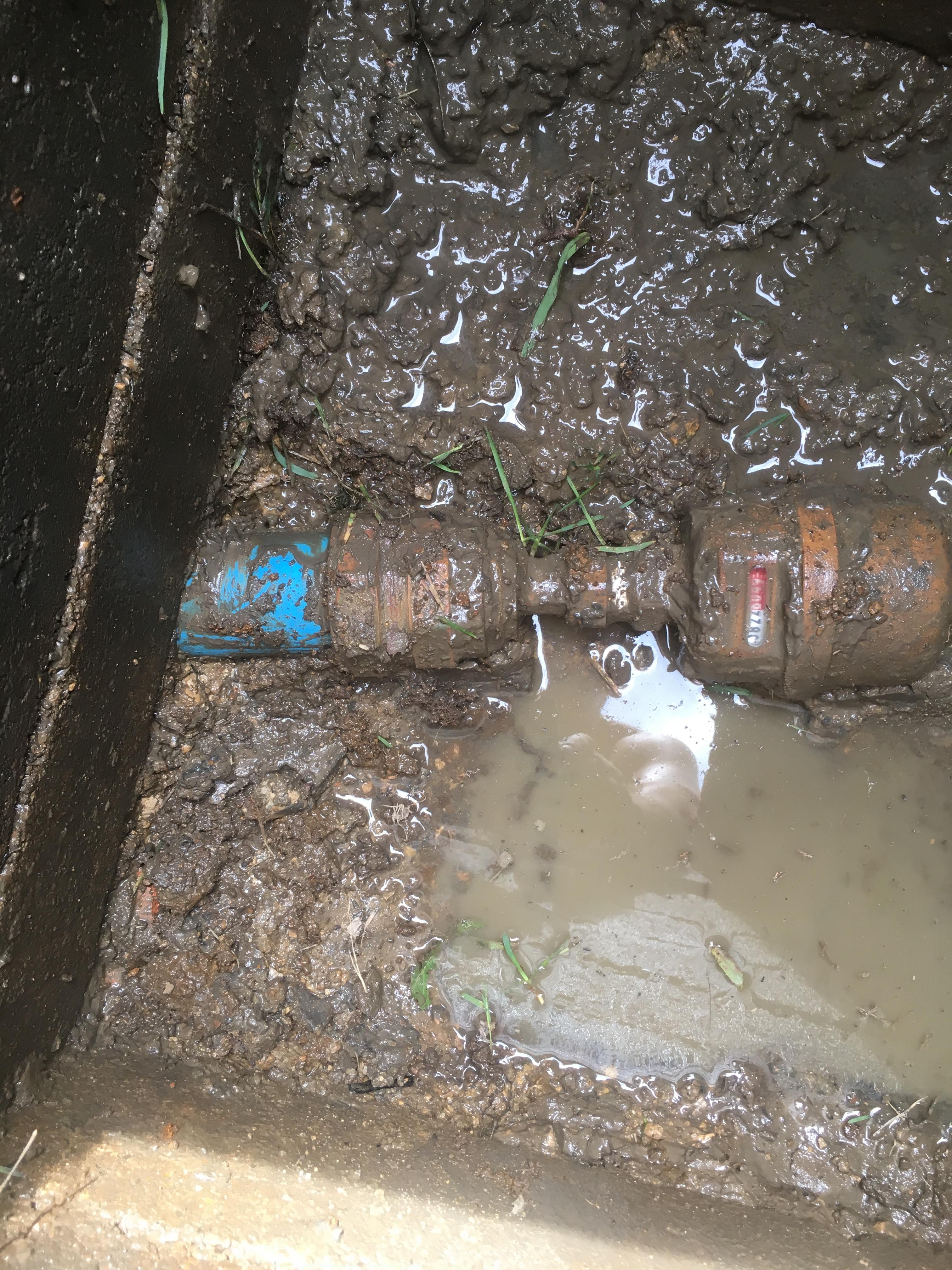

Russell griffiths Posted June 2, 2018 Share Posted June 2, 2018 (edited) Have a look at the pic, does it look normal? the pipe that comes from the water co main is 32mm it then hits the meter, if you look the short pipe coming out of the meter is about 25mm, this then feeds our incoming water pipe the blue pipe in the pic this is a 50mm pipe as it runs a huge distance to our plot. Does this make sense, is it a case of pressure rather than volume, any thoughts russ. Edited June 2, 2018 by Russell griffiths Helps if you add the pic. DOH!! Link to comment Share on other sites More sharing options...
Nickfromwales Posted June 2, 2018 Share Posted June 2, 2018 Looks like 32mm MDPE x 15mm / 1/2" to the meter. Not usually a problem as the issue is the resistance of the ongoing pipe to the property. Link to comment Share on other sites More sharing options...
Russell griffiths Posted June 2, 2018 Author Share Posted June 2, 2018 The blue pipe I the pic is 50mm being fed from that meter. Link to comment Share on other sites More sharing options...
Temp Posted June 2, 2018 Share Posted June 2, 2018 I'd say it's not ideal having a 25mm "restriction" in a 50mm pipe but is it actually giving any problems? Is the standing charge higher if you have a 2"/50mm meter ? Link to comment Share on other sites More sharing options...
Mr Punter Posted June 2, 2018 Share Posted June 2, 2018 9 minutes ago, Temp said: Is the standing charge higher if you have a 2"/50mm meter ? It is where we are (Southern Water). They claim it is because the bigger meters don't measure as accurately so you could be using water that does not register if the flow is low. Link to comment Share on other sites More sharing options...
Nickfromwales Posted June 2, 2018 Share Posted June 2, 2018 9 hours ago, Mr Punter said: It is where we are (Southern Water). They claim it is because the bigger meters don't measure as accurately so you could be using water that does not register if the flow is low. Isn't that their problem not yours? 11 hours ago, Russell griffiths said: The blue pipe I the pic is 50mm being fed from that meter. Yes, sorry, just re-read this. So is the short & narrow connecting piece 22mm / 3/4"? If so I doubt you'll get much better, as the size of the tapping at the main will be no bigger. Link to comment Share on other sites More sharing options...

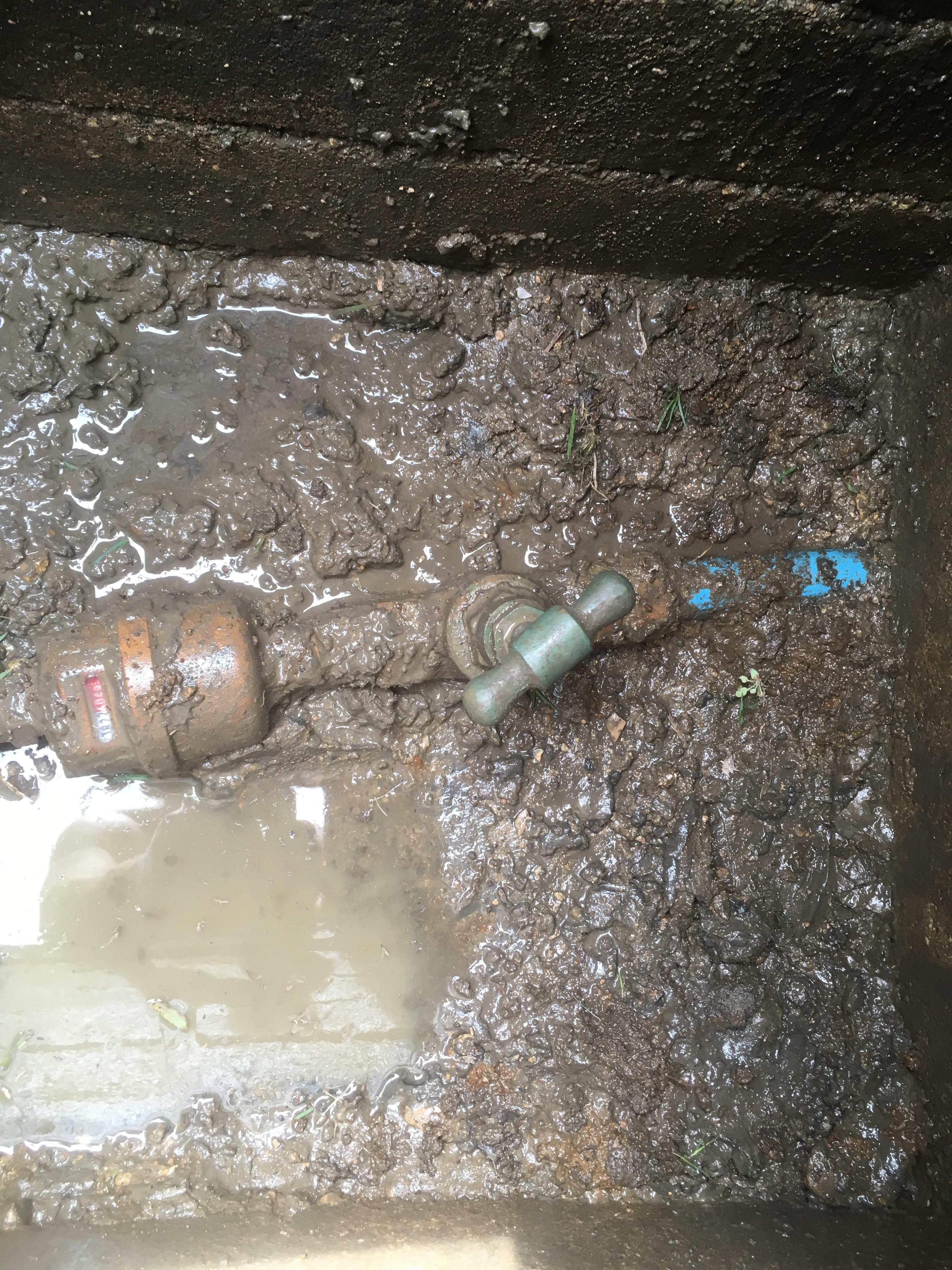

Russell griffiths Posted June 3, 2018 Author Share Posted June 3, 2018 Another better pic. From the main in the street it’s 32mm plastic then the meter then that bit of 22-3/4 whatever it is then our 50 service pipe that runs to our plot. Link to comment Share on other sites More sharing options...
Russell griffiths Posted June 3, 2018 Author Share Posted June 3, 2018 So I better check if we have a problem before I presume we do 1- what would be a good pressure, flow rate at my plot 2- how do I measure this i have 32 mm mdpe sticking out at the plot so will need to connect to that. Link to comment Share on other sites More sharing options...
dpmiller Posted June 3, 2018 Share Posted June 3, 2018 just look at the 50mm as a built-in expansion vessel. Link to comment Share on other sites More sharing options...
PeterW Posted June 3, 2018 Share Posted June 3, 2018 32mm reduced to a 22 then 15 I would expect with a gauge on it. If you use a 22mm reduced tee you can put the gauge on the 15mm section and put a stop tap on the 22mm end and get both static and dynamic pressure. Most water company domestic meters are 15mm and if you want anything bigger they charge a fair bit more. Link to comment Share on other sites More sharing options...
