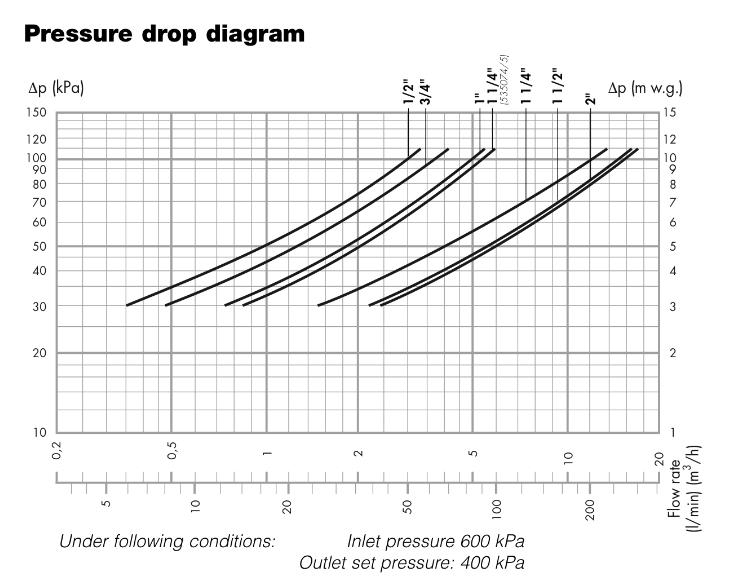

ProDave Posted May 31, 2018 Posted May 31, 2018 So not long back I fitted the Telford 300L heat pump col indirect HW tank. It comes with a pressure reducing valve. There is a cold water tap off point so the hot and the cold taps all get the same pressure regulated feed. Worth pointing out our mains pressure is in excess of 6 bar and has a fantastic flow rate. I have had a nagging doubt since installing it that the flow rates are not brilliant. Showers are okay at about 14L per minute, not fantastic but adequate. It's the bath flow that may prove an issue as that is not a lot higher. That may be the fault of the floor standing bath filler that cam with long inbuilt 1/2" flexis so that is bound to limit flow a bit. But now cut to the chase and get to the point of the thread. Today I borrowed one of the pressure gauges from one of the UFH manifolds and hooked it up to a pressure regulated cold water feed. Sure enough, it measures a static pressure of 3 bar as it is set to. But turn on say a shower (remember 14L per minute) and the pressure gauge drops to 2 bar. To me, it seems like the PRV is doing a poor job. With our high mains pressure and flow, that will not be the reason for the drop. It would appear that at 14L per minute the PRV can only maintain 2 bar. This is measured right at the PRV so it is not pipework causing the presure drop, and even if I just run a hot tap, so no flow through the cold feed where the gauge is, the pressure still drops. Before I discuss this with Telford technical, I would be interested if anyone has done a pressure measurement and what sort of pressure do you thing it should maintain? I would expect a drop but not down to 2 bar.
PeterW Posted May 31, 2018 Posted May 31, 2018 They are a Caleffi unit and you can change the flow regulator. I would check you’re getting 2 bar dynamic water pressure prior to the PRV first as it could be a 6 bar static until you get a flow.
ProDave Posted May 31, 2018 Author Posted May 31, 2018 Just moved the pressure gauge. Mains pressure is 6.5 bar and you can't even see the pointer move at all when you run a bath or shower, so mains pressure or flow is not the problem.
PeterW Posted May 31, 2018 Posted May 31, 2018 Looking at the graph the pressure drop at 15 litres /min is about 0.5 bar at most. They can be adjusted upwards so you can set it to 3.5 bar if you are losing pressure downstream.
ProDave Posted May 31, 2018 Author Posted May 31, 2018 So is mine faulty? should I be asking for a replacement?
PeterW Posted May 31, 2018 Posted May 31, 2018 Not necessarily - they are factory set for an average use at 3bar or 300kpa at 10lpm which is fine usually. Standard fluid dynamics says that if you increase the flow you decrease the pressure so you need to decrease the pressure restriction. Graph below shows that for 14lpm you would need to decrease the restrictor by approx 0.45bar or 45kpa

ProDave Posted June 1, 2018 Author Posted June 1, 2018 I am sure there is no crap in the strainer. Before the tank was fitted I had all the hot and cold pipes plumbed, and a temporary link, done with compression fittings from cold feed in, to hot and balanced cold out. That was well flushed through to get all the flux residue and other crap out of the system. When the tank arrived I simply removed the temporary link pipe, and connected the cold in to the PRV in with compression fittings, so no chance of crap getting in. I am not bothered about the flow rate particularly, it's just when I checked and saw the pressure drop so much, I thought that can't be right. We had pretty much the same setup at the last house so same PRV and I recall the baths filled a lot quicker, and one of those was plumbed in 15mm which didn't seem to restrict it much. @PeterW you talk about "decrease the restrictor by 0.45 bar" What is this resrictor you talk of? This is a pressure regulating valve that works by feedback and should (within limits) maintain a fixed pressure at the output. Are you saying as well as the pressure adjustment there is a restrictor?
Nickfromwales Posted June 1, 2018 Posted June 1, 2018 I think has saying what I said, but more technically put. Open the restrictor ( spring ) turnscrew by 0.5 bar, found in the centre of the cartridge top. You may have to remove the dust cap to do so as I dont know exactly which one you have.
ProDave Posted June 1, 2018 Author Posted June 1, 2018 So you are saying adjust the static pressure to 3.5 bar to get the dynamic pressure up to 2.5 bar. Won't that have implications for the warranty? Question still remains, if it should drop by 0.5 bar at 14L / min but is actually dropping by 1 bar isn't it "faulty"?
PeterW Posted June 1, 2018 Posted June 1, 2018 Are you getting an actual measured 14 lpm..?? Look at the graph and the 3/4 has a reasonably shallow curve but would still have a perceived increase in pressure drop from the valve. As they are spring driven, the preload on the spring will vary the actual response so your “dynamic” pressure is the operating pressure at the coil. These tanks have 6bar fail at the control group, 7 bar at the combined overheat pressure relief, and will comfortably take 10 bar without too much trouble as long as it’s not permanent.
ProDave Posted June 1, 2018 Author Posted June 1, 2018 So here is what I have done. I tried setting the PRV so that the dynamic pressure with the bath taps on full, was 3 bar. That resulted in the static pressure rising to 3.8 bar with the taps all off. So I have compromised and set the static pressure to 3.5 bar and that gives a dynamic pressure of 2.6 bar with the bath taps on. This has given a noticable improvement to the bath fill speed but strangely made hardly any difference to the shower flow which is still at 14 litres per minute. The shower flow is measured with the sceintific method of timing how long the shower takes to fill a bucket of known capacity. 1
