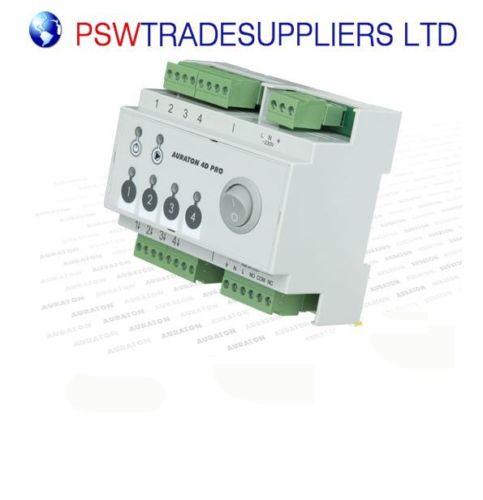

ProDave Posted May 23, 2018 Share Posted May 23, 2018 One thing you need with under floor heating is the electrical controls for the manifold. As an electrician I have wired many different makes. Most have struck me as over complicated with features that are never used, poorly thought out making them very hard to wire neatly with insufficient space for cable termination, and over expensive for what they are. Then I found this one: On sale very cheap on ebay https://www.ebay.co.uk/itm/4-ZONE-UNDERFLOOR-HEATING-WIRING-CENTRE/132318857114?ssPageName=STRK%3AMEBIDX%3AIT&_trksid=p2057872.m2749.l2649 Before I bought it I did some searching and found the instruction manual http://www.auraton.pl/wp-content/uploads/_instrukcje/en/manual_AURATON_4DPRO_en.pdf That is it. That is the entire instruction manual, you get a paper copy of that with the item. First impressions. The manual is about as much use as a chocolate tea pot. There is not enough information to safely and correctly connect it and expect it to work, let alone understand what exactly it is doing. However once you work it out, it does indeed do everything you need it to do. You just need to fill in the blanks. Firstly the themostat terminals (variously referred to as such things as "terminals of cable controllers") There is a pair of terminals for each room thermostat for the 4 zones. It is important to note that the left hand of each pair of terminals is the L supply out (internally linked to the L into the unit) to the thermostat, and the right hand of each pair of terminals is the switched L back from the thermostat into this unit. If your thermostat needs a neutral, you will have to link that independantly. The output terminals are one pair for each zone. The left hand of each pair being N internally linked to N in, and the right hand pair being switched L to the zone actuator valves. There is a global switched L out to turn on the pump when any zone calls for heat, and a volt free changeover relay contact to link to the boiler / heap pump etc. So it does what it should, just shame you have to do a bit of detective work to fathom it out. I just thought I would mention this if anyone else was after a budget controller. 2 Link to comment Share on other sites More sharing options...

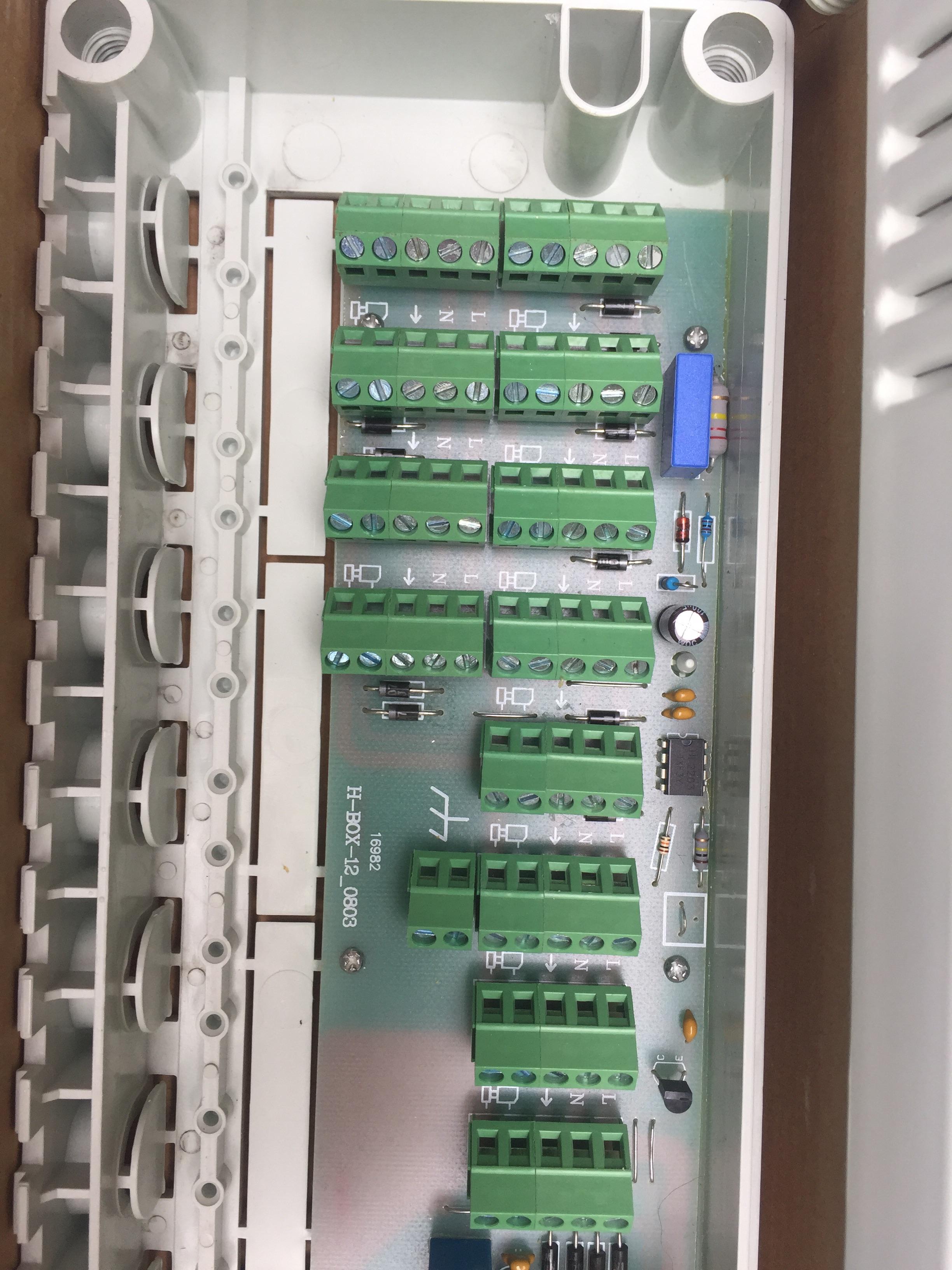

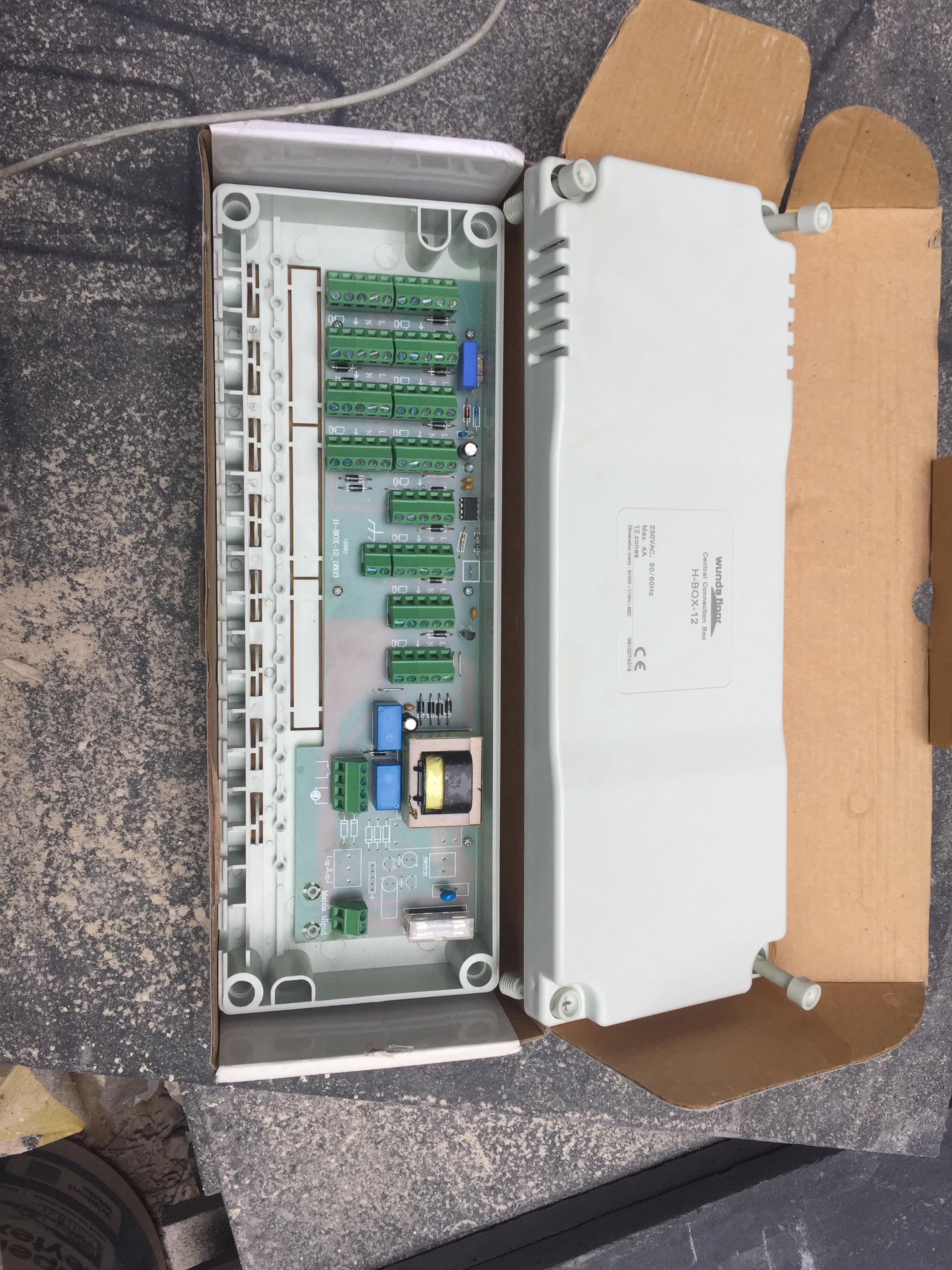

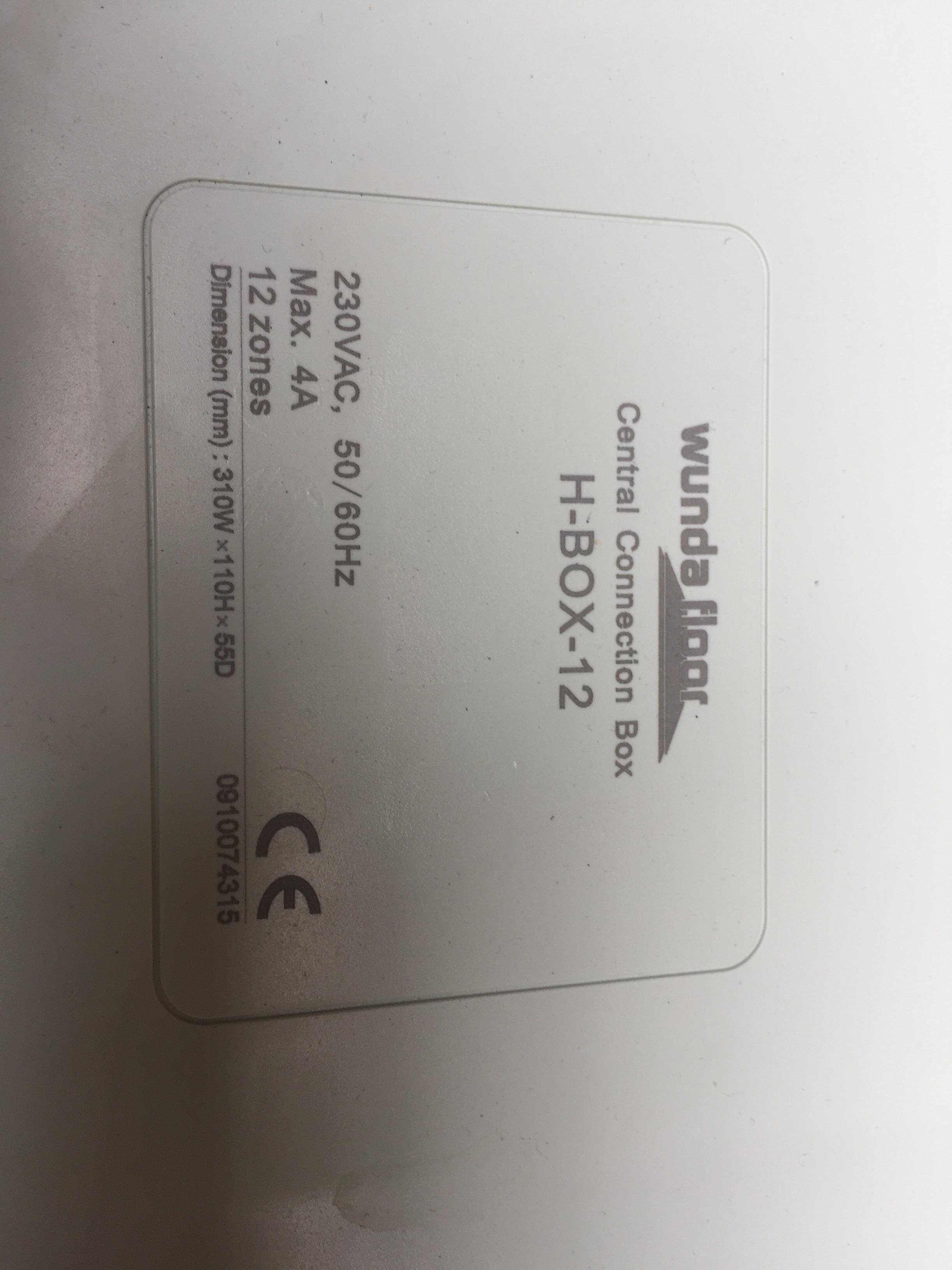

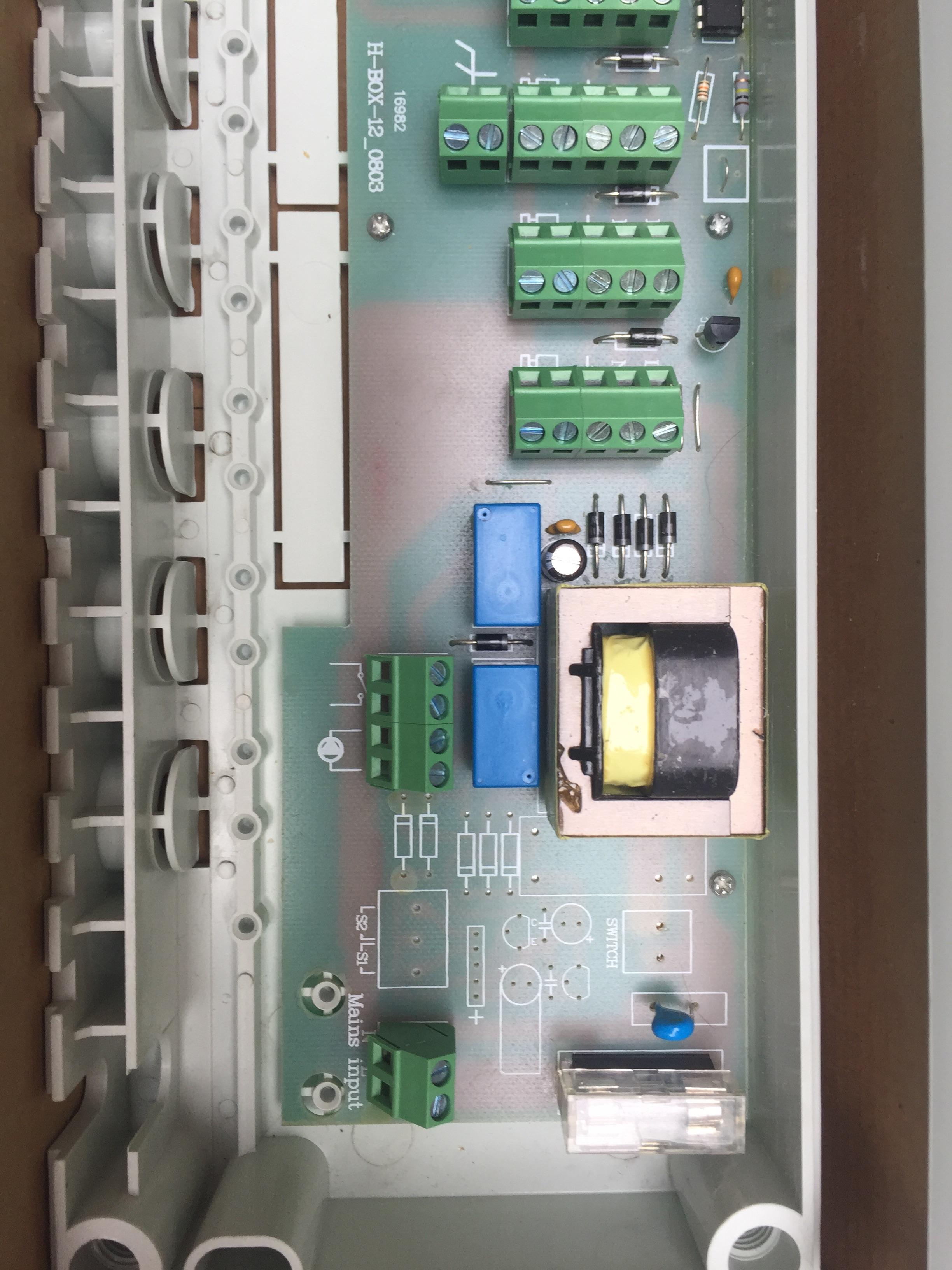

Nickfromwales Posted May 24, 2018 Share Posted May 24, 2018 @ProDave This any good ? Link to comment Share on other sites More sharing options...
ProDave Posted May 24, 2018 Author Share Posted May 24, 2018 That's pretty normal. The way they stack the terminals, things get very cosy indeed when you have a thermostat and then say 3 actuators connected to each zone. How much did that one cost? Link to comment Share on other sites More sharing options...

Nickfromwales Posted May 24, 2018 Share Posted May 24, 2018 32 minutes ago, ProDave said: How much did that one cost? Your missing the point dave That was a remnant, ( left over item from @newhome's conundrum of plumbing bewilderment ), which is going begging. If it's any good it's your FOC. ? Link to comment Share on other sites More sharing options...
PeterW Posted May 24, 2018 Share Posted May 24, 2018 http://www.wundafloorheating.co.uk/wp-content/uploads/2017/02/E09-Generic-wiring-Plumbing-Guide-Oct-5-2017.pdf wiring for it is E09 I think. Link to comment Share on other sites More sharing options...

ProDave Posted May 24, 2018 Author Share Posted May 24, 2018 I will almost certainly use the one I have just bought for the downstairs manifold. Now I have put it in a spare DIN rail enclosure, it is such a perfect fit. Then I will use the one from @newhome with the yet to be bought manifold for upstairs. 2 Link to comment Share on other sites More sharing options...
