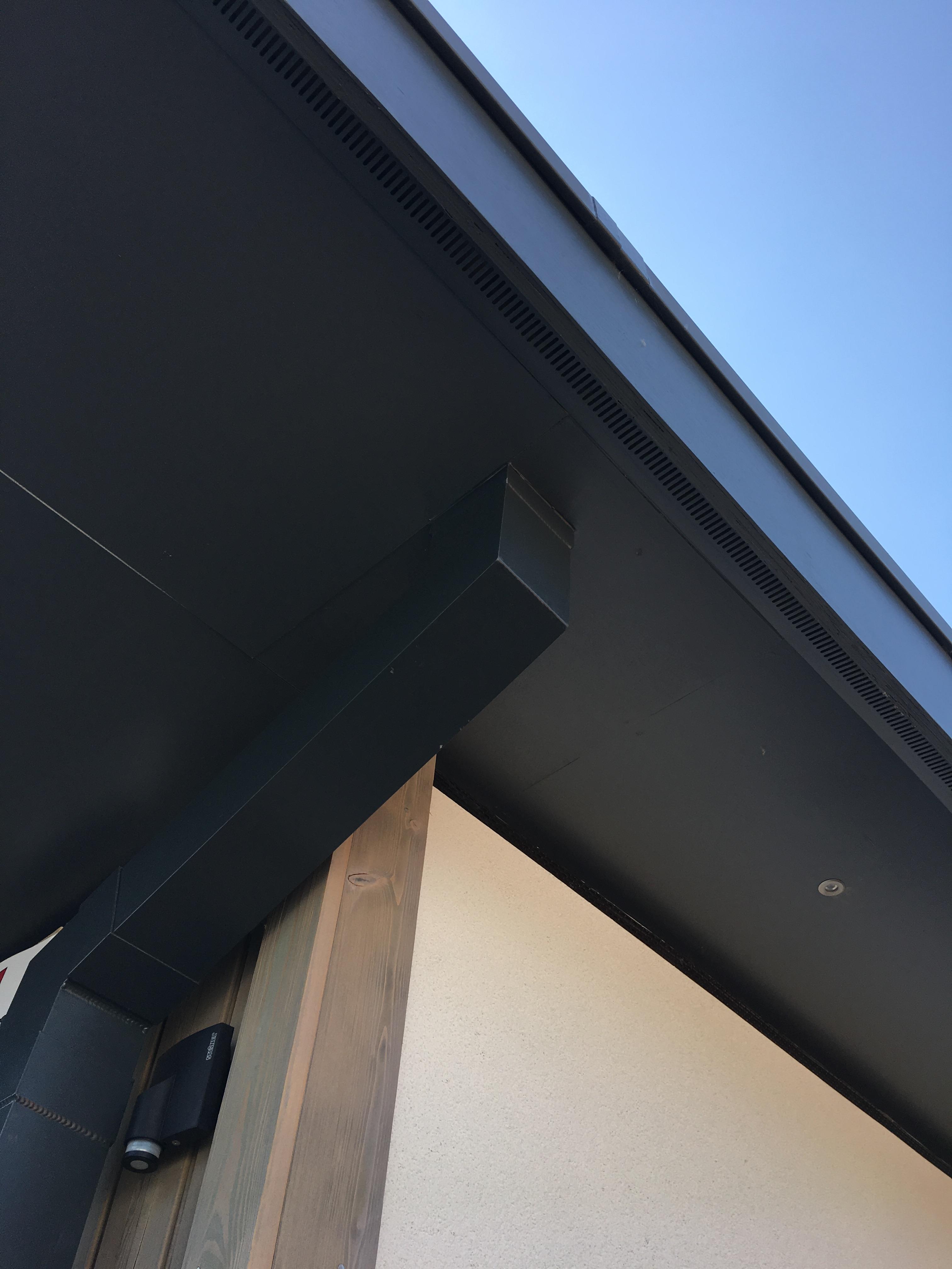

I have a cold roof on top of the MBC warm roof.  MBc provided us with a flat deck and then we built another shaped roof on top to meet our design/planning requirements.
Cold roof definately needs ventilating.  We have large overhanging soffits and have a continious ventilation grill running all the way around (thats how the buzzing stripey things got in to nest). I believe that TRADA have some guidelines for the amount of ventilation needed. We have a lot and it is crossflow too but we are venting +250sqm of roof.
Our vent strips are painted the same colour as the soffits so they are less visible. They are invisible unless you look up under soffit you would not know they were there looking at the house as fascias are not affected. ED163F4A-05EA-42FB-94EA-035CCB6609A1.thumb.jpeg.9820baf66fa1677ac85acee3eebe6236.jpeg Not sure if photo of ours is clear enough to show vents.
