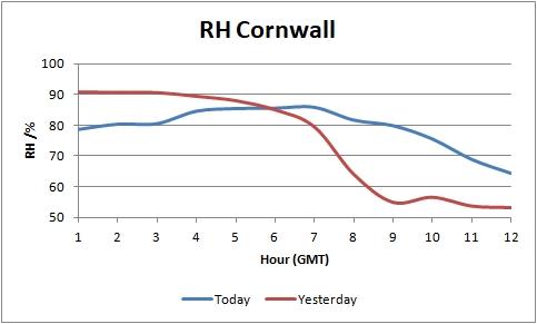

SteamyTea Posted May 24, 2018 Share Posted May 24, 2018 (edited) 32 minutes ago, lizzie said: Good news is humidity level in house is now 42% and much more comfortable. Bad news I say, I felt good yesterday and dreadful today. Edited May 24, 2018 by SteamyTea Link to comment Share on other sites More sharing options...
lizzie Posted May 24, 2018 Author Share Posted May 24, 2018 6 minutes ago, SteamyTea said: Bad news say, I felt good yesterday and dreadful today. Thats high. I would not feel good with that! About 45% is my optimum level. Which website are you using for those stats - are you able to post me a link. Thanks Link to comment Share on other sites More sharing options...
SteamyTea Posted May 24, 2018 Share Posted May 24, 2018 I monitor the RH and Temperatures myself. Just a DHT22 and a Raspberry Pi. Easy and cheap to set up. You could try WeatherUnderground to find a local weather station. https://www.wunderground.com/ 1 Link to comment Share on other sites More sharing options...
