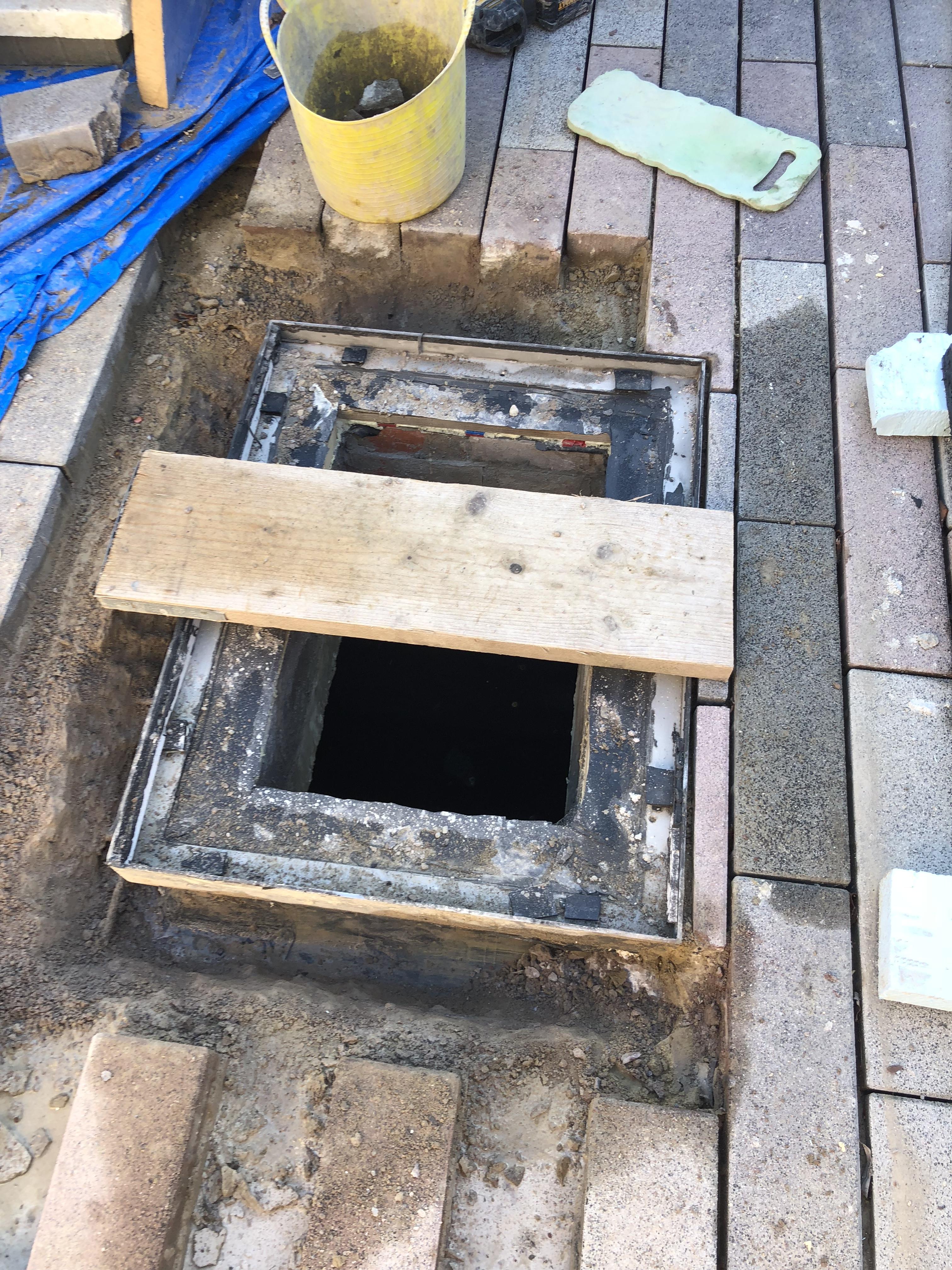

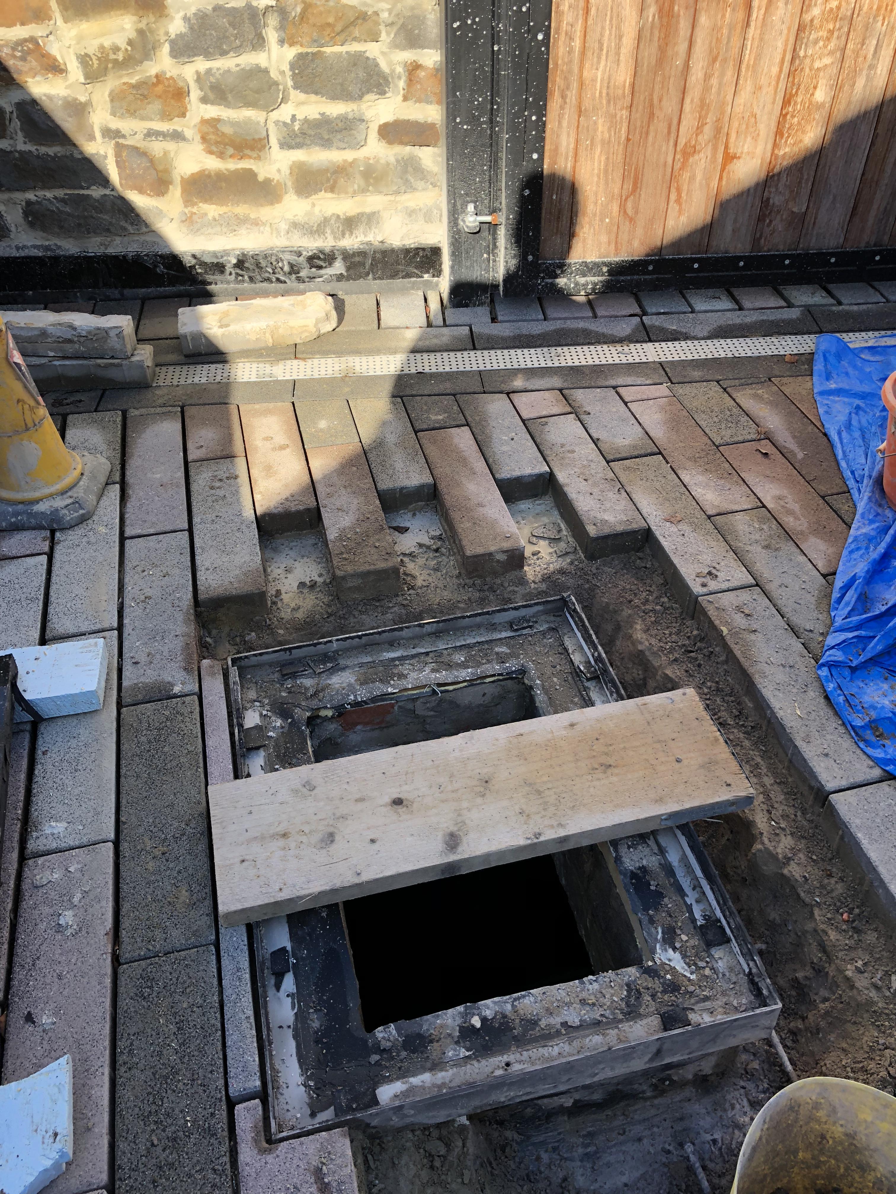

Pocster Posted October 18, 2018 Author Share Posted October 18, 2018 My other thought is the water could be getting under the nearest window and running down to the other !!! So I would need to both to be certain water proof Link to comment Share on other sites More sharing options...
Declan52 Posted October 18, 2018 Share Posted October 18, 2018 Honestly I think take it all back to the top of the concrete and break around each window and continue to remove the upstands as you have been doing. Get your architect to do proper drawings and then do as it's on these for test window 1. Create a dam with sand and fill the hole with water around the test window and observe. Let it sit for a day and if it's good then proceed with the rest. If it leaks and it's done as is on the drawing then it's up to your architect to come up with plan B. Repeat as above. 2 Link to comment Share on other sites More sharing options...
Pocster Posted October 18, 2018 Author Share Posted October 18, 2018 14 minutes ago, Declan52 said: Honestly I think take it all back to the top of the concrete and break around each window and continue to remove the upstands as you have been doing. Get your architect to do proper drawings and then do as it's on these for test window 1. Create a dam with sand and fill the hole with water around the test window and observe. Let it sit for a day and if it's good then proceed with the rest. If it leaks and it's done as is on the drawing then it's up to your architect to come up with plan B. Repeat as above. Yeah I did think of a dam around each one and soak will keep breaking out Link to comment Share on other sites More sharing options...
Pocster Posted October 18, 2018 Author Share Posted October 18, 2018 Architect thinks he knows someone who does rubber . My concern is he might say he wants it stripped right back and ripped out . Then he’s starting afresh and not with a bodge . Link to comment Share on other sites More sharing options...
Declan52 Posted October 18, 2018 Share Posted October 18, 2018 1 minute ago, pocster said: Architect thinks he knows someone who does rubber . My concern is he might say he wants it stripped right back and ripped out . Then he’s starting afresh and not with a bodge . Has to be some method of joining two bits of rubber. Link to comment Share on other sites More sharing options...

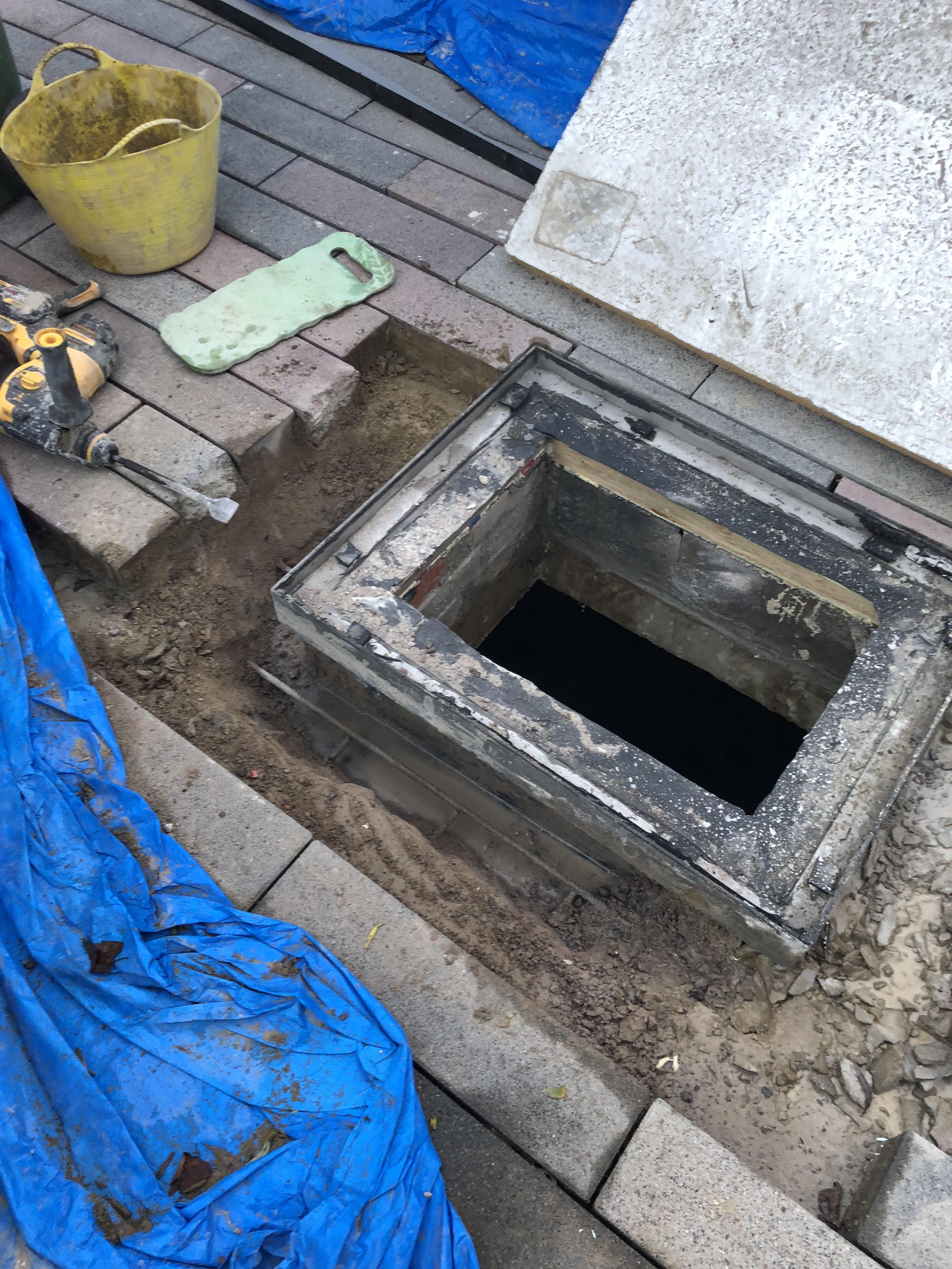

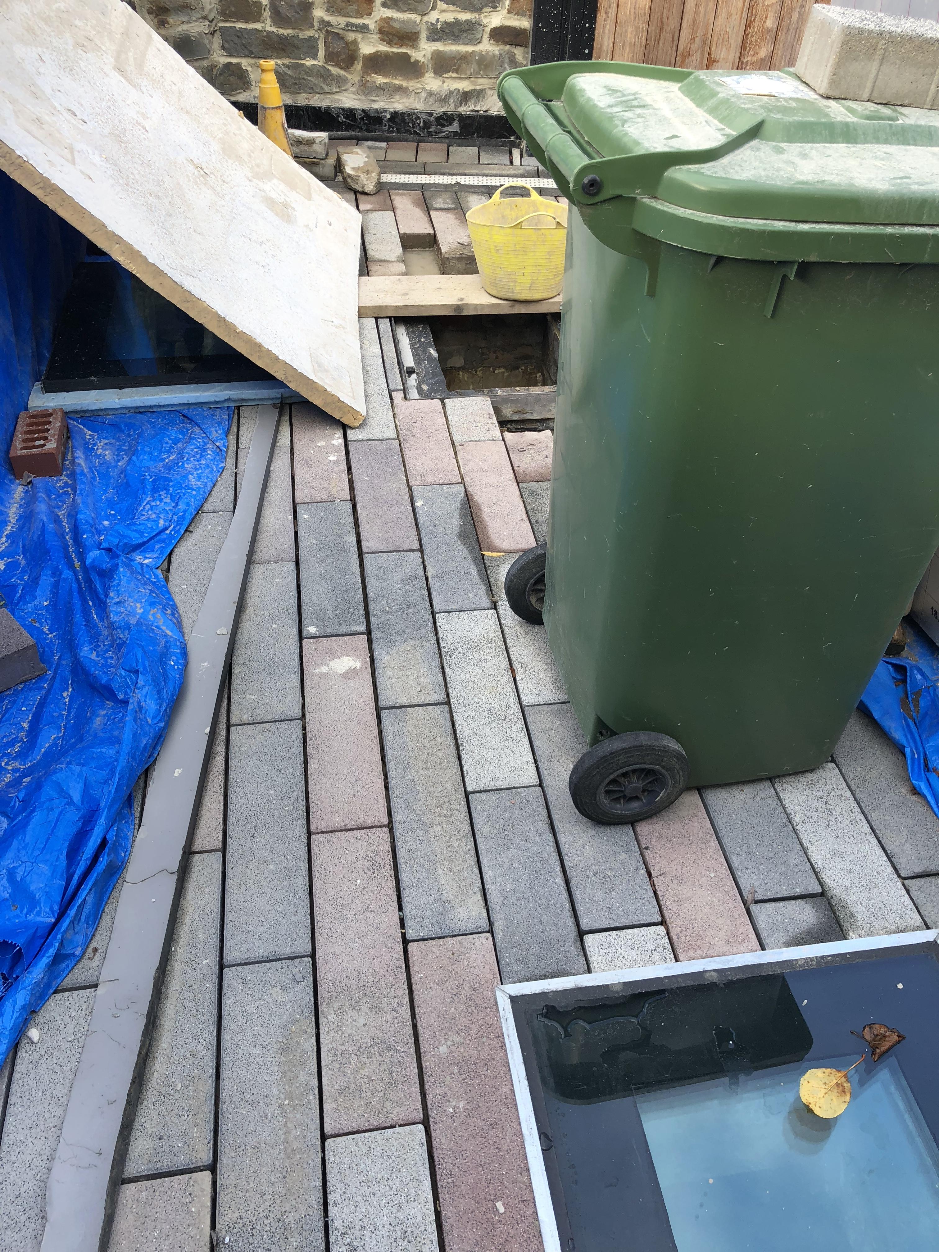

Pocster Posted October 19, 2018 Author Share Posted October 19, 2018 3 sides exposed . Nothing at this point suggests the water getting under the rubber . What worries me now is water runs over this upstand and it doesn’t leak . But runs to the front of the site - has no where to go so pools and *perhaps* goes under my rubber extension to their piss poor attempt at the edges . This upstand once done properly and entombed in water would prove it doesn’t leak ; but somewhere else is . Still ! Try and get 4 sides exposed today and that frame off ( as @PeterW said - stuck down with structural silicone it doesn’t want to move !!! Link to comment Share on other sites More sharing options...

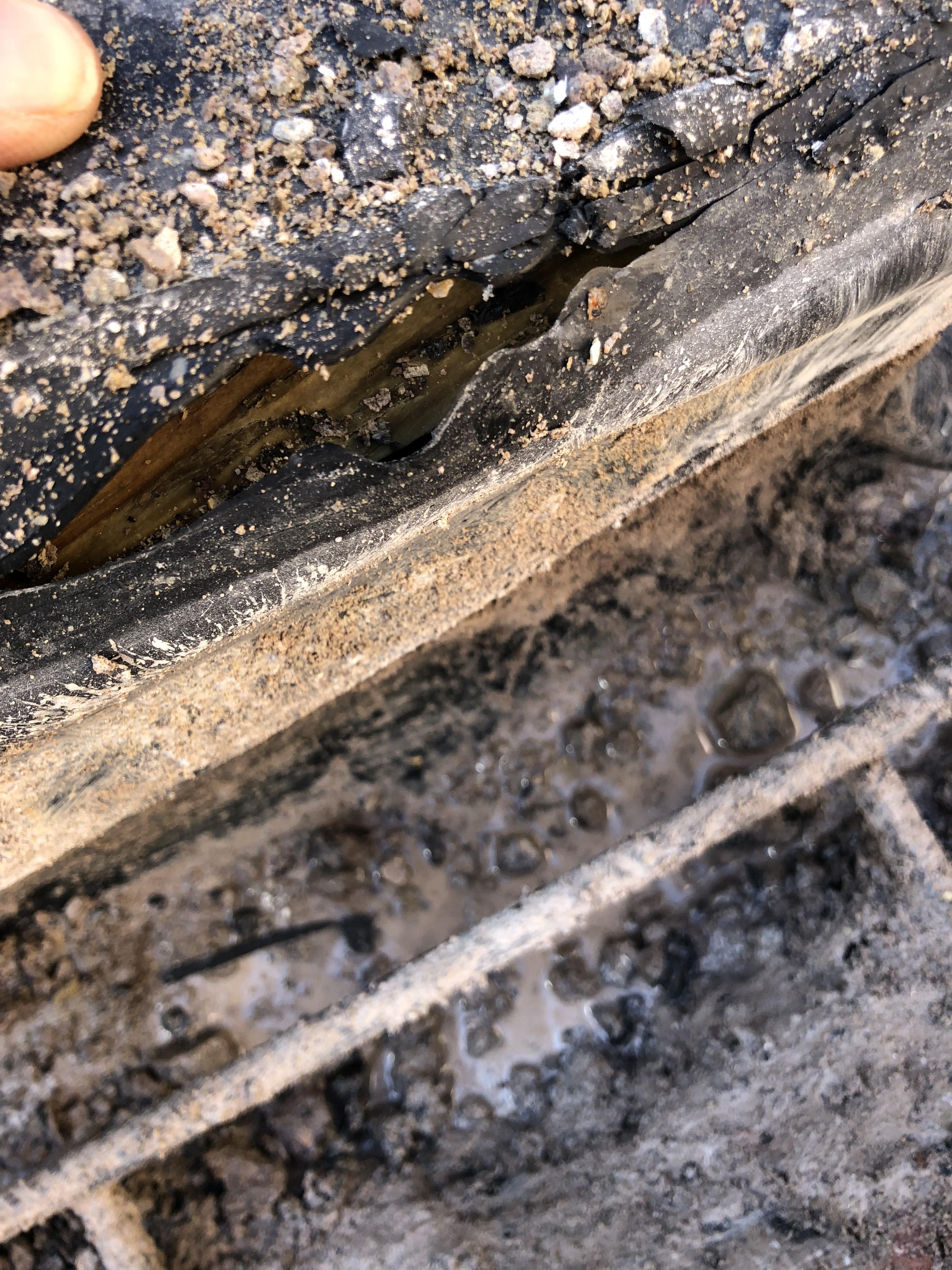

Pocster Posted October 19, 2018 Author Share Posted October 19, 2018 Right whilst not the issue a concern ! Looks like the metal frame can tear the rubber ( or I did it when removing it ) Link to comment Share on other sites More sharing options...
