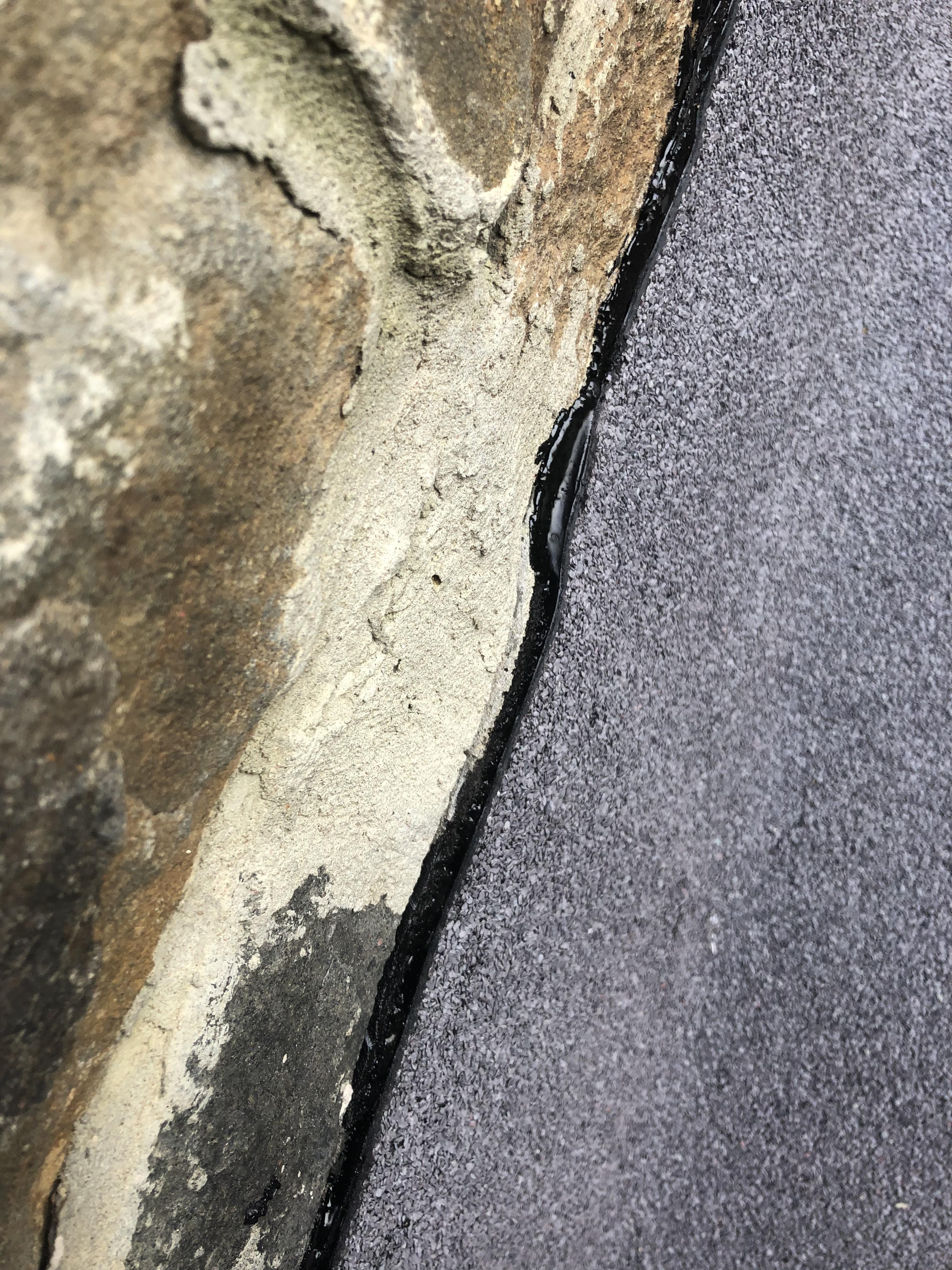

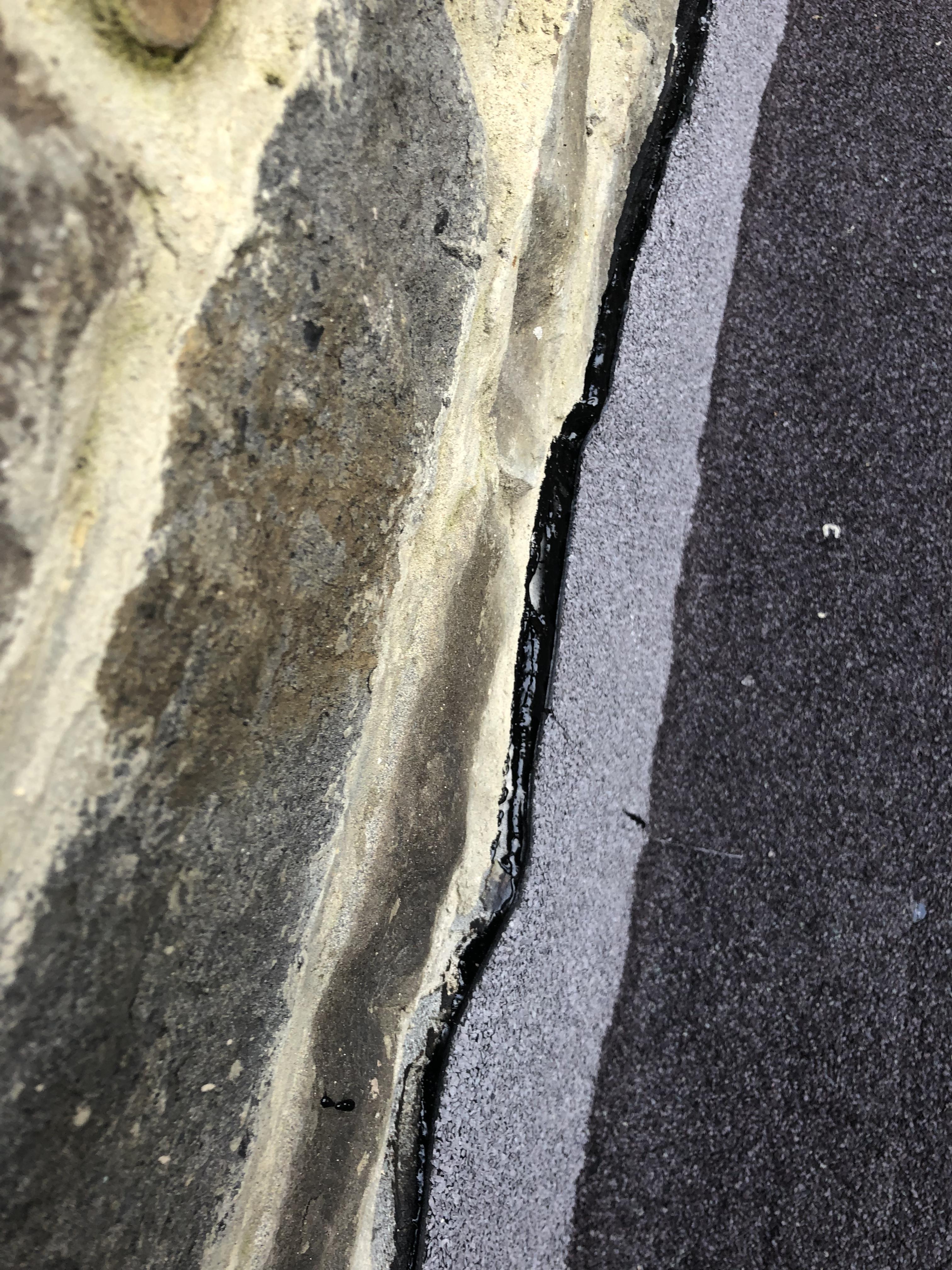

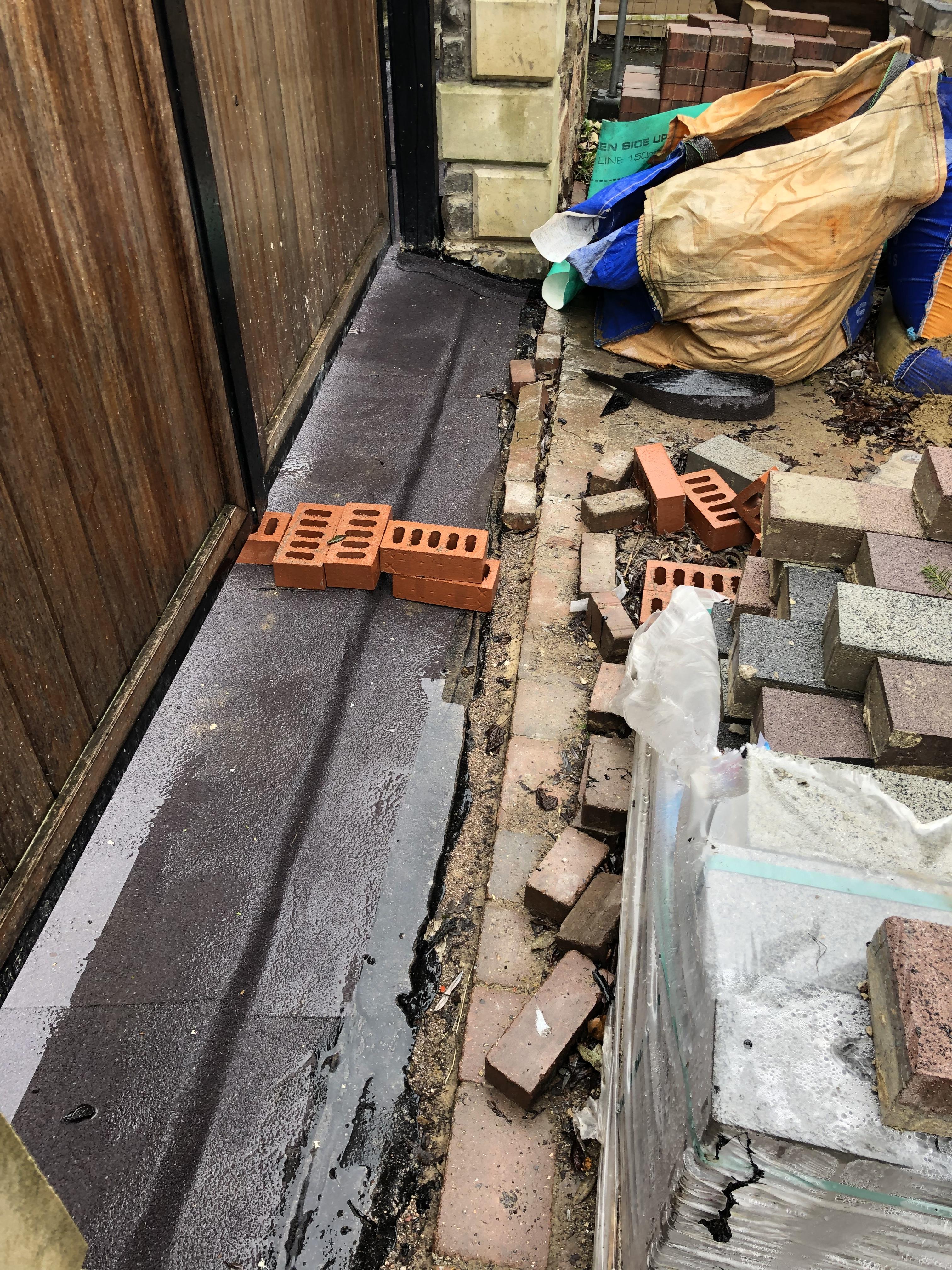

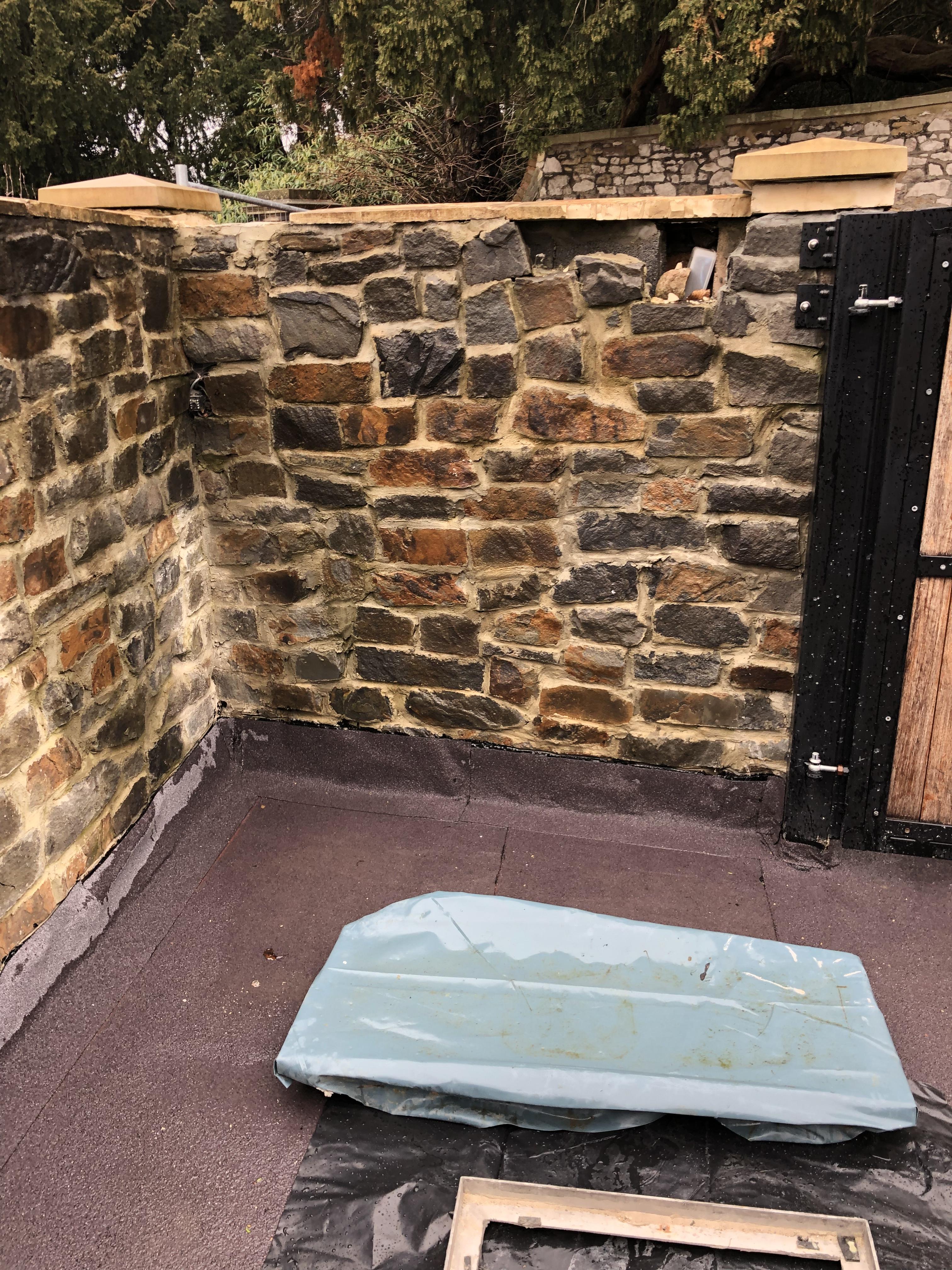

Not at the site. But took this photo because the gate hinges will need moving up 50mm
What I do notice where the permatec goes vertical up the stone work it does look like it's fully bonded - so *perhaps* flashing isn't required !

Posted
I assume you will be flashing it anyway along the wall as belt n braces but also to create a nice crisp transition ?
Posted
Roofers been
He said price didn’t include flashing (ffs) ; but said it did need it and gave me a guys number .
The ‘test’ took all of 4 minutes - guy with a broom type device
Posted
Unbelievable....... you need to triple check your warranty man, to the point of maybe getting a solicitor to verify it...... you also need to flood test it ASAP and triple check all possible points of weakness, like behind the gate pillars...I’m sure they are stand up chaps but to have talked about flashings and then tell you they are an add on is a potential red flag.
Posted

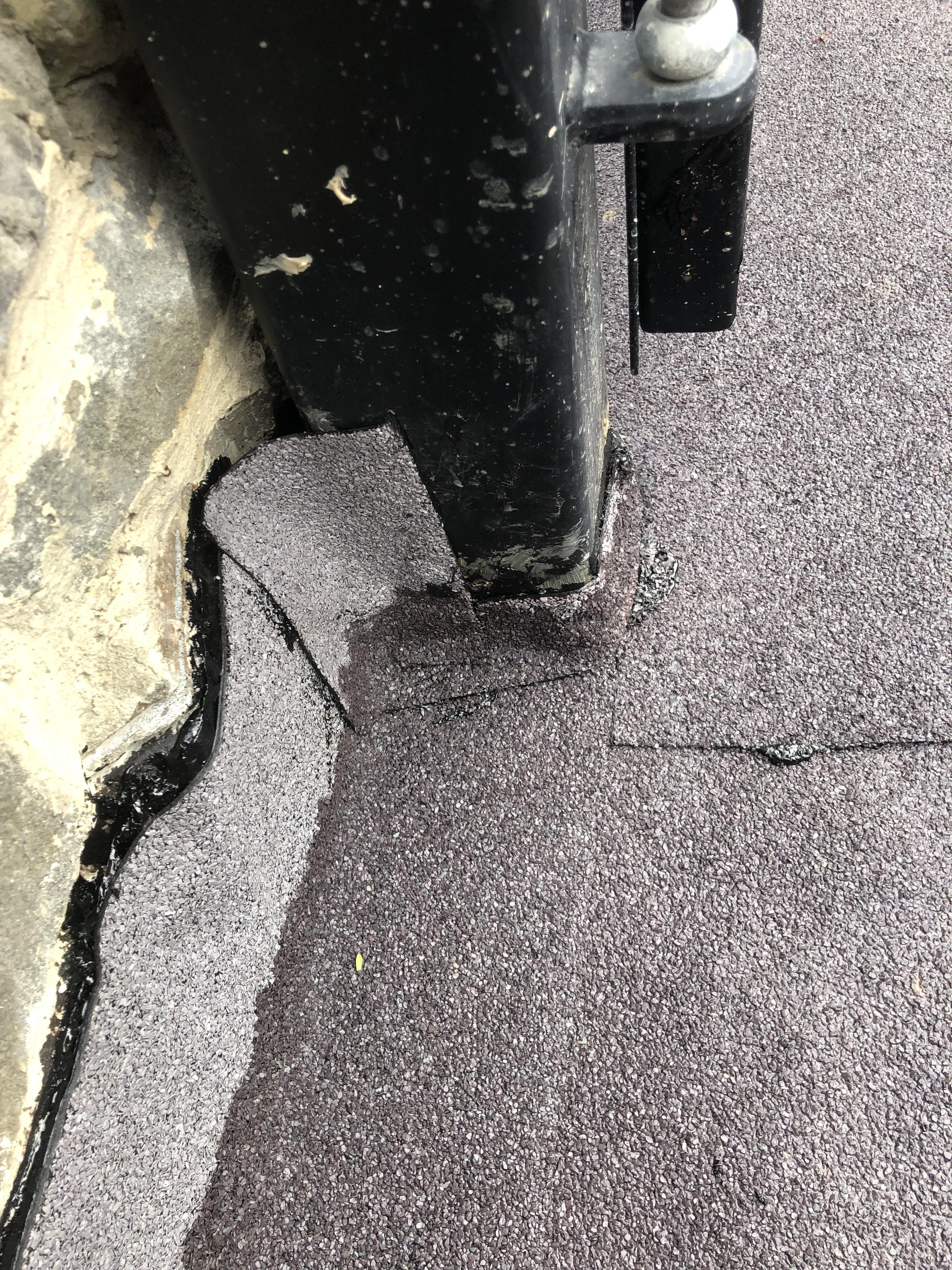

What happens on the far side of the gate ? I assume this is where water will run off, but how is it detailed ?
Posted
It passed the test so will get the 25 yr warranty .
You are quite right behind the gate pillars was tricky ( they showed me this without me prompting) they’ve ‘poured’ bitumen in that gap . Between the gates the bitumen runs through them so water will run off ( will get a photo up later ) .

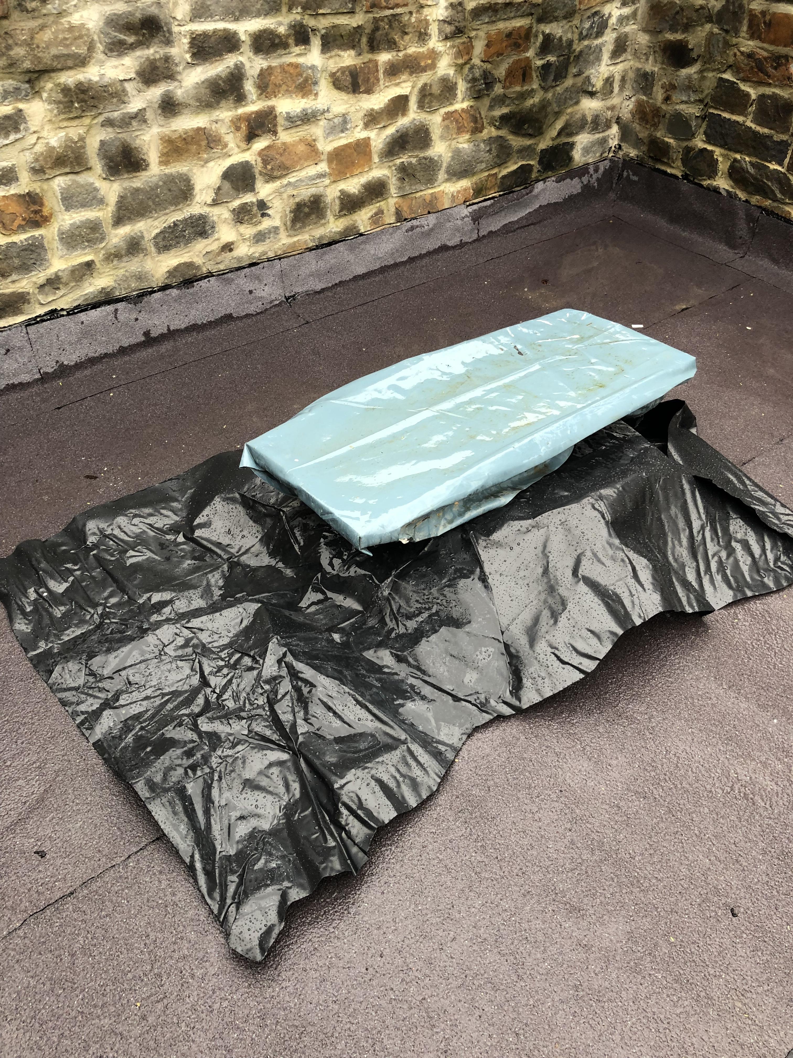

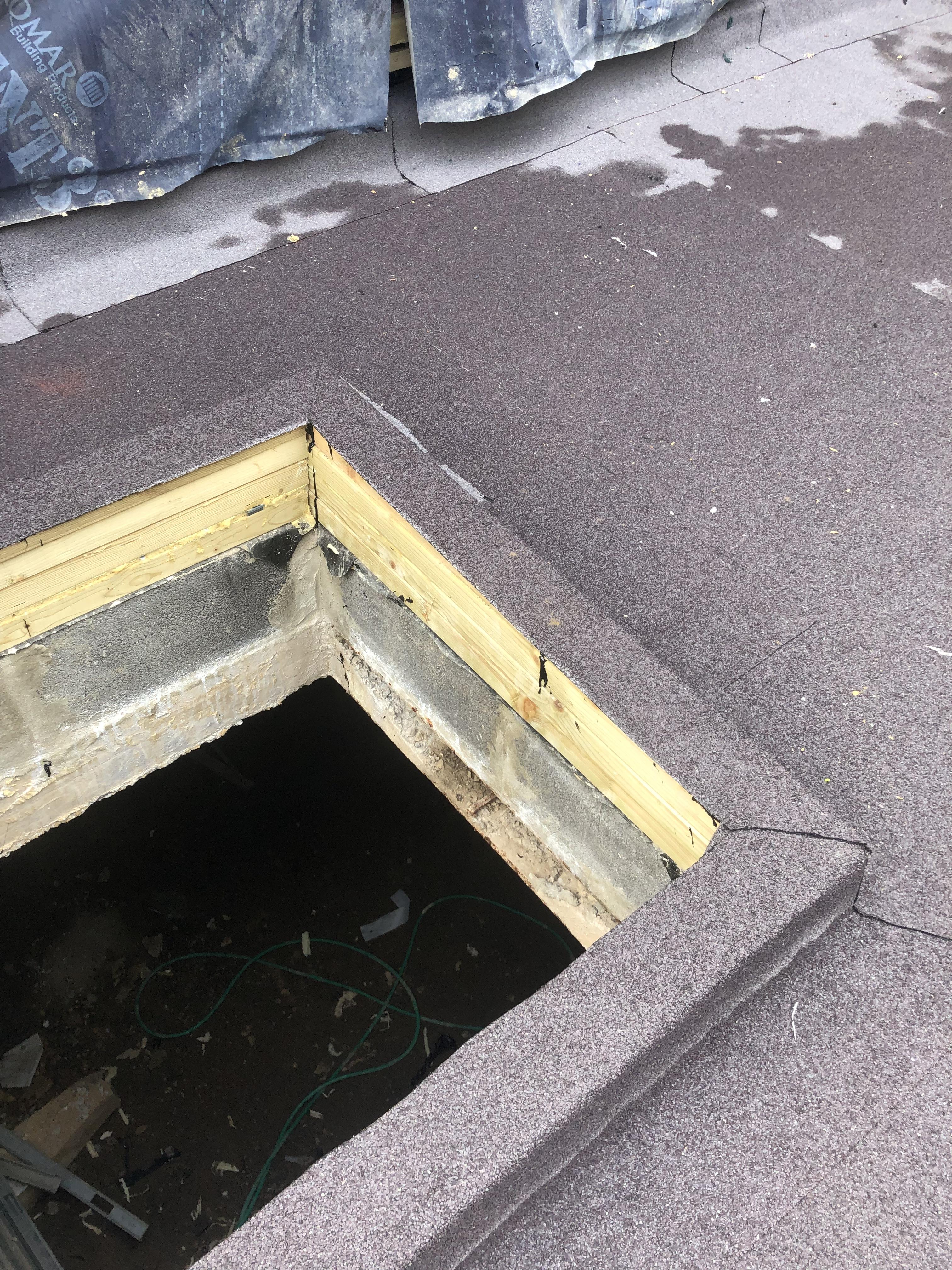

Have completely covered the walk on sky light holes - just waiting for rain .
Posted
Have you made sure that what you have covered then with is folded down at the edges as otherwise water will track under and either cause you some confusion or a hernia
Posted
Yep .
Its ok - I know exactly where to look for leaks .

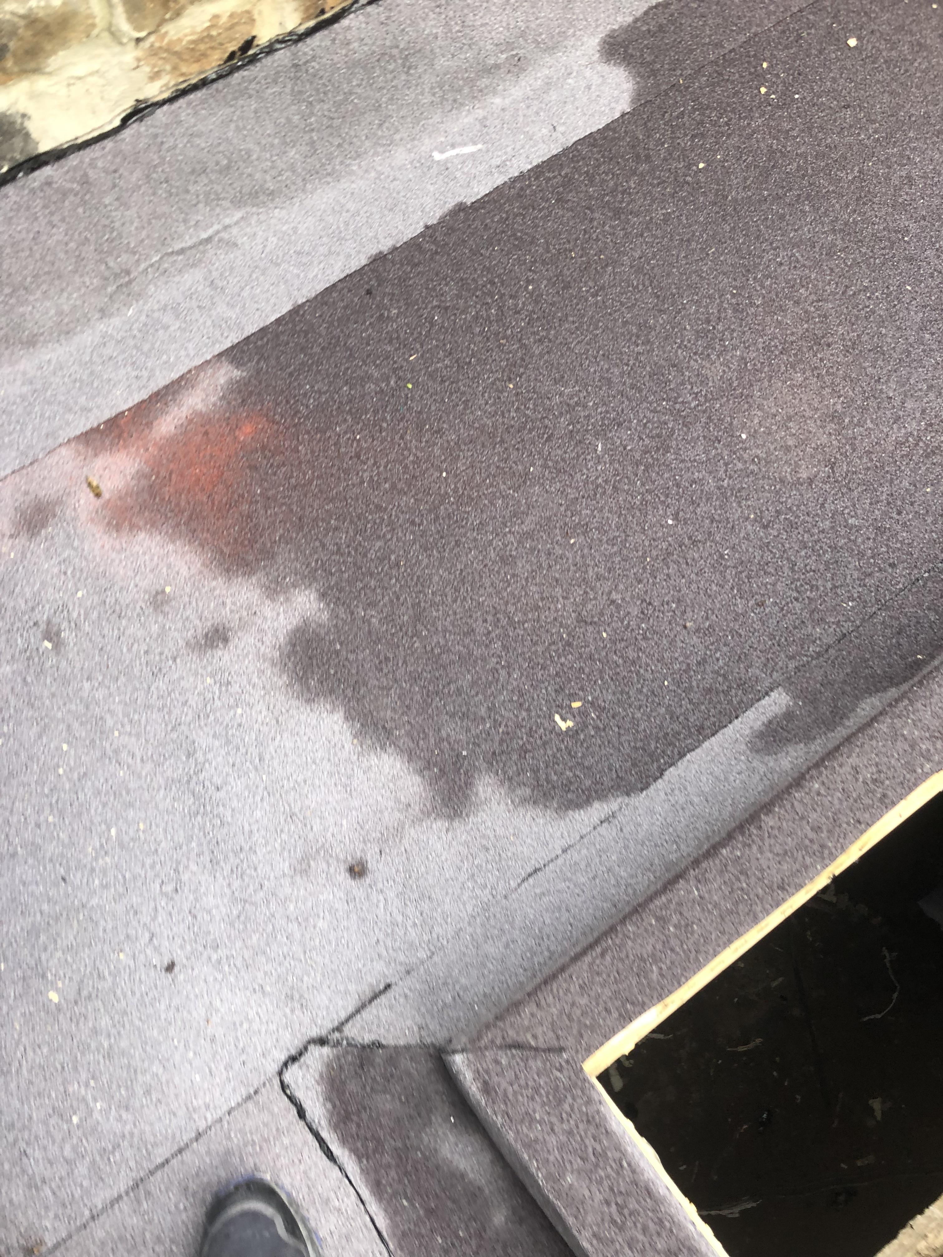

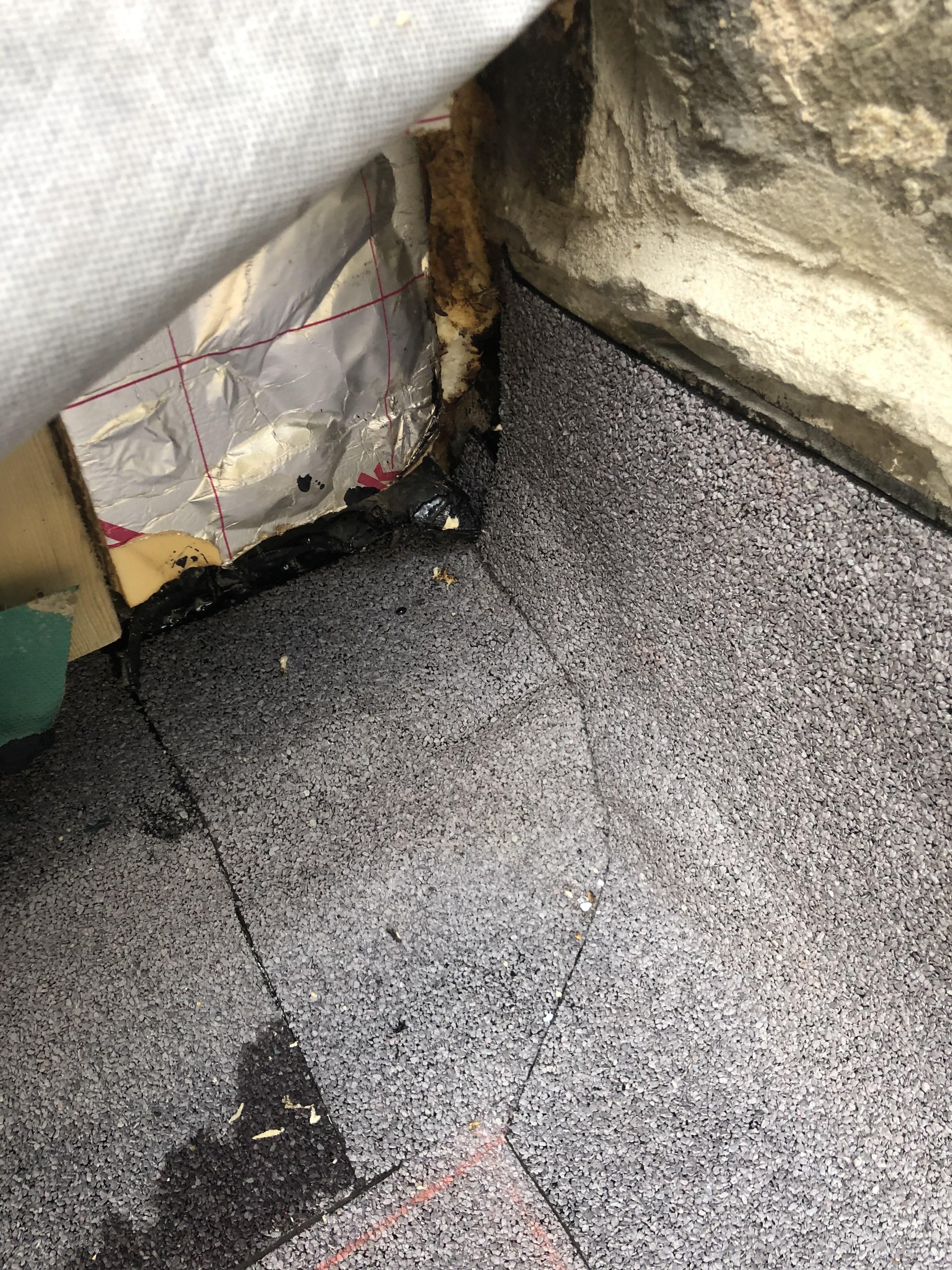

Posted (edited)
Ok
We’ve had fairly decent rain so I went to look at the site . Gates blown open and knocked a window cover over - so water there expected . 2 seem dry . 1 slight water as expected . Other not so sure ( the smaller one with water tracking marks from the corners .
Remember no flashing at the moment

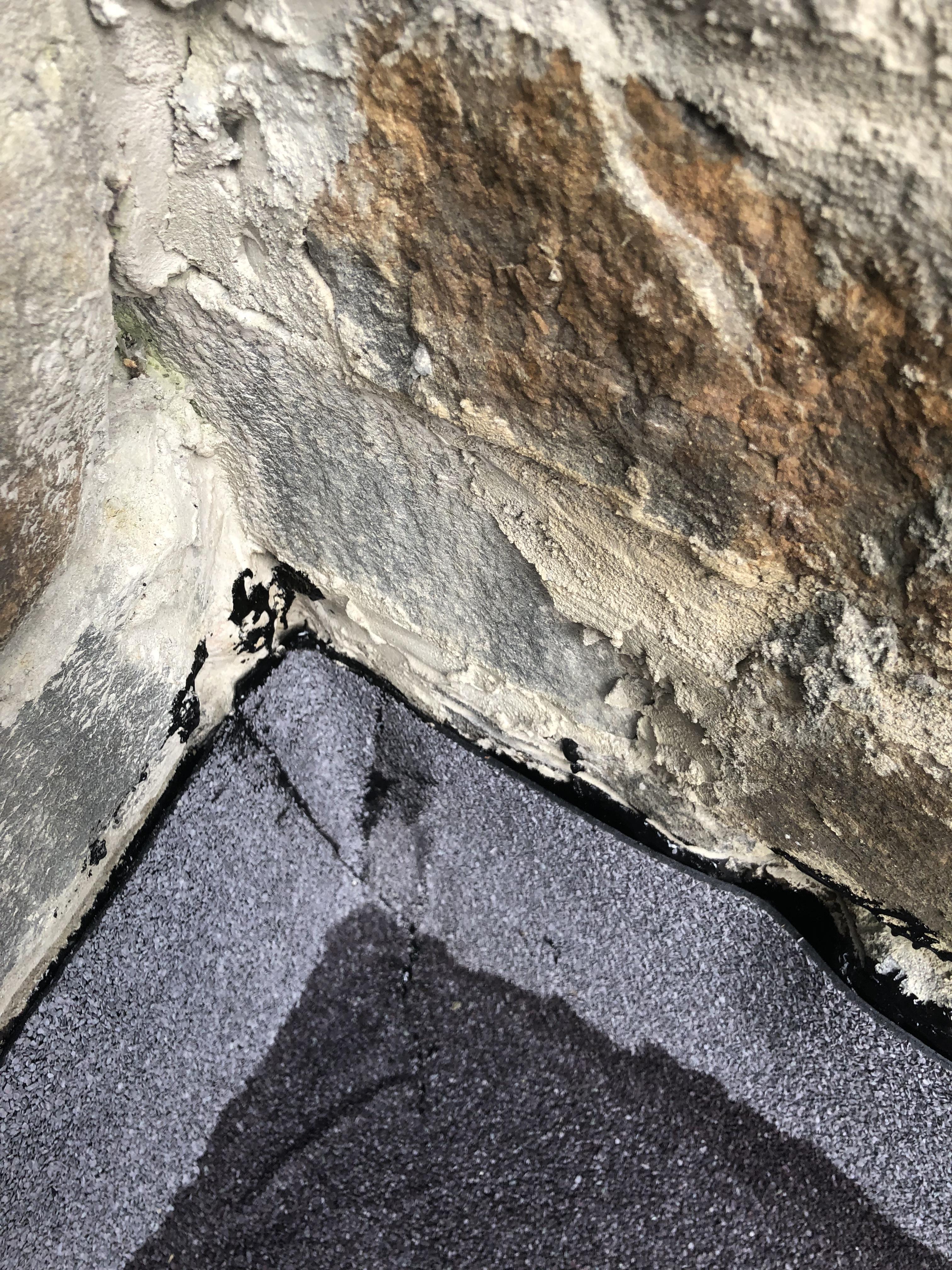

Posted
This is the wall near the troublesome window . Looks like it got saturated in the rain - so with no flashing possibly the problem ?
i’ve covered the window better this time - see what happens
Posted
So !
i hose that corner wall for a good 10 minutes. Run underneath- can’t see any obvious difference ! ?
What I meant is the water track marks from the corners look the same ! Not good news .

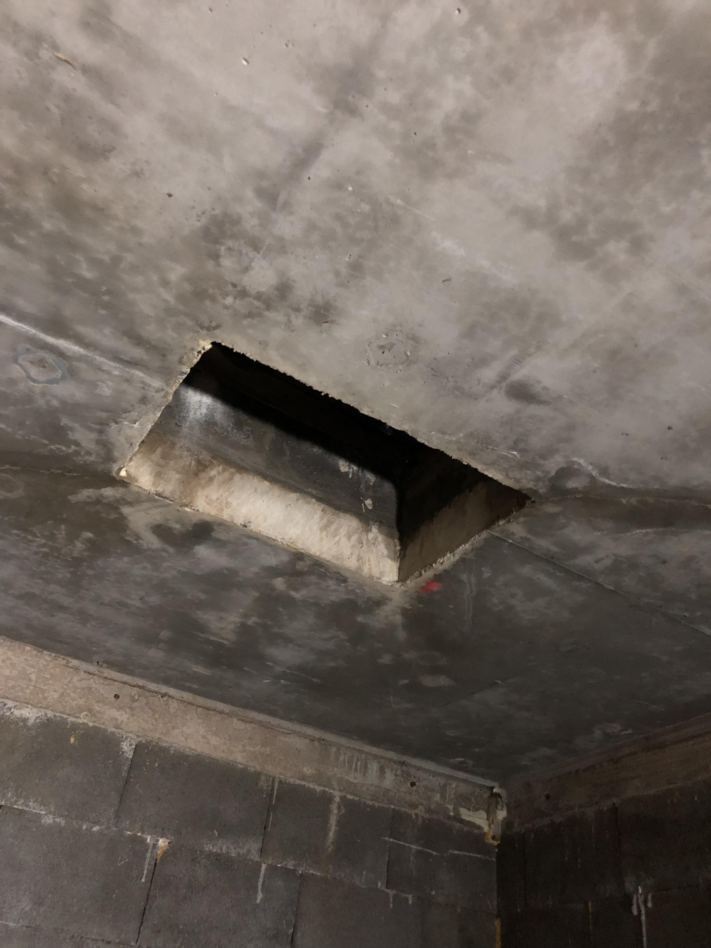

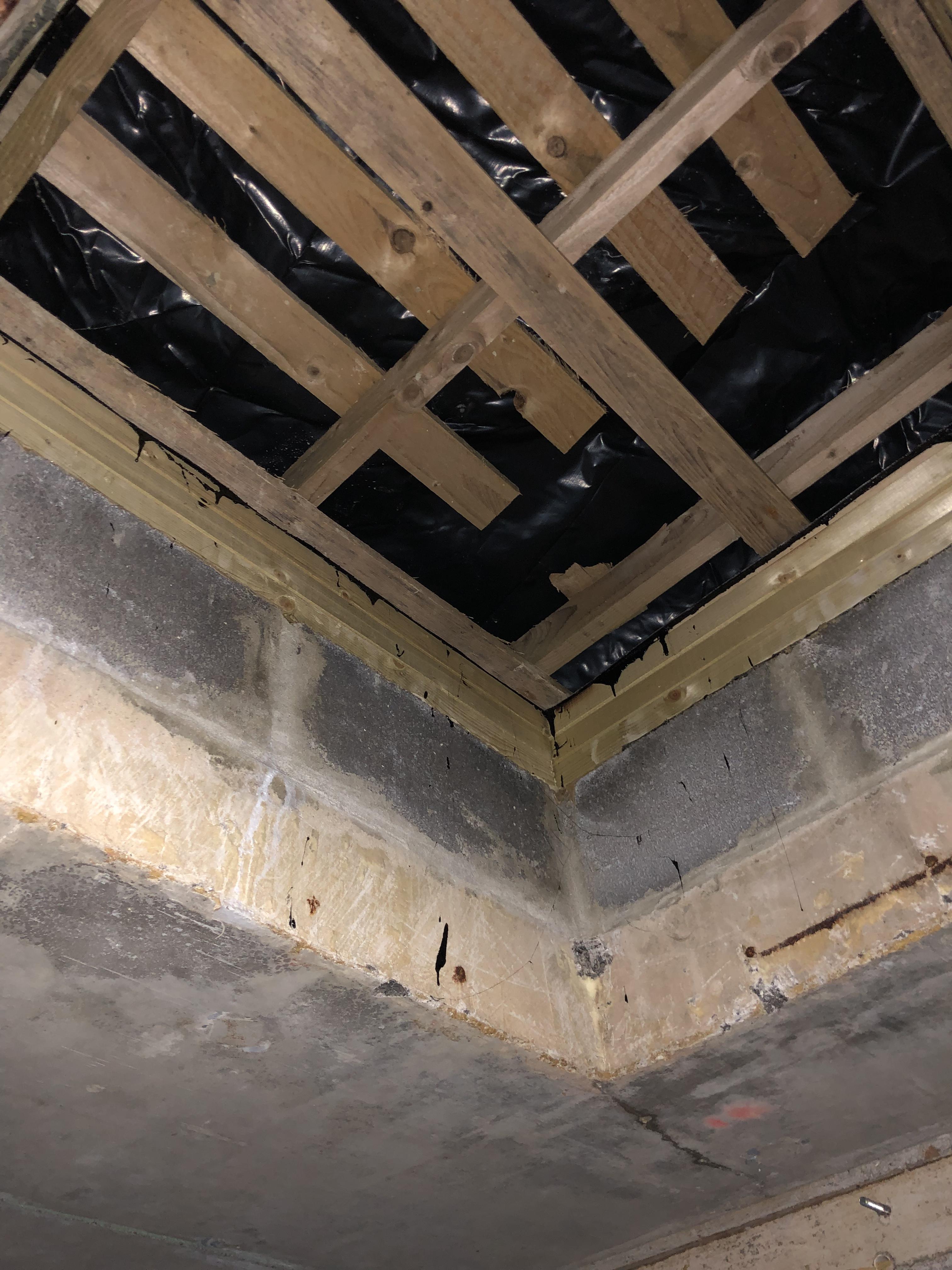

Posted
Dumb question.
I've seen LOTS of condensation before in the basement area i.e. droplets on the concrete ceiling with no track marks,
On these window corners as a test ; if I foam gunned come PIR to the problem areas and indeed even up the inside of the upstand.
*In theory* after rain etc. if I removed the stuck PIR and no water tracking was visible on the concrete then that would confirm it's a condensation issue where the concrete reaches dew point.
Dumb idea? or just incorrect!
Posted
really tricky to differentiate between condensation and water ingress in this situation....... I suppose by lagging the cold spots in theory should eliminate condensation from this area but it may just form on the next coldest spot......

Posted (edited)
Don't do this, WAIT for someone more knowledgeable to comment...
That inside concrete reveal under the roof lights, could you paint that with black concrete paint so you can see if water runs down it. Thinking bare concrete will soak anything up?
