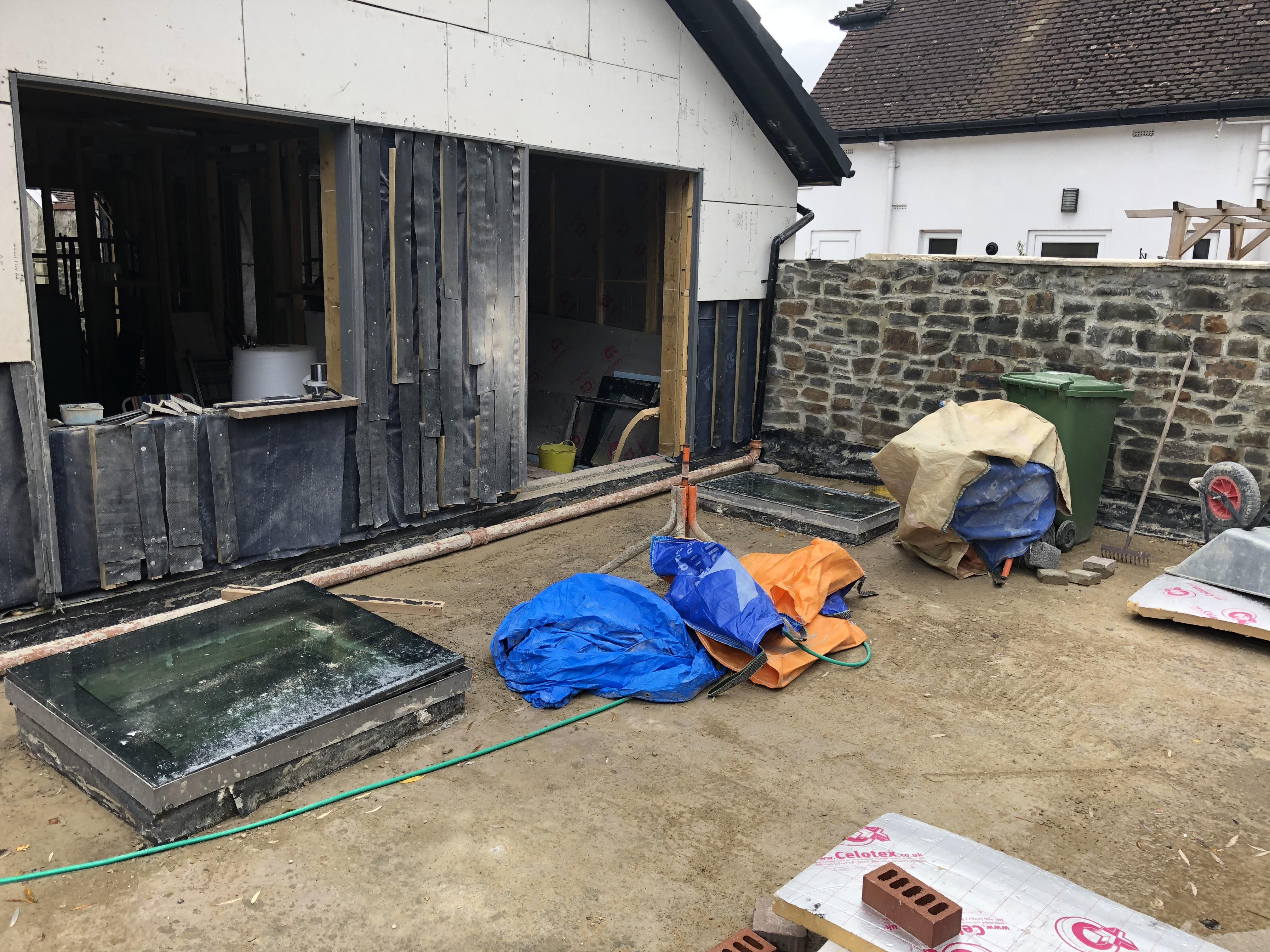

Pocster Posted October 30, 2018 Author Posted October 30, 2018 Right! Had many a "roofer" out. Today a guy from about a week ago wanted to view again with 2 technical guys. They were speechless. Said it was the worst rubber install ever. The site is unique and non-standard and that the architect was wrong to insist on rubber. The 'details' at the front (around gate posts etc.) being the main issue of concern. They looked for a good hour - pulling many faces. Ultimately they seemed to agree that it could 'probably' be done with a liquid membrane . SIG are out tomorrow - be interesting too see how shocked he will be!

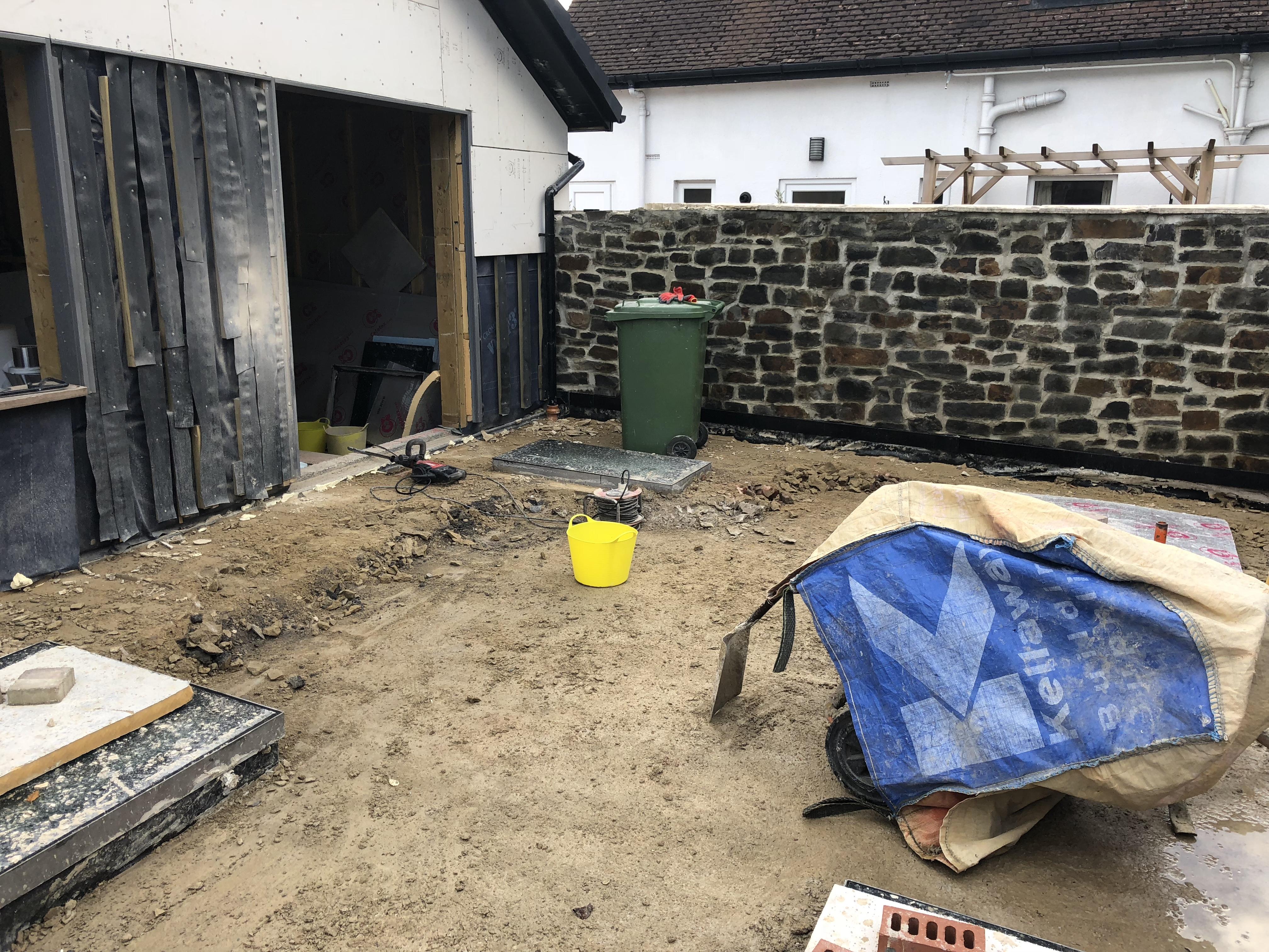

Mr Punter Posted November 1, 2018 Posted November 1, 2018 How far have you taken this down? Is the membrane under the stuff we can see?
Pocster Posted November 1, 2018 Author Posted November 1, 2018 1 hour ago, Mr Punter said: How far have you taken this down? Is the membrane under the stuff we can see? Yes . So the lower bit is the 30mm reinforced concrete on the rubber . sig said to get back this was fine ; then screed a fall
Mr Punter Posted November 1, 2018 Posted November 1, 2018 That is good as the rubber membrane looked fine, just the detailing and drainage. I imagine that just removing the build up as you have will halt the water ingress.

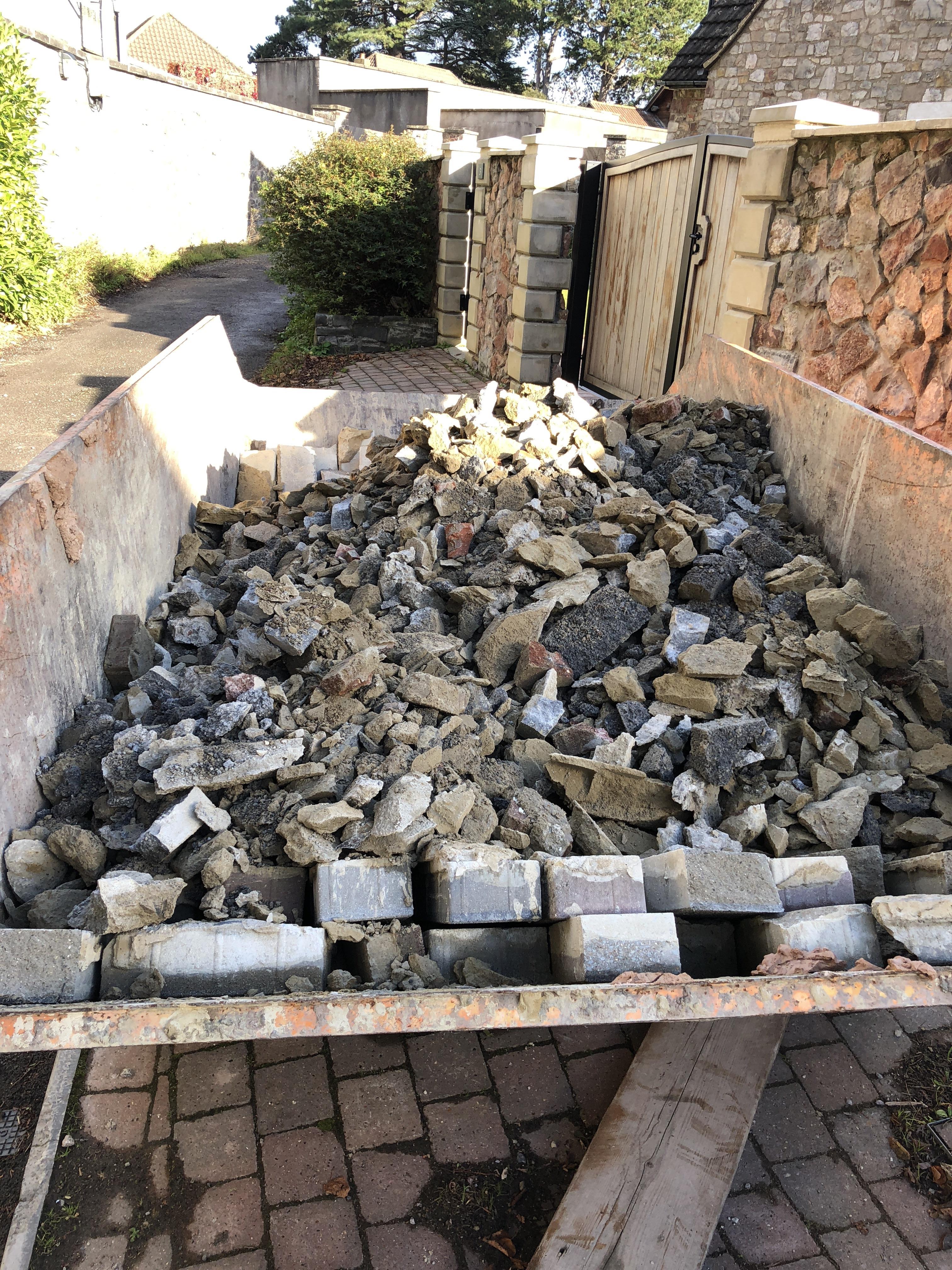

Pocster Posted November 1, 2018 Author Posted November 1, 2018 6 minutes ago, Mr Punter said: That is good as the rubber membrane looked fine, just the detailing and drainage. I imagine that just removing the build up as you have will halt the water ingress. Oh I don’t doubt it . The water level will effectively lower now . My back aches - filling up a 10 yard skip ?

Pocster Posted November 14, 2018 Author Posted November 14, 2018 Right ! Finally all clear - still waiting for SIG man to get back too me after initial visit
