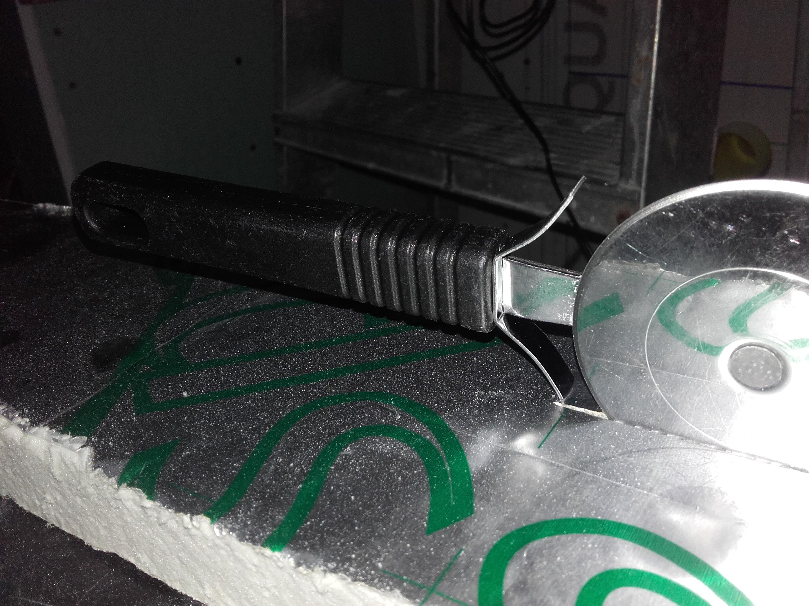

Russell griffiths Posted May 12, 2018 Posted May 12, 2018 Ere mr @Onoff do you reckon you can knock one of these up. 1
Onoff Posted May 12, 2018 Posted May 12, 2018 12 minutes ago, Russell griffiths said: Ere mr @Onoff do you reckon you can knock one of these up. It's finding a pizza wheel that big that's the problem!

Onoff Posted May 13, 2018 Posted May 13, 2018 I just tried (on the quiet ) a cheapo pizza wheel on a bit of 25mm pir. Cuts it like a dream! You need to ideally push the blade against the non foiled end like in the video. Pushing the blade into the foiled face and there's some resistance. I wonder how thick a say 300mm dia blade would need to be to remain rigid whilst offering as little resistance as possible? Scale it up and job done!

Onoff Posted May 13, 2018 Posted May 13, 2018 I reckon a 400mm disc so you could cut +150mm thick. How to sharpen then a say 2mm thick disc?
