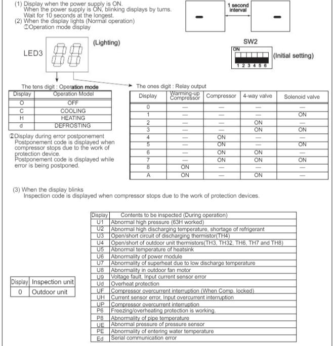

DeeJunFan Posted January 8, 2020 Posted January 8, 2020 On 08/01/2020 at 20:48, Declan52 said: Not having much luck then Dee. Expand You don't know the half of it. This is a mere inconvenience at the moment. @ProDave and @dpmiller the plot thickens somewhat. My father came down this evening and insisted on changing the isolater and when the heat pump started up I was expecting the same startup process as earlier this evening H6 code and fan to start up etc and then trip. But this time the code 08 was displayed on the PCB display and the fan didn't start up there was a strange humming sound coming from the board and nothing tripped. The insulation test was just standard voltage so I didn't think it would change anything in terms of the function. But there you go.

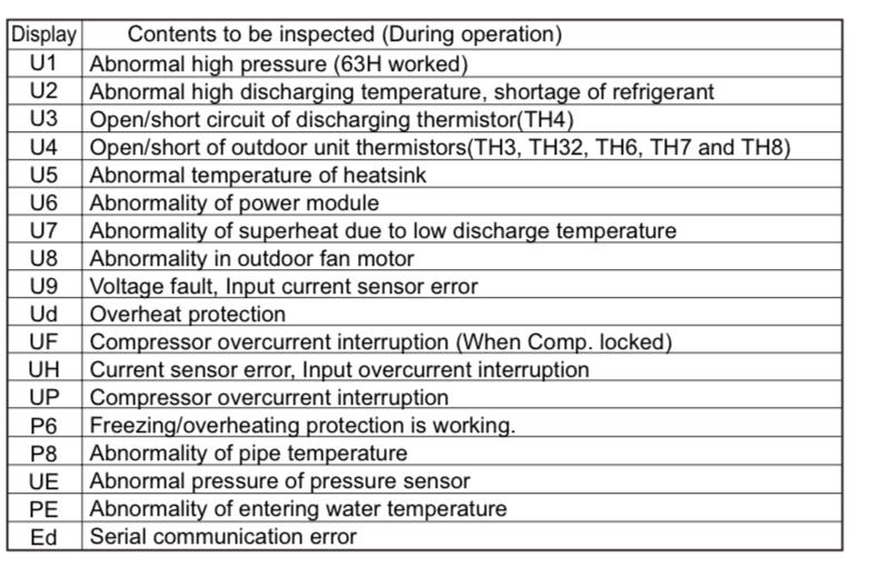

DeeJunFan Posted January 9, 2020 Posted January 9, 2020 On 09/01/2020 at 06:49, dpmiller said: And what does your magic book say 08 is? Expand It doesn't list 08 as a fault. There are 2 U8 faults. So either fan motor or refrigerant circuit temp. I'm not holding out any hope for it just very strange.
dpmiller Posted January 9, 2020 Posted January 9, 2020 Wonder if the compressor has now failed sufficiently that the inverter is chosing not to drive it...
DeeJunFan Posted January 9, 2020 Posted January 9, 2020 On 09/01/2020 at 07:16, dpmiller said: Wonder if the compressor has now failed sufficiently that the inverter is chosing not to drive it... Expand Very possible.
PeterW Posted January 9, 2020 Posted January 9, 2020 On 09/01/2020 at 06:58, DeeJunFan said: It doesn't list 08 as a fault. There are 2 U8 faults. So either fan motor or refrigerant circuit temp. I'm not holding out any hope for it just very strange. Expand If this is an Ecolane then it’s a Mitsubishi AX-09 under the covers. U8 is abnormality in the main fan unit so check it’s not jammed. Error codes are as follows : Send me a PM with your email on and I’ll forward you the service manual for it.
DeeJunFan Posted January 9, 2020 Posted January 9, 2020 Thanks @PeterW Ill fire you over a PM now . I was expecting a letter and then a number but it reads 08 to me which is a strange one. Fan is (was moving without issue) Cheers Damian
PeterW Posted January 9, 2020 Posted January 9, 2020 On 09/01/2020 at 06:49, dpmiller said: And what does your magic book say 08 is? Expand sorry !! O8 is compressor warm up - does it change after a while ..??? @DeeJunFan can you take a photo of the board when it calls for heat ..? There are also some items about using Meggers on the boards - check the info carefully in the document I’ve sent you.

DeeJunFan Posted January 9, 2020 Posted January 9, 2020 On 09/01/2020 at 16:16, PeterW said: sorry !! O8 is compressor warm up - does it change after a while ..??? @DeeJunFan can you take a photo of the board when it calls for heat ..? There are also some items about using Meggers on the boards - check the info carefully in the document I’ve sent you. Expand I didn't leave it on very long because there is a strange humming (almost sparking) noise coming from the unit. This is the LED display codes. So i was seeing H6 which is heating mode but Solenoid valve not on. and now getting 08 which looks like Off Compressor warm up
