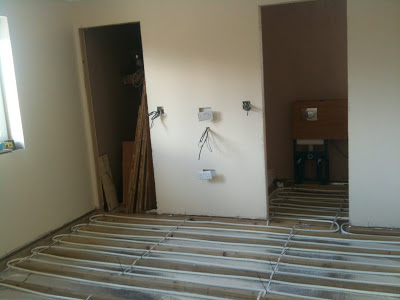

Hecateh Posted April 18, 2018 Author Share Posted April 18, 2018 This is the current situation. - Can anyone point me in the direction of a schedule of work that will tell me what order things need to be done in internally from now. I don't want to get one job done to find that I should have done something else first. PDF finance April.pdf Link to comment Share on other sites More sharing options...

Hecateh Posted April 18, 2018 Author Share Posted April 18, 2018 Does anyone know the regulations about fire escape. Specifically - does there need to be an escape route from the bedroom which is only up 4 stairs from the hallway and then 5 metres to front door. If I do need one. Can it be the French Windows. I seem to recall something about it not being lockable, but I cannot leave French Doors permanently unlocked. Link to comment Share on other sites More sharing options...

Ferdinand Posted April 18, 2018 Share Posted April 18, 2018 29 minutes ago, Hecateh said: Does anyone know the regulations about fire escape. Specifically - does there need to be an escape route from the bedroom which is only up 4 stairs from the hallway and then 5 metres to front door. If I do need one. Can it be the French Windows. I seem to recall something about it not being lockable, but I cannot leave French Doors permanently unlocked. I think it will be that there must be an escape route from the bedroom to outside without going through a likely source of fire eg a kitchen. So you can have it down the hall past the kitchen door but not through a room which includes an open plan kitchen. Five stairs are not .. I think .. a problem. Alternatively there are things you can do to make such a route acceptable such as sprinklers in the open plan area. Alternatively I think you could provide a direct escape route from the bedroom which could be French windows or an escape window. And I think that locks with keys are acceptable, though you could always provide eg thumbturn locks if required or possibly even some approved rapid window-smashing device if such exists. There are many options. Ferdinand Link to comment Share on other sites More sharing options...
Mr Punter Posted April 18, 2018 Share Posted April 18, 2018 36 minutes ago, Hecateh said: Does anyone know the regulations about fire escape. Specifically - does there need to be an escape route from the bedroom which is only up 4 stairs from the hallway and then 5 metres to front door. If I do need one. Can it be the French Windows. I seem to recall something about it not being lockable, but I cannot leave French Doors permanently unlocked. Thumb turn on the inside? 1 Link to comment Share on other sites More sharing options...

PeterW Posted April 18, 2018 Share Posted April 18, 2018 1 hour ago, Hecateh said: Does anyone know the regulations about fire escape. Specifically - does there need to be an escape route from the bedroom which is only up 4 stairs from the hallway and then 5 metres to front door. If I do need one. Can it be the French Windows. I seem to recall something about it not being lockable, but I cannot leave French Doors permanently unlocked. Quick way round this is to ensure that the doors are all fire doors and the frames have intumescent strips. Sounds daft, but fire doors can be cheap and they stop sound better. Intumescent strips can be fitted to frames before they are fitted for £2 each, so its not a bank breaker. You can also have doors made with no handles on the outside - again, not a big issue although your problem will be the juliet balcony. It will have to be a min of 1100mm to meet regs for falling, but that makes it too high for an access window from memory. Link to comment Share on other sites More sharing options...
PeterW Posted April 18, 2018 Share Posted April 18, 2018 2 hours ago, Hecateh said: Can anyone point me in the direction of a schedule of work that will tell me what order things need to be done in internally from now Doors and Windows - make it watertight Internal walls First fix plumbing, heating and wiring UFH (depending on method...) Screed (depending on UFH) Wall and Sloping ceiling insulation Board and Skim Loft insulation 2nd Fix Doors / Archs / Skirts 2nd Fix plumbing 2nd Fix Electrics Has (CH)BB given you the exact make and model of the boiler yet..?? that will influence first fix... and is gas connected anywhere..? Link to comment Share on other sites More sharing options...

Hecateh Posted April 18, 2018 Author Share Posted April 18, 2018 10 minutes ago, PeterW said: Quick way round this is to ensure that the doors are all fire doors and the frames have intumescent strips. Sounds daft, but fire doors can be cheap and they stop sound better. Intumescent strips can be fitted to frames before they are fitted for £2 each, so its not a bank breaker. You can also have doors made with no handles on the outside - again, not a big issue although your problem will be the juliet balcony. It will have to be a min of 1100mm to meet regs for falling, but that makes it too high for an access window from memory. I think I am going to have to wait on Building Control for this. Fire doors are ok but there is an open plan staircase from lounge/kitchen to entry level corridor )8 treads) and then the and then another 4 treads to bedroom where there is a landing and door. 4 minutes ago, PeterW said: Has (CH)BB given you the exact make and model of the boiler yet..?? that will influence first fix... and is gas connected anywhere..? Thanks for the list - that makes it easier to know where to start. Boiler --- hhmmmm. I asked him again to take it off and he agreed. Took off £315. I told him I was surprised at the price and he said he could show me the price online. I guess you can get boilers that cheap but I wouldn't be wanting one in my house and it's certainly not what he was talking of fitting when he still thought he had the whole job. i'm biting my tongue, and not saying anything because he throws his teddy at the slightest thing and I want my roof finished Link to comment Share on other sites More sharing options...

Nickfromwales Posted April 18, 2018 Share Posted April 18, 2018 2 hours ago, Hecateh said: Does anyone know the regulations about fire escape. Specifically - does there need to be an escape route from the bedroom which is only up 4 stairs from the hallway and then 5 metres to front door. If I do need one. Can it be the French Windows. I seem to recall something about it not being lockable, but I cannot leave French Doors permanently unlocked. Only BCO can tell you as he / she is signing it off. "Not lockable" refers to a thumb turn on the inside eg no looking for mislaid keys to get out in an emergency. 1 hour ago, newhome said: You would be more than welcome. But your house is tiny and cramped. How will you ever manage ?!? 1 Link to comment Share on other sites More sharing options...
