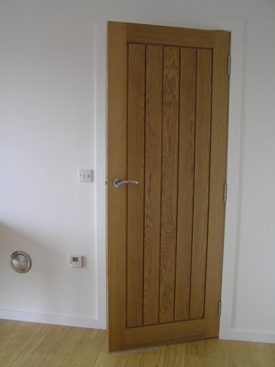

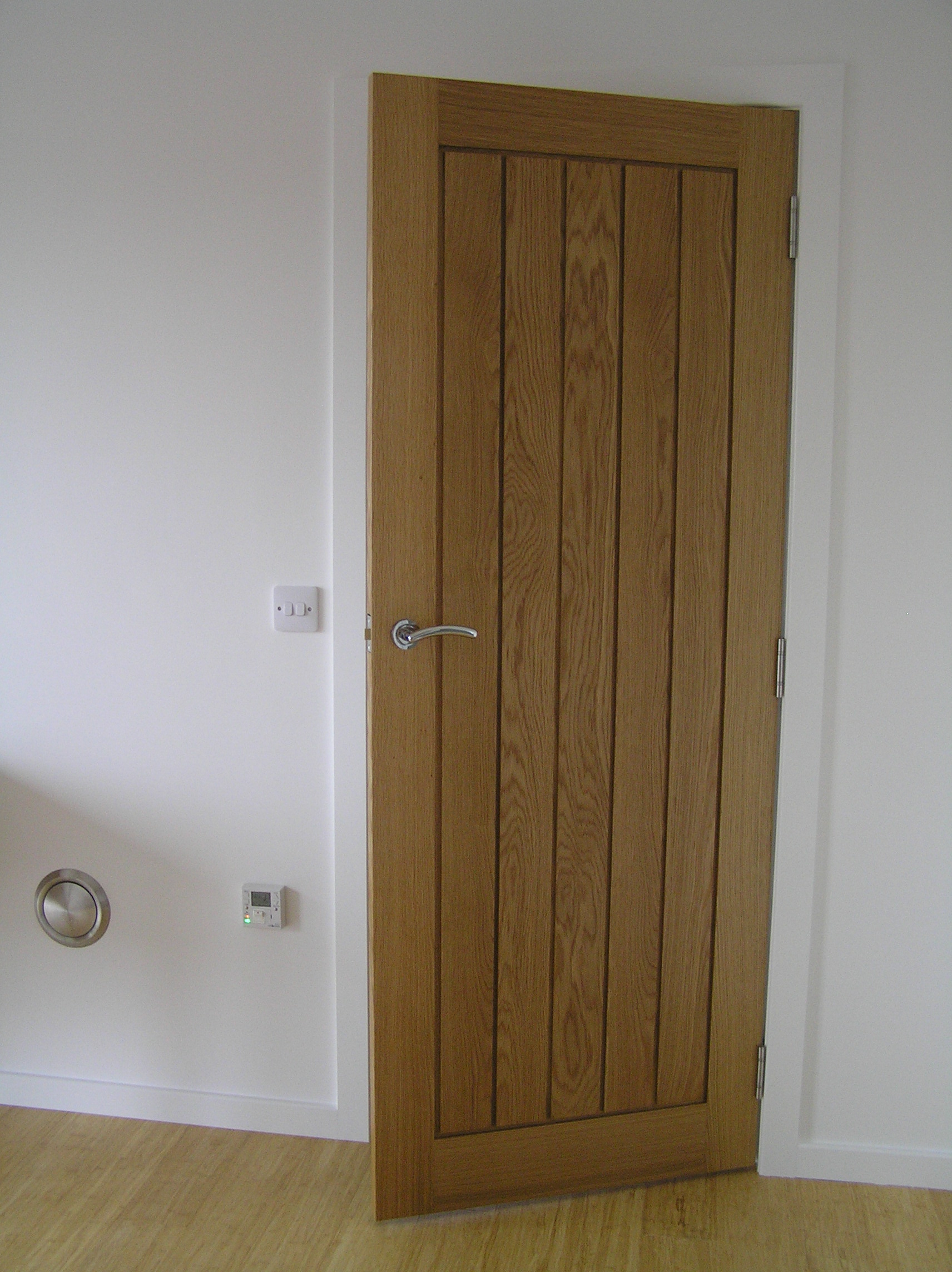

Jeremy Harris Posted April 7, 2018 Posted April 7, 2018 I bought our Mexicano doors unfinished and gave them a couple of coats of Osmo oil. At a guess I'd say it takes around 30 mins to rub the door down with a Scotchbrite pad, wipe the dust off and apply the first coat of Osmo. The Osmo takes a fair time to dry hard enough to de-nib for the second coat, around 24 hours, but giving the doors a quick rub down again with a Scotchbrite pad to knock the nibs off and then apply the second coat of Osmo is a fair bit quicker, maybe 15 minutes or so. Osmo is expensive, but goes a long way, I think we did all 13 doors in our house with about 1 1/2 tins for two coats, so around £3 or so per door for the oil plus around 3/4 hour to 1 hour labour per door. Bear in mind that I'm an amateur, too, so someone who's better at finishing may well cut the time down a bit. This is the best photo I can find of a finished door, done with the satin finish Osmo oil:

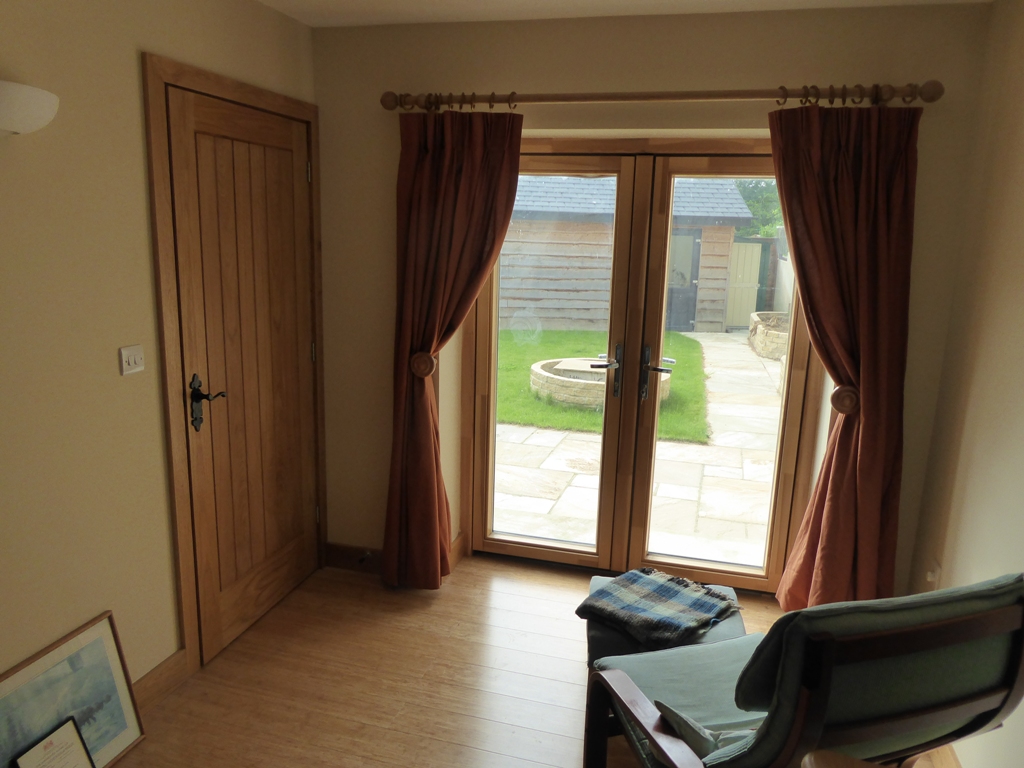

Stones Posted April 7, 2018 Posted April 7, 2018 I did the same, applied 3 coats in total, spending just over an hour per door between denibbing and applying the Osmo. Should be some pictures on my blog. I went for unfinished doors as I wanted the doors to have the same finish as our oak skirtings and facings. A prefinished door would have looked very different to the Osmo finish we had settled on.
Gone West Posted April 7, 2018 Posted April 7, 2018 Same as Jeremy, I put on two coats of Osmo PolyX satin clear. Easiest finish I have used.
