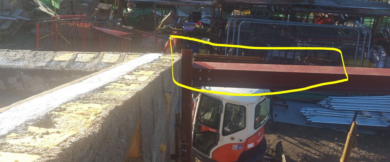

ToughButterCup Posted April 5, 2018 Posted April 5, 2018 The wall plate on the south face of our build runs across two sections: Durisol and steel. I'm almost clear about how to fix it to the Durisol. But how do we fix it to the top of the RSJ ? Is a simple bit of M14 threaded bar with bolts top and bottom sensible? (Countersunk bolt and bar at the top). Or is this a question the SE needs to answer?
Dudda Posted April 5, 2018 Posted April 5, 2018 (edited) M16 bolts at 500mm centers. M14 at larger centers would be find but the structural engineer will always over specify to be safe. If you've any more steel to get, get them to pre drill it. Edited April 5, 2018 by Dudda
Russell griffiths Posted April 5, 2018 Posted April 5, 2018 You can hire a hilti shotfire gun and shotfire it on, you need to way up how long to drill the holes verses the hire cost if you had the gun on site it’s a five minute job.
Alexphd1 Posted April 5, 2018 Posted April 5, 2018 (edited) On top of beam we shot on with a nail gun. We bought a paslode/spit p370 off eBay nearly new less than 200. Also can be used for shooting nails into concrete. On to the face we hired a magnetic drill. Edited April 5, 2018 by Alexphd1
