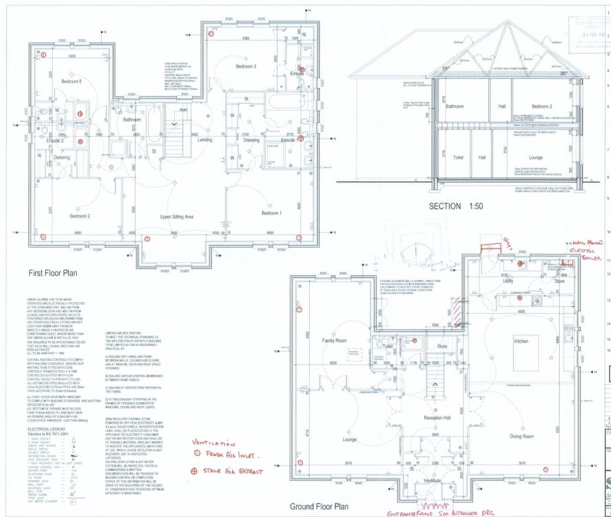

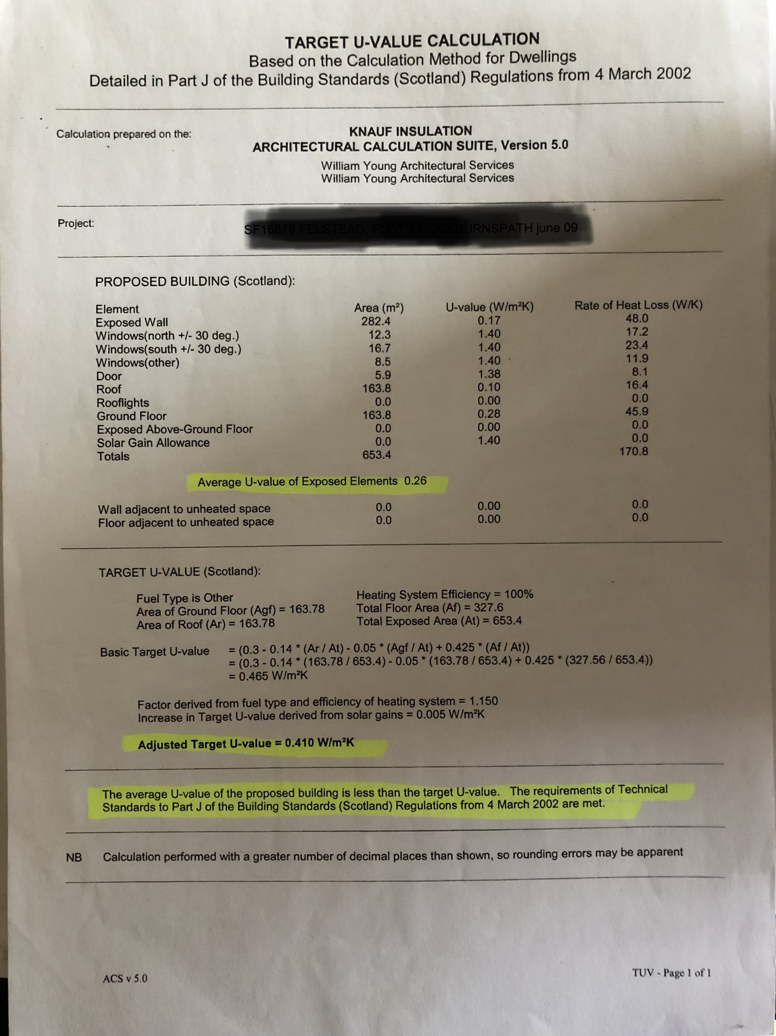

newhome Posted April 3, 2018 Share Posted April 3, 2018 Does anyone have a link to an idiot proof guide to help me understand my U-Value calculations, and what ‘Ok’ might look like please. I don’t have a passive house, so it won’t be super efficient, and some of the assumptions in mine aren’t quite right I believe as surely if I have MHRV it shouldn’t say ‘ventilation natural, fans 5’ ? It also doesn’t take the extension into account either. I really just would like to form view of how my house performs, and how I might be able to calculate a revised value. I doubt I can change anything at this stage. Many thanks! Summary of mine is below. 1 Link to comment Share on other sites More sharing options...

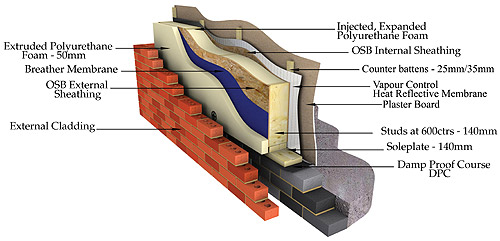

PeterW Posted April 3, 2018 Share Posted April 3, 2018 @newhome what’s the ground floor construction as that seems way off ...?! Link to comment Share on other sites More sharing options...
newhome Posted April 3, 2018 Author Share Posted April 3, 2018 47 minutes ago, PeterW said: @newhome what’s the ground floor construction as that seems way off ...?! Standard foundations, celotex under the UFH, then anhydrite screed, timber frame, ‘supawall’ and blocks and render. So this essentially, plus render on top of the blocks. Link to comment Share on other sites More sharing options...
PeterW Posted April 3, 2018 Share Posted April 3, 2018 Do you know the thickness of the celotex..? Link to comment Share on other sites More sharing options...
newhome Posted April 3, 2018 Author Share Posted April 3, 2018 11 minutes ago, PeterW said: Do you know the thickness of the celotex..? Not sure. There is some in the garage I think. Will look tomorrow night. Here is a photo but it doesn’t give much away I think. Do you think it’s ‘off’ in an overly optimistic way or pessimistic? Link to comment Share on other sites More sharing options...

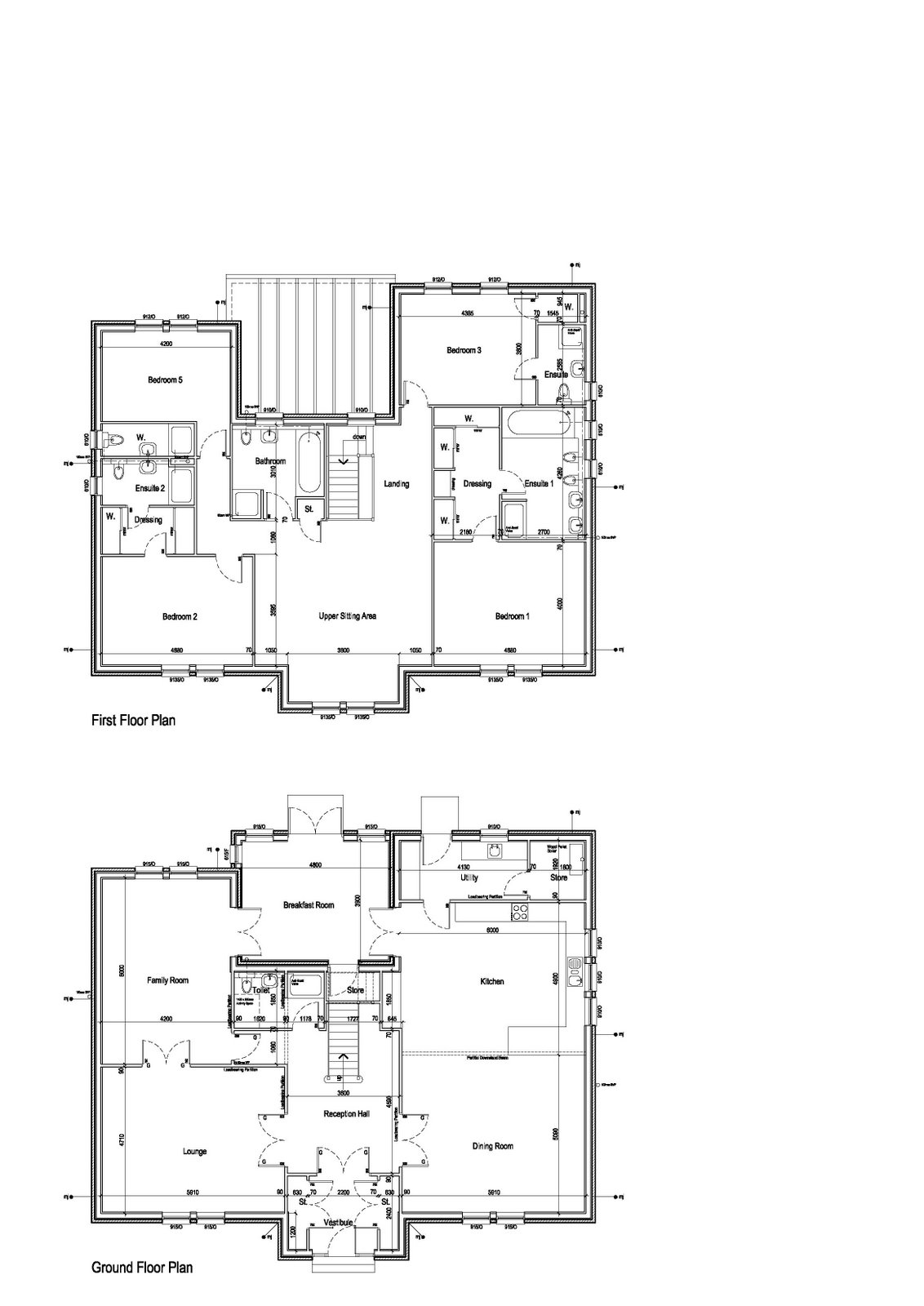

A_L Posted April 3, 2018 Share Posted April 3, 2018 1 hour ago, newhome said: Do you think it’s ‘off’ in an overly optimistic way or pessimistic? If your 163m2 floor is anywhere near square it would only take 50mm of Celotex to get down to 0.28W/m2.K Link to comment Share on other sites More sharing options...
newhome Posted April 3, 2018 Author Share Posted April 3, 2018 7 minutes ago, A_L said: If your 163m2 floor is anywhere near square it would only take 50mm of Celotex to get down to 0.28W/m2.K Here is the floor plan that it’s based on, although the bit at the back is now ‘filled in’ as per the second drawing but the calcs didn’t include it as it was an add on. Link to comment Share on other sites More sharing options...

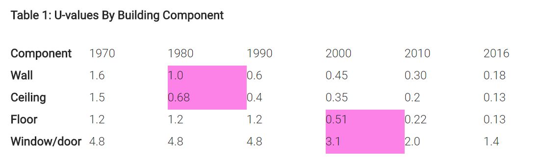

Ferdinand Posted April 4, 2018 Share Posted April 4, 2018 (edited) 10 hours ago, A_L said: If your 163m2 floor is anywhere near square it would only take 50mm of Celotex to get down to 0.28W/m2.K These are the approx. required building regs u-values for floors from here: http://great-home.co.uk/building-regulations-u-values-how-have-they-changed/ 0.28 would have been OK (ie meets the regs) before 2010, which is probably the date of the @newhome your PP. Ferdinand Edited April 4, 2018 by Ferdinand Link to comment Share on other sites More sharing options...
newhome Posted April 4, 2018 Author Share Posted April 4, 2018 10 hours ago, Ferdinand said: 0.28 would have been OK (ie meets the regs) before 2010, which is probably the date of your PP. Planning permission was 2005, building warrant 2006 (there was another house already built under the same PP and building warrant before we bought the plot). So how would things be done differently today for the floor? The foundations where already here and we just did what the UFH folk suggested re the ground floor. Couldn't work out how thick the Celotex was I couldn't find any. Thought there was some in the garage but that was Quintherm and we didn't use that for the floors. At a guess the Celotex was 50mm but can't tell for certain as the invoices are still at HMRC. Link to comment Share on other sites More sharing options...
A_L Posted April 4, 2018 Share Posted April 4, 2018 29 minutes ago, newhome said: Planning permission was 2005, building warrant 2006 (there was another house already built under the same PP and building warrant before we bought the plot). So how would things be done differently today for the floor? A U value of 0.13Wm2.K could be achieved (just) with 130mm of Celotex 1 Link to comment Share on other sites More sharing options...
newhome Posted April 4, 2018 Author Share Posted April 4, 2018 3 minutes ago, A_L said: A U value of 0.13Wm2.K could be achieved (just) with 130mm of Celotex OK thanks. The floor levels would have been wrong for 130mm so the timber frame would have to have been done differently I guess. Long time ago now tho (2009) and things change. Link to comment Share on other sites More sharing options...
