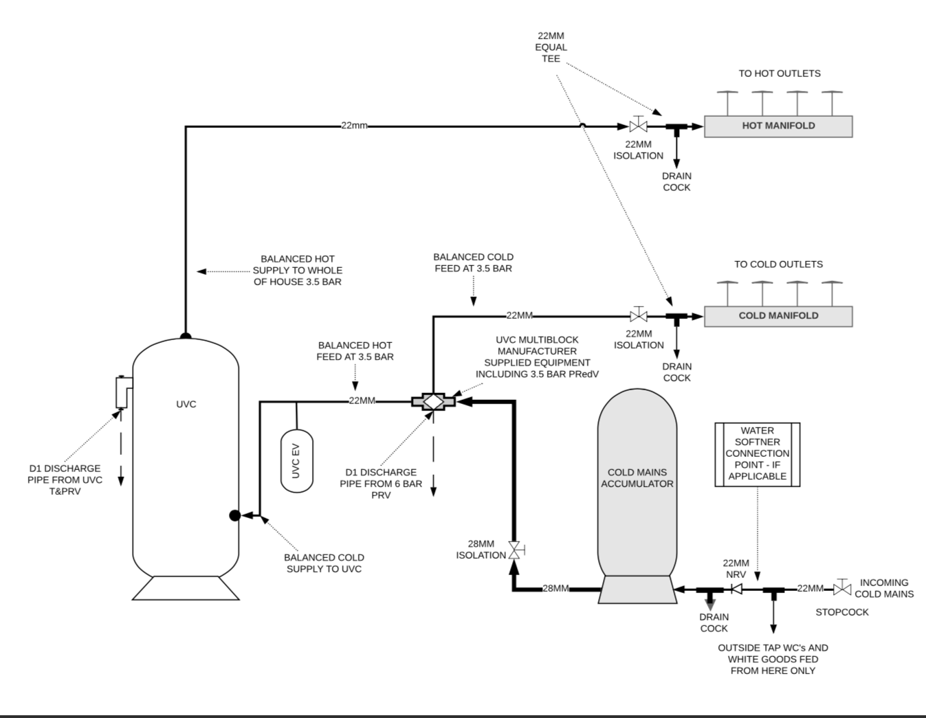

Pocster Posted April 1, 2018 Author Posted April 1, 2018 Actually how is all this plumbed ? Out of the uvc do you have a manifold ? Supplying each shower for example ? Could I not treat all hot taps like that ? I mean 1 manifold output just for all hot taps ? . Hot tap pressure dropping because another hot tap is in use is less of an issue I assume ... Equally couldn’t all cold taps and toilets run off 1 manifold run from the cold water tank ?

Nickfromwales Posted April 1, 2018 Posted April 1, 2018 1 minute ago, pocster said: Ok - I’m confused ! the secondary cold water tank feeds the uvc - got that . Ok I'm confused too What secondary tank ? The UVC is cold MAINS fed, so... cold mains stopcock 22mm pipework to uvc multi-block. multi-block has a 3.5 bar PRedv to glean 3.5 bar feeds to both the cold and the hot so you get a "balanced" hot and cold network with both at the same potential. 22mm feed to the UVC from the multi-block 22mm feed to the cold outlets. ( except WC's ). WC's fed from cold main after the stopcock but before the PRedV. outside tap same White goods fed same 15 minutes ago, pocster said: Perhaps I’m confused by the uvc - does that output hot and cold at pressure ? ( I.e as long as the 2nd tank is supplying it ) Explain what you meant by second tank ? A tank is an open plastic box, an accumulator is a sealed giant coke can with a half inch thick rubber bladder inside that gets filled and pressurised to the same pressure as the mains.

Pocster Posted April 1, 2018 Author Posted April 1, 2018 15 minutes ago, Nickfromwales said: Ok I'm confused too What secondary tank ? The UVC is cold MAINS fed, so... cold mains stopcock 22mm pipework to uvc multi-block. multi-block has a 3.5 bar PRedv to glean 3.5 bar feeds to both the cold and the hot so you get a "balanced" hot and cold network with both at the same potential. 22mm feed to the UVC from the multi-block 22mm feed to the cold outlets. ( except WC's ). WC's fed from cold main after the stopcock but before the PRedV. outside tap same White goods fed same Explain what you meant by second tank ? A tank is an open plastic box, an accumulator is a sealed giant coke can with a half inch thick rubber bladder inside that gets filled and pressurised to the same pressure as the mains. Ok ! My bad ! Secondary tank and accumulator are the same thing in my world ?. Will call it accumulator from now on . So all cold water also comes via uvc ? I thought the UVC was fed from the accumulator?? For the electric shower then - it’s fed off cold from uvc ? . If uvc fails will electric shower still get a supply ? sorry - for the confusion. I want to understand this so when I get a plumber in he doesn’t bs me or “ that’ll do mate “ ....
Nickfromwales Posted April 1, 2018 Posted April 1, 2018 3 hours ago, pocster said: I thought the UVC was fed from the accumulator?? The UVC is fed from the cold supply. The cold supply is connected to the accumulator, recharging and discharging accordingly. I'll post a diagram in a bit, easier that way
Pocster Posted April 1, 2018 Author Posted April 1, 2018 1 minute ago, Nickfromwales said: The UVC is fed from the cold supply. The cold supply is connected to the accumulator, recharging and discharging accordingly. I'll post a diagram in a bit, easier that way Oh ! ? I had assumed mains into accumulator then accumulator into uvc . Can I ask in your diagram you show the electric shower , an ensuite sink and toilet as well . That would be really helpful ! cheers
Nickfromwales Posted April 1, 2018 Posted April 1, 2018 58 minutes ago, pocster said: Can I ask in your diagram you show the electric shower , an ensuite sink and toilet as well . That would be really helpful ! The manifolds can be made to have as many outlets as you require. You would simply connect the electric shower ( yuk ) to an outlet of the cold manifold. Same for the basins / sinks / baths / showers. Simplicity itself, and you can make outlets live as the build progresses. If an item fails, you can just isolate that one outlet and leave the rest of the house working.
Pocster Posted April 1, 2018 Author Posted April 1, 2018 (edited) 12 minutes ago, Nickfromwales said: The manifolds can be made to have as many outlets as you require. You would simply connect the electric shower ( yuk ) to an outlet of the cold manifold. Same for the basins / sinks / baths / showers. Simplicity itself, and you can make outlets live as the build progresses. If an item fails, you can just isolate that one outlet and leave the rest of the house working. Fantastic ! Much appreciated!! so must I restrict say each output to each shower ? . I.e reduce the flow so multiple showers simultaneously don’t cause pressure loss ? . How do I set this ? Just trial and error ? ( I mean on the manifold ) Edited April 1, 2018 by pocster
Nickfromwales Posted April 1, 2018 Posted April 1, 2018 4 minutes ago, pocster said: so must I restrict say each output to each shower ? . I.e reduce the flow so multiple showers simultaneously don’t cause pressure loss ? . How do I set this ? Just trial and error ? Just fit one of these onto the end of each shower hose, then the handset
