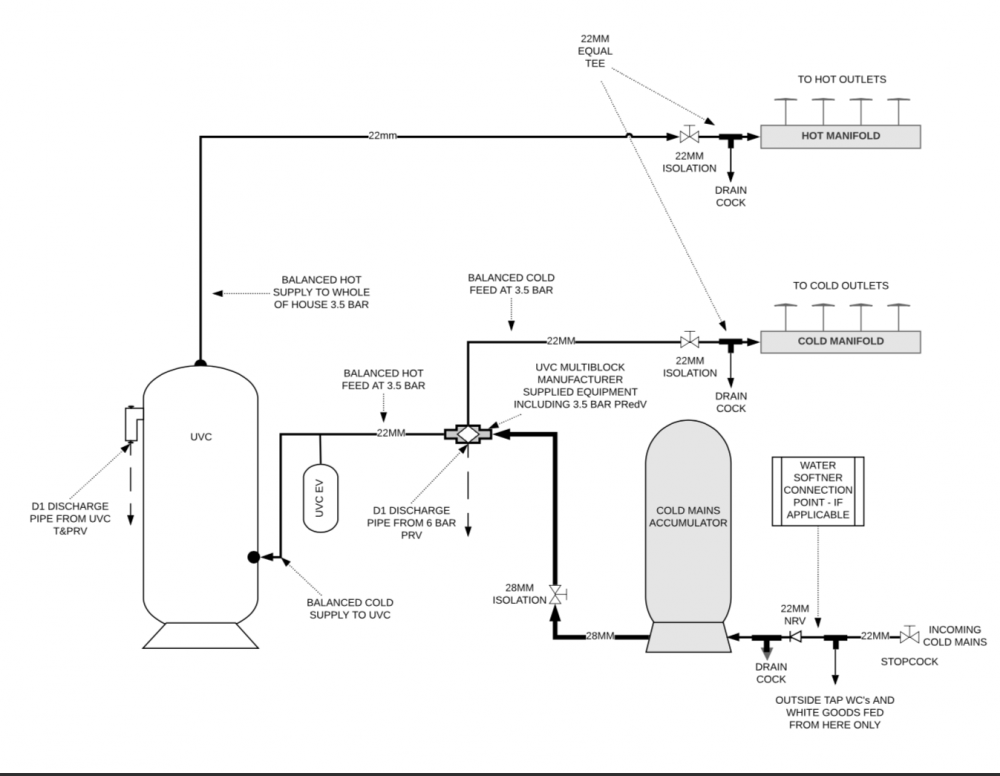

Nickfromwales Posted March 31, 2018 Share Posted March 31, 2018 20 hours ago, pocster said: I actually looked into this in 2014 on the old forum ? Just getting round to it now ! @Nickfromwales will save me ! I'm working on it. What electric supply do you have ? 21 hours ago, pocster said: 5 people a hot water tank , only finite water . All shower simultaneously ( worse case senario ) could be you have no water !! No other realistic solution . 5 showers simultaneously is a big ask. Tank fed elecric showers were the weapon of choice the last time I came up against such a request but with cooking on electric too they had to get another phase brought in from the electric board. Letting them fight over 5 standard electric showers would be the norm but to design a system with 5 showers will need the electrics notifying and signing off. Even with diversity you won't get all that one one phase. This is going to cost a good few £££ so best work out if you want to get on this rollercoaster. Link to comment Share on other sites More sharing options...

Nickfromwales Posted March 31, 2018 Share Posted March 31, 2018 14 minutes ago, pocster said: After all How do small b & b’s manage ??? By luck, that everyone isn't going to shower at exactly the same time. Plus, they don't do a new install from scratch, instead just adding showers willy-nilly hoping to get away with it. Ive stayed at plenty where the electric has tripped when I turned the shower on, so it's down to luck afaic. Your designing a system to suit, from scratch, so, if it's elecric based, your only option unless you change the UVC to a 4-500L ( >500 is commercial too so whole new can of worms there ) is to get the electricity supply upgraded. Link to comment Share on other sites More sharing options...

Nickfromwales Posted March 31, 2018 Share Posted March 31, 2018 45 minutes ago, pocster said: Let’s say we go for a 400ltr Megaflo type thing . Is this a solution ?? Not really because when the 2nd or 3rd shower is used the low ( available ) incoming cold water pressure will render them useless, either elecric or thermostatic mixer, both are cold mains dependant. No easy way out here I'm afraid. Link to comment Share on other sites More sharing options...
Pocster Posted March 31, 2018 Author Share Posted March 31, 2018 (edited) 1 hour ago, Nickfromwales said: Not really because when the 2nd or 3rd shower is used the low ( available ) incoming cold water pressure will render them useless, either elecric or thermostatic mixer, both are cold mains dependant. No easy way out here I'm afraid. Ok what about 2 Megaflo ? Each feeding just 2 showers ?? come on nick ! No such thing as no solution ? Edited March 31, 2018 by pocster Link to comment Share on other sites More sharing options...

Nickfromwales Posted March 31, 2018 Share Posted March 31, 2018 2 hours ago, pocster said: Ok what about 2 Megaflo ? Each feeding just 2 showers ?? come on nick ! No such thing as no solution ? They'd both need a cold main each Every pressurised water heater is cold mains dependant. No cold flow in = no hot flow out. Simples. You need to throw money at this, and there are a few ways to spend it. First:- How many showers are there now? When do they get used ? You charge for energy in a HMO monthly rental fee anyway, so how much excess consumption are you looking to prevent? Shortesr route :- You can put a 4-500L UVC in and fit a 500L cold mains accumulator to reinforce the hot and cold system and run cheap mixer showers. Job done. No option for timers etc so tough titties for going cheap. Timed route :- Get 3-phase in from the street to the meter location. Min £1800-£2k with you digging the hoolio. Fit £400 pumped electric showers ( 5 x £400 = £2k ) which need gravity cold water tanks and plumbing to each shower to drink from ( £1k ). Subsequent additional internal wiring to get fuseboards done and get juice to each isolator & shower location ( £2k -£2.5k most prob ). Does have integral run timers for 10 / 15 / 20 min duration before shutdown. Cost of energy youll save vs payback = waste of time IMO. What is there now? Is this a new system from scratch ? INPUT !!!! Link to comment Share on other sites More sharing options...
Pocster Posted March 31, 2018 Author Share Posted March 31, 2018 (edited) 12 minutes ago, Nickfromwales said: They'd both need a cold main each Every pressurised water heater is cold mains dependant. No cold flow in = no hot flow out. Simples. You need to throw money at this, and there are a few ways to spend it. First:- How many showers are there now? When do they get used ? You charge for energy in a HMO monthly rental fee anyway, so how much excess consumption are you looking to prevent? Shortesr route :- You can put a 4-500L UVC in and fit a 500L cold mains accumulator to reinforce the hot and cold system and run cheap mixer showers. Job done. No option for timers etc so tough titties for going cheap. Timed route :- Get 3-phase in from the street to the meter location. Min £1800-£2k with you digging the hoolio. Fit £400 pumped electric showers ( 5 x £400 = £2k ) which need gravity cold water tanks and plumbing to each shower to drink from ( £1k ). Subsequent additional internal wiring to get fuseboards done and get juice to each isolator & shower location ( £2k -£2.5k most prob ). Does have integral run timers for 10 / 15 / 20 min duration before shutdown. Cost of energy youll save vs payback = waste of time IMO. What is there now? Is this a new system from scratch ? INPUT !!!! I hear you nick ? we are looking at a from scratch system . currently 1 electric shower - that’s it ? ; hence the need to upgrade . so a 500uvc with a 500ltr cold supplying it ?. So I have 1000ltr too hand ? so when any taps run hot or cold will that effect shower flow ? can the taps come off just the Combi boiler ?? ( oh yeah ! There’s a Combi there ? ) agree timed route / 3 phase is s dead route . Simplest is best ! Edited March 31, 2018 by pocster 1 Link to comment Share on other sites More sharing options...
