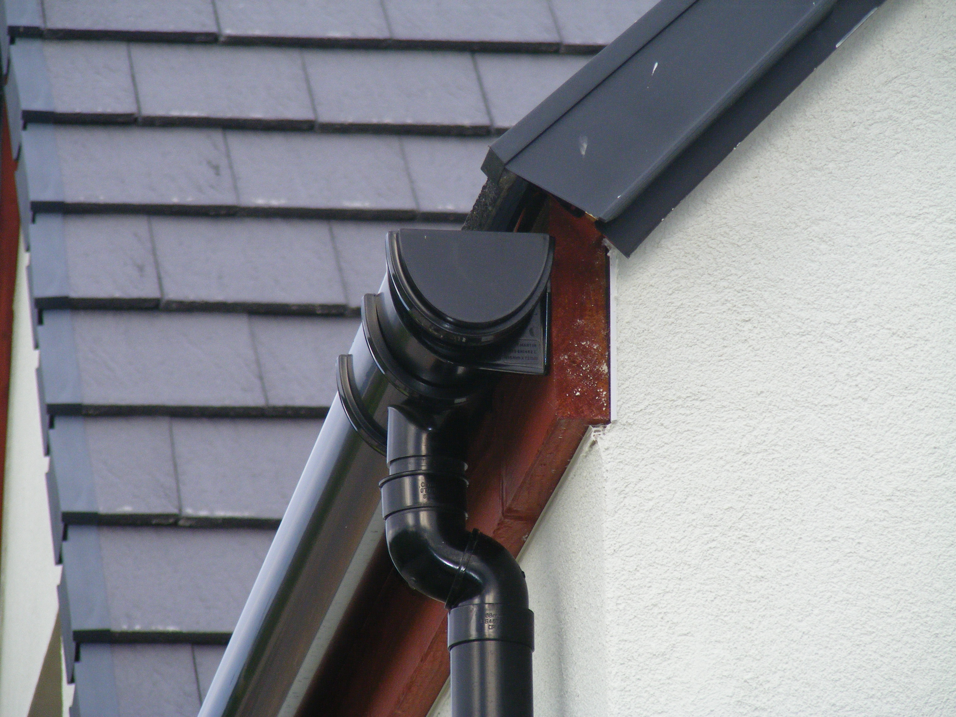

Tin Soldier Posted March 28, 2018 Posted March 28, 2018 Hi there Can anyone tell me why fasica/soffit are so boxy, and stick out so far. Is there some sort of minimm distance that a gutter must be from the wall, is there a minimum overhand of roof structure at both gable and non gable ends? I really like the look of older Scottish properties that come without this chunky addon, but is there a smart way to avoid this detailing is there some solution that is minimalist, sleek and weatherproof? I've looked at Kytun dry verge but can this be attached to the wall or a batten, or does it need an overhand and fasica/soffit box from the 90's
ProDave Posted March 28, 2018 Posted March 28, 2018 It is just style. Ours are not like that. Just lengths of 6 by 2 regularised timber, that will eventually be clad in an aluminium profile (so painting or varnishing wood is not a regular chore) This is typical of how older cottages were built for instance. It did create an "issue" with the downpipes. The standard bends were too bulky and I had to trim them a bit to get a small enough offset

ProDave Posted March 28, 2018 Posted March 28, 2018 No 4 by 2 on the gables. It didn't quite go to plan as I detailed that before I got the tile end caps, and when I put it all together, it left a sliver of wood exposed, and in keeping with my low maintenance goal I did not want that, so I fitted a plastic strip before the tile end caps went on to both protect the wood from getting wet and create a drip bead (much as there will be a drip bead when I add the aluminium cladding to the fascia)
