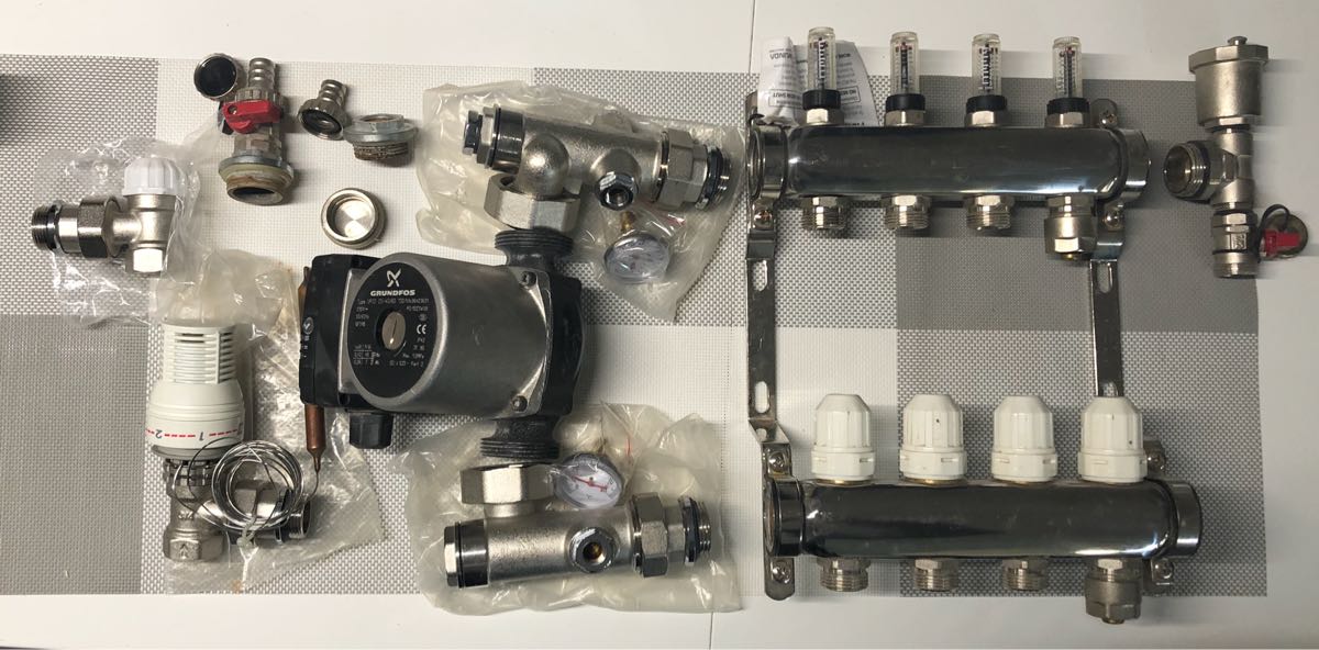

First play in this match is to get the manifold out, clean it up and sort an installation position to be able to connect it all up for a proper pressure test and take it from there.

I need to know what type of UFH manifold you bought. If its Wunda, and from back in the day, then it may be one like this, noting the curly capillary wire from a TRV type control knob  that is hidden behind the black cable, rather than one like this which is a true thermostatic blending valve with the rotary control knob inbuilt into the TMV.
Similar but different to first one.

Hi @daiking
The 15mm feeds will suffice, you'll just need to put a manual bypass ( standard £5 gate valve ) across flow and return at the manifold, immediately prior to the pipes being connected to it. It'll make almost no difference whatsoever to the running of it, like near zero, and would only really impact the heating up when you want to warm it from cold ( and then TBH you'd not really suffer as 15mm flow and return will still keep a 2600 x 700mm K2 double radiator blasting ) so tell your plumber to have a chill pill and just connect to the 15mm ones you already have.
The only time the boiler will 'suffer' ( short cycle excessively ) is when the UFH is used on its own, so I'd try to never have a system configured where that would be the rule, or the exception TBH. When the UFH is up to temp it will require less than the boilers minimum output even at max modulation ( you have a Baxi Duotec IIRC? ) therefore will be a design load that is outside of it's 'happy place'. Running the bathroom towel rads simultaneously at the bare minimum will help the boiler out no end, so at least one of those should stay on manual ( bypass ) radiator valves, but the other 2 (?) certainly should have TRV's fitted. Leave the one in your ensuite on bypass valves and change the others to TRV's so visitors / kiddies are less likely to come into contact with them ;) Plumbers ( on their mothers side ) do this in bathrooms ( leave out TRV's ) as a knee-jerk action, and are bell-ends for doing so. Get those done asap for comfort and safety.
The blending valve on the UFH manifold will allow you ( as in you personally ) to adjust the flow temp of the UFH loops to whatever you want, so once plumbed in and commissioned you can tweak this daily. You can get two set points marked with Tippex and change the temp a little 'seasonally' for selecting between the shoulder months and deepest winter for eg, same way folk with boilers turn the flow temp up a bit when the weather becomes a bit sharp. You would do it at the manifold and not the boiler so as to not affect the flow ( surface ) temp of those emitters, again promoting comfort / safety.
Connecting this lot up is a doddle, so don't let anyone start tearing pages out of the Problematic Plumbers Bible, simply do as above, connect up the flow and return to the manifold, and get the slab warmed. Remember the 50p per day is only due when you need to heat the slab, so no banks are going to be broken here, and I reckon you'll only need to provide a bit of background heat from the slab to make a huge difference in the house. UFH via a slab is a bloody good way of getting 'comfort' heat into a space, so try it low first and go from there.

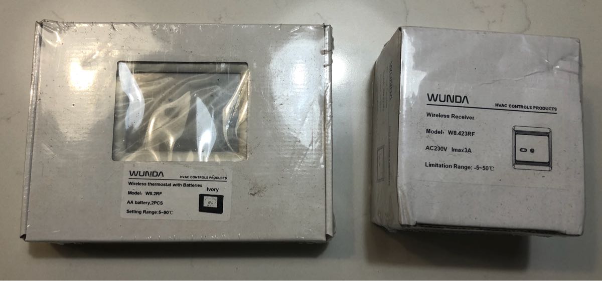

As far as controls are concerned, run with what you've got and just put a simple £1 1g1w light switch as an on/off switch so you can remove / introduce the UFH as required. Start off cheap and cheerful, and add complexity later if you find it's necessary :)
"Proceed"

Next up, will an 8-port manifold (4 loops) and pump setup with associated plumbing fit within the confines of a 500 wide kitchen base unit?
If not, how much space will it need? And,
Can you still use some of the space in the cupboard?
Do you need to provide any ventilation for it? Hopefully passive if at all
@PeterW @Nickfromwales
