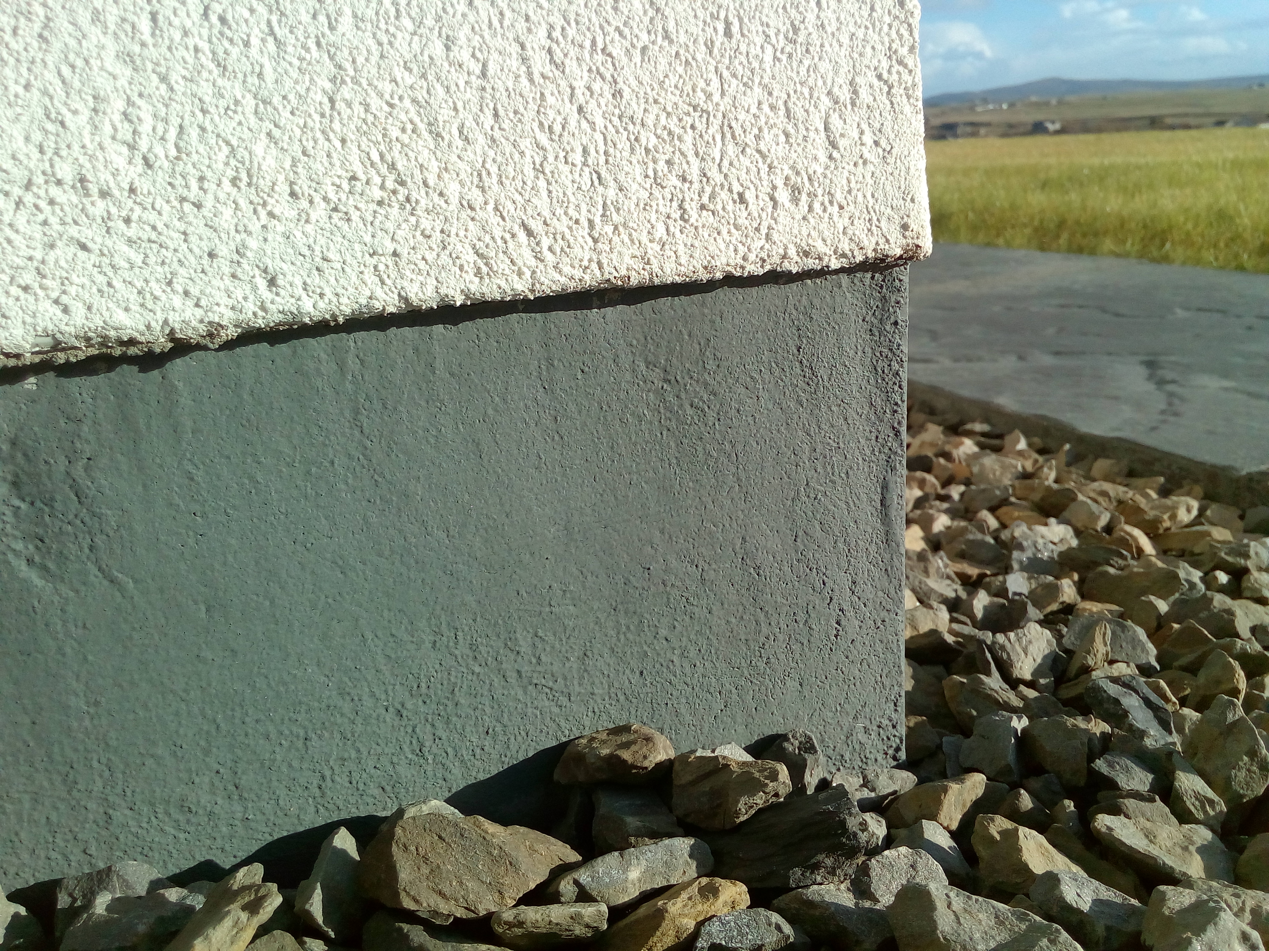

Alexphd1 Posted March 23, 2018 Share Posted March 23, 2018 Had the 1st spray render guy out today for a quote. Our house is ICF on a 450mm high passive slab with the DPM coming out between the raft and ICF. I was originaly hoping to have the render all the way down to the ground level, but the render guy told me I needed a bead with DPM coming out. With a stop bead and render both sides it doesnt look good which i agree. He suggested brick slip or painted for the DPM down. Has anybody used anything else for ideas? Link to comment Share on other sites More sharing options...

nod Posted March 23, 2018 Share Posted March 23, 2018 1 hour ago, Alexphd1 said: Had the 1st spray render guy out today for a quote. Our house is ICF on a 450mm high passive slab with the DPM coming out between the raft and ICF. I was originaly hoping to have the render all the way down to the ground level, but the render guy told me I needed a bead with DPM coming out. With a stop bead and render both sides it doesnt look good which i agree. He suggested brick slip or painted for the DPM down. Has anybody used anything else for ideas? The Quik answer is You can have the render right down I normally trim the dpc flush with the slab set a laser line along the dpc then stick a movement joint bead on top of the dpc In effect your leaving a 15 mil void around the hidden dpc You can normally match the movement bead to your render colour 1 1 Link to comment Share on other sites More sharing options...

Stones Posted March 23, 2018 Share Posted March 23, 2018 @AliG the picture you found is from the builder I used. Silicone render finished down to a bead, below the bead has been rendered with two coats of the base render then painted (or at least, that's how mine was finished). @Alexphd1 I'll try and post some close up pictures tomorrow for you. 2 Link to comment Share on other sites More sharing options...

lizzie Posted March 24, 2018 Share Posted March 24, 2018 @Alexphd1 took some pics this morning we have a layer of geotex fixed round our eps to protect it then the aluminium on top. Aliminium is foamed/screwed to eps around slab and house timber frame. It extends a short way up under the render board and cladding to make sure there is no problem with water getting in. If you want a more technical explanation I can ask my superstar carpenter (he fitted it). It works really well and looks smart..... well it will do when we get all the muck off! 1 Link to comment Share on other sites More sharing options...
Stones Posted March 24, 2018 Share Posted March 24, 2018 As described earlier: Link to comment Share on other sites More sharing options...
