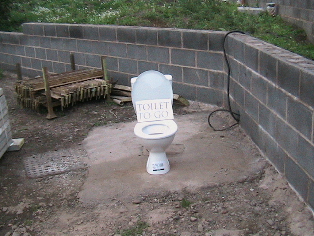

newhome Posted March 21, 2018 Posted March 21, 2018 5 minutes ago, recoveringacademic said: Toilet Everyone uses our house loo. We only had the cassette loo in the caravan as it was a new build so bought a cheap loo (called a “toilet to go” hence the sign) from Homebase which was about £50 and plumbed it into the drain temporarily. We already had a Khyam shelter (essentially a tent without windows) and erected that round it. Threw in loo rolls and hand wipes and it was good to go. We binned it once the downstairs loo was installed. Photo before the tent went up.
vivienz Posted March 21, 2018 Author Posted March 21, 2018 I should clarify that we aren't living on site and the existing bungalow will be demolished. There's no mains drainage, either, so I think that a portaloo is the easier option for the site.
