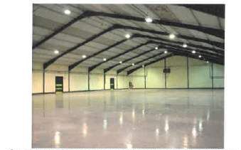

Ferdinand Posted March 20, 2018 Share Posted March 20, 2018 (edited) This is slightly off topic, but we are technically "self-building". I am involved in moving a (Crossfit) gym into a new unit. This is a photo of the unit pre-fit-out, and we will be having the far end in the pic when a wall has been built across. The left hand side is the front. Dimensions of our unit are 30m front to back by 18m side to side, giving a 5800 sqft rectangular space, with loos, showers, and changing rooms on the right hand side in this view. The eaves height is about 5m, and the apex height is about 9m. The facility will run potentially from 6am to 11pm six days a week plus special events on Sundays. The walls will be painted grey to a height of ~4.5m. The issue that I have got is a pair of normal self-build elephants that have appeared out of thin air at zero notice and are now standing on my foot, and I have a very few days to decide how to deal with it, and there is not very much in the budget - but what is needed will be found. Basic heating is gas and will be staying. Electrics are generally not an issue as Crossfit does not usually involve machines with power supplies. 1 - I need to replace the lights. The cable is staying in place. 2 - I need to run a water supply from the LHS where the new metered supply comes in to the changing rooms and showers. Water heating will be electric at the shower. Lighting For 1, which I think is the more straightforward, it is a case of rapidly sourcing the right LED lights for a gym lit from that height, getting them and probably paying the LLs refurbishment contractors to replace them when they take the old ones down to avoid messing about with big scaffold towers. Plus a need to think about certification if required. Can anyone advise me on light intensity, types and perhaps colour of light (warm or cool white?), and perhaps recommend a source? Water pipes etc For 2, it seems to me that I can run the water supply high or low, exposed or hidden. I need to decide: 2a - Type and size of pipe. I think I want plastic (JG Speedfit?) on a 100m reel, or perhaps 2x50m for ease of handling, so it is in one or two lengths only. 2b - High or low? Hidden or concealed? If I am running it at ground level (and therefore round at least one or two doors depending on which way we go) it will need protecting, perhaps by the type of plastic boxing in which was pointed out by I think @Onoff some time ago for bathrooms. I think that is complicated, and more expensive, but if I did it I would probably also run a pipe and conduit in tandem in the other protected space in the boxing-in product so I can get electricity anywhere later round the walls. I think I prefer to run it at perhaps 3-3.5m to go above doors and nto have things dropped on it, but not be stupidly high for ease of installation, and to leave it exposed so that any leaks or damage become immediately obvious. For wallball exercise spots we would need to install facing boards over the pipe. Not a problem. 2c - Do I need an accumulator or similar? We will be having 2 showers, with potentially one or two extra later, but if we grow to need them we will have more money to spend. Wrap-Up 3 - Have I missed anything? I would welcome comments on any of the above, perhaps especially from known gym users such as @Onoff and @jack or relevant pros. Any advice from anyone would be most welcome. Cheers Ferdinand Edited March 20, 2018 by Ferdinand Link to comment Share on other sites More sharing options...
Dudda Posted March 20, 2018 Share Posted March 20, 2018 (edited) Planning, Fire certification, accessibility? You'll need accessible toilets, showers, fire escapes, etc. Is someone taking care of this for you? Can't imagine electric feeding multiple showers will work. What are you doing to support the floor where heavy weights are lifted and dropped? Ventilation is also a big issue in gyms. How are you ventilating the toilets and showers or the waste? I've a lot more questions and bit worried about this. Edited March 20, 2018 by Dudda 1 Link to comment Share on other sites More sharing options...

jack Posted March 20, 2018 Share Posted March 20, 2018 That's an amazing space! 1 hour ago, Dudda said: What are you doing to support the floor where heavy weights are lifted and dropped? First thing I thought. Our (also Crossfit) gym has special flooring in the main open areas, although I'm not sure of the actual make-up. No weights are allowed outside of those areas. "Proper" gym flooring can be eye-wateringly expensive, I believe. Not sure whether you could do a cheap version with a layers or two of plywood covered in some form of rubber matting over the top. Re: lighting, I saw this article: http://luxreview.com/design-clinic/2014/10/three-ways-to-light-a-gym - among other things, it mentions the importance of low intensity lights. I hate doing wall-balls or anything involving lying on my back underneath the lighting fixtures at our gym, and they use pretty low intensity panels. I'm not sure of the details, but they're suspended panels about a metre square. 1 1 Link to comment Share on other sites More sharing options...
Nickfromwales Posted March 20, 2018 Share Posted March 20, 2018 @Ferdinand Run a 22mm Hepworth pipe up and over with basic girder clamps and just lag it. Cover with white duct tape for aesthetics Do that with a 100m length if a 50m isn't enough. No joints on the main run is a no brainer. 2-man manageable without issue. As you should have 3 phase available, you'll need to provision to have a new 3-phase board to run the electric showers and water heater. Size the water heater accordingly with either a 15litre instant blended down to 50oC flow or if preferred just fit a Sunamp unit so you have no valves / complexity / discharge pipework to outside / annual inspection and known maintenance. SA = Fit and forget. . For showers, forget the accumulator and go for a single 50gal break tank, or two smaller 25gal coffin tanks if space is tight. Use these on a 22mm pipe 'common rail' reducing to 15mm to supply each one and use Pumped Electric showers. Instant high performance and they suck the water out of the gravity / break tanks. The water heater / WC / kitchen / utility can then run completely unaffected by the bulk water consumption of the showers. Triton T80Si These have integral run time limiters for 8-10-12 min showers or around those times afaic remember so members can't shower forever and run the break tanks dry. Also preserves water in the event that somebody leaves a shower running. They'll automatically shut off after the preset timer ( user definable jumper pins are located inside the shower to select duration ). 8.5kw is plenty but they are available in 9.5kw too iirc. 1 Link to comment Share on other sites More sharing options...
Nickfromwales Posted March 20, 2018 Share Posted March 20, 2018 A way to cheat out of lots of fixings with the cold feed going 'up and over' is to pull a 6mm catenary wire over first, spanning the big members / beams, and tighten it off with a Gripple. Secure the loose tail with a couple of U clamps and don't over tighten. Then you can zip-tie the pipe at 300mm intervals, cheaper and quicker imo. EDIT : Just looking at the picture, if your going alongside one of those big support beams eg left to right, stick with the Girder clamps Link to comment Share on other sites More sharing options...

oldkettle Posted March 20, 2018 Share Posted March 20, 2018 Just +1 to what @jack said on lighting. Most people spend some time lying on their backs in a gym and lights, even at 5m height, easily make it unpleasant. If there is a way to create reflected lighting, may be excessively bright, but pointing a bit up from the top of the wall area (plus bright reflective paint for the ceiling), it might work. Otherwise, larger panels with lower intensity would probably be better. I personally don't care about the colour. 1 Link to comment Share on other sites More sharing options...
