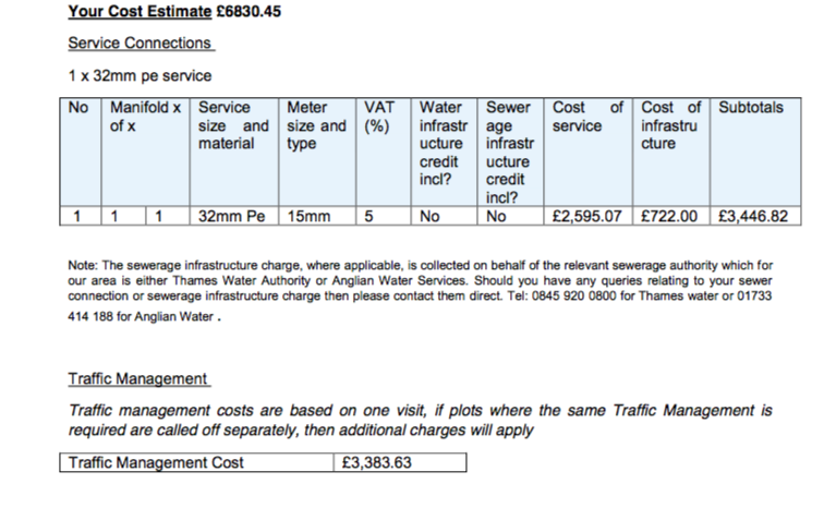

How much is a water connection?
Iv just been estimated nearly 7k because it looks like they have got to dig to the other side of the road :(
the farm has got its connection right next to where they plan to dig. does anyone know a good way of "subletting" water? and also what sized pipe would I like to see on their side of the farm's meter to be able to cope with another house?

Is the farm supply for the house or the entire farm ..? Would guess it’s 32mm or similar.
You could run 25mm to yours with no issues as long as there is decent static pressure.
And you can buy cheap meters off eBay that are WRAS approved for less than £20...

You would need an easement from the farm to allow you to connect in case you ever sold the farm to someone else and you would then possibly need to put in a separate feed at that point.... but I would not worry about that at this point ..!
Cut the 32mm, tee in a 25mm MDPE and then stick a non return valve and a meter on it ...
Tee off and run 32mm to an outhouse if possible. Cap it off and see how you cope with any pressure / flow fluctuations. If it's problematic then just connect an accumulator to the end of the 32mm. Fwiw I'd keep all of the buried stuff 32mm as you'll need all the flow you can get when both dwellings are consuming water at the same time. ;). Pennies difference.

5aae8421c39c8_ScreenShot2018-03-18at15_20_58.png.164ee59249a1cc9f907eb919d14c7268.png
3 day road closure :(
1 minute ago, PeterW said:
Why do you want a 32mm connection ..?!   That will be driving up the cost.
I just asked for a new connection, This is the cost advice they have come back with,
 I don't remember specifying pipe size
Does the water company have to manage the 3 day road closure?  I managed our partial road closures and we dug right across two roads and laid ducts, pipes and cables in less than one day, in two trenches.  I agreed with the council highways people to maintain one lane for traffic using steel plates and they agreed I didn't need a closure order, just traffic management.  We did the latter with one lad holding a stop/go board.

Why will it take 3 days?
Can they not mole under the road?
for just over £3K I am pretty sure I could buy (or make) a set of traffic lights.
Who gave this quote?
When I was looking at getting the road crossing made for all 3 services, I contacted a local contractor with a minor street works permit as well as the Hydro and Scottish Water.  The independent contractor was the most expensive as although he has the street works permit he still would have to apply for and pay for a road opening permit (even if molling under the road)  In contrast the utilities hold a permanent road opening permit.
Even if it is a busy dual track road, all it needs is to do one half of the road at a time with traffic lights. It should be comfortably done in a day.  I suspect the 3 day thing is they cannot guarantee which day, so they will book and (you will) pay for 3 days. THIS is the bit I would be contesting with them.

ask them if you can provide your own traffic management.  Here you go, a set of lights for £211 for a week https://www.speedyservices.com/22_0248-h-xlite-traffic-signals-2-phase-radiolink
You just need some cones and signs.  Over £3K for 3 days is taking the urine.,
The quote was from affinity water ( the people that supply our water. ) I’m not sure why they haven’t planned to mole it. Possibly things to hit in the road but that is just speculation.
