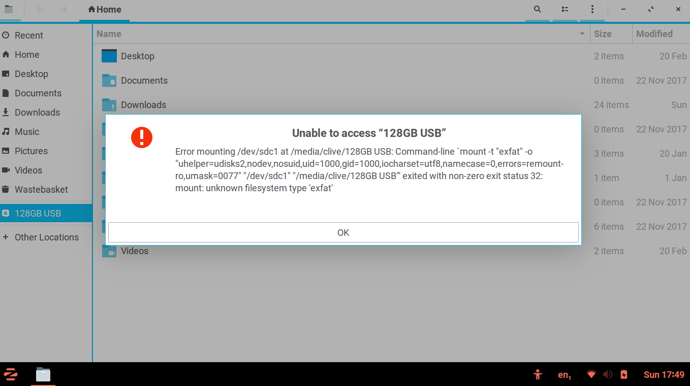

Onoff Posted March 11, 2018 Posted March 11, 2018 My lad has given me some films on a USB3.0 128GB memory stick. It shows up OK in the wife's Win 7 desktop In my laptop running Zorin 12 32-bit (Ubuntu base) it won't mount, when I try I get this message: Which is a pain as this lappy lives by the tv on which I want to watch the stuff! The stand alone media player won't see it either. Any suggestions? Cheers
PeterW Posted March 11, 2018 Posted March 11, 2018 Exfat is an old MS file system type - can you copy them to the Win7 laptop and then reformat the USB key and put them back ..?
MikeSharp01 Posted March 11, 2018 Posted March 11, 2018 8 minutes ago, PeterW said: copy them to the Win7 laptop and then reformat the USB key and put them back The man from the north speaks correctly - but you might ask your boy how he created an EXFAT format on what must be a recent USB key. MS used EXFAT from about 10 years back and I think they keep some of the 'secrets' to themselves. Other formats are faster these days anyway.
Jeremy Harris Posted March 11, 2018 Posted March 11, 2018 I've found that some flavours of Linux are OK'ish with ExFAT, some aren't. Mint is sort of OK and will read an ExFAT USB stick OK, but throws a wobbly when trying to write to it. I only have one ExFAT formatted USB stick, solely because it's the only format that works for large USB sticks with Windows XP, and I still have a Win XP netbook. @PeterW's suggestion is the one I use when this happens, but I'll copy the files across to a stick that's formatted with something like NTFS, as that seems to work with most newer Windows systems and every Linux system I've tried it with. I try not to have any sticks formatted to something like ext3 or ext4 unless I have to, as it's a pain loading stuff to Windows to allow them to work.
Jeremy Harris Posted March 11, 2018 Posted March 11, 2018 1 minute ago, MikeSharp01 said: The man from the north speaks correctly - but you might ask your boy how he created an EXFAT format on what must be a recent USB key. MS used EXFAT from about 10 years back and I think they keep some of the 'secrets' to themselves. Other formats are faster these days anyway. ExFAT is pretty much the only way to get something like a 64Gb USB stick to work with Windows XP, I've found. May be why this USB stick is formatted this way.
Onoff Posted March 11, 2018 Author Posted March 11, 2018 Cheers all. Going to try and reformat it NTFS. In the back of my mind there's a reason why it's exFAT...
Jeremy Harris Posted March 11, 2018 Posted March 11, 2018 3 minutes ago, Onoff said: Cheers all. Going to try and reformat it NTFS. In the back of my mind there's a reason why it's exFAT... The only reason for it being ExFAT usually is because it's too big a USB stick for Windows XP to natively read/write. XP was limited to FAT32, IIRC, so wouldn't handle large USB sticks, at least that's why I have a 64Gb stick that's formatted to ExFAT, simply for transferring stuff to an XP machine.
ProDave Posted March 11, 2018 Posted March 11, 2018 2 hours ago, JSHarris said: The only reason for it being ExFAT usually is because it's too big a USB stick for Windows XP to natively read/write. XP was limited to FAT32, IIRC, so wouldn't handle large USB sticks, at least that's why I have a 64Gb stick that's formatted to ExFAT, simply for transferring stuff to an XP machine. XP is quite happy with NTFS which should comfortably do 128GB
Jeremy Harris Posted March 11, 2018 Posted March 11, 2018 14 minutes ago, ProDave said: XP is quite happy with NTFS which should comfortably do 128GB That's weird, as I had to format the 64Gb drive I have to ExFAT, specifically to get it to work with my netbook that runs XP. I'll have a play tomorrow to see what's going on, as having that stick formatted as ExFAT is a PITA.
Onoff Posted March 11, 2018 Author Posted March 11, 2018 NTFS worked. However...seems this is all I needed; sudo apt install exfat-fuse exfat-utils
