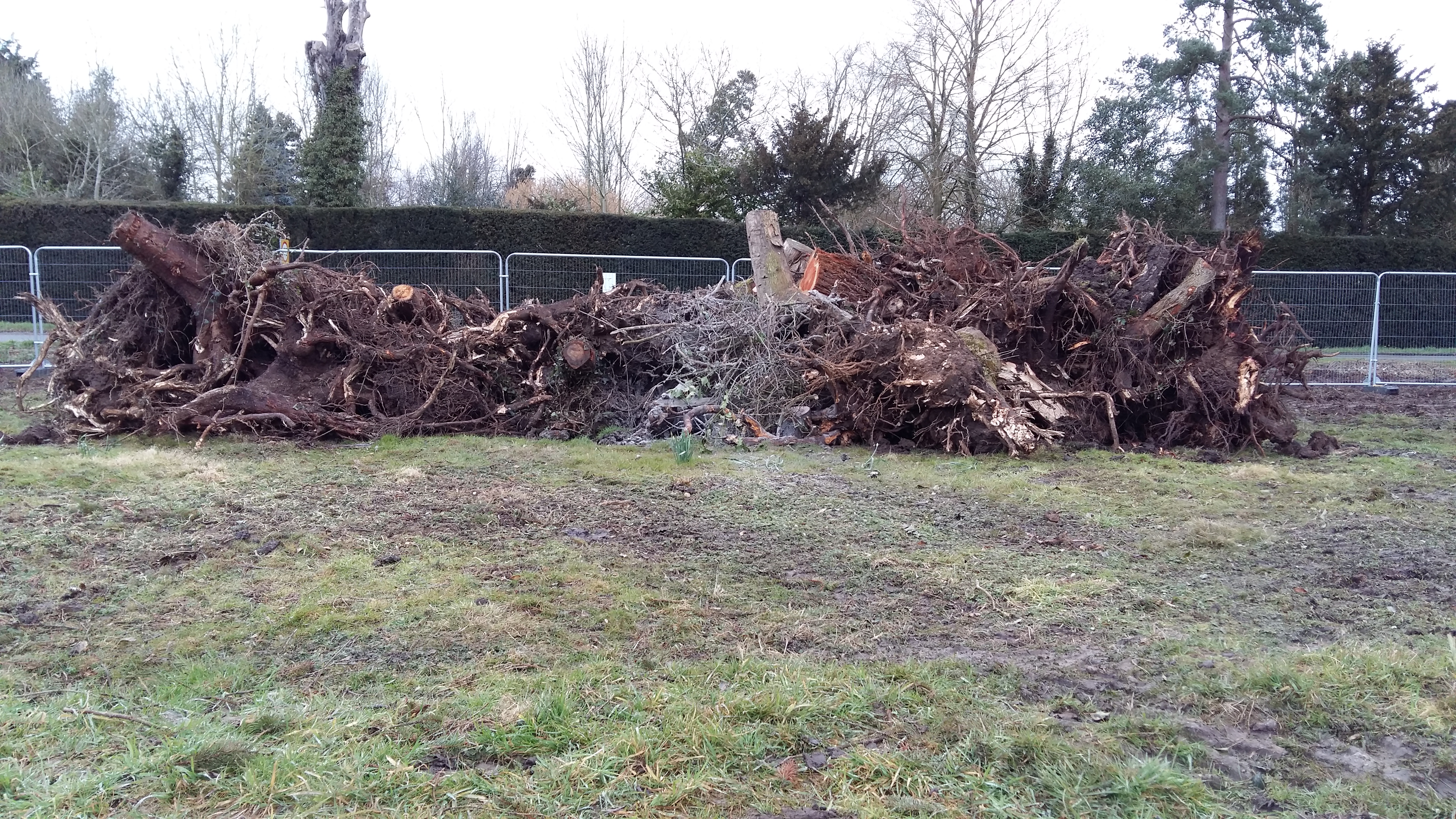

ProDave Posted June 23, 2016 Share Posted June 23, 2016 This was the largest tree I removed: The one on the right. the trunk was about 18" diameter. It was very hard going with my 3ton digger. I had cut it off about 4ft above ground so I had a good stump to work with. It still took a lot of digging and pushing and pulling. I found the maximum "push" was achieved by positioning the bucket then pushing by tracking the machine forwards. That seemed to give more force than just trying to push it with the boom. Your difficulty is going to be the short stumps, so it will be more a case of dig them out rather than the brute force of push the stump over. Link to comment Share on other sites More sharing options...

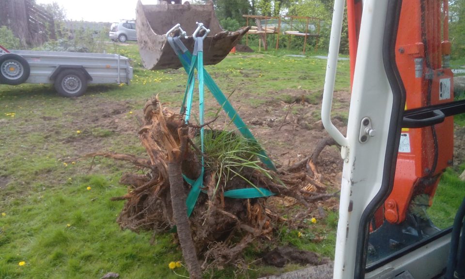

ToughButterCup Posted June 23, 2016 Share Posted June 23, 2016 2.0 tonne Kubota: first job.... The first thing I did with my digger was dig out the root bowl of a cherry tree (12 inch diameter minimum) that I had stupidly sawn off at ankle height. I was fed up with it. The centre part of the tree was rotten, and the fruit was stolen each year with unnerving stealth by Blackbirds. BTW, on Declan's advice I now no longer sling loads like that on the bucket teeth. I use a 4 tonne shackle on the back of the proper lifting point on the quick hitch. Link to comment Share on other sites More sharing options...
