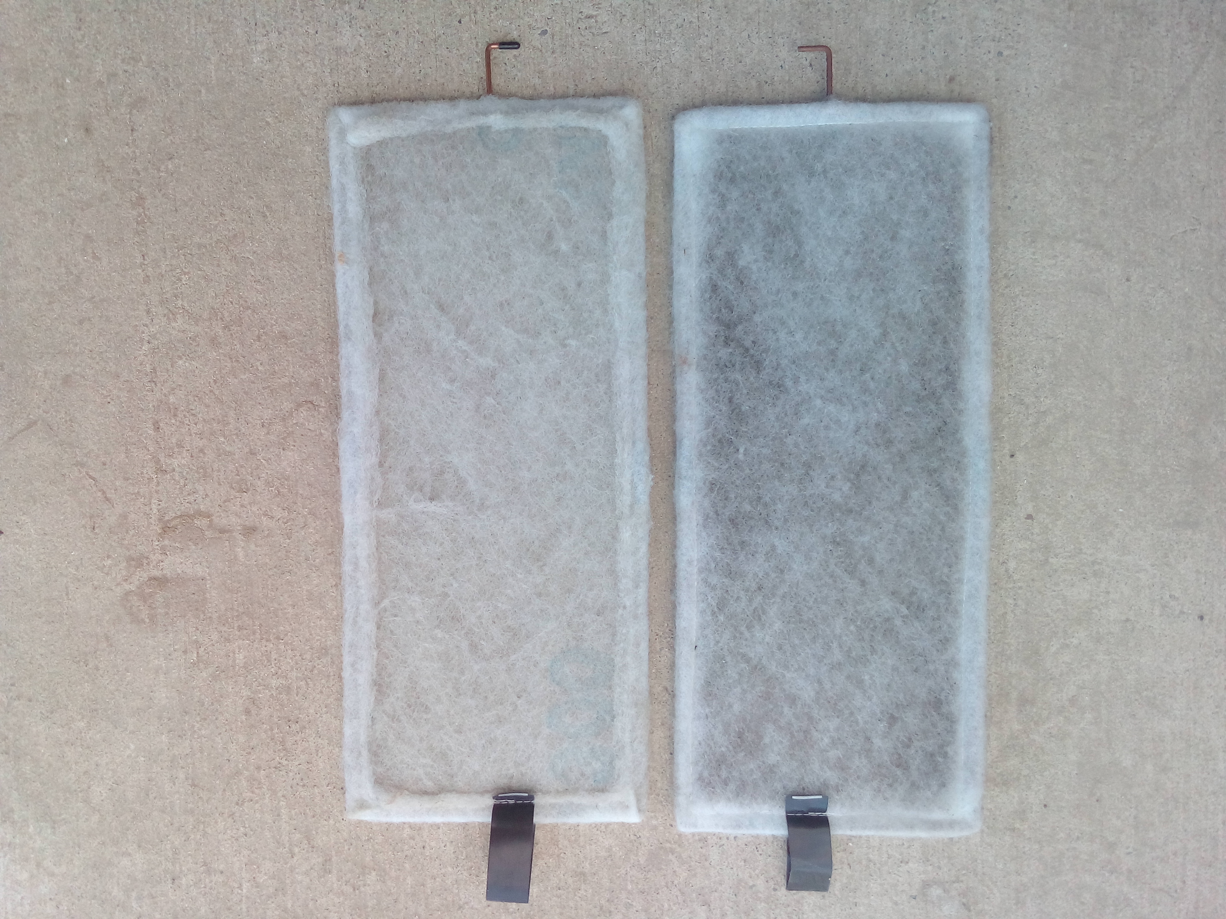

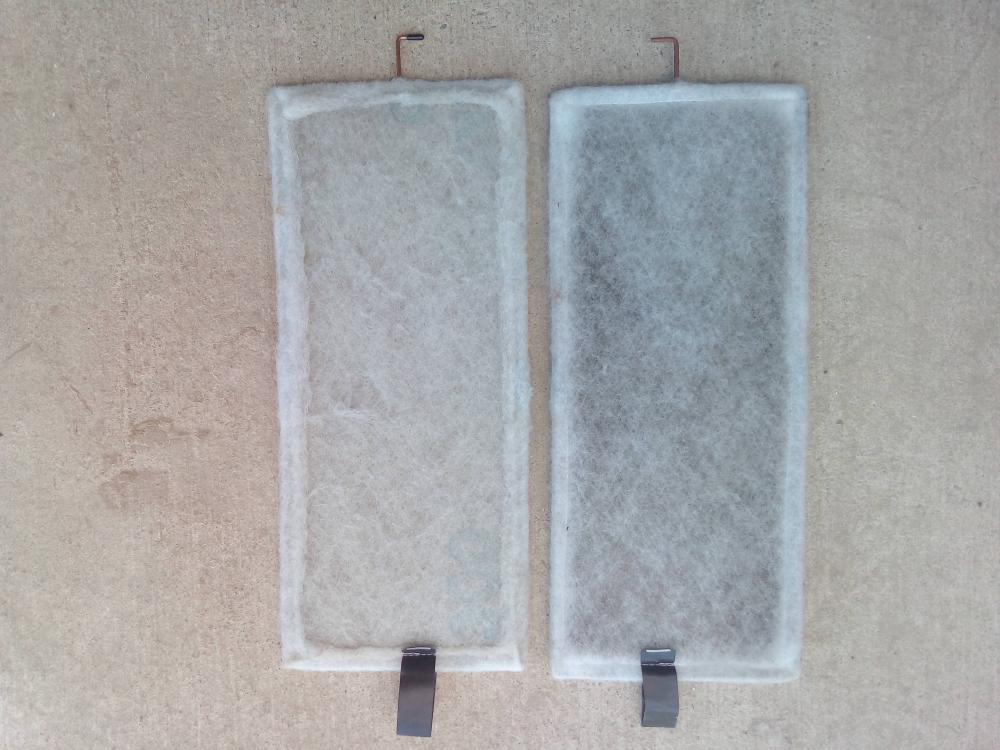

Stones Posted February 25, 2018 Author Share Posted February 25, 2018 @JSHarris and @pulhamdown, attached picture of the original filters I replaced last year. I would describe the fit as having a bit of wiggle, and as you can see no neoprene seal. The replacement filters I used were actually meant for a bigger unit but do have a snugger fit. Same filter material on metal frame. The darker of the two filters you see was on the air intake so caught all the insects. I'm not convinced many got round the filter, but suspect in removing the filter to clean some will have got shaken off or into the core while the filter was out. Link to comment Share on other sites More sharing options...

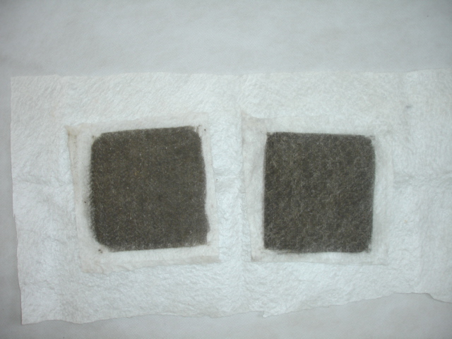

PeterW Posted February 25, 2018 Share Posted February 25, 2018 I’m adding a 300mm square filter unit to the side of the MVHR that is 100mm thick. It will contain a 45mm G7 filter and a 25mm carbon filter so that leaves 15mm either side to allow for better air flow. Filters are cheap - I plan to swap every 6 months which I don’t think is an unreasonable cost for filtered fresh air.... Link to comment Share on other sites More sharing options...
Stones Posted February 25, 2018 Author Share Posted February 25, 2018 10 minutes ago, PeterW said: I’m adding a 300mm square filter unit to the side of the MVHR that is 100mm thick. It will contain a 45mm G7 filter and a 25mm carbon filter so that leaves 15mm either side to allow for better air flow. Filters are cheap - I plan to swap every 6 months which I don’t think is an unreasonable cost for filtered fresh air.... Do you have a link to what you are planning to install or are you making it yourself? Link to comment Share on other sites More sharing options...
PeterW Posted February 25, 2018 Share Posted February 25, 2018 10 minutes ago, Stones said: Do you have a link to what you are planning to install or are you making it yourself? Errr ... it’s a mix of both ..!! This is the filter box This is the G4 This is the carbon filter I will use some 10mm angle to create the slot for the filter pair which will be hopefully an airtight fit and ensure that both the dust and smaller stuff is kept out. Link to comment Share on other sites More sharing options...

JOE187 Posted February 25, 2018 Share Posted February 25, 2018 https://uk.rs-online.com/web/p/filter-media/1221772/ I use this filter material on my outside inlet in front of the mesh screening catches all insects and grime, makes the internal filters last twice as long before cleaning or replacing! Both my MHVR units have this on the external inlets and need changing every 3 to 4 months 1 Link to comment Share on other sites More sharing options...

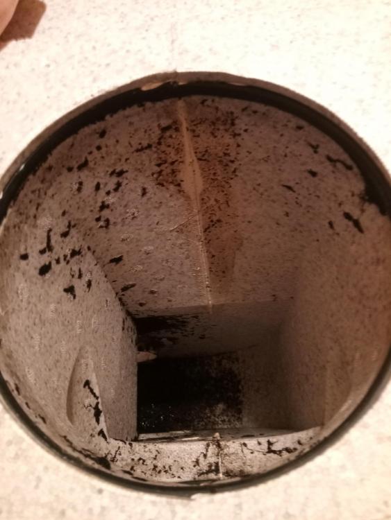

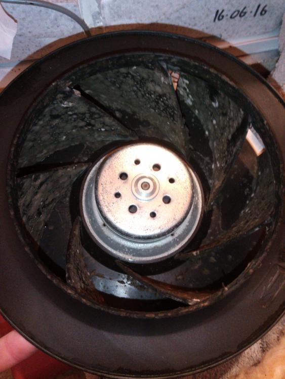

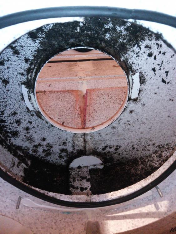

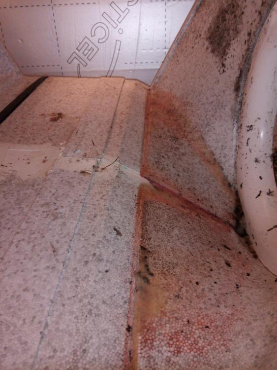

Stones Posted February 9, 2020 Author Share Posted February 9, 2020 Bit of an update, 3 years in. I've been changing filters every 6 months and servicing the unit (core, fan blades, drain) every 12 months. Last night, some odd noises coming form the exhaust vents, which made me think a bearing had gone. So today's job was checking. And this is what I found... Thankfully all on the exhaust side after post the heat exchange core. The cause of all this was the condensate drain being blocked with mould and 'biojelly' (see last pic, the large black area). It would seem that in not draining away, water has overflowed or been pulled into the exhaust fan chamber where it has obviously coated the fan blades and walls of the chamber. No warning indicators or lights to suggest a problem of course. So, having found the problem, I had to take the whole unit apart, remove the top and sides (which slide and interlock with each other)to get to the back of the fan. Unbolt and remove fan to get into the chamber. Interestingly, this seems to be the only way you can properly clean the fan blades as you certainly can't do it from inside the main body of the unit. A lot of wipes used to remove the mould, then a generous application of bleach to kill the nasties and clean it up. Fan blades cleaned and all reassembled. Should be easy but took best part of the day, in large part due to the poor design of the unit. Screws and fixings (referenced earlier) used to secure body panels were a real pain, and I think I'm going to ditch them in favour of cam lock belts. Condensate drain not easy to clean through (must get a bottle brush). Best part of £1250 for one of these units and this is what happens. Never had this problem before, having had MVHR (different makes) in 5 previous houses. I am not a happy bunny right now. Link to comment Share on other sites More sharing options...
Declan52 Posted February 9, 2020 Share Posted February 9, 2020 They have to have updated the panel fixings by now for their latest versions. It's like they spent thousands and thousands of £££ to design the inner workings of the unit and then 2p on how you attach it all together. I have never went as far as checking the fan in mind but maybe for a bit of peace of mind I might do it when it's next due the filter change in April. Link to comment Share on other sites More sharing options...
Stones Posted February 9, 2020 Author Share Posted February 9, 2020 @Declan52 just shine a torch into the fan when you have the heat exchanger removed. You WILL know if you have a problem. 1 Link to comment Share on other sites More sharing options...
