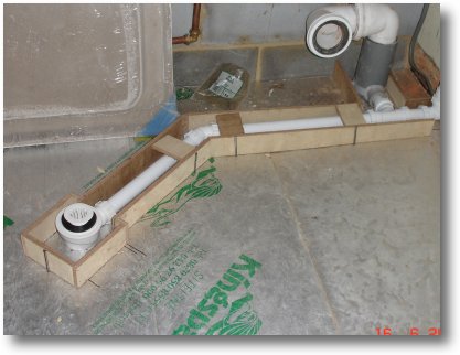

Triassic Posted February 22, 2018 Share Posted February 22, 2018 (edited) I’m starting to set out the waste pipes for a basement bathroom and was wondering what was best practice for such things. I had in mind something like this (see photo). My thinking was that if I shuttered around the pipes I could then have some flexibility fitting the sink, shower and bath. In my situation the toilet waste waste is in the middle so I was thinking of a boss on each side, rather than using a T piece, as in the example below. Once fitted and in their final position I’d then remove the temporary shuttering and concrete the pipes into place. Edited February 22, 2018 by Triassic 1 Link to comment Share on other sites More sharing options...
Triassic Posted February 23, 2018 Author Share Posted February 23, 2018 (edited) I also assume I’ll need a drain in the room containing the thermal store, if so, what size? Would 40mm do? ps. I notice the guy whose picture i borrowed has used screw connections, I’d use solvent weld, less likely to leak? Edited February 23, 2018 by Triassic Link to comment Share on other sites More sharing options...

Onoff Posted September 25, 2019 Share Posted September 25, 2019 My basin and semi sunken bath go into the same 50mm waste. Anti siphon trap on the basin. Connection to the bath via a 40mm flexible. 2 Link to comment Share on other sites More sharing options...
