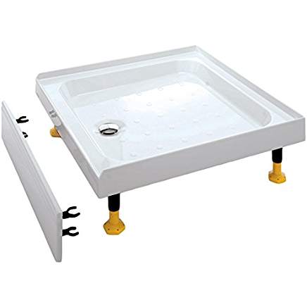

CC45 Posted February 16, 2018 Posted February 16, 2018 Hi all, Been getting a few prices from my local BM Eastbrook volente 900 x 900 - £104 excl Kartell kt35 900 x 900 - £66. Both need waste on top. No idea how to guage quality except based on price (dubious I know) - has anyone heard of either of these? Would you buy online? Any recommendations? Thanks Cc
Cpd Posted February 16, 2018 Posted February 16, 2018 https://www.amazon.co.uk/Coram-Showers-YD903WHI-3-Tiling-Upstand/dp/B00C2IEWKC/ref=sr_1_5?ie=UTF8&qid=1518805286&sr=8-5&keywords=coram+shower+tray+900+x+900 i put one of these in last year and its been great. However its the first shower tray i have ever installed so no comparison. Sure others will have some solid recommendations. I went with this because i wanted one with good up-stands as i was using shower wall board to come down over the upstands. Worked for me....
nod Posted February 16, 2018 Posted February 16, 2018 1 hour ago, CC45 said: Hi all, Been getting a few prices from my local BM Eastbrook volente 900 x 900 - £104 excl Kartell kt35 900 x 900 - £66. Both need waste on top. No idea how to guage quality except based on price (dubious I know) - has anyone heard of either of these? Would you buy online? Any recommendations? Thanks Cc The shower trays seem much of muchness With some giving a free waste I got a free waste with all three of mine and replaced the with mc alpine wastes I’m not a plumber but I could see that the free ones looked flimsy 1
CC45 Posted February 16, 2018 Author Posted February 16, 2018 I think Im going for the £100 one & a decent trap. At the end its £40 & its not a game changing amount + I need to make the decision and move on to the next decision!
Nickfromwales Posted February 16, 2018 Posted February 16, 2018 39 minutes ago, CC45 said: I think Im going for the £100 one & a decent trap. At the end its £40 & its not a game changing amount + I need to make the decision and move on to the next decision! Stone resin is the one to go for. As long as its not composite coating / foam centre then your good to go.

CC45 Posted February 17, 2018 Author Posted February 17, 2018 Tray is stone resin with something on top. Ordered now. Will prob have a question or two when it arrives - easier to answer than @Onoff questions! 1
Nickfromwales Posted February 17, 2018 Posted February 17, 2018 I think another member made a good suggestion. When it arrives lay it flat, outside, and level it by whatever means. Then run water over it to see if its all free running to the drain and doesn't pool at the corners / other.
Onoff Posted February 18, 2018 Posted February 18, 2018 11 minutes ago, CC45 said: Tray is stone resin with something on top. Ordered now. Will prob have a question or two when it arrives - easier to answer than @Onoff questions! Yeah, sorry for the hijack! Moved to my own thread now!
CC45 Posted February 18, 2018 Author Posted February 18, 2018 8 minutes ago, Nickfromwales said: I think another member made a good suggestion. When it arrives lay it flat, outside, and level it by whatever means. Then run water over it to see if its all free running to the drain and doesn't pool at the corners / other. Good idea - thats Tuesday night then. I'm expecting it to be ok, since I didnt buy the cheapest. Will order the valve showers tomorrow - can then get down to some plumbing again.
