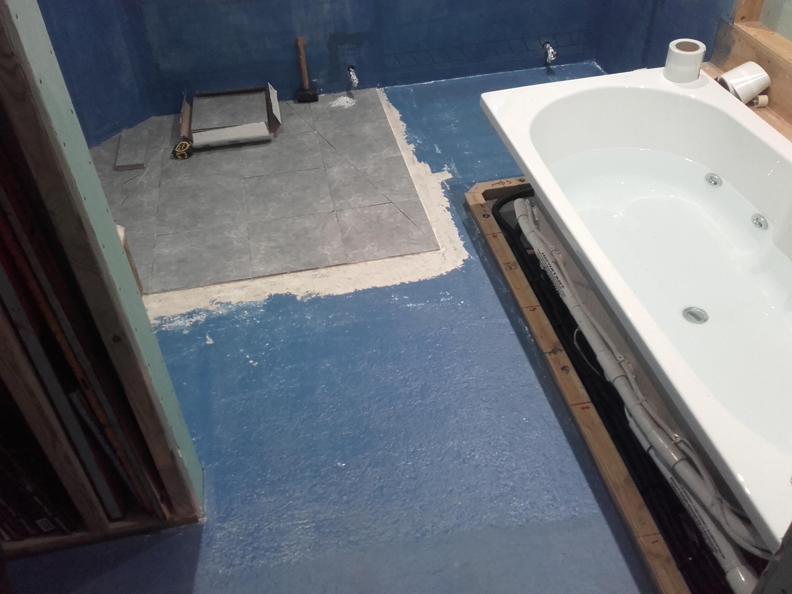

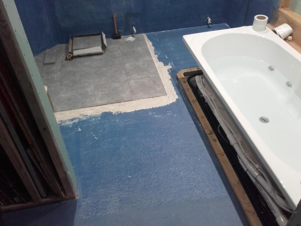

Onoff Posted August 6, 2018 Author Posted August 6, 2018 @Nickfromwales, not wishing to agree with SWMBO here but why can't I now do the section where the basin will be to the right in this picture? It's about 1m2 so not too much for me to get into trouble. THEN from the bottom of the picture to the stub wall. When that's dry the bit in the cupboard & out the door? Ta.
Nickfromwales Posted August 6, 2018 Posted August 6, 2018 As long as you've got a dry section to work away from then carry on. ?
Onoff Posted August 6, 2018 Author Posted August 6, 2018 So tonight these two areas abutting the wet room corner. If I butter both floor and tile now won't I just have more adhesive ooze out / to clean up?
newhome Posted August 6, 2018 Posted August 6, 2018 45 minutes ago, Onoff said: So tonight these two areas abutting the wet room corner. If I butter both floor and tile now won't I just have more adhesive ooze out / to clean up? You may well have probably but you won't have any missed spots under the tiles which is surely what the buttering derisks so which is more important?

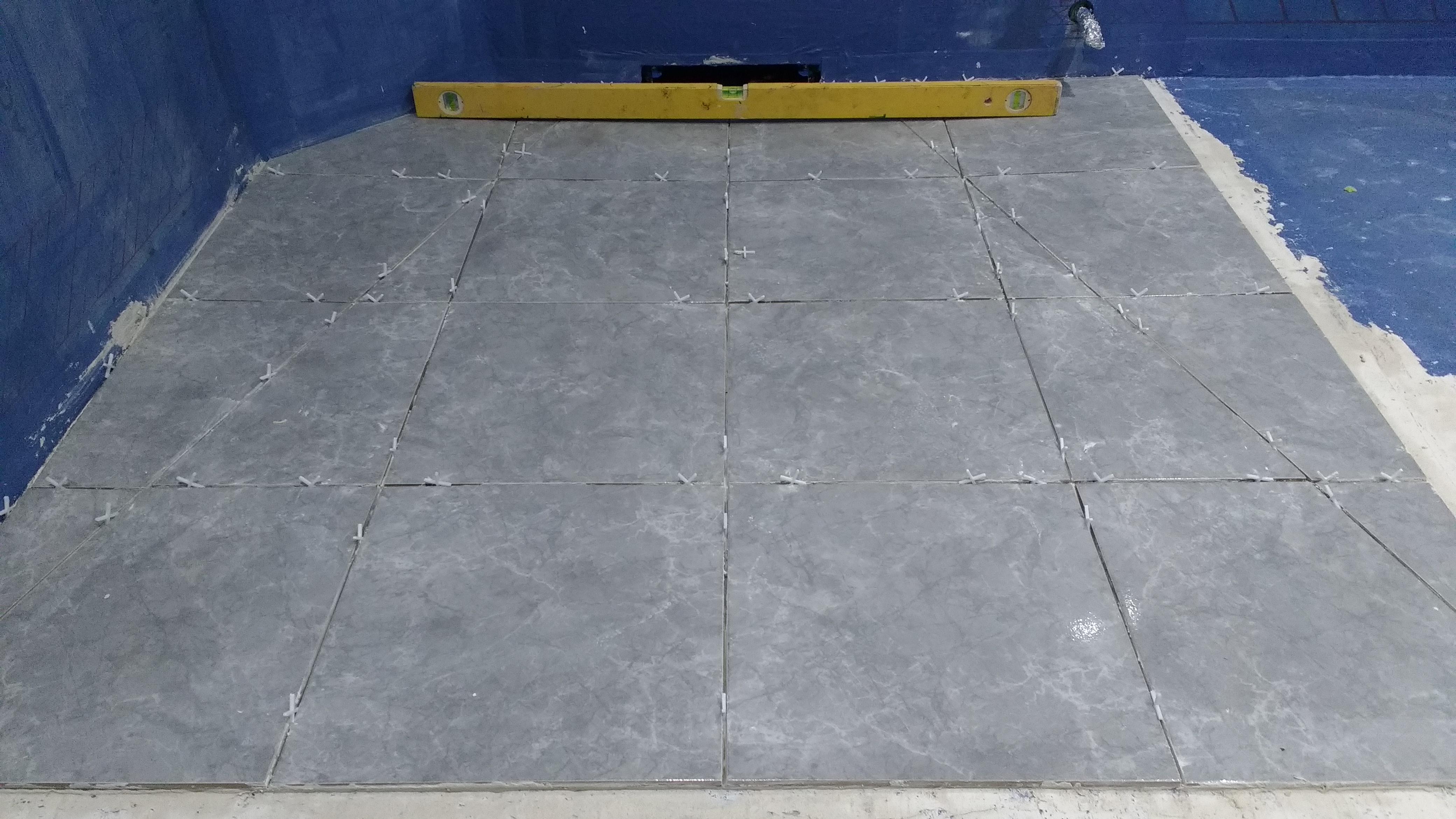

Onoff Posted August 6, 2018 Author Posted August 6, 2018 Just did the bit under the basin area tonight. Buttered the tiles. Felt "better" laying them. Also a couple under the wc with last of the muck: Found a method to get shot of the excess adhesive too. I laid all the tiles with spacers. Then removed them and wiped the faces with a sponge. Used a 1" paintbrush in the joints to get rid of the excess. Another go over with the sponge and then put the spacers back in. Used a 4' Stabila level and "knees" to level across them. 2

Onoff Posted August 6, 2018 Author Posted August 6, 2018 24 minutes ago, CC45 said: coming along...... 6mm tile trowel used? Yep. Bed on the floor, trowel held at 45deg. Then buttered the back of the tile in the opposite direction. Laid with a twist!
