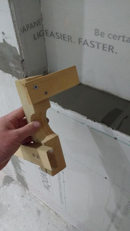

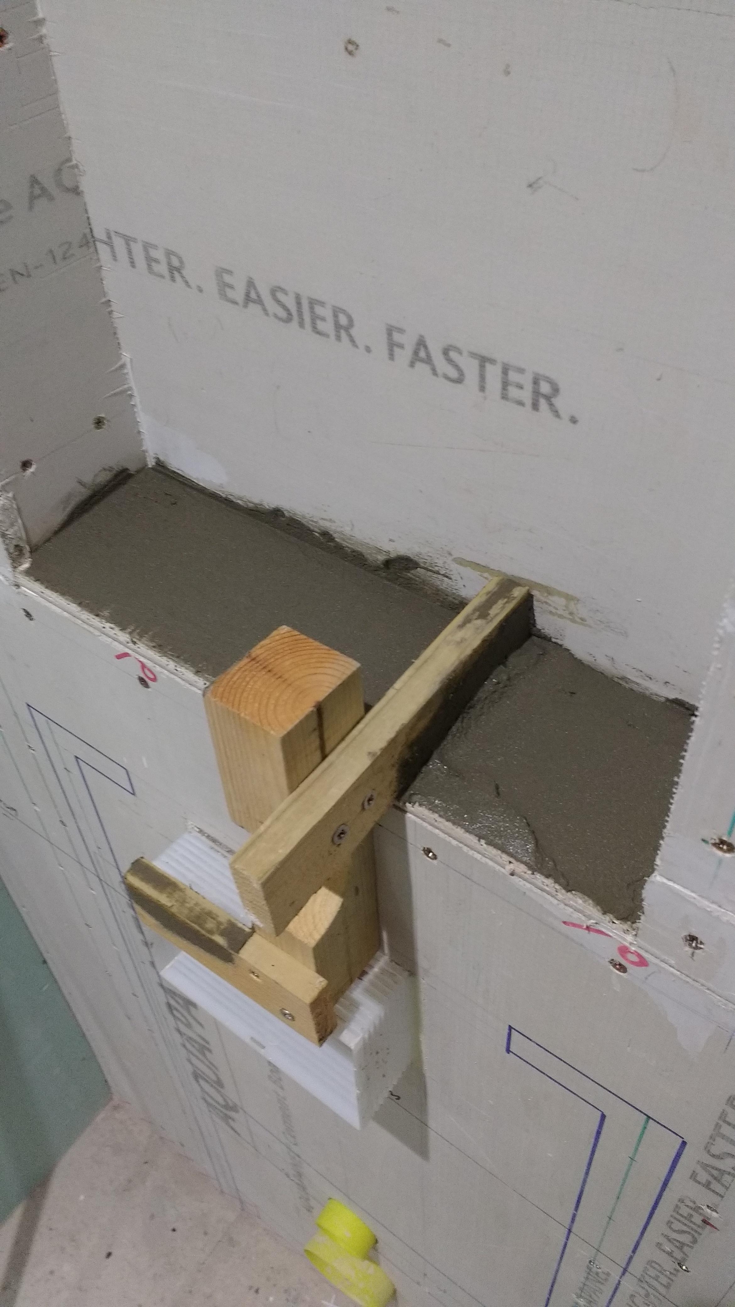

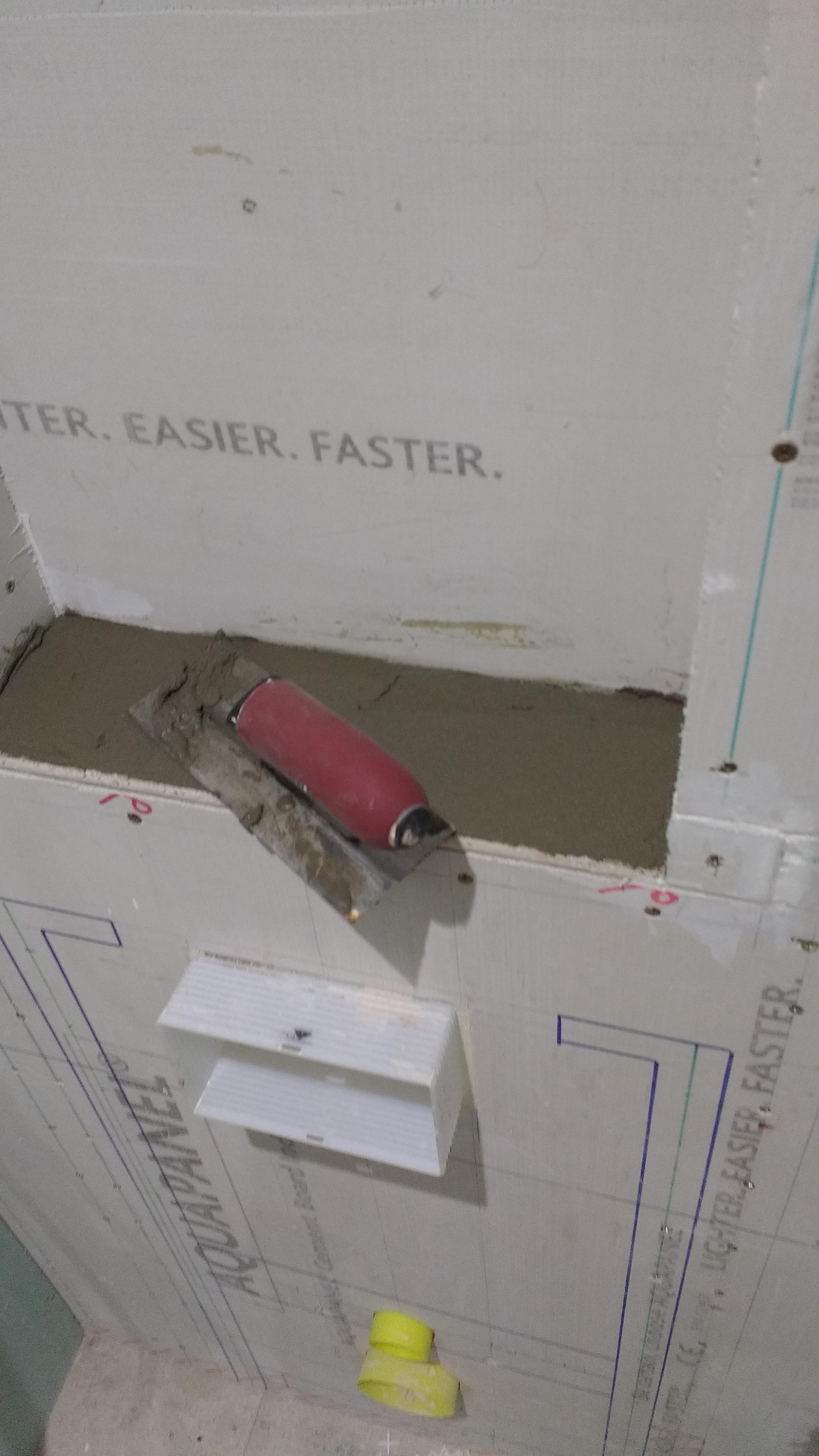

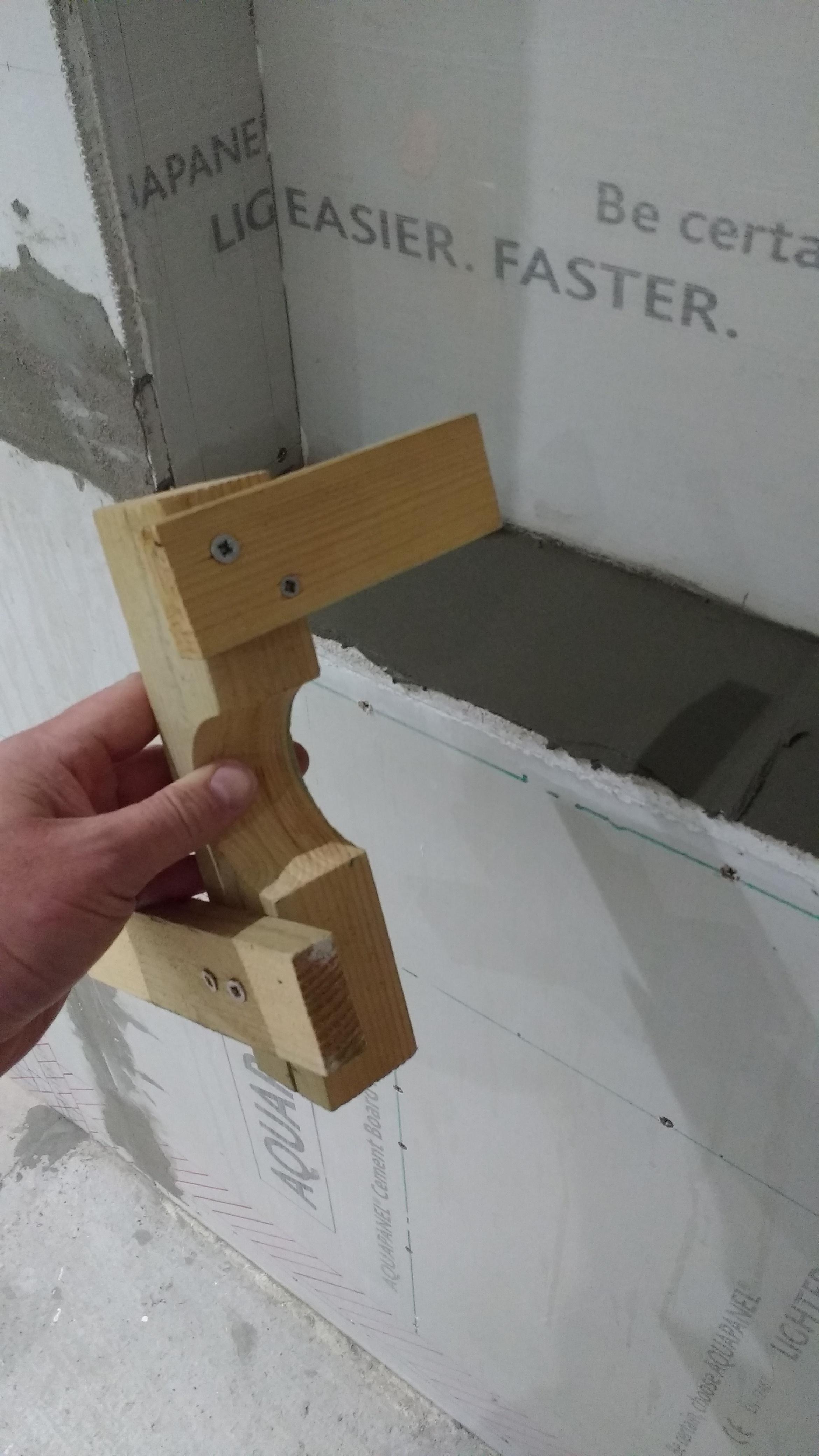

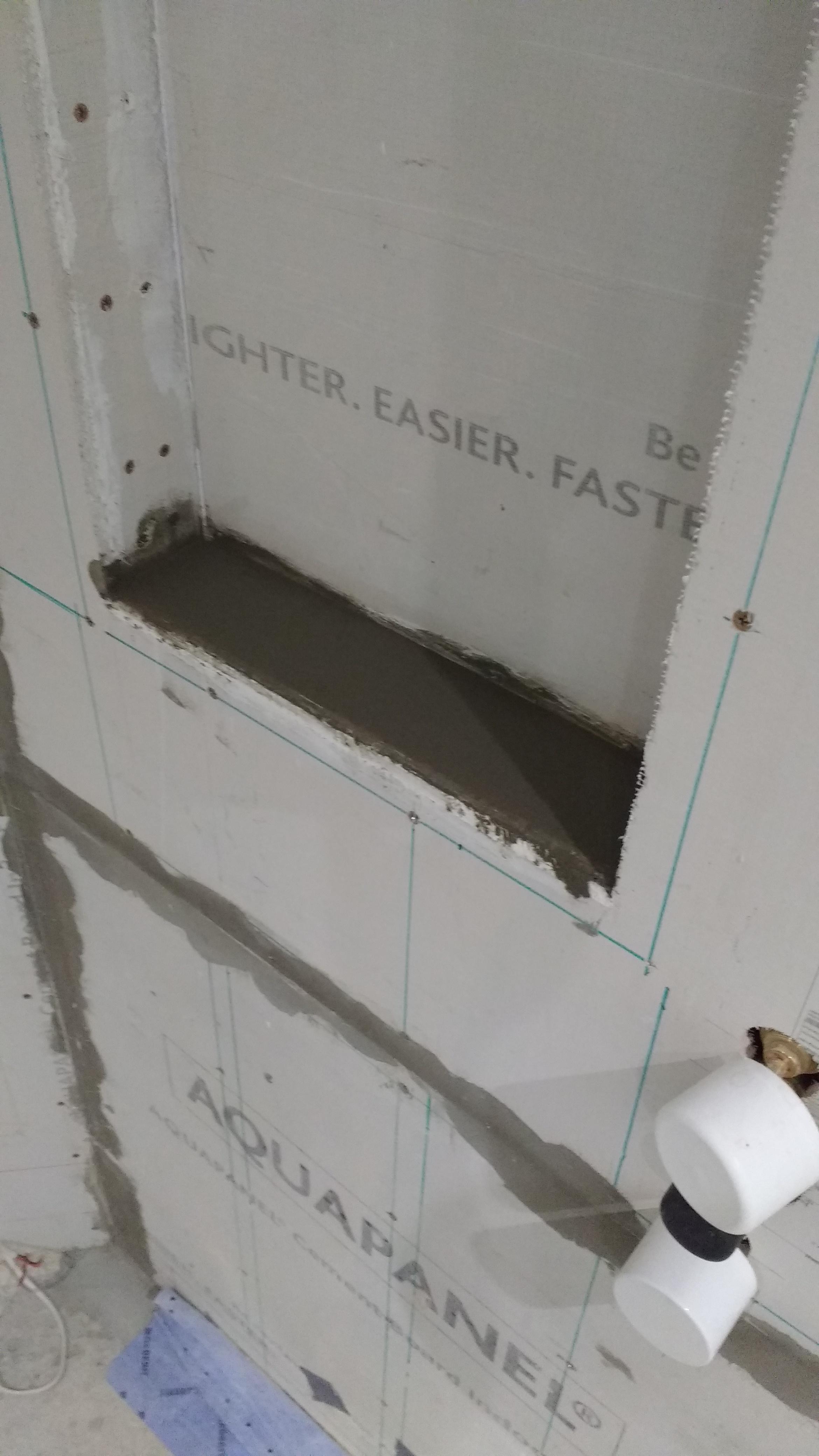

Put a 3taper on the pockets. Primed with 5:1 SBR then used my special tool. You can't buy this in the shops! Does two different depth pockets:
They'll do!
