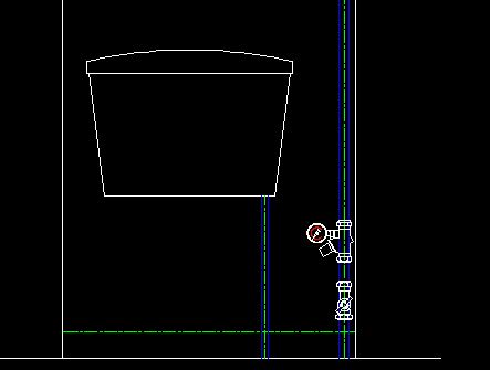

Onoff Posted October 3, 2016 Author Share Posted October 3, 2016 If I methodically CAD everything maybe even beyond: Link to comment Share on other sites More sharing options...
Nickfromwales Posted October 3, 2016 Share Posted October 3, 2016 Turn the cad off and get a spanner out I really need to get cad fluent, but then I'd spend more time drawing the damn things than actually out earning dollars. I design most of my installs the day I turn up to fit them tbh. I just look at the space for an hour or two and work all the crossovers etc out in my head and then draw a few lines and mark locations of things so I can recollect what's going where when I'm underway and then just go for it. I see the job in layers in my head so I can put timbers in, board, lay clips etc, and allow for insulation / brassware accordingly and usually it goes in first time. Usually. Link to comment Share on other sites More sharing options...

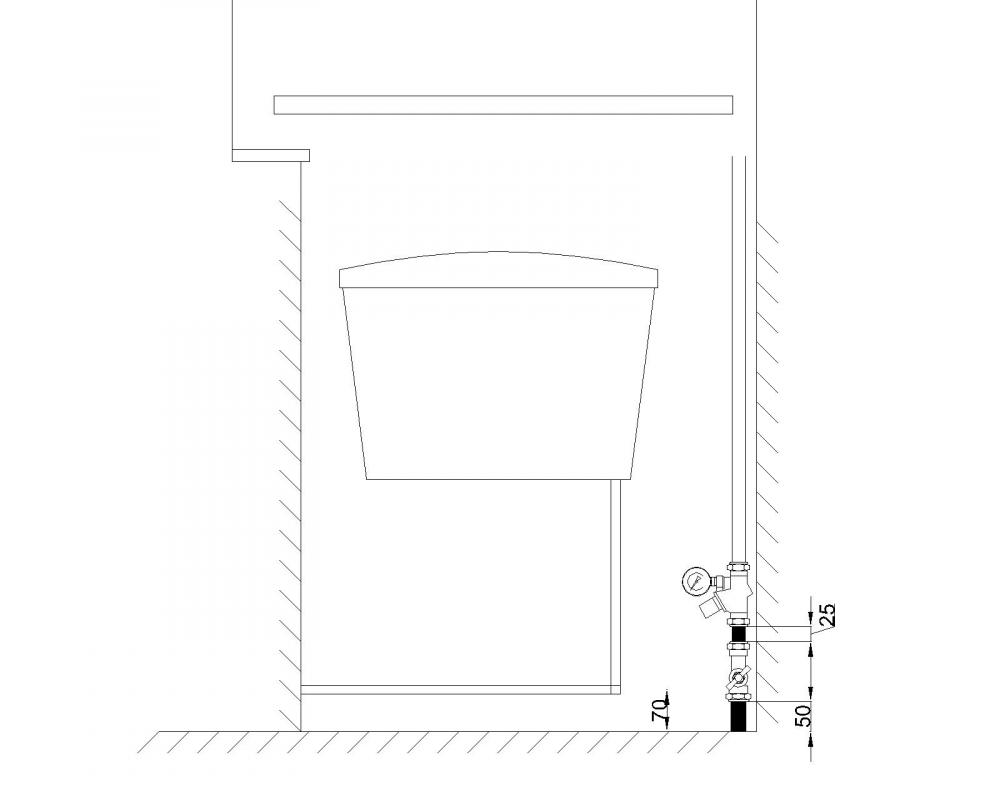

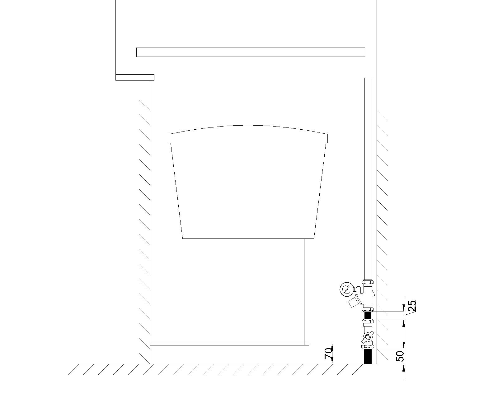

Onoff Posted October 3, 2016 Author Share Posted October 3, 2016 I'll often CAD it & THEN draw it physically on a board/big piece of card! All a bit tight next to this existing cistern. Showing what I think are some minimum spacings between fittings. I suppose I could turn the PRV thru 90deg? Its where to put the outside tap..... Maybe thinking about this the WRONG way. If later on this cistern comes out I need to think about just getting the MDPE connected even if a bit rough. I guess I could even feed the cistern and basin via a flexi for now? Link to comment Share on other sites More sharing options...
Nickfromwales Posted October 4, 2016 Share Posted October 4, 2016 As long as water gets to them then what the hey Don't forget, if you go for an UVC or have to G3 the install, you'll need a secondary PRedV ( multiblock ) which will come supplied. That HAS to be with the cylinder for G3, even if you have one at the stopcock. They'll also want a NRV ( single check ) on the hot outlet to stop any unwanted mixing of pressures at mixer taps / showers etc from back flow, ( as a failsafe against the secondary PRedV ( at the stopcock ) failing ). Part of that multiblock would be a 5 or 6 bar cold mains blowoff, and also a TPRV, so make allowances for running a 22 or 28mm D2 discharge pipe if your going to need a path through the house to get it to ground level outside. Link to comment Share on other sites More sharing options...

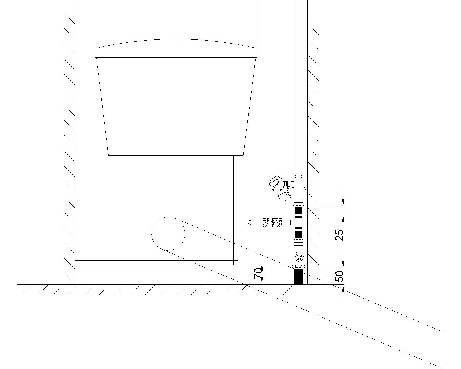

Onoff Posted October 4, 2016 Author Share Posted October 4, 2016 Tundish? Getting there figuring all this tight space out. Still like the idea of the outside tap at "full" available mains pressure. Showing below the MDPE stop cock 50mm above the floor then a Yorkshire T coming off to a Pegler isolating valve and out though the wall to the outside tap. This will however sit it just above the angled soil pipe and I think only about 8" up from the DPC so about 350mm off the ground. That soil could later go vertical down outside on the wall. Then PRV above the T. I've now to add another T above the PRV to tap off a line for the feed to the bottom fed cistern and along the bottom to the basin. BUT is's tight for vertical height Any hard and fast rule about butting compression fittings together i.e. little if any copper showing? Thinking to do away with the solder T after the MDPE stop cock and use a compression T to feed the Pegler isolator / outside tap. I could then get rid of the 25mm bits of copper either side of the Yorkshire. Link to comment Share on other sites More sharing options...
Nickfromwales Posted October 4, 2016 Share Posted October 4, 2016 25mm stubs can go with the end feed tee, same as with compression. just solder the tee out of position, clean / file away the excess solder, cut back to required length and Roberts your Mothers Brother. That's what I'd do Link to comment Share on other sites More sharing options...

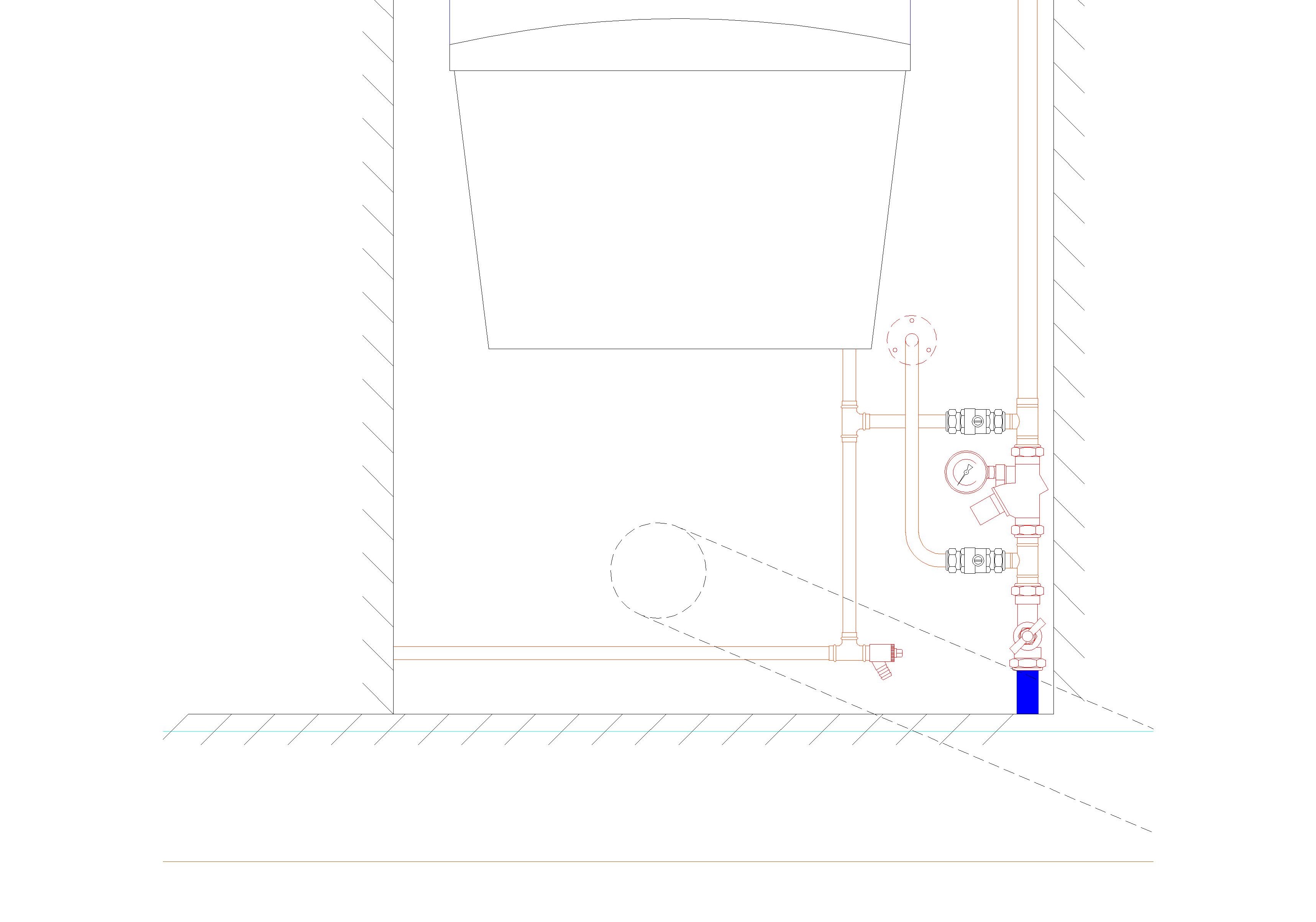

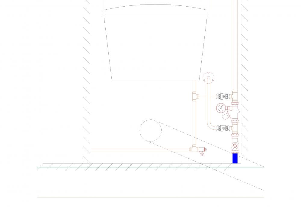

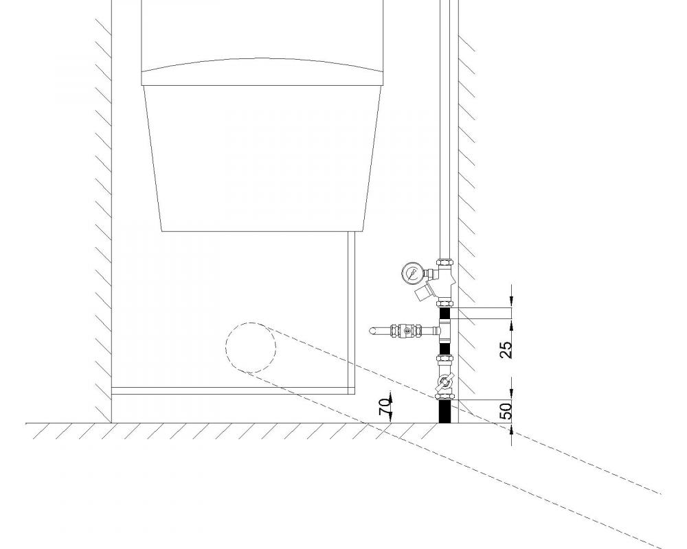

Onoff Posted October 5, 2016 Author Share Posted October 5, 2016 8 hours ago, Nickfromwales said: 25mm stubs can go with the end feed tee, same as with compression. just solder the tee out of position, clean / file away the excess solder, cut back to required length and Roberts your Mothers Brother. That's what I'd do Cheers. I meant 22mm thinking about it! It's 22mm above the stop cock. I'm just not used to having fittings so close to each other! I might turn the outside tap feed so it goes up the side of the cistern then out the wall with a saddle bend to cross the feed to the cistern & basin (not shown). It'd put the outside tap at a more convenient height then. Link to comment Share on other sites More sharing options...
Onoff Posted October 5, 2016 Author Share Posted October 5, 2016 This works..... Puts the outside tap about 2' above the eventual path level. Link to comment Share on other sites More sharing options...

Onoff Posted October 6, 2016 Author Share Posted October 6, 2016 Reckon this'll work alright, just laid loose at the mo: Link to comment Share on other sites More sharing options...

PeterW Posted October 7, 2016 Share Posted October 7, 2016 If it was me I would make that bottom tee with the drain off a compression tee and then you can just line the rest up and solder out of the way. Link to comment Share on other sites More sharing options...
